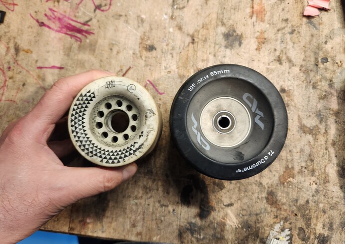

This is only possible thanks to MAD wheels too @fujio001
You would be a good candidate for the 125 x 80mm version coming out this summer!
That would probably be really good on this board!!!
