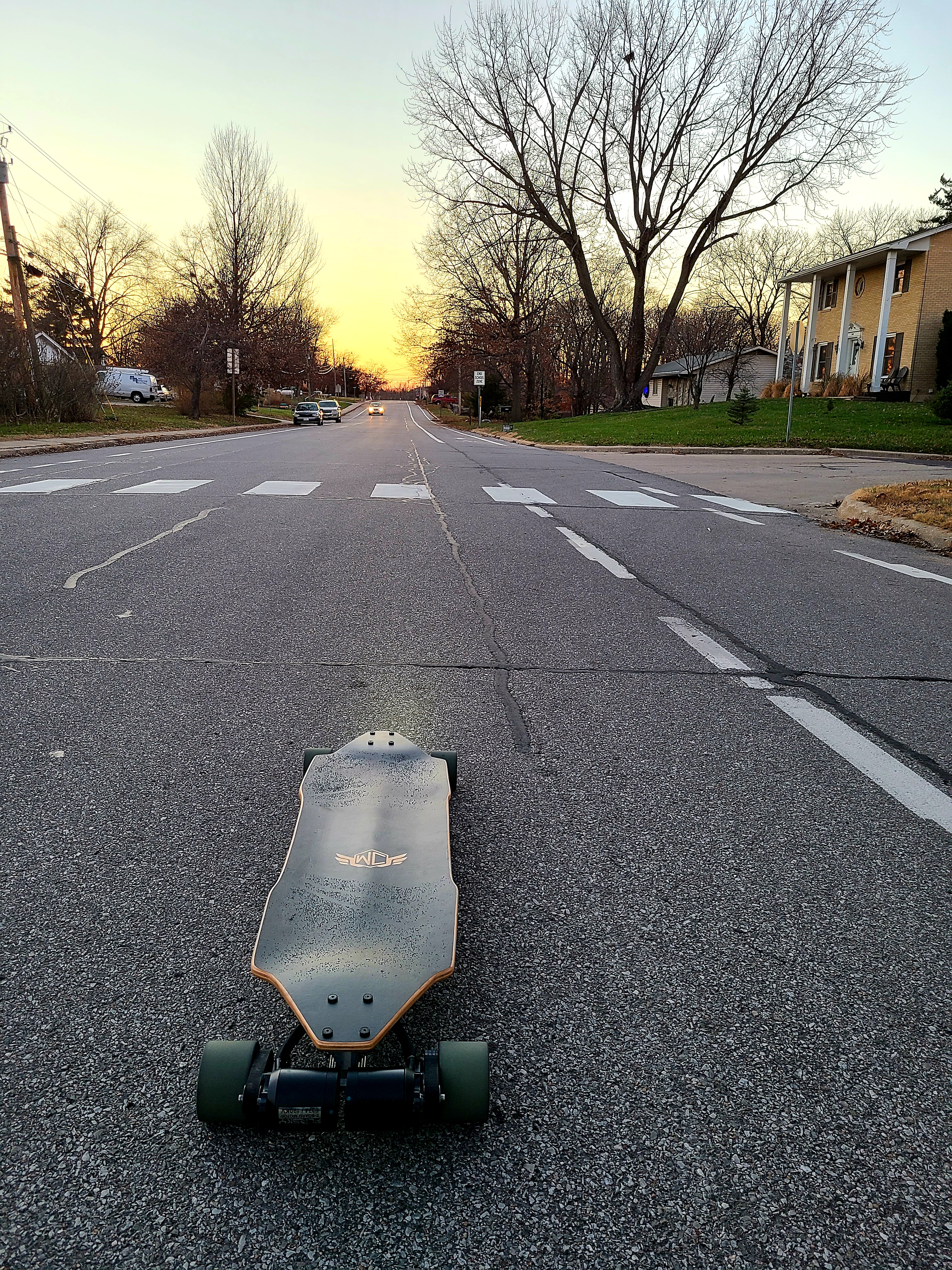

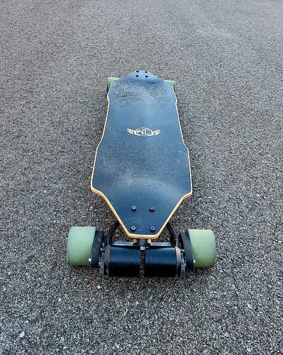

I finished the Llama.
This is just supposed to be a mellow neighborhood carver.
We will see…
This took mostly parts that were on the set up with the Evolve bamboo deck.

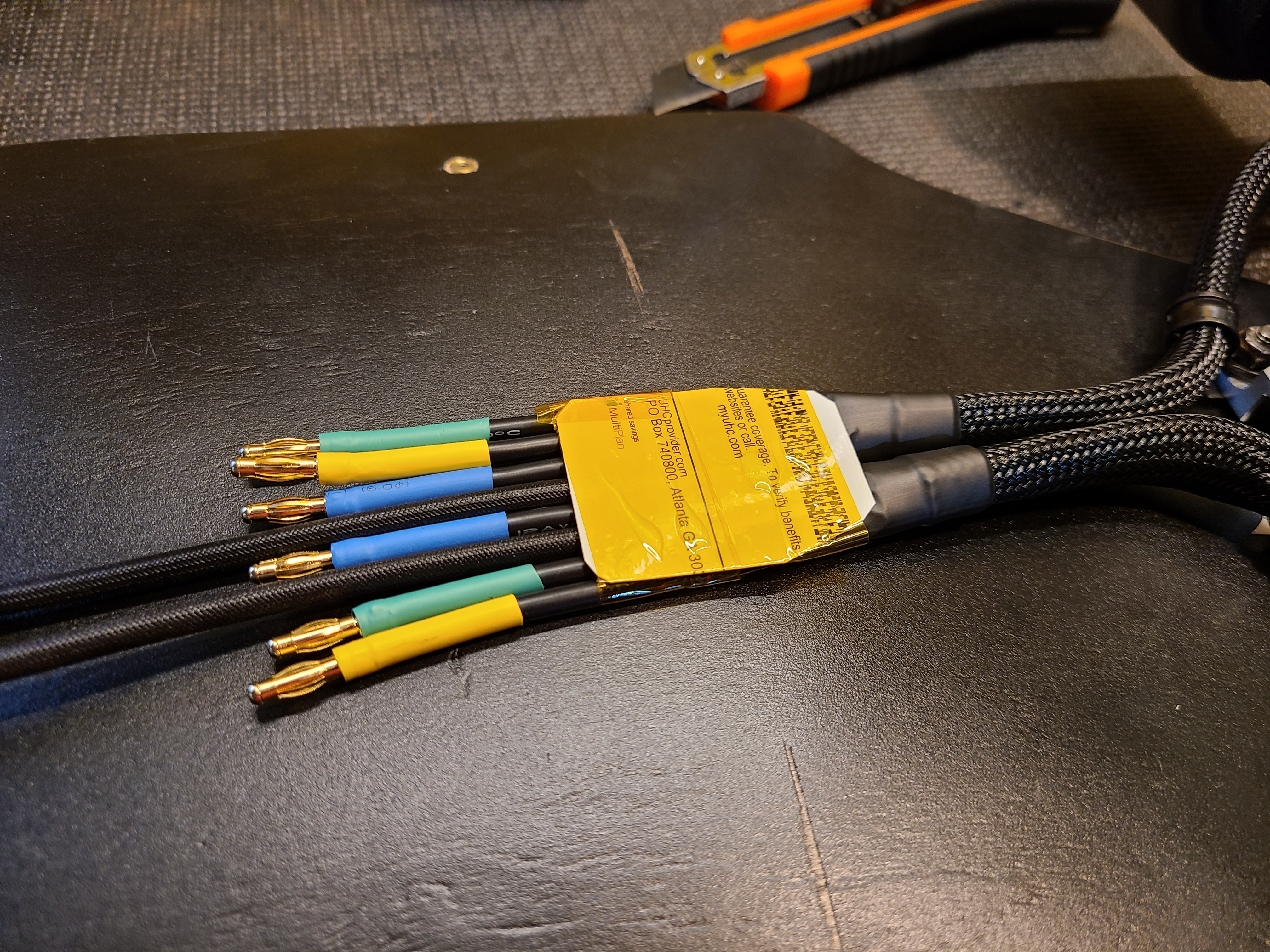

It has a 10S4P 30q
FSESC 6.6 dual plus.

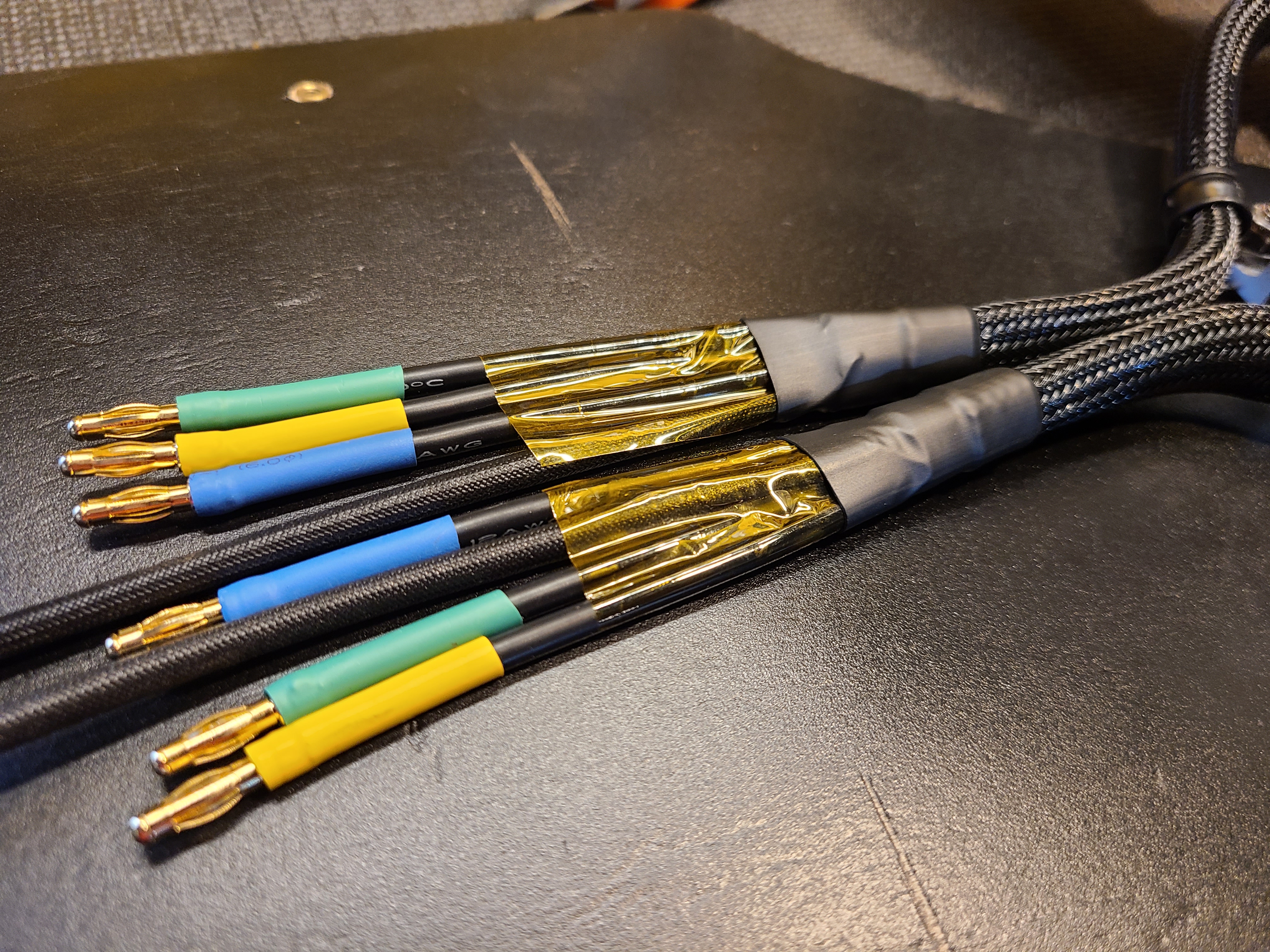

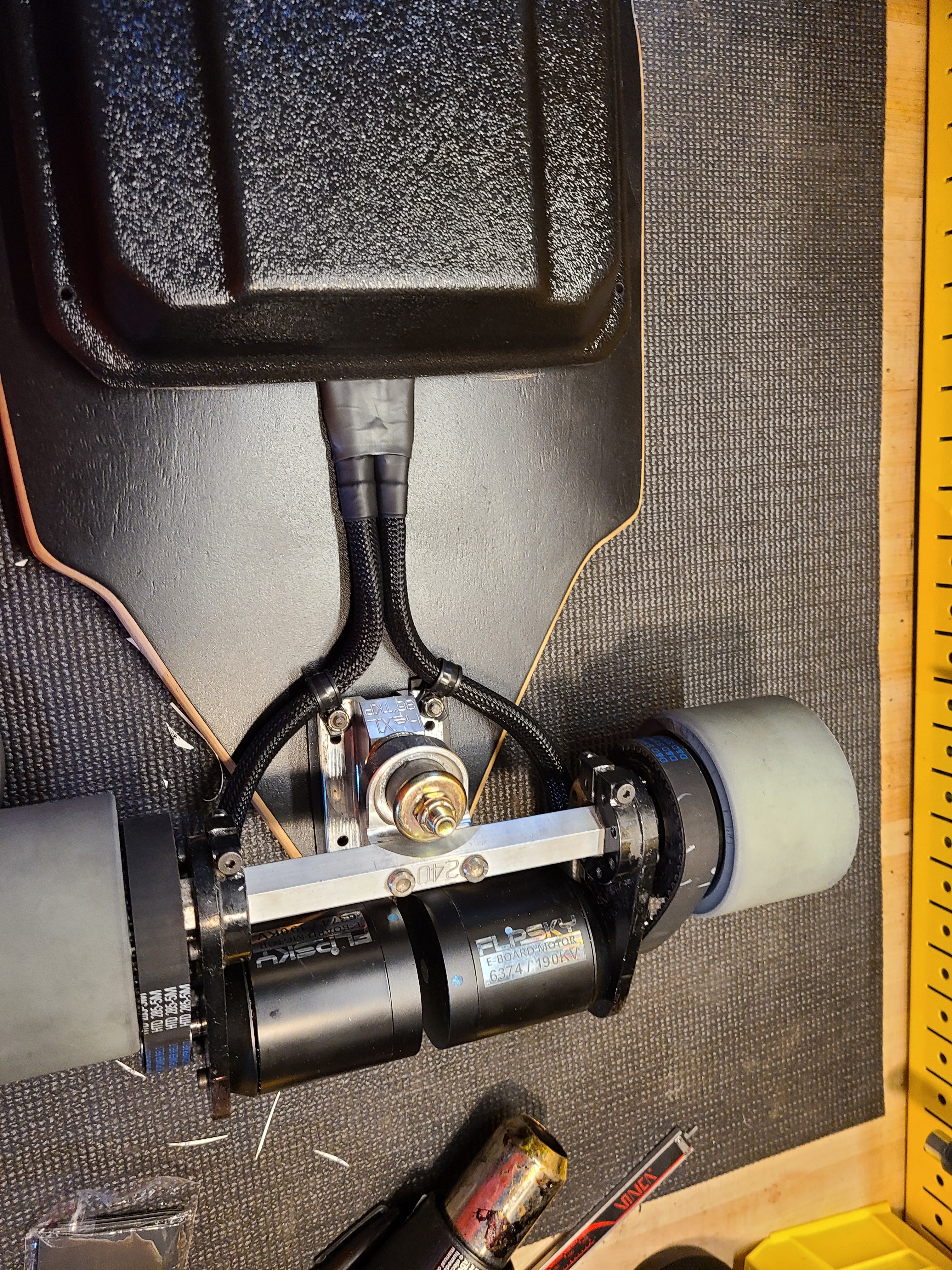

The new Flipsky battle hardened 6374s 190kV.
Blacked out blue Caguamas.
Hexl Trucks.

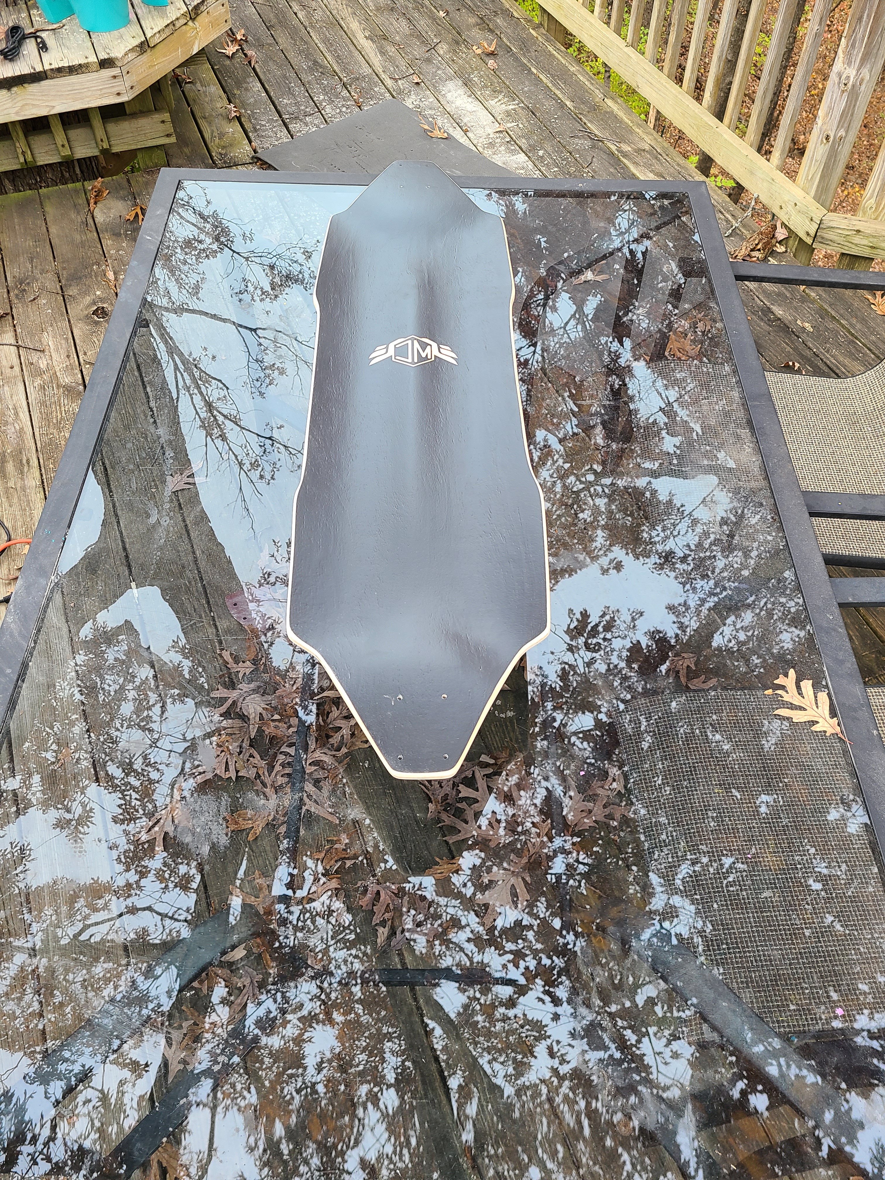

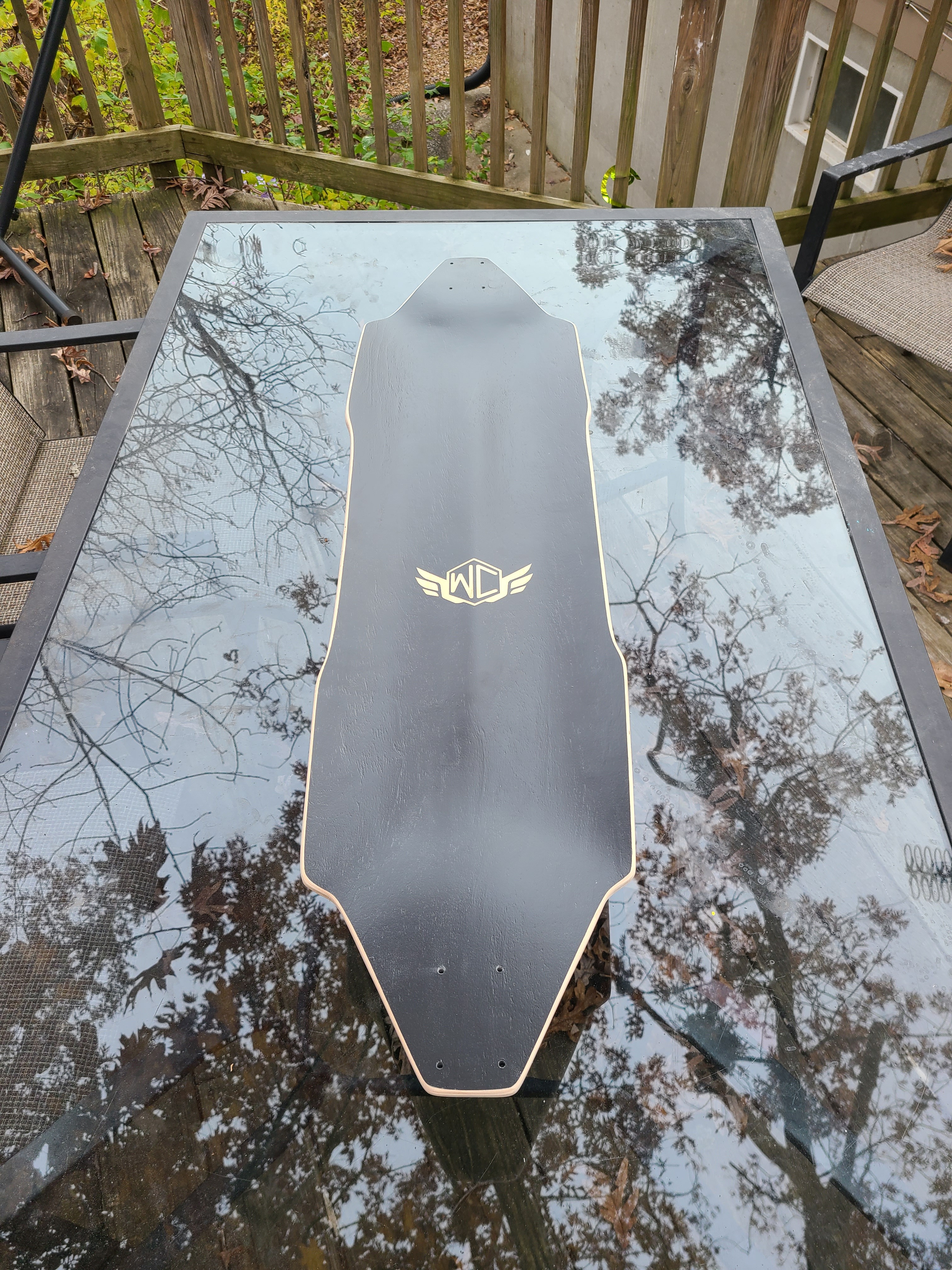

And the Llama which is a giant monster of a deck.

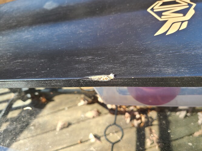

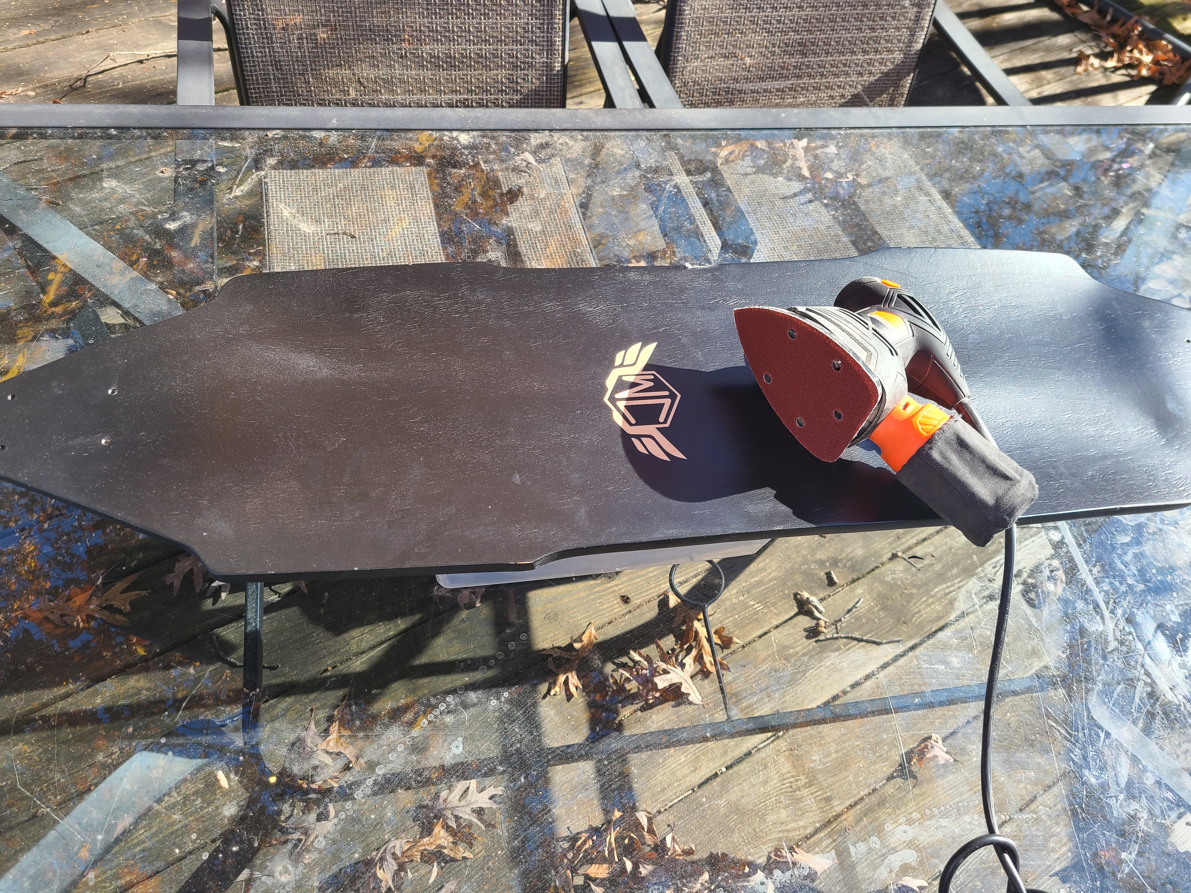

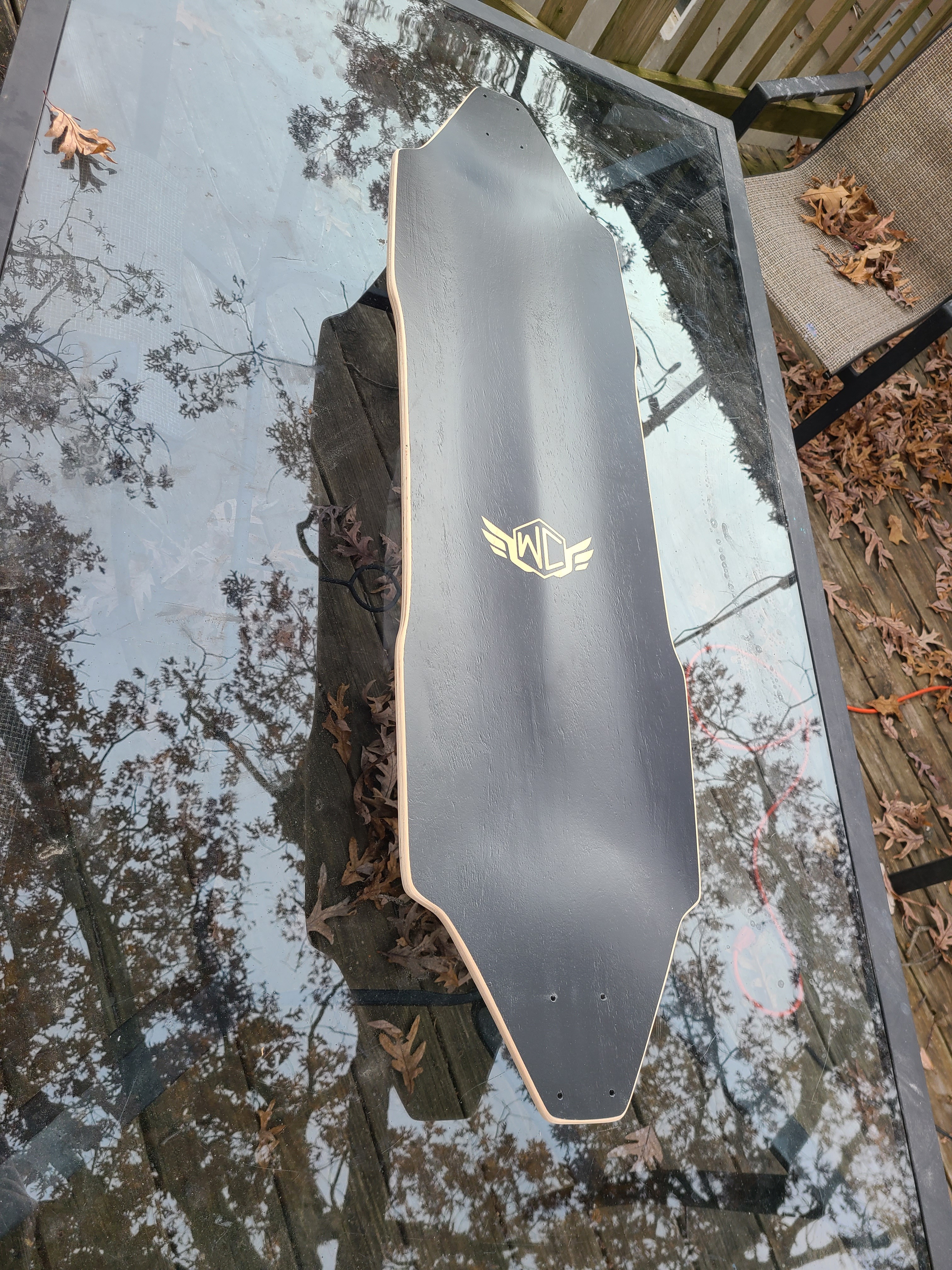

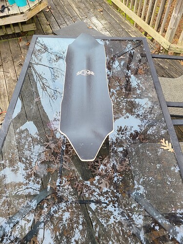

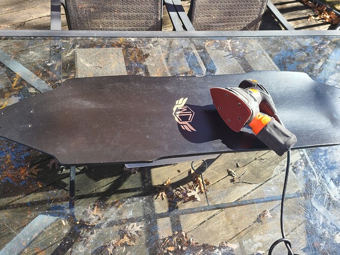

The deck came with the sides black and I wanted them showing. So I sanded it.

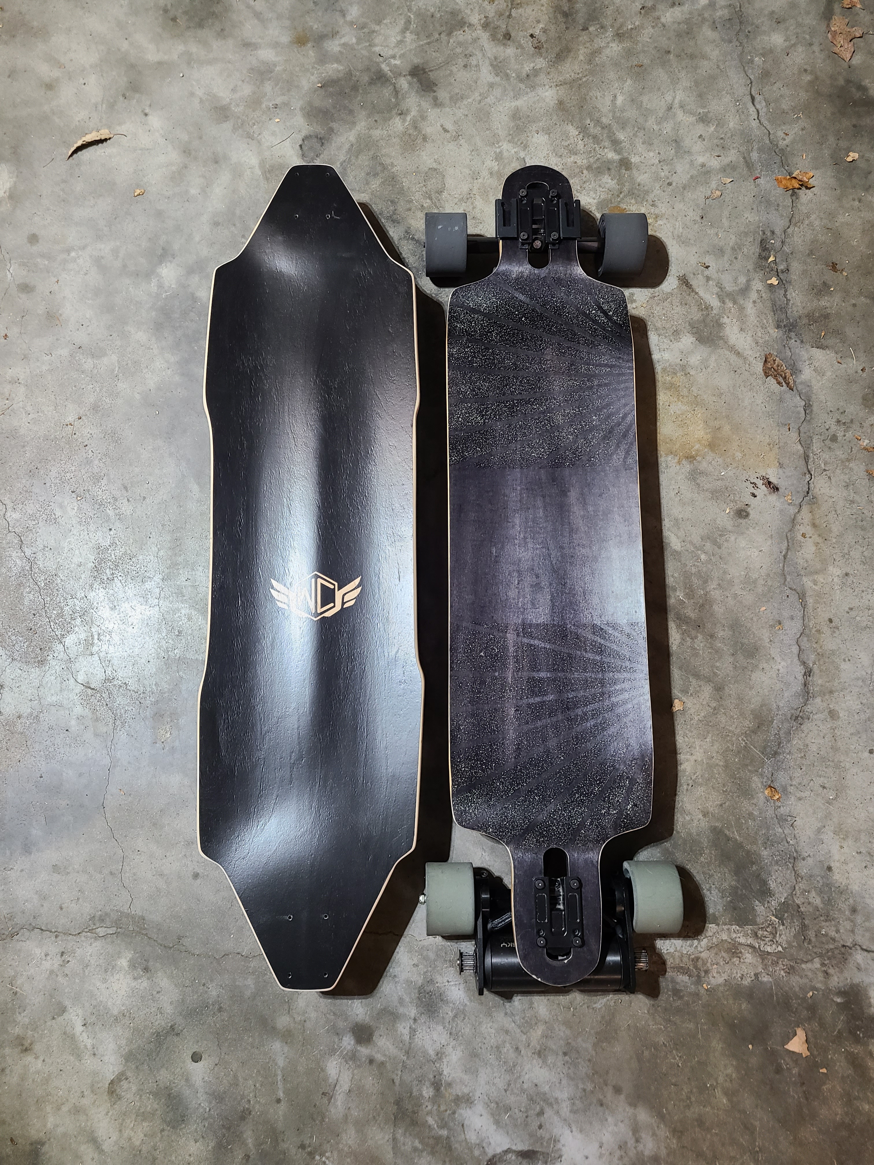

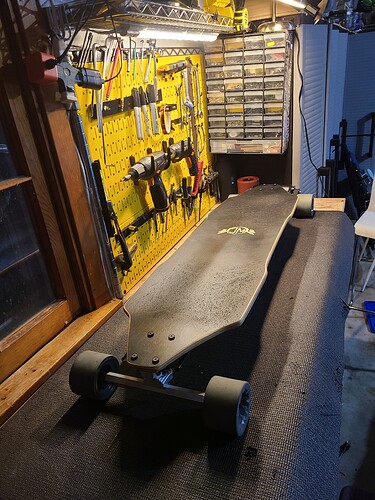

Here is the Llama next to a Demonseed 42 which was my reference for a giant deck.
I just used some black Lucid on the Llama.
I need to add some more.

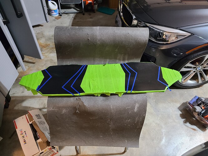

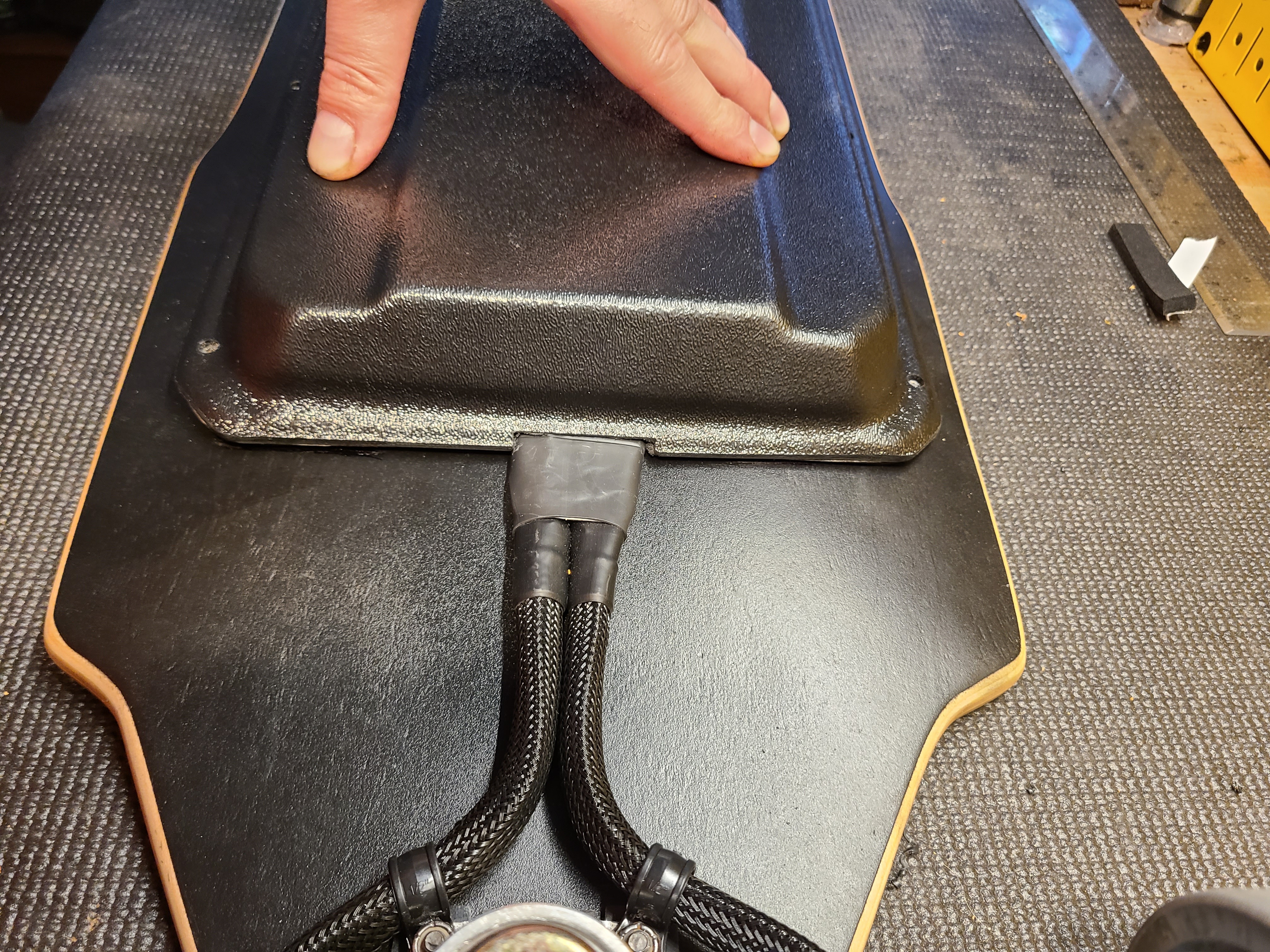

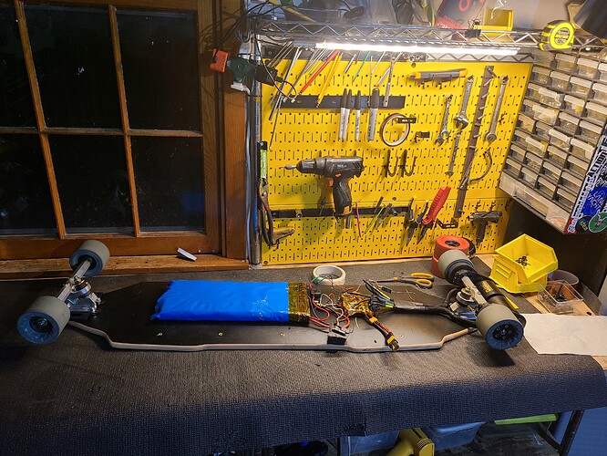

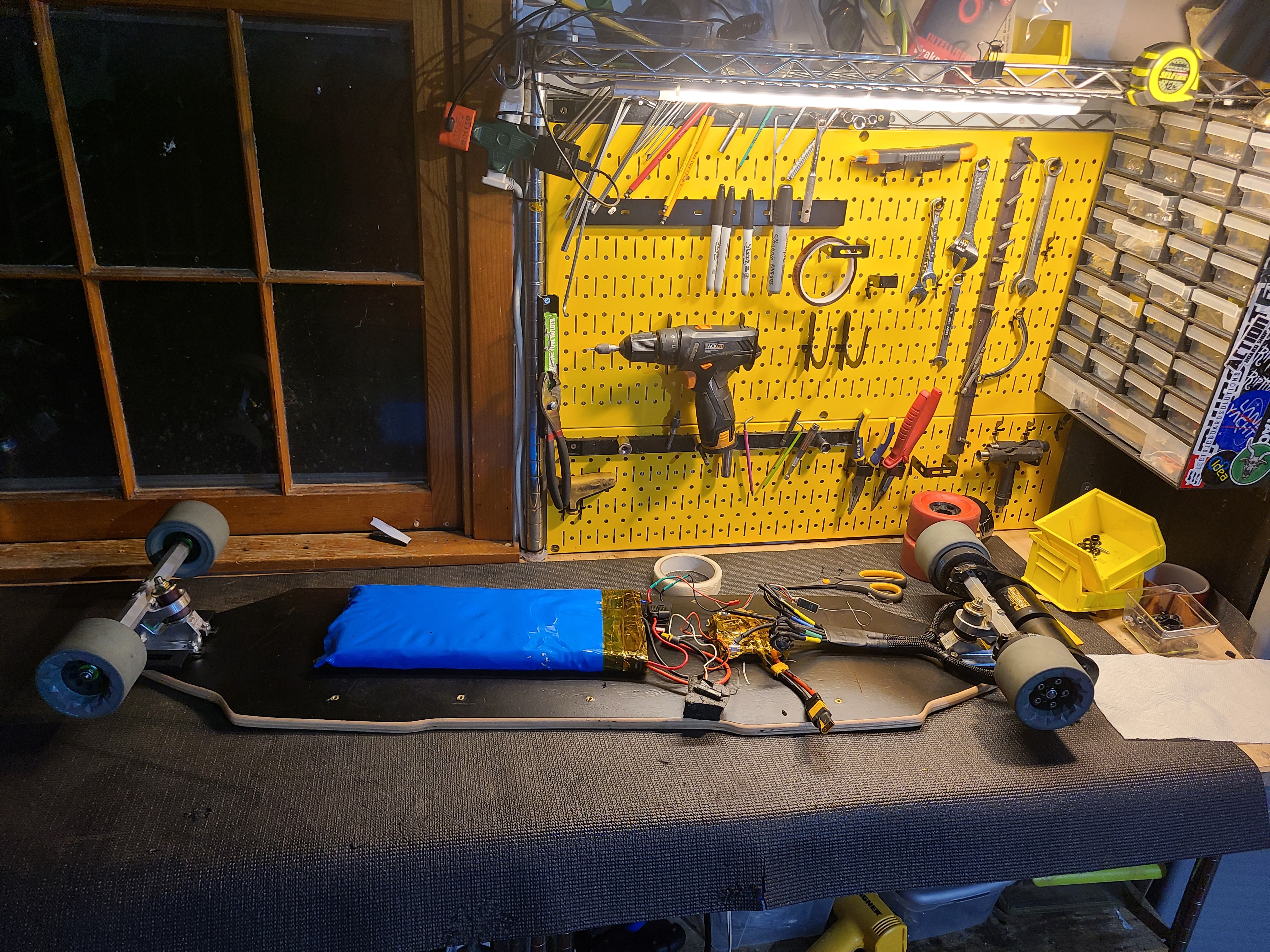

Here are a bunch of in process pictures…

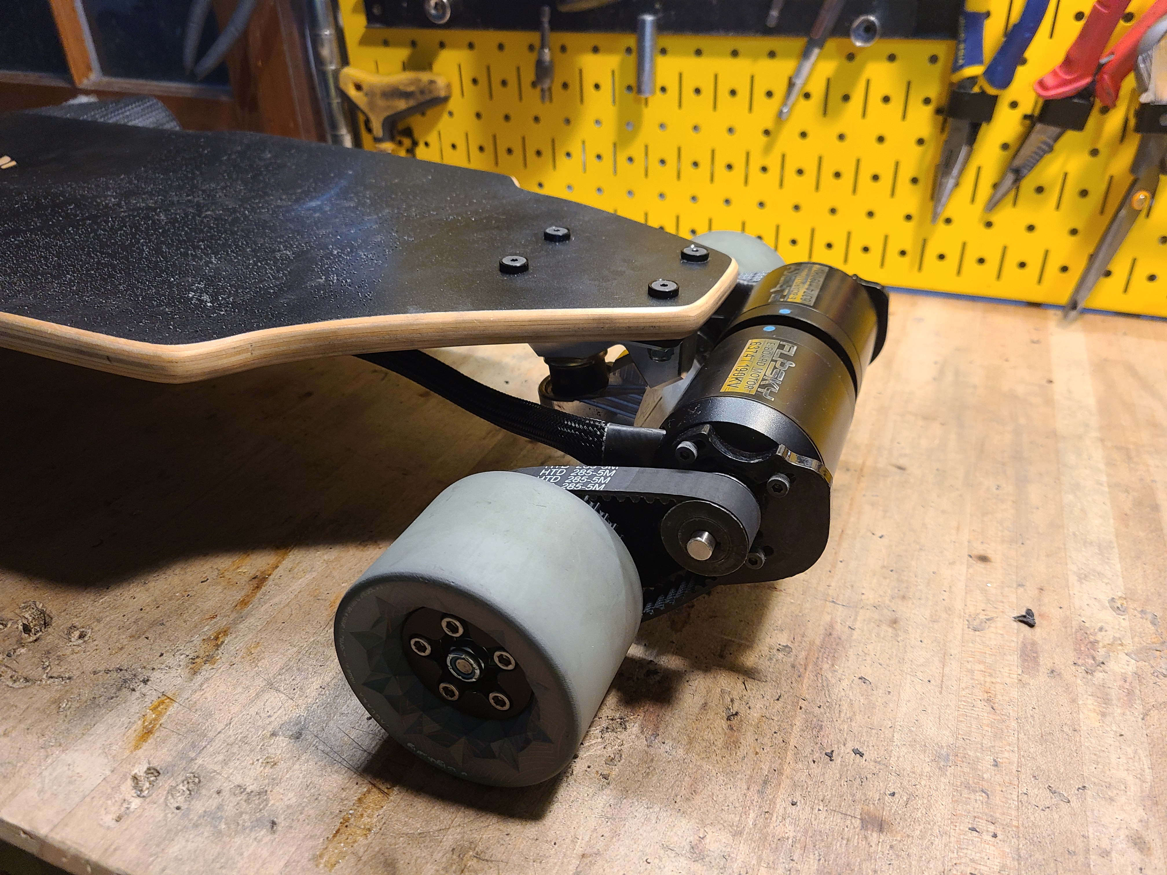

It turned out pretty fun to ride.
The trucks are neat as they are pretty different than rkp.
More carvy.
I expect they will bend eventually running on Caguamas and under my weight. But whatever. I will deal with it then.
The new flipsky motors ran well.
I already wish this had a bigger battery.
And I am already thinking of doing different stuff with it.
