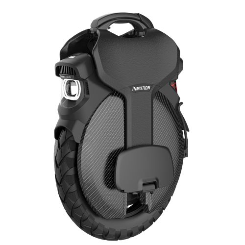

EUC ordered.
Inmotion V11 should be here Monday.
I am freaking out about not riding and moped enough that my wife gave me the green light.
It is pretty hard to navigate the EUC world and decide what to buy.
The V11 has been around a while, and hopefully it is less of a bomb than other EUCs.
But my main drive for picking it is probably because it is on Amazon Prime, and if it turns out I hate it, or can’t really ride it without hurting myself, I would be able to send it back.
My hope is that with the looking forward standing straight ergonomics, I will be able to get some miles in. And continue doing my physical therapy to get my neck back in good shape to ride sideways a bunch.

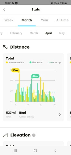

I am sure my wife noticed me not going on rides, and I even broke out the data to show what a dive my mileage has taken.

So the bell rang at 7:11 this morning, just after we had woken up.
It was Amazon with the Inmotion V11…
It was a big ass heavy box, and I probably hurt my back just pushing it into the Garage.
Fancy box…
Good packaging though. Solid.
It took a little bit to get it going as I had to fill 4 air chambers and the tire.
And half ass tape some pads on there.
After I had gotten back from riding the Omakase I started trying to ride it
And I ended up doing 4 miles over about an hour.
Top speed 12.6…
It’s hard.
First few times trying to go were hard…
But I managed to get going.
I still don’t know what to make of it…
Some of the turning feels neat and fluid.
Accelerating is weird. I keep feeling like I am going to fall off the front.
Then I took a break.
At lunch I went out some more in front of the house with the little dude.
Racked up 3 miles.
So 7 ish miles so far today.
Didn’t fall.
Didn’t drop the wheel too much.
So, so far so good.
