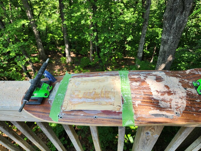

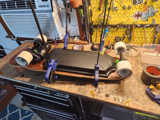

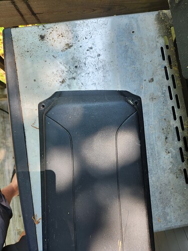

Water definitely got in there.
But I rode in a lot of rain so, pretty extreme conditions
But it is not totally clear the point of ingress.
I am going to try to seal a couple areas when I put this one back together.
And not ride in crazy rain…

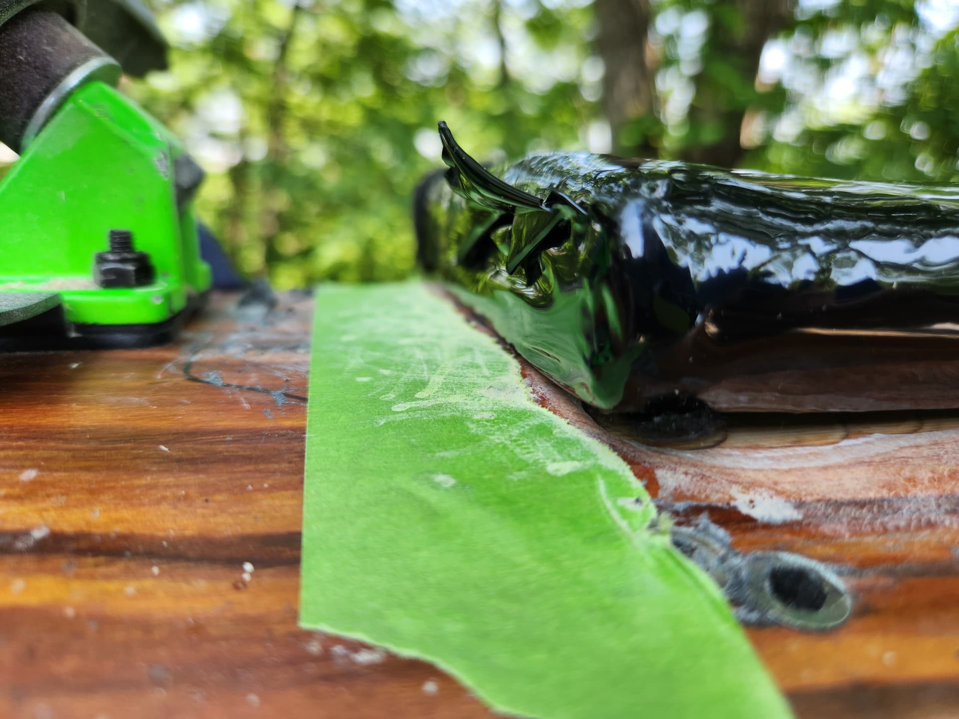

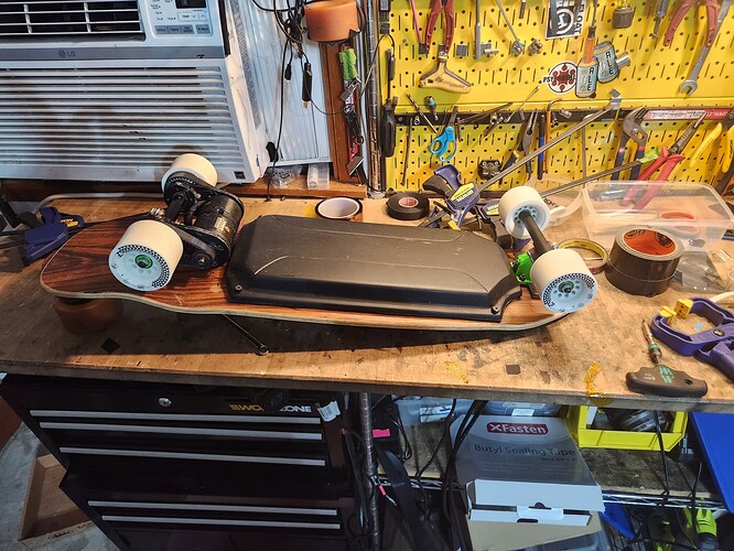

Sorry… I got updates from fedex…those sealing clay are banned good, they took it out.
Oh Man.
I will try to find something here locally.

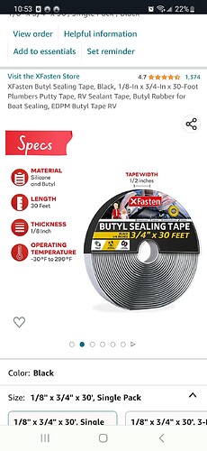

I was thinking about using Butyl tape I use for sealing my enclosures.
Is it difficult to get off if you need to get in an esc or battery case? I might get some myself if it’s alright. Haven’t got any experience with it
It’s difficult, but it’s possible.
It stays sticky and pliable.
I find it easier to take off than silicone, or hot glue.
That is why I like Butyl…since everything is temporary…
Don’t get me wrong. It’s a mess and a pain in the ass.
But it’s doable.
I’ve siliconed my esc case anyways so I’ll probably stick with it. No point taking it apart until something (fingers crossed it never does) goes wrong

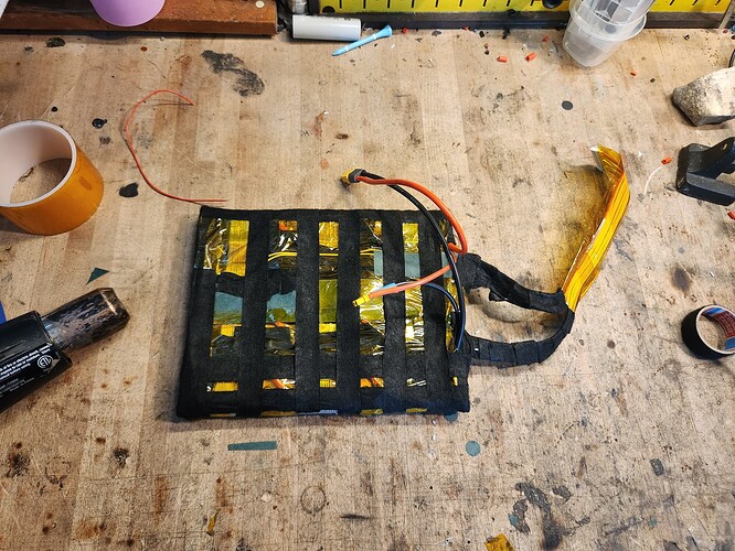

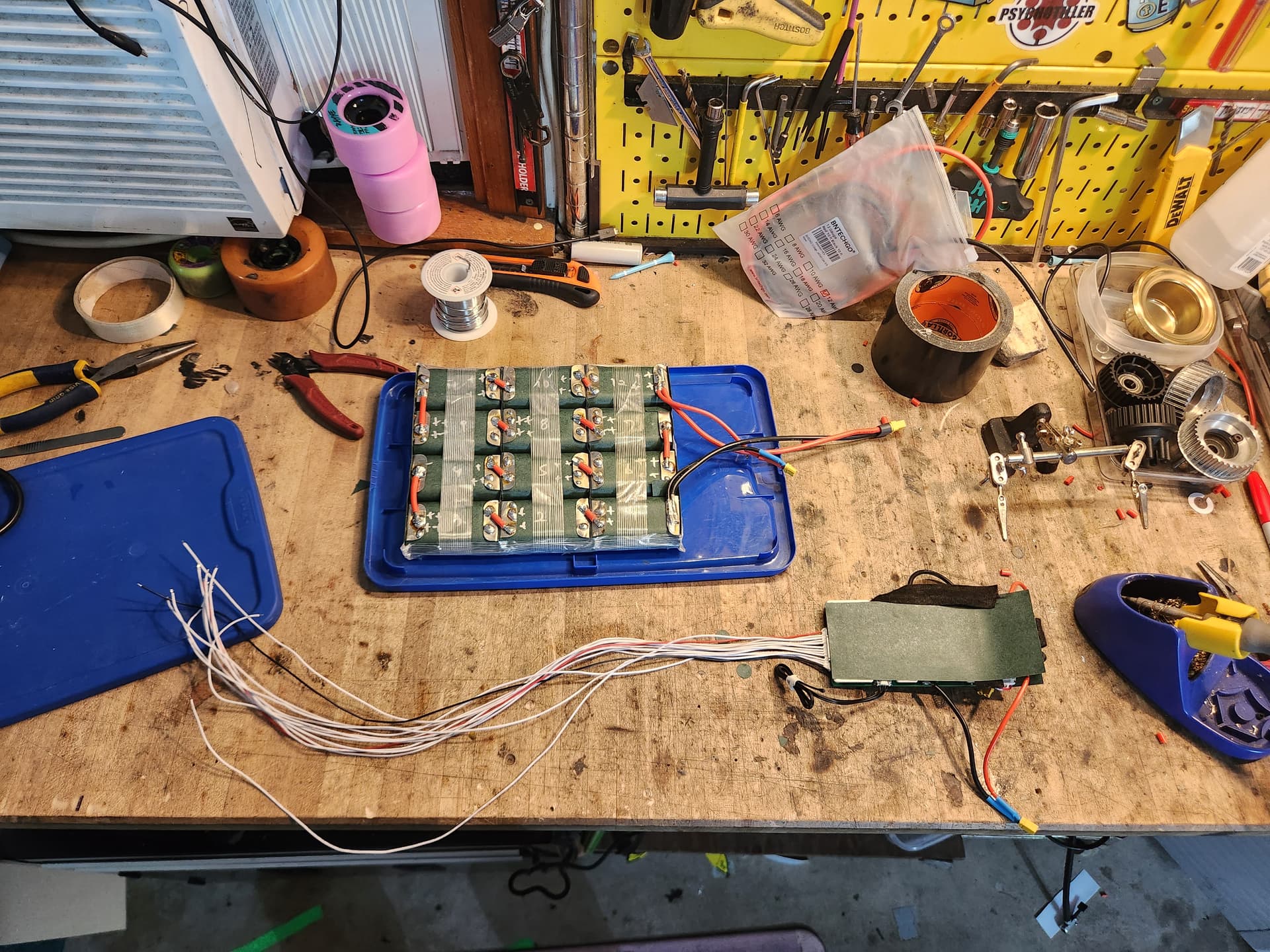

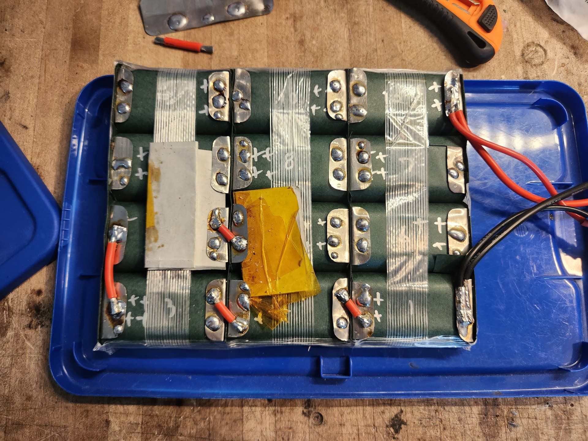

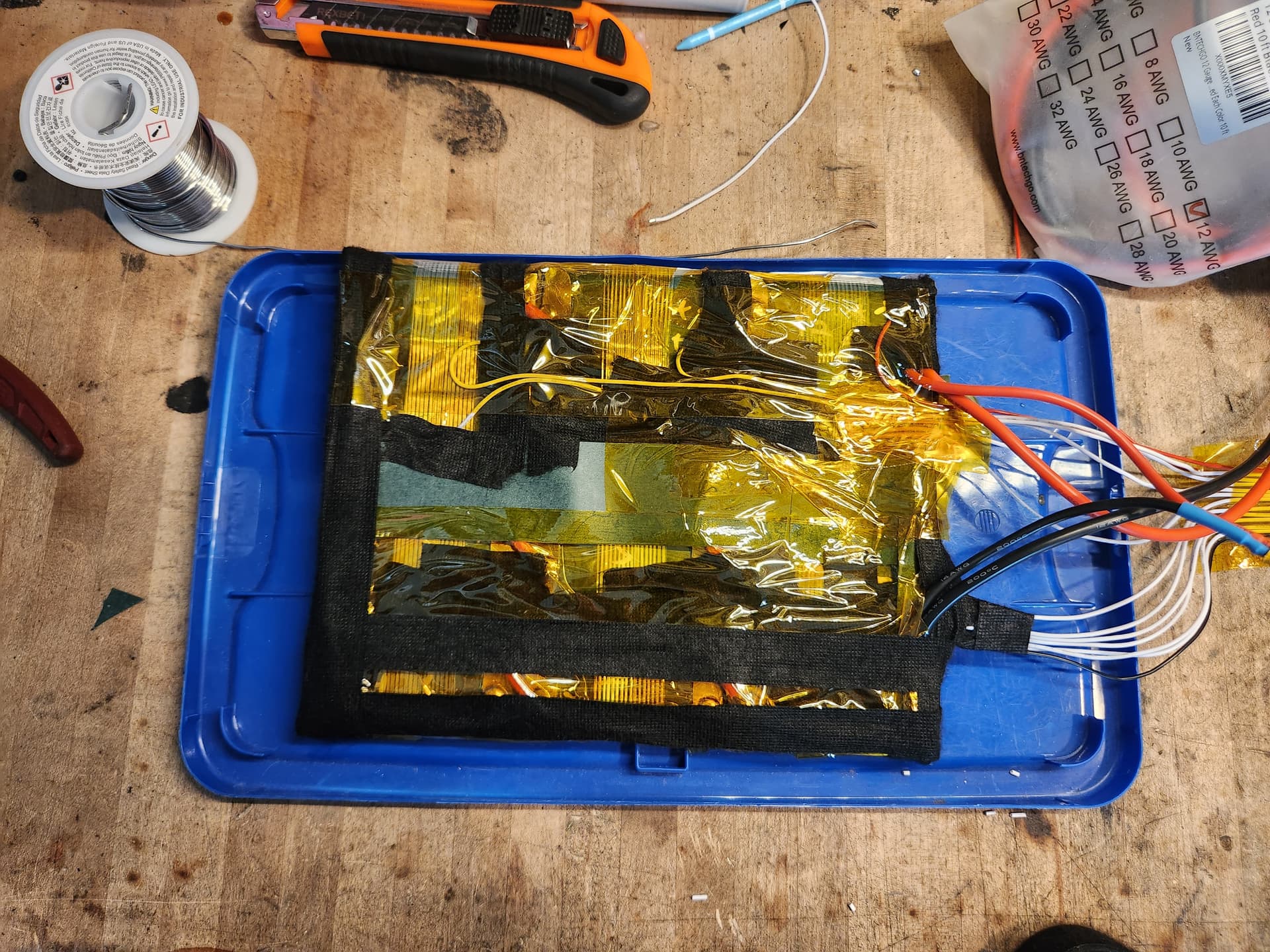

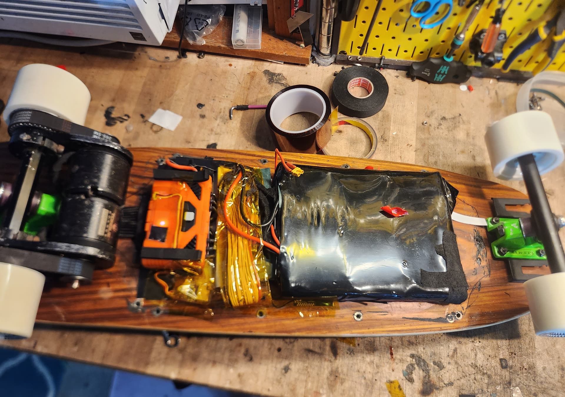

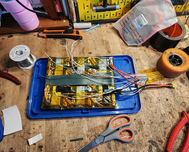

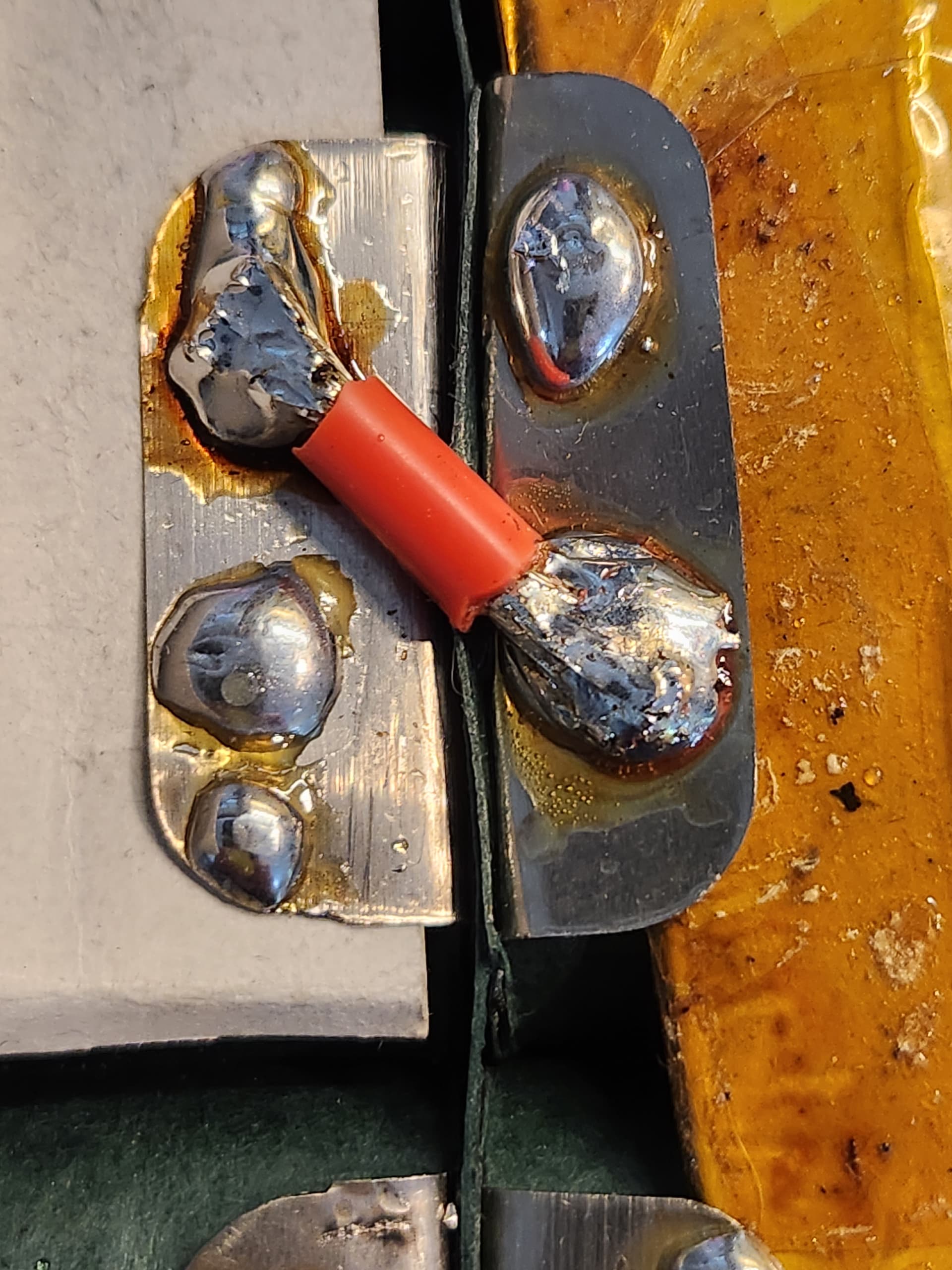

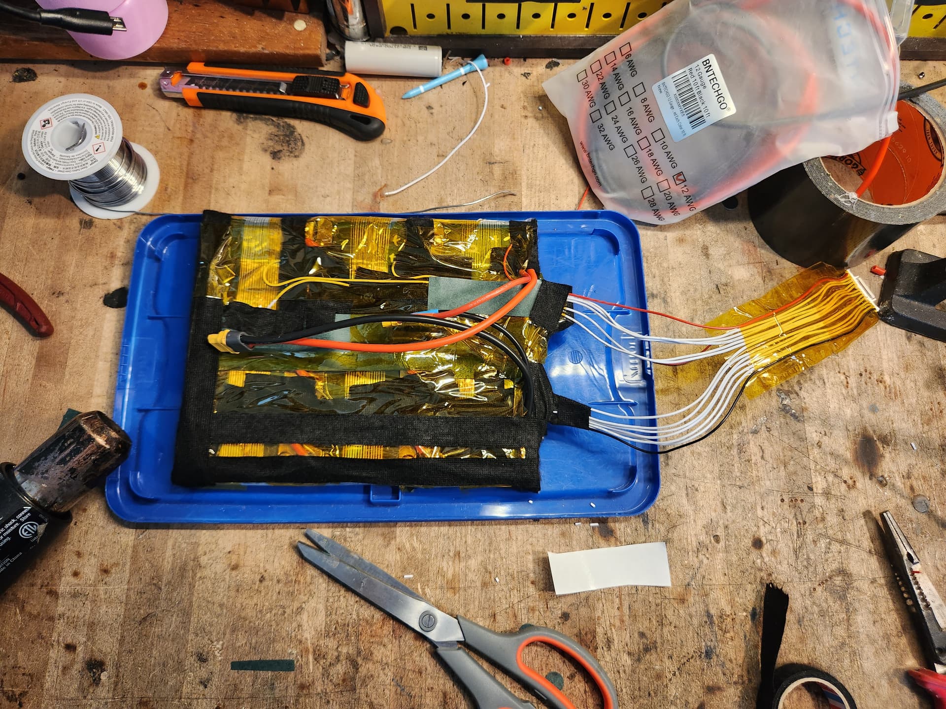

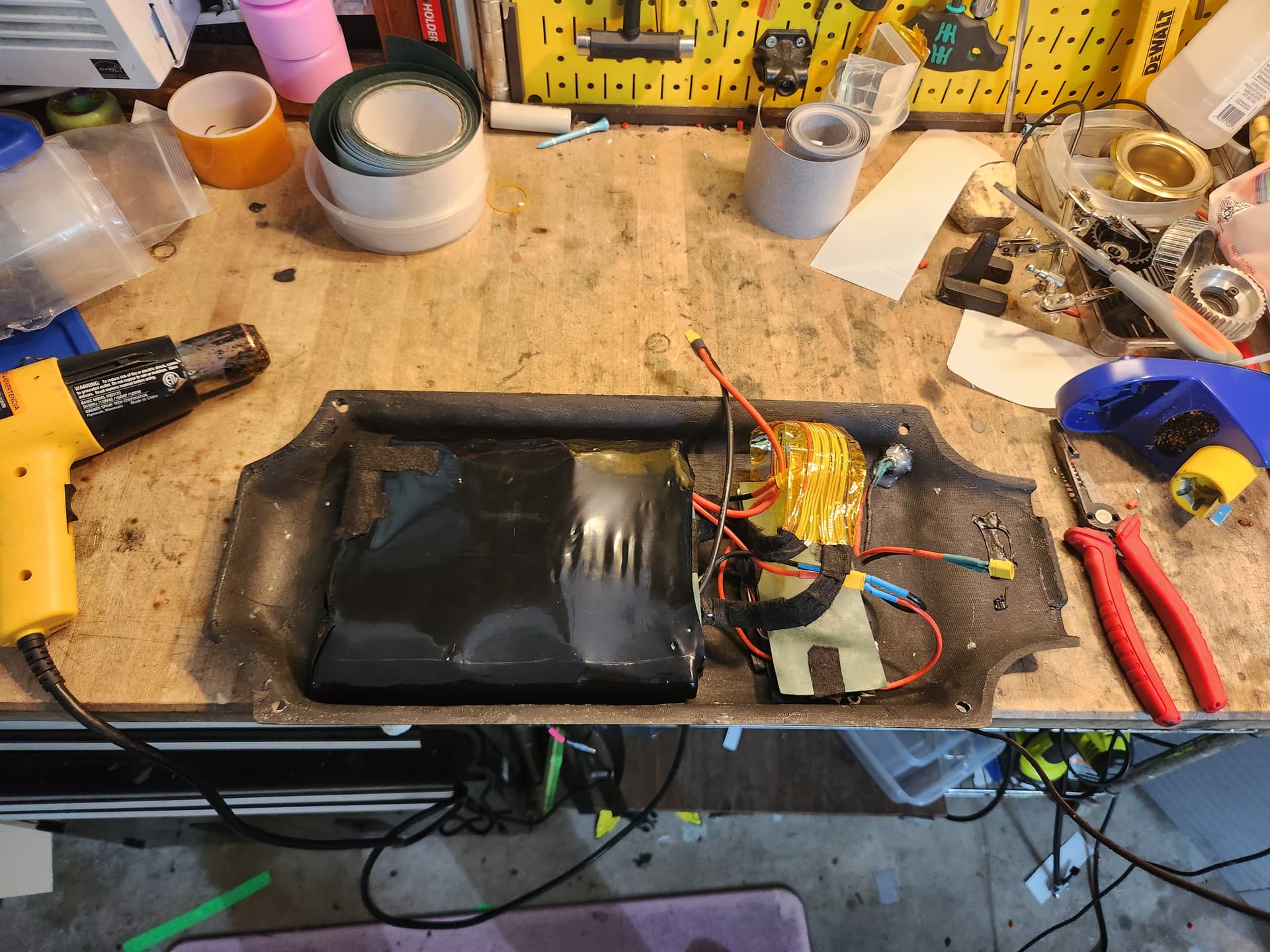

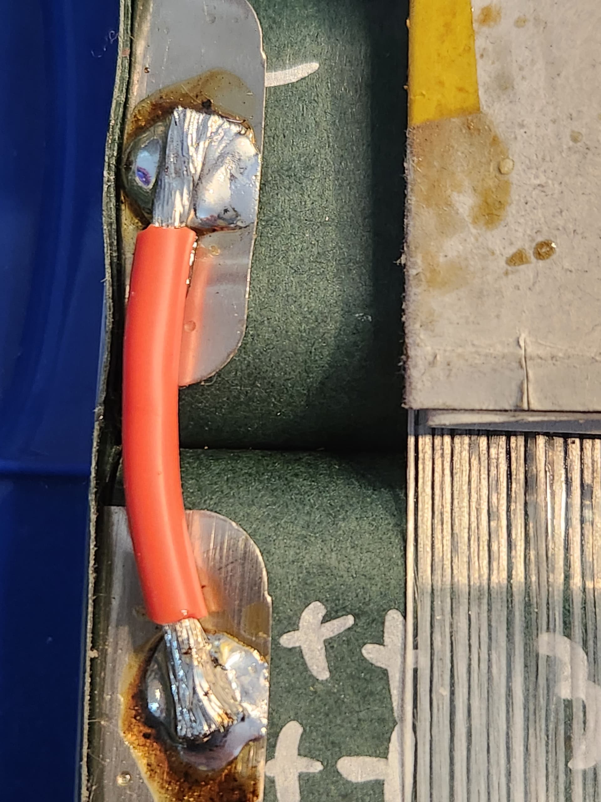

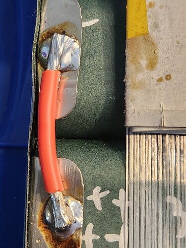

Today I did some work on the Omakase battery.
Took steps 6785 to 9023…

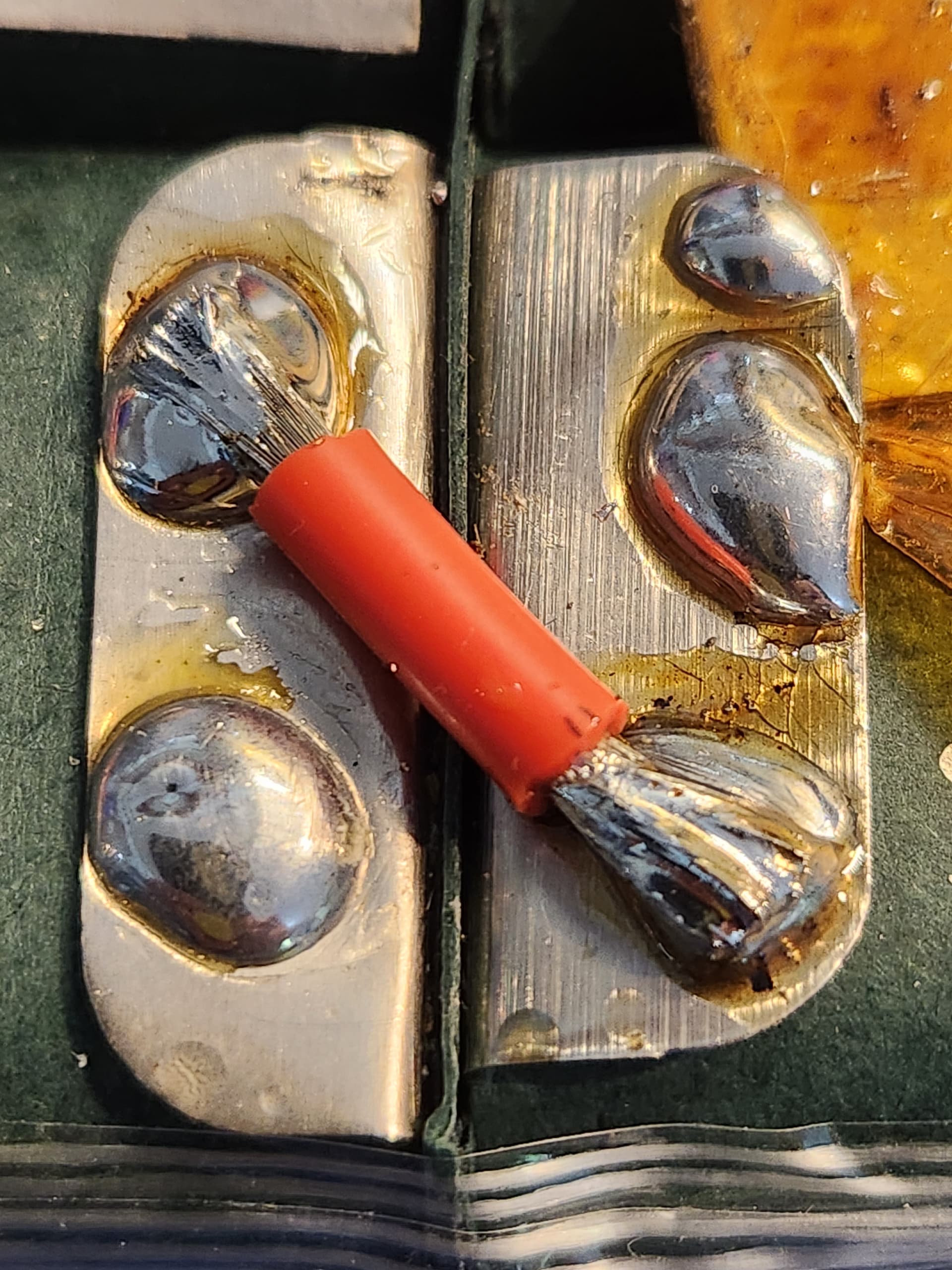

Soldering…
Adding the tiny BMS wires.
Exploding with Joy to see it’s alive.

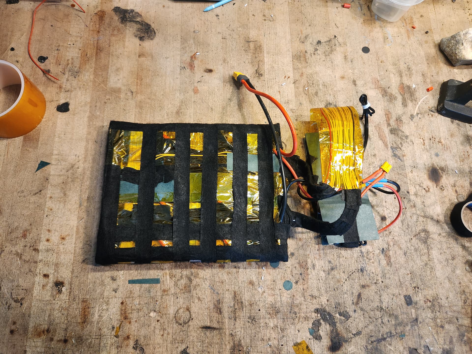

And adding more tape

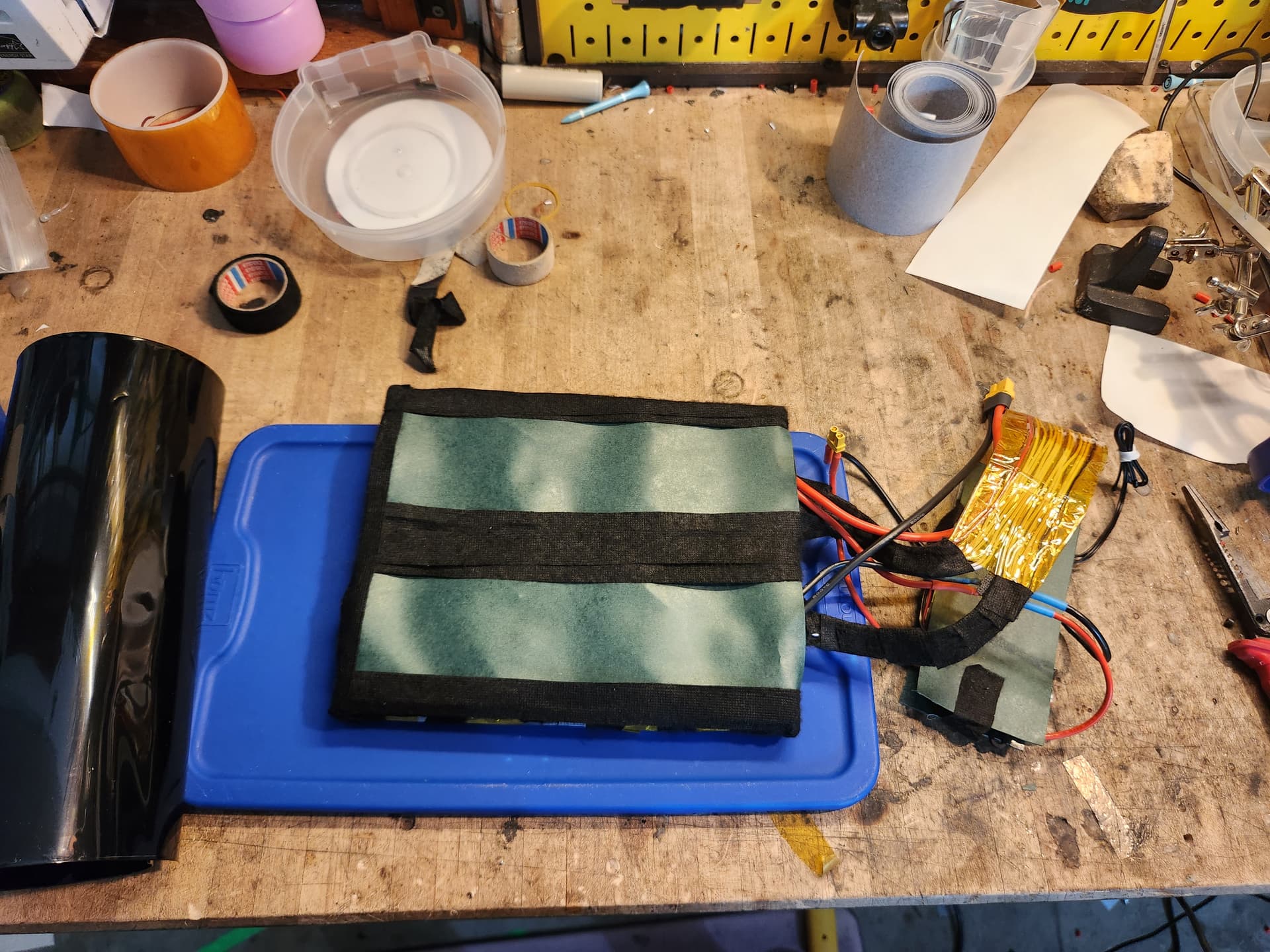

And fish paper.
And more tape.
And heat shrink
And…
It is not pretty…
But should be robust.
It is nice to get to this point…
But man. Wow. It’s a lot of little steps.

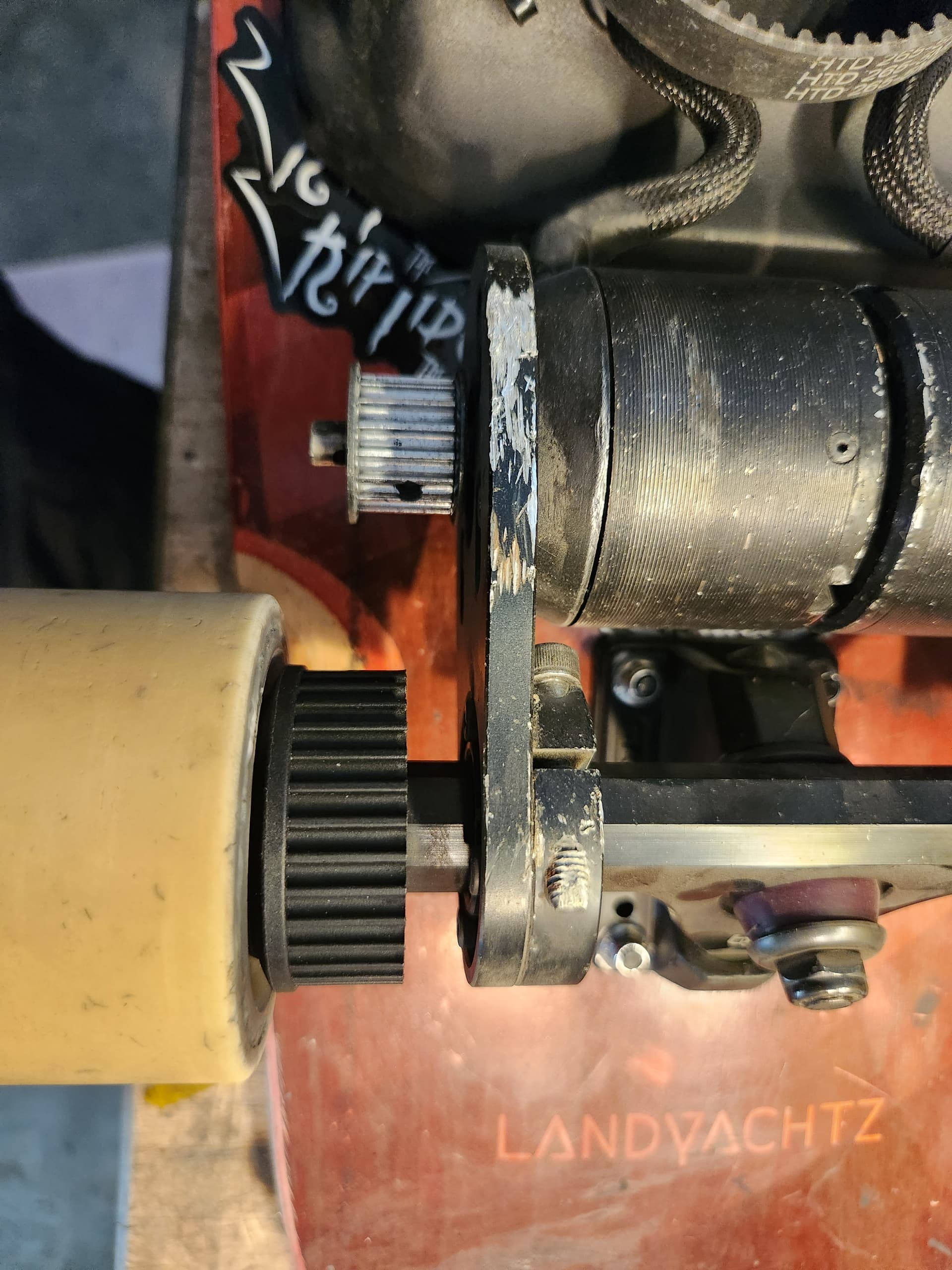

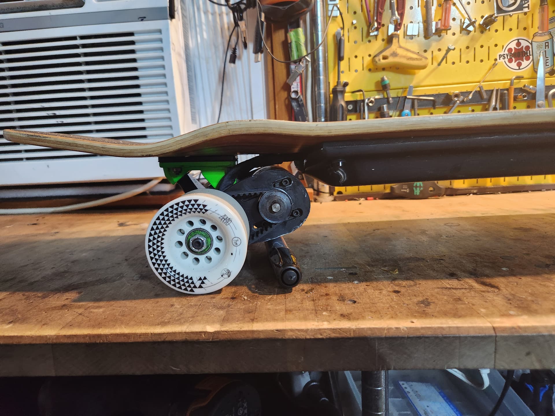

Not really trying to do anything hard today, but I did pop the Rally Cat on the bench.

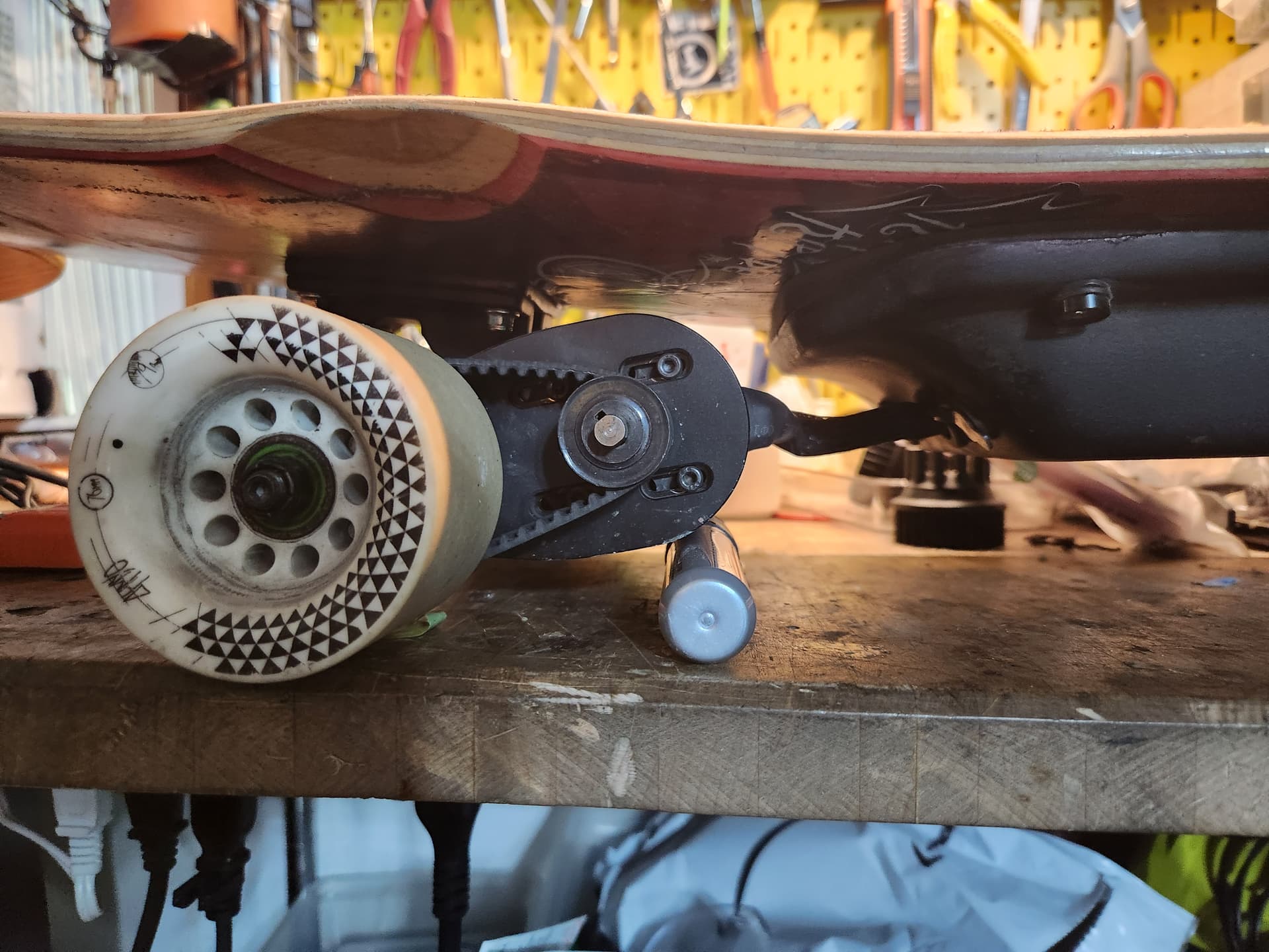

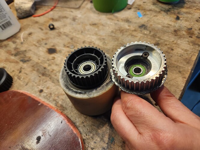

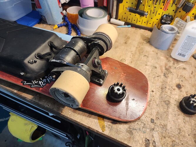

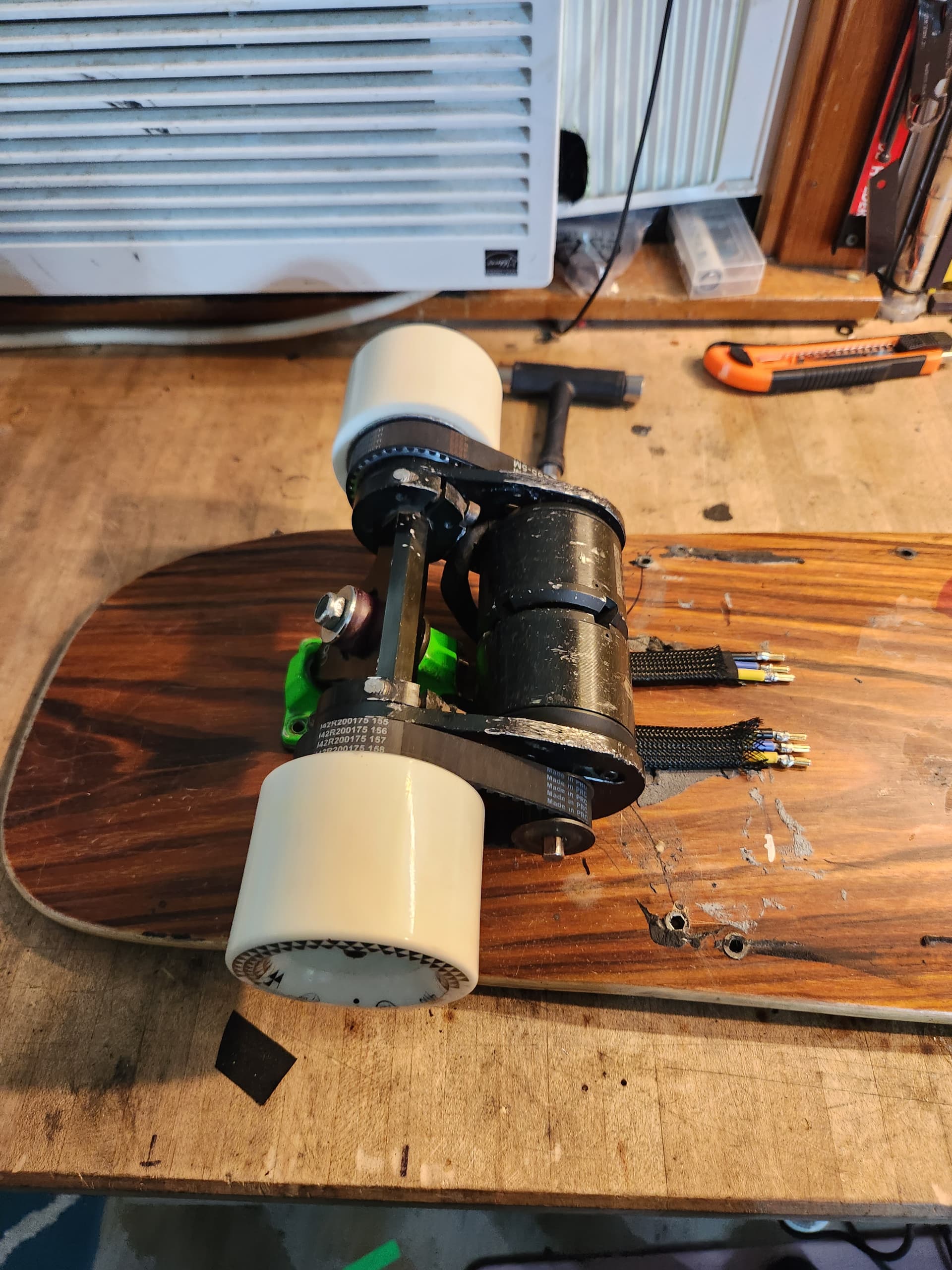

@glyphiks made me feel bad about my Akashas set up with 36 tooth BN pulleys.
So I ordered the Onsra 32 tooth. (I think these may be generic. I don’t remember my evolve ones having 2 bearings like these do.
I am trying this on the Rally Cat because is has the narrower FR variation of the Akashas.
Shout out @Razillian for making these happen.
In all fairness Al has a Point and this is kinda crazy.

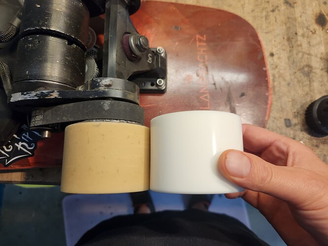

And the onsra pulleys fit well.
But I won’t be using them…
The bearings stick out more than the BN pulleys.
So I would have to move the motor mounts out.
And I am not going to there. I harassed Kevin a bunch to get these 170mm axles so the 6354s sit close together.
So yep.
You guys know I am not all that big on clearance…
I do think It would be possible to use these pulleys with the DH Akashas if you rock them backwards.
I might go through the trouble of trying that on the Demonseed.
Or maybe not…

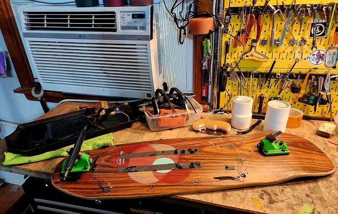

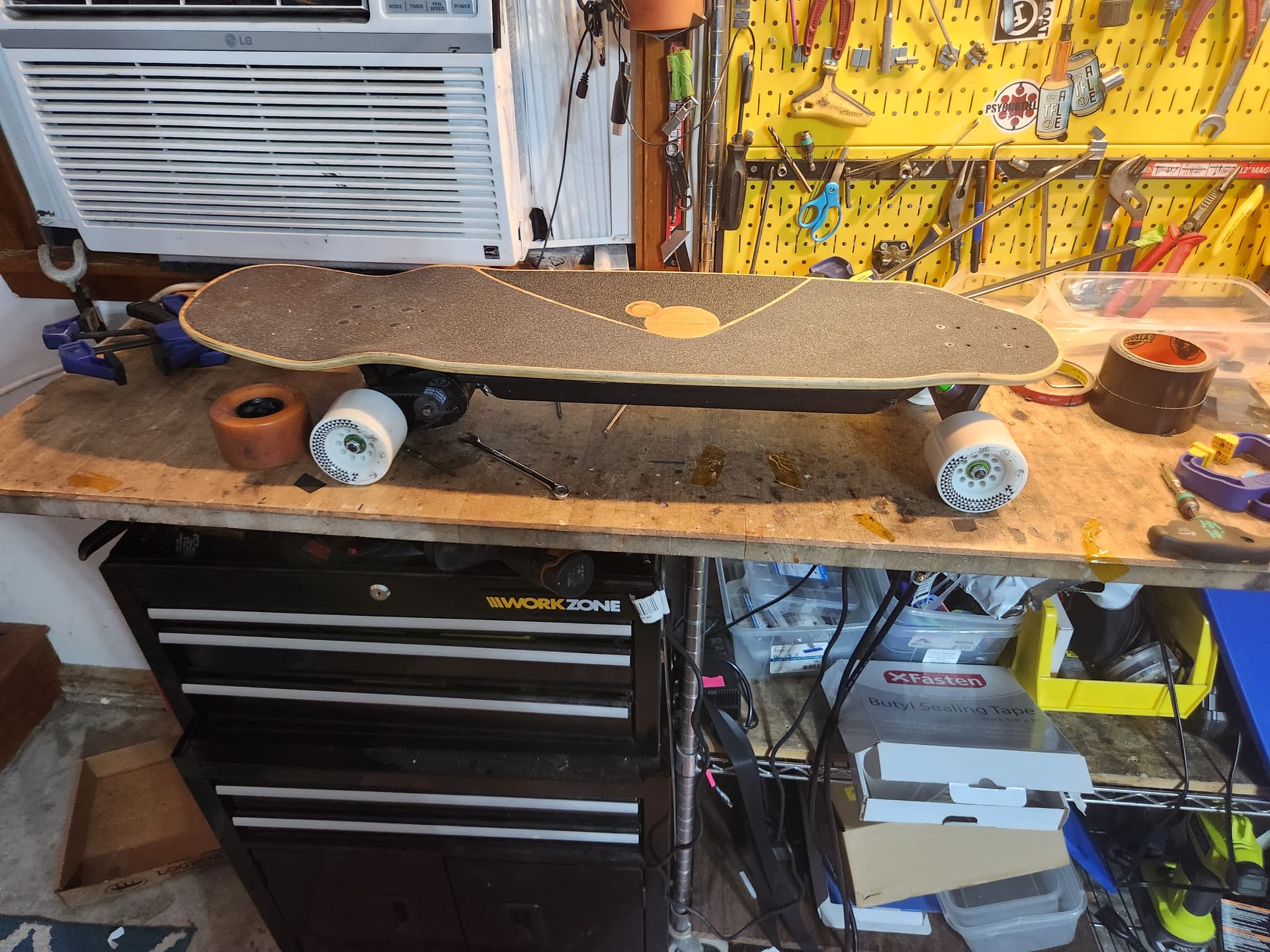

It’s time for me to start thinking about putting the Omakase back together.
It’s all there.
I am looking forward to how this will turn out.
But I want to clean up the motor cables and maybe get a better angle on the mounts.
So it’s not going to be just putting it back together…
I might have a bunch of work to do…
So yeah.
There is a few things I need to figure out.

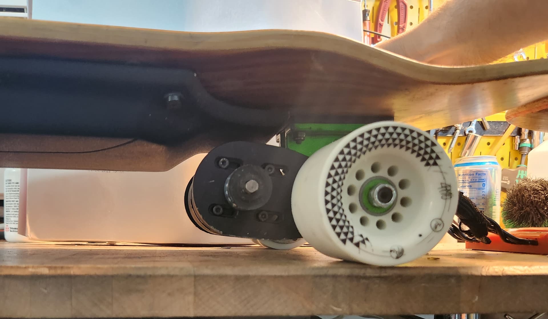

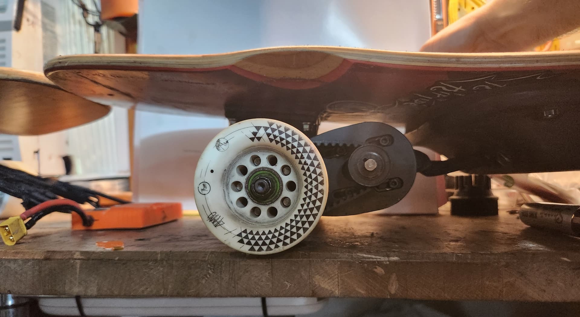

One is moving the motor mounts…
No clearance is the price you pay for Akashas.
And I am glad to pay that price.
The Rally Cat is gnarly.
The Omakase is looking worse…
So I have to mess with the mounts.
Its not going to get much better.
But I can’t leave it alone.

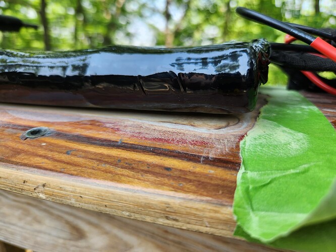

The other challenge I have is the battery is a little thick…
I used a sheet of ABS to give it structure. But adds thickness.
So I will need some gasketing.
And I am slightly tempted to route a tiny bit of the belly.
It sure would be sweet if it could be like this… Sitting flush.
But that’s never my luck.
I’m not sure what I will end up doing.

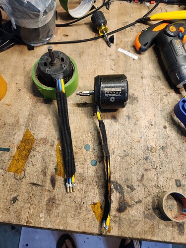

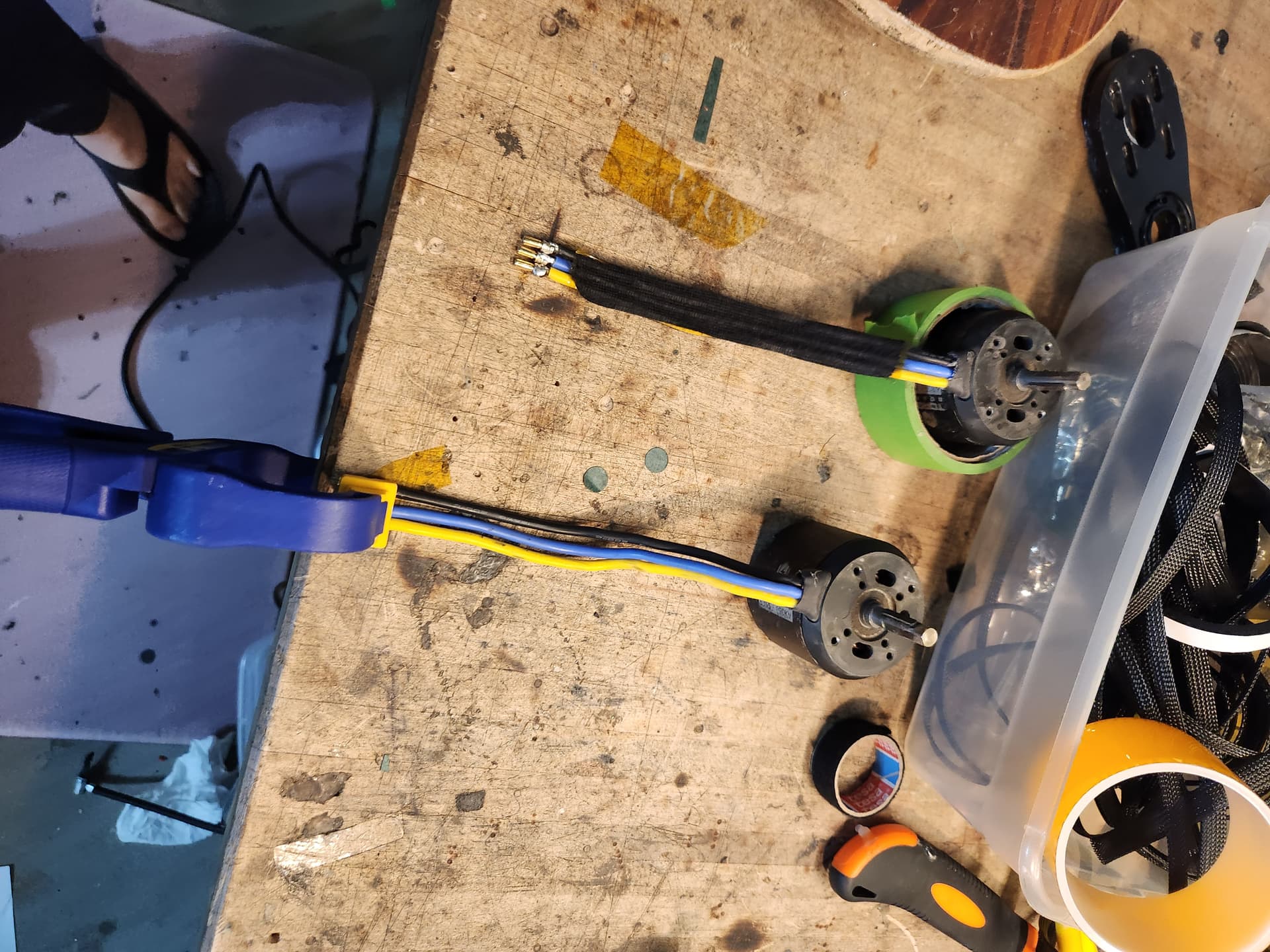

I separated the motors from the Unity.
This is an old one with the thin cables and the 3mm bullets. Which I used here.
I wonder if the 2 I wrote on there means it was the second one I got.
It’s nice to see a preview with the shinny new Akashas even though I have a long ways to go

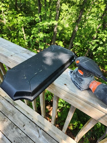

Yesterday I got up ready to fuck shit up on the Omakase!
And I messed with it throughout the day.

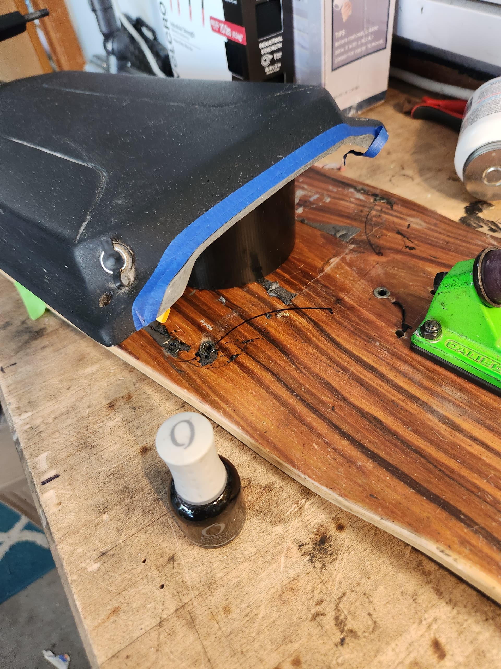

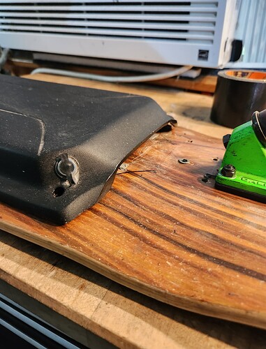

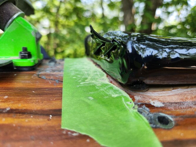

1st I hacked off the tail of the enclosure.
Crooked as hell… Lol
So much sanding ensued.
Turned out ok.
I used nail polish to coat the cut edge. I did not want to mess with a rattle can.
I am totally happy with how it turned out.

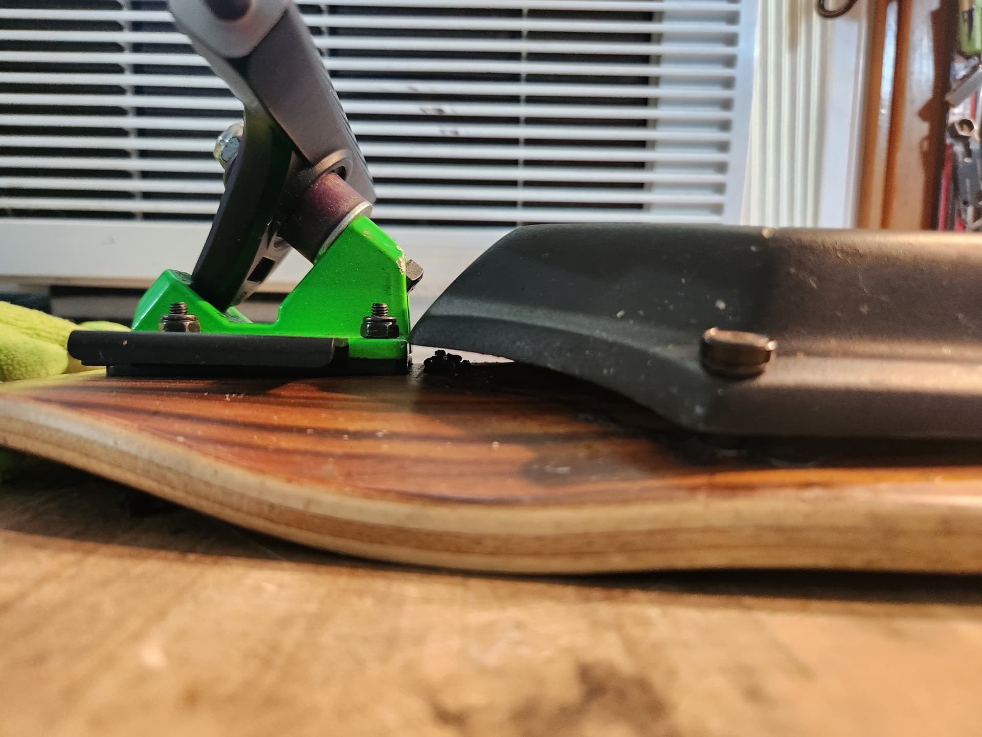

Then I proceeded to carve out a mm or 2 off the Omakase…
This is probably pointless.
But I did it regardless.

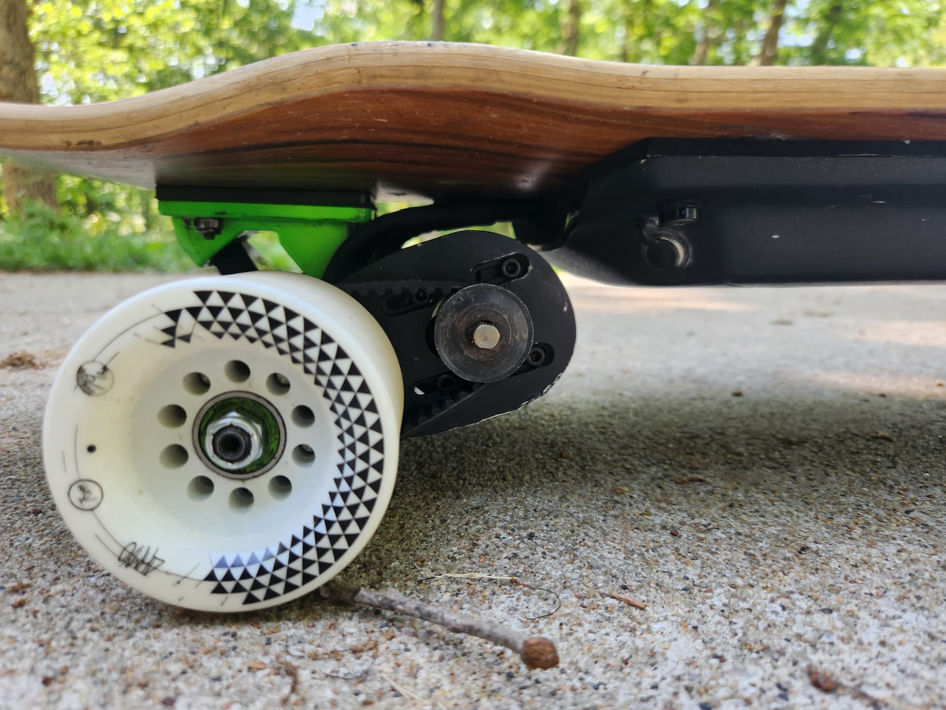

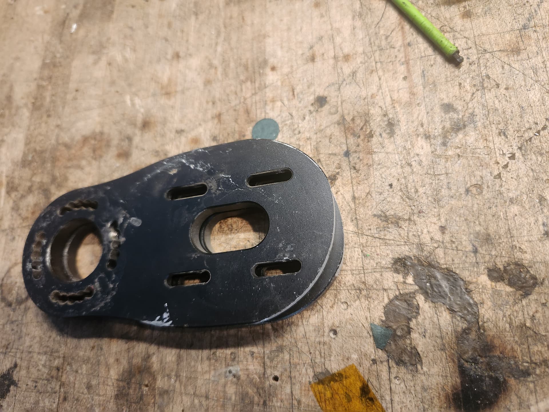

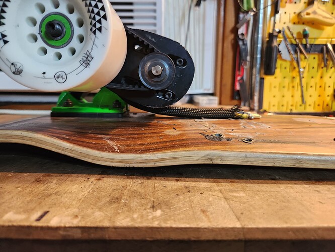

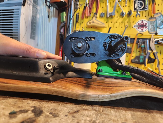

Later on I got to looking at the mounts.
I have way more space to work with and could move the plates one hole down.
Which was nice not having to drill out the plate to fall somewhere between…

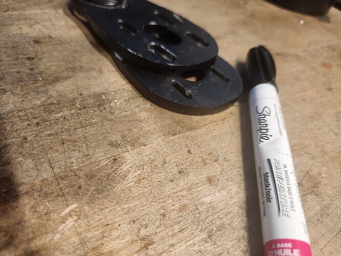

It would hit the enclosure on a hard lean so I decided to grind the plates a tiny bit.
The grinding was done this morning.
I just used a paint pen to go over the bare aluminum.

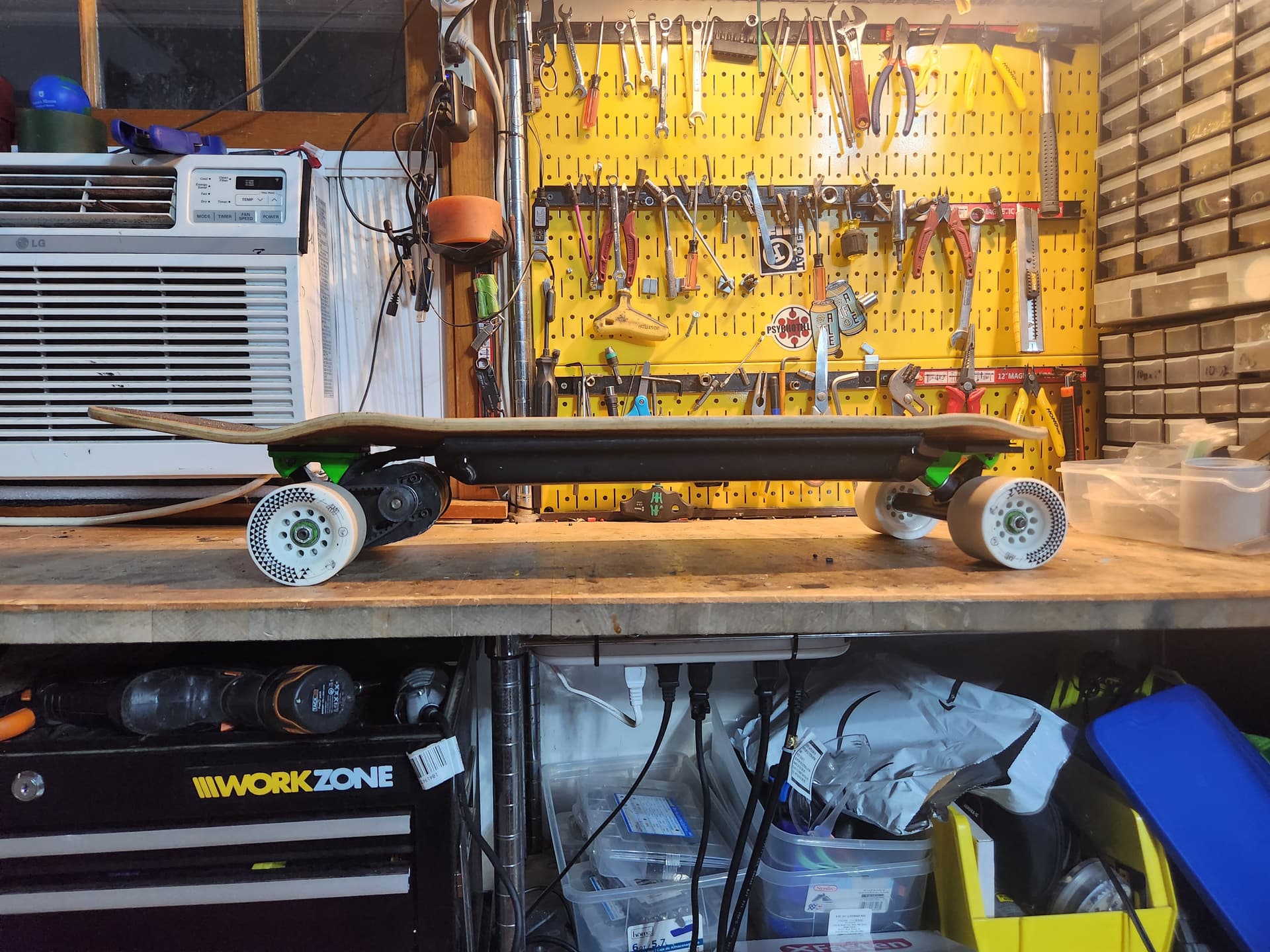

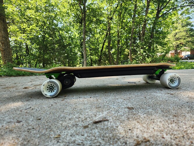

I got the Omakase buttonned up yesterday.
So far I had gotten to where I shaved the mounts.
Another Z-mote comes to life.
This is the last one I had planned on installing and makes it 8 total.
Still love the lights.
20230522_221738_1

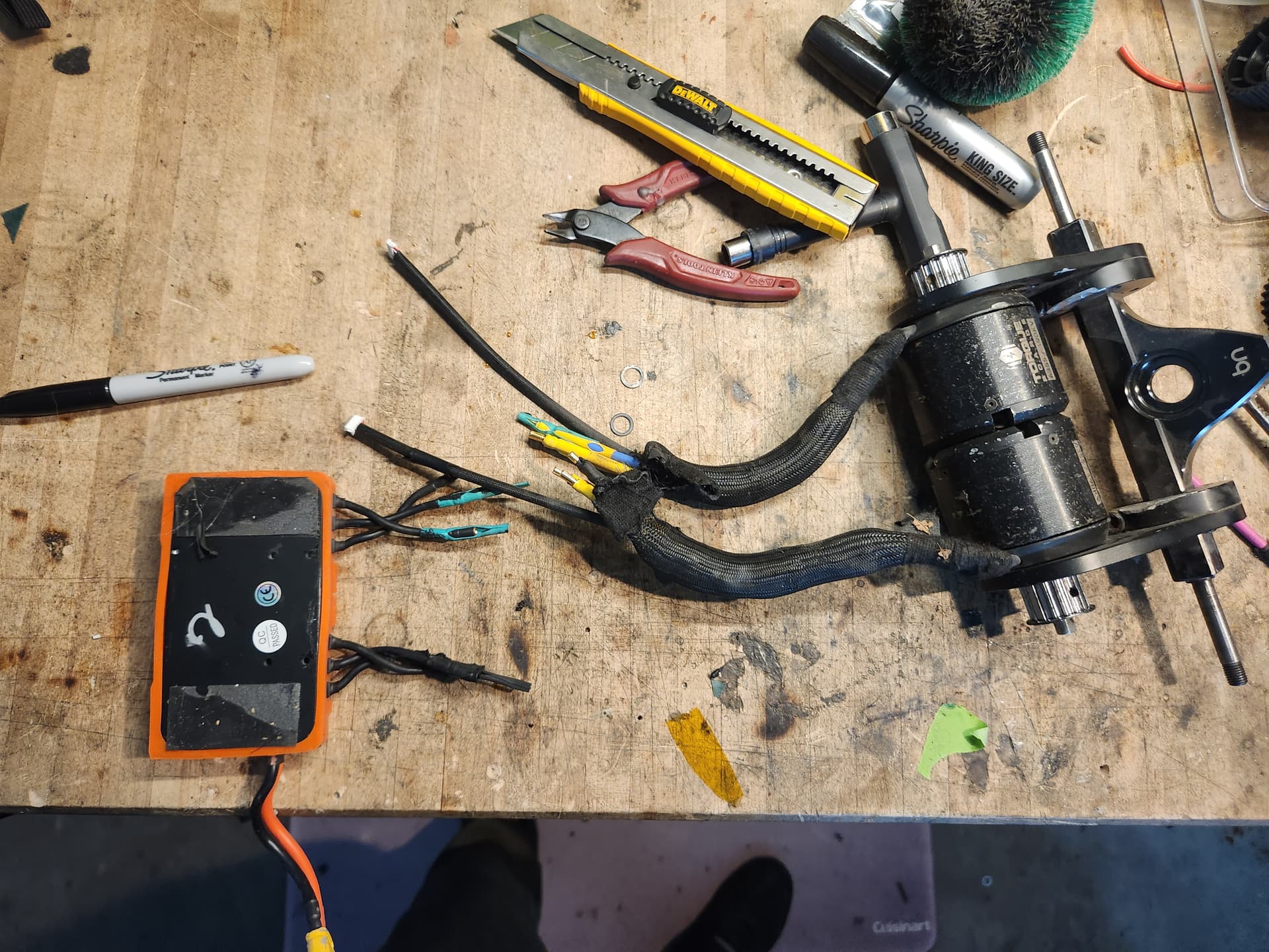

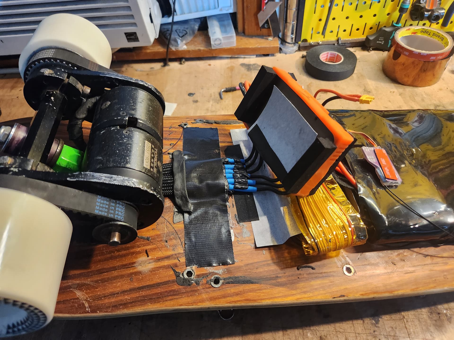

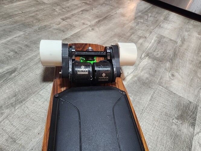

Then I wanted to make the motor cables a flat ribbon.
I could not really do the same thing as the Rally Cat with the cables to the front of the motors.
So I battles with going to the back and under the motor.
I have a couple layers of Tessa tape. So even if the motors rub I doubt they would rub through…
The motor cables were too long instead of cutting and resoldering I decided to turn the Unity around.
Then I decided to o elevate it and run the cables underneath.
Taping everything down. Never pretty. But everything should stay in place and is well insulated.

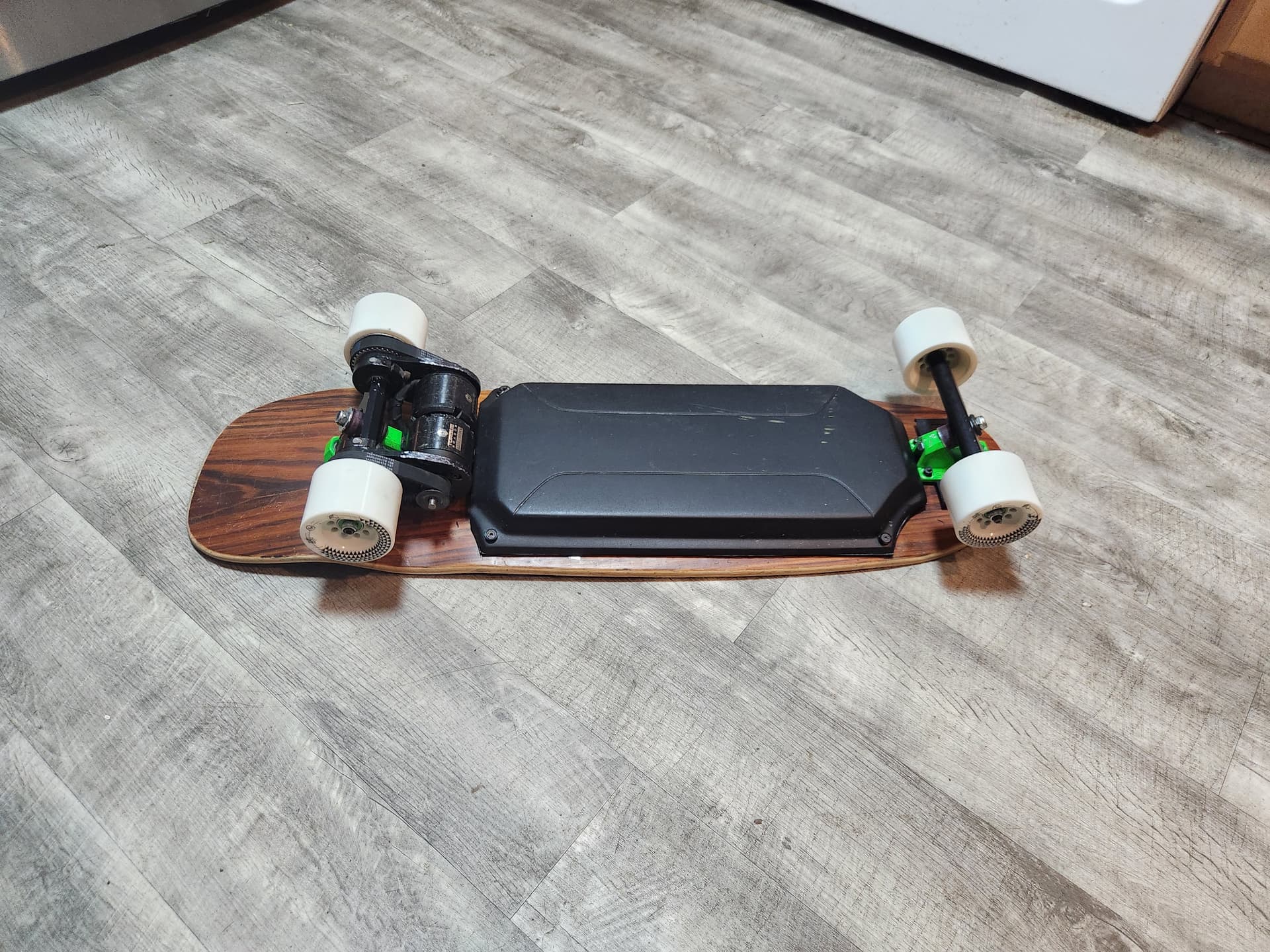

And finally lining up the enclosure.
I did different pieces of gasketing similar to the Rally Cat. Thicker on the front and back.
And boom.
It’s such a pretty board.
I love this enclosure.
And I love the shinny new Akashas.
The motor clearance is super good. For something like this…

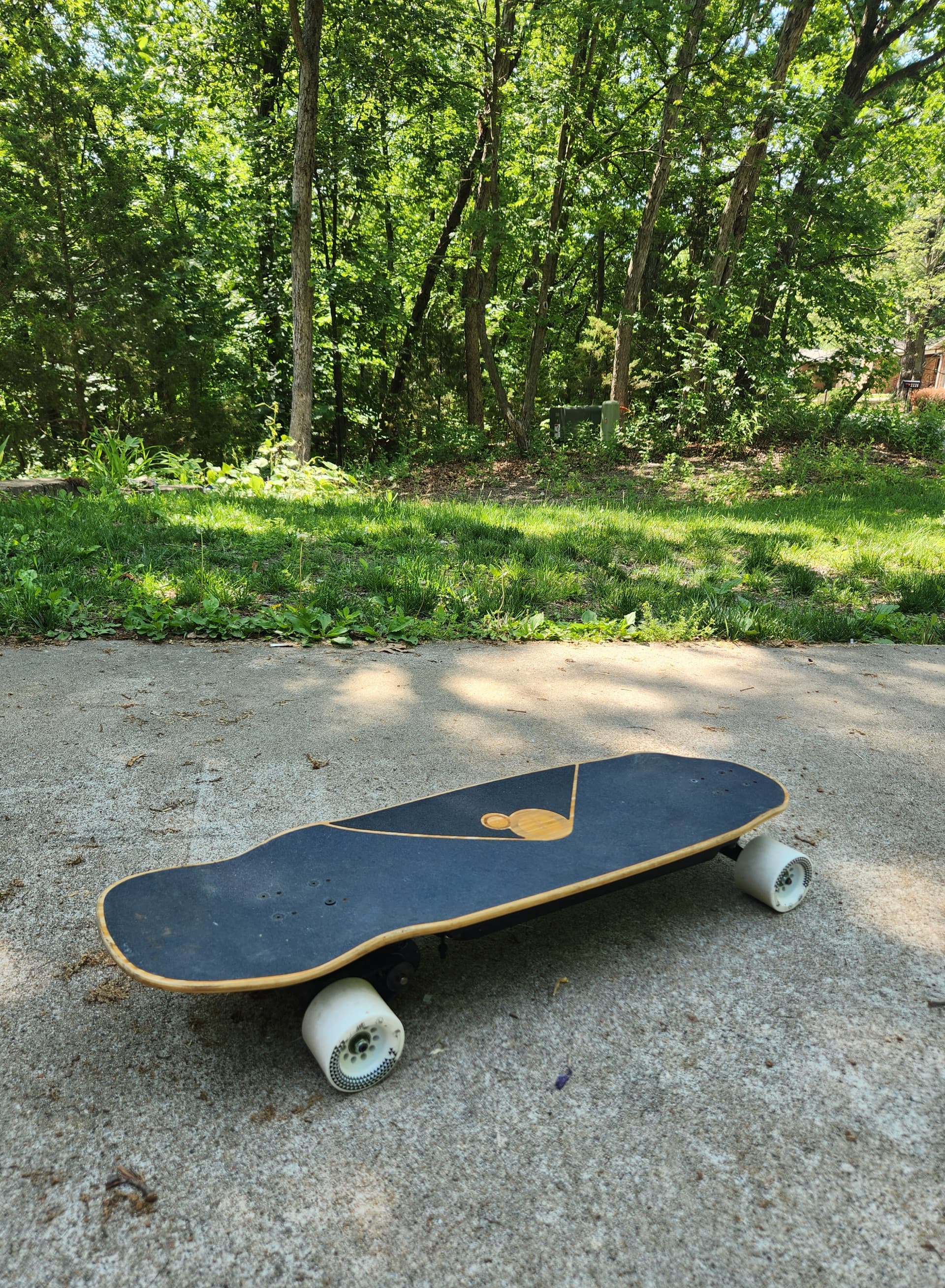

And wow. It had been a long time since I last rode the Omakase.
And it felt amazing. It’s big, but it feels little.
It’s perfectly comfortable.
Power and Carving felt awesome.
I only got up to 25mph.
Akashas man!!!
