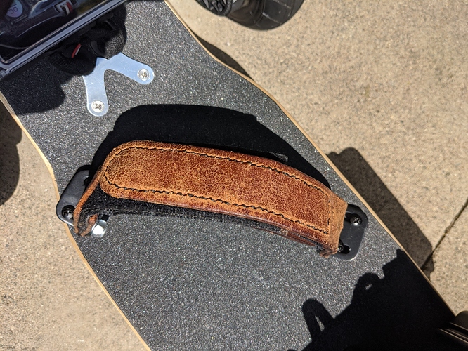

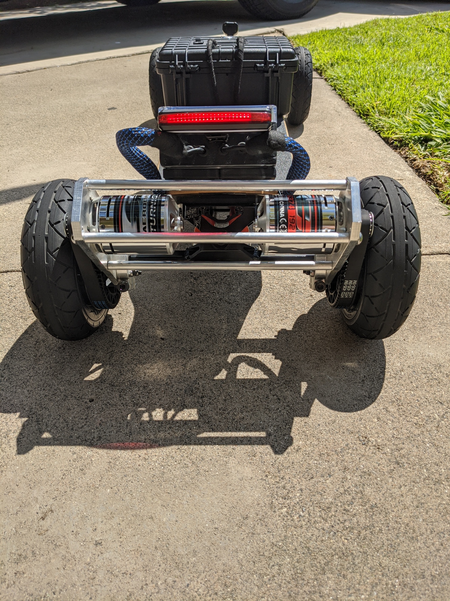

This s my first build. Initially, I wanted an off-road/mtb. I was searching for an enclosure for my lipos and esc. I actually did use the one from Harbor Freight, that Mobutusan posted a link to. All in all, it’s a great box. And you can’t beat the price. Originally, I had 2 lipo (10s 1p, without BMS) packs, and the esc inside. However, I was only getting a range about 10 miles. I added 2 more packs to double my range, making it 10s 2p. Also, I want to sell this thing, and wanted to make it easy to charge for whomever buys it. So I added a charge only BMS, which can be unplugged. I set the battery discharge limit through the Vesc software. However, I ran out of room. So I moved the esc to the back tail, and put it into a junction box, and painted it black… something I got off of Amazon. It looks okay, I guess…I was going for function over form. But I think I would have made an enclosure for the bottom, in hindsight. Also, I decided that the bindings were not for me, and I prefer riding on paved surfaces. The bindings were also made form an old weathered leather belt, and my first attempt at tooling leather My next build will definitely have an enclosure underneath. The box is the easy way to go, for sure. This build has less than 20 miles on it (testing, and getting things dialed in.) And I have some brand new tires to put on it.
