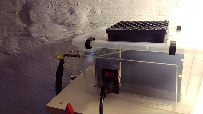

I also installed a 4th axis end of last year. it’s am harmonic drive for almost zero backlash, then IKEA box for the electronics I put together and getto shielded cable :grin:
