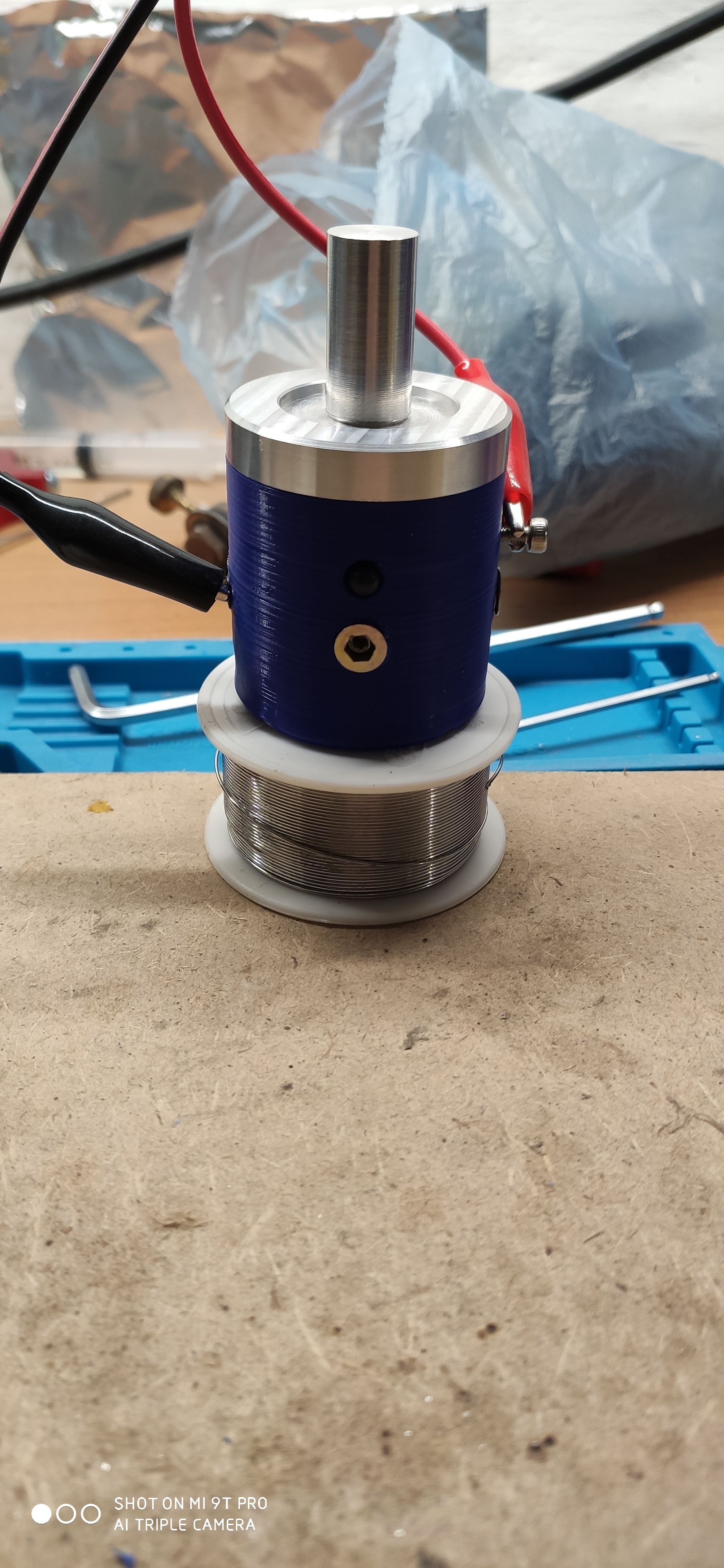

For future reference. In case someone would need it.
Made a fix adjustable probe digitizer to locate your x, y and z. It works as a NO circuit that closes when touching a metal surface and sends signal to your breakout board. It can be adjusted in X and Y to be fully concentric with your spindle without runout by 4 grub screws pressing against a bearing. Z load is assured by a spring pressing down the central column.
Still waiting the stylus tip :sweat_smile:
