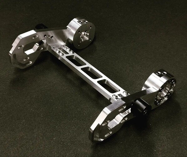

There is also an option to mount a crossbar
This type of motor mount can also be installed on the APEX Air and Luna 350 trucks

These are motor mounts designed for the MBS Matrix and Trampa ATB with an additional crossbar of an adjustable width crossbar

Do you have crossbars like this for the slot at the end of the motor mounts? To attach to the part that I think functions as a bash guard.
I currently have two BN mounts set about 170mm apart and because there’s very little distance between the motors it would be good to add rigidity there so the cans don’t clank off each other
There are 2 options
  1. I have crossbars with adjustable width.
    Crossbars are designed for longer mounts (113-120) that already have dedicated mounting holes. Theoretically, you can also mount crossbars in 92-98 mounts, but you need to drill additional holes with a diameter of 5mm.
  1. Some time ago I designed adapters for Bash Guard
    Adapters require 12mm diameter tubes with M6 hole, tubes are not added to the kit.
    It is necessary to make them yourself
