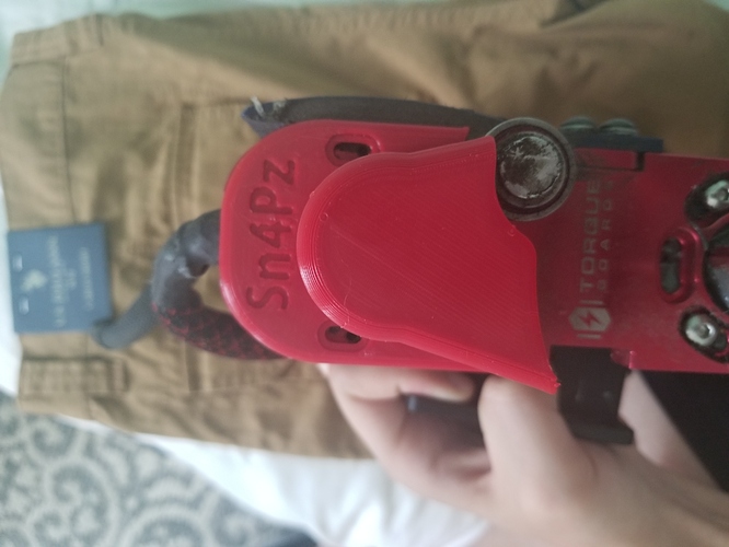

But the files were for Boardnamics when I already bought my mount kit from torque boards(normal/inward mounts) and motors from flipsky (dual 6354). What do you guys recommend for this? I am willing to change my mounts as long as it doesn’t cause that much altering needed for the rest of my build. I can also 3D print.

They fit better, much better, but not perfectly
  • The idler bearing cutout is still too big, but is easily fixable so I guess that’s not a problem
  • The mounting holes are a bit wonky, the C to C distance needs to be extended by a mm so I don’t have to thread the bolt through the side of the hole.
Other than that, they seem fine for a 15mm pulley w/ an extra 3mm of shaft poking out above.

I’ve got ‘belt covers’ in the sense that I’ve got the pieces that cover the motor pulley and belt, yeah.
I don’t have an enclosed belt drive setup, which is what you seem to want :thinking:
Yeah, can I see those belt covers? Maybe something I can use or build off of
They’re in the photo above, the red piece ontop of the mounts
Ohh ok, I think I might have seen that on thingiverse. Correct?
Youve probably seen something similar, but not for v6 trucks.
