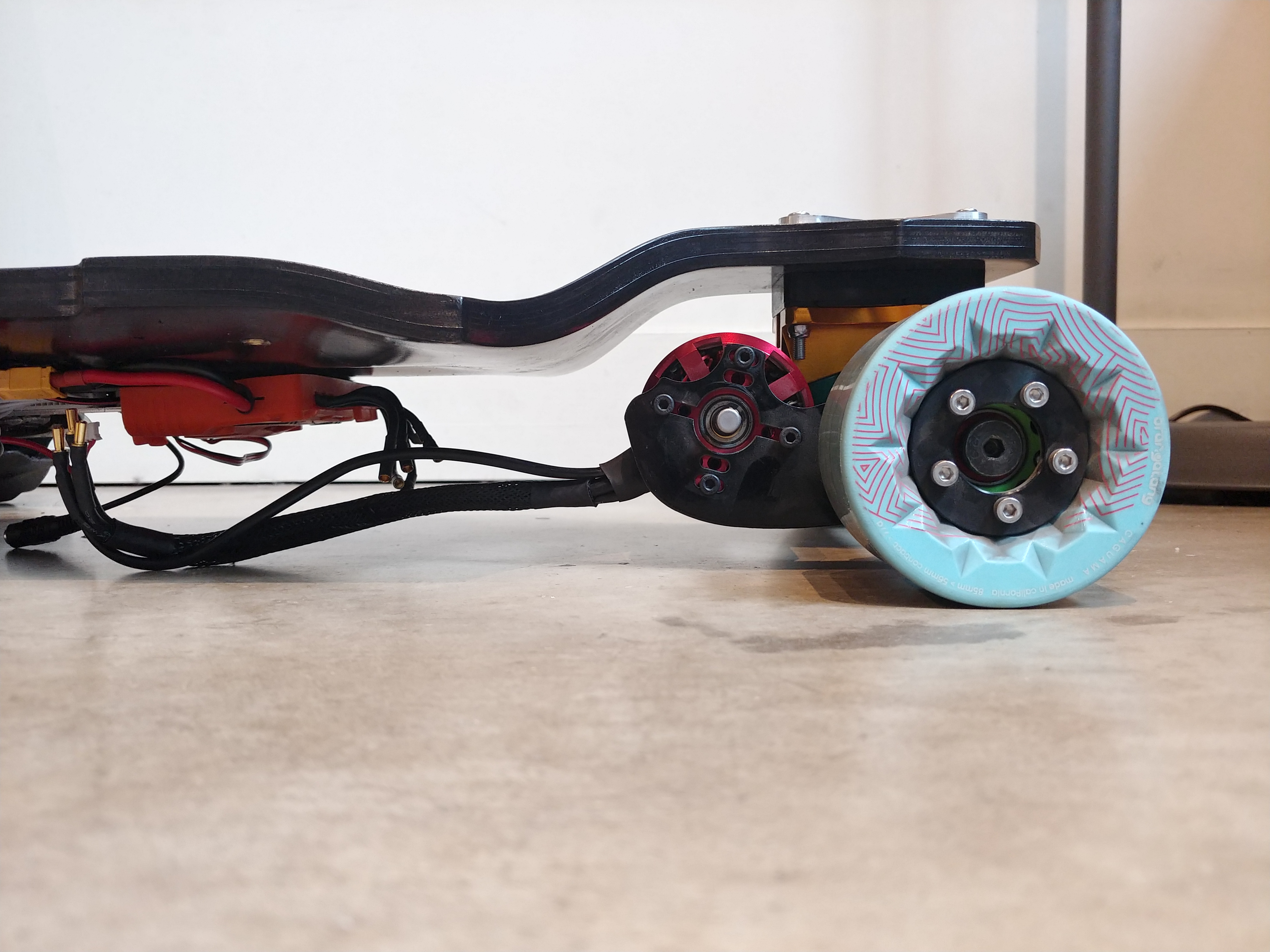

On my first ride a stone hit one of my motors and broke it.
The motor scrapes when it turns so I opened it up and found a broken magnet. I think it will probably still work if I just remove the magnet fragments but it looks like the broken magnet may break again. If possible I’d like to replace just the motor frame/magnets instead of buying another motor, but I’m not sure if psychotiller/maytech have frames available for purchase on their 6374 motors.
The bigger problem is that this happened on my first ride. I need to move my motors higher off the ground or cover them in order to make sure this doesn’t happen again. I could do this with bigger wheels, different motor mounts, motor covers, or just a different mount orientation. I knew the motors were a bit low to the ground but this was the highest I could get them without hitting the board so I don’t think adjusting the mount orientation is an option.
I’m using Surf Rodz TKP trucks with Psychotiller mounts, dual Psychotiller 6374 motors, and a RedEmber 44.

some pictures of the damage to my build:

@Peter could you show a picture of the stator? (the green part), could you also show a picture of where the fragment broke off from
Dickyho sells hex adapters that are a bit too small but I may be able to file them down to fix the surf rodz. I’m all ears if you have any suggestions though.
Here are some more motor pictures. The stator looks fine to me. You should be able to see the chipped magnet to the left of the motor shaft. I’ve also included the magnet fragment on the left of the picture. There is also a picture in my initial post showing the chipped magnet but it’s hard to see.

You already have some pretty hefty risers there. You could lift the motor mount closer to the deck and remove the street side bushings and stand on the deck to check motor binding. They look on the low side. Failing that you could try reverse mounting to get more clearance. Also with reverse mount debris has a habit of hitting the truck assembly first before the motors so it may be safer.
I think my problem has been that the psychotiller mounts don’t have much room to adjust them if you use all the screws supplied. I used 3 of the 4 screws and it seems to fit much better. I’m probably going to play with the mounting orientation a bit more but this seems to be a better solution than using all 4 screws and scraping the ground.

Just as an aside. Your mounts are upside down, the rounded part of the plate protects the can from bashes. The way you have it now reduces top clearance and leaves the can open to curb surfing.
There’s no rule on how to mount… just seems like common sense :+1:
Yeah I was going to flip them. I was just messing with the orientation to get a bit more height. Thanks
