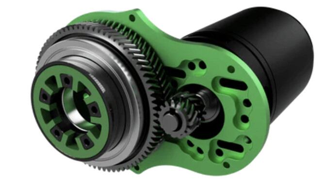

@rusins What do you mean by tuning 3dservisas gear drive right for less noise? What has to be done?

Minimal backlash and sufficient grease.

That certainly helps a lot. What grease is best to use? Brand/model grease? Packed pretty good yeah?

I run red n tacky personally. You can also run some thick white lithium grease. You don’t need much, it’s just going to get thrown out onto the casing anyways. I just apply a thin coat all around. Once the drive starts to be a bit noisy i open it up and regrease it.
I use lucasoil red and tacky for metal. And super lube for plastic
Btw, newbee 4gs are incredibly quiet, much more than my 3ds or moons
I use superlube for steel on steel gears. works fine

Hey you guys I think I found the answer to this post. Aside from pricey wonderful quality 3d gd’s, which btw please check out SKP’s website as he has tons of quality options and some at used prices, but gotta check out bioboards herringbone gear drive! Looks like a wonderful option and priced at $500 sounds absolutely fair to me, I’m prolly gonna get some too. I hear Herringbones, then helical, then straights are the best to worst as far as freeRoll walking rattle and other stuff. Herringbones are basically described as dual helicals.
I unfortunately only have super lube so I’ll use that for now, as I’m gonna adjust my backlash mesh on my bn m1 at gd’s. I read somewhere to use about 2oz of lube on a gd but maybe since I’m tryna rid the rattle I need to pack in double that. What do y’all think?
My 4GS drives are more quiet than my belt drives. It’s nuts.
Hopefully in the next few weeks I’ll be trying out the newest version of 4GS drives with the metal slave pinion gears. Curious to see if those are also just as quiet.

I used 3ds’s supplied lithium grease, and just made sure that it’s fully covering the gears. No need to completely fill up the casing, that’ll just make it leak out faster.

Anyone know how loud the Acedeck gear drives are?
i think they’re louder than belt drive. i haven’t heard them recently tho
Pretty quiet, I ride with a friend who has a NYX Z1 and I certainly can’t hear him over my straight cut BN gears.
It’s about as loud as you’d expect IMO, not shockingly loud or quiet, louder than 4gs, or belt drives. Quieter than pretty much any straight cuts I’ve heard.
