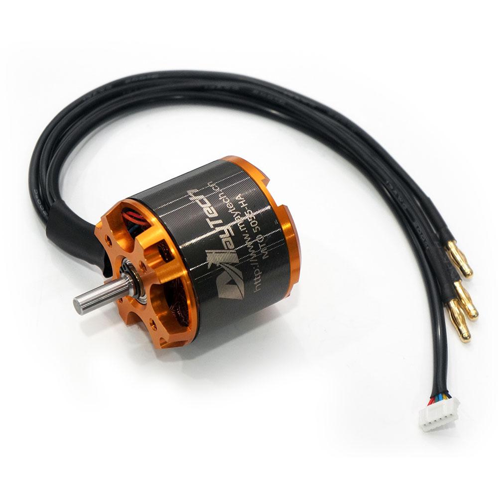

I’m wondering which motor is the most efficient Wh/km wise at a constant speed of let’s they 20km/h-30km/h.
I found so far 5 interesting options

MT 5055S 220KV

I think that depends also with which voltage you power them, I think also gearing.
I do not know the calculation behind, probably @professor_shartsis can give you some nice graphs for it.
Should be 12S. Higher voltage is more efficient. KV and gearing should max out at the max speed wich should be achieved for best efficiency. Also the best results should have a 1:1 gear ration. But I don’t know if such a low kv is possible at that speeds.

Look for idle current/no load consumption. Usually a good tell overall. (lower=better)
Yes but they lie on those numbers so not necessarily a good indication
for the same size stator and copper fill the higher kv is more efficient, generally the bigger motor is more efficient, for the same kv the lower resistance motor is more efficient, gearing for the lowest acceptable top speed is most efficient… unless its direct drive (1:1 gearing) then the lower kv is more efficient

Does anyone have a suggestion for an efficient motor preferable with estimated consumption Wh/km?
that depends on the gearing, resistance, how fast you ride, amount of starting and stopping, weight of the rider and the terrain.
No gearing, aiming for 1:1, DD, hub, or something. Just looking for a motor ATM. Speed like I said something between 20-30km/h should be fine. Normal rider weight. 60-100kg. It should be for long distance on street in a light weight build. Maybe 12S1P Samsung 50E or similar.
