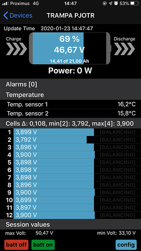

@pjotr47: Have you never experienced 1 group draining slowly over time when not using? It sometimes happens with mine and I’m heavily suspecting the bms.
Ps: yeah the companies customer services is non existent…
What cell group is draining slowly?
Group 2
Same here on my trampa
I have to put always balancing on for some days and then it will be gone. But I am to lazy for it at this moment. It is the only BMS I have with this problem.
Worth noting, I have two units that I check and graph daily, and they do not drain any group more than another. Is that LLT, with xiaoxiang? My app looks very different. Maybe they screwed up the newer ones?
It looks like an iPhone app vs Android.
I have 5 different boards laying with a llt BMS. And I have also some customers with them. They works all fine except the one in my trampa.
I have also had 2 faulty ones with bad balance circuit.
And it is llt with Xiaoxiang. On android you can download the original manufacturer app. On Apple you have only a app that is designed by somebody random.

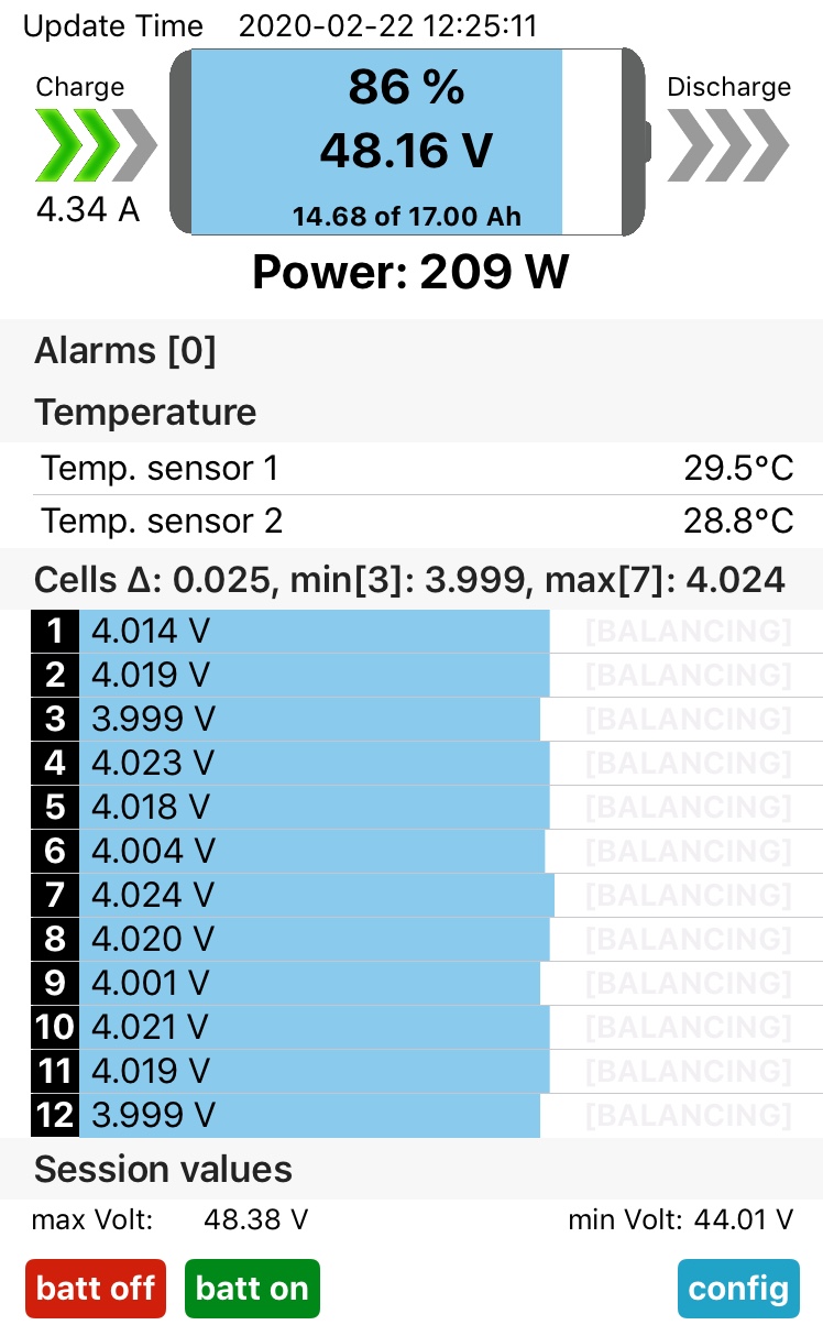

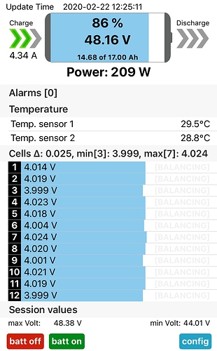

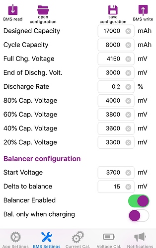

Wrote the bms that it should start balancing at 3700 mV but I’m not getting any balancing at all…
Am I doing something wrong? Gonna try with the android app
need to enable balance whilst charging slider

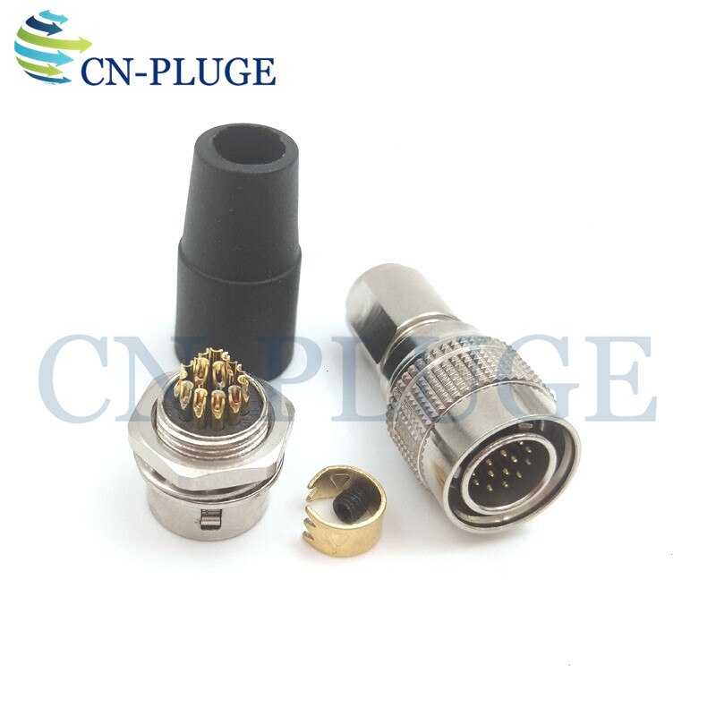

Found a fancy connector for wiring the balance cables outside of the enclosure. Think I will be using this.
Looks nice. Do you know what the current rating is though? Those pins look super tiny.
That looks awesome! Looks like it would be a bitch to solder tho… and bloody expensive!
Bought one for science :sweat_smile:
Yeah they look really good! I agree that they are expensive, but if they work good and look good it’s worth it to me. They also have the female on the panel mount. So no bending pins that could cause a short.
@janpom Found this, don’t know if that’s per pin or total though.
Edit: Also, it wouldn’t really matter for me I think, I will have one port for balancing like this and one 3-plug dedicated to the positive and negative. Balancing current isn’t that much…
Would be perfect if that is per pin, but at the size I dunno.
I asked the seller if they could let me know the per pin rating. Will update when i hear back.
That’s good. Looking at the 14 pin version, 2A is more than enough for balance wires. :+1:
Confirmed through seller that it is 2a per pin :ok_hand:
