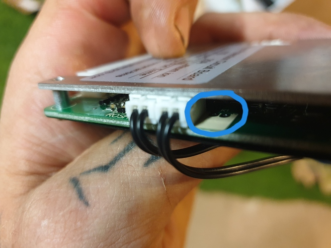

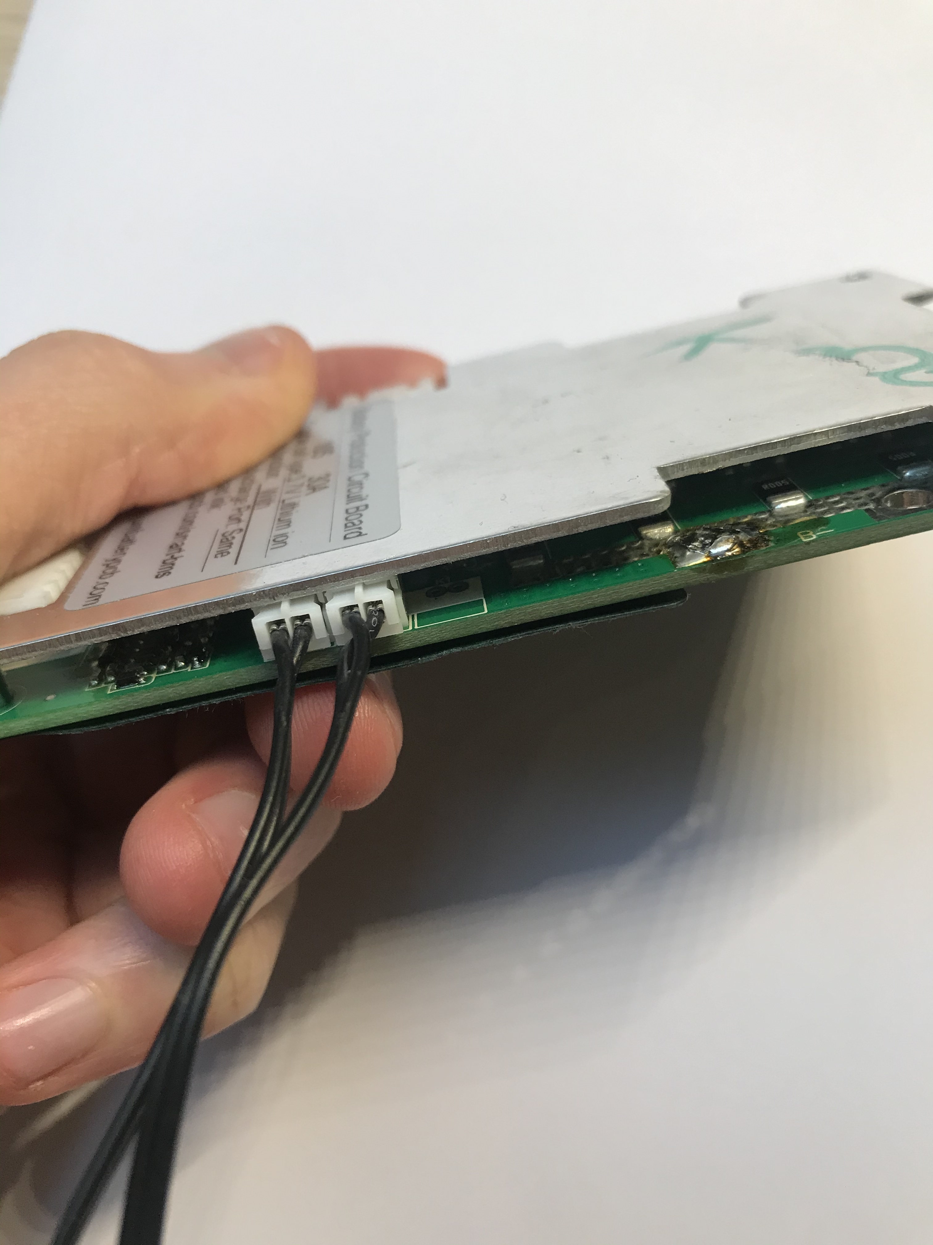

@glyphiks I think there’s 2 pads labeled k1 next to the temp sensors. If you get the pc app I believe you can enable the switch and then wire a simple 2 pin switch too the k1 pads.
I saw that in the documentation, but mine doesnt have those two pads… i got the 10s 20a version because I want to bypass discharge for the board, but I want to run a battery gauge off the discharge of the BMS…
Mine does have two P- pads at the top, but documentation says to leave those blank… what are they there for? :man_shrugging:
I’m not 100% sure. It may be able to do charge/discharge on both a single port or separate ports.
And on the note of 2 pads… why is there 2 pads for b- and two for c-? Are they the same pads? Does it matter which I connect to? Goddamn BMSs are confusing :crazy_face:

Check the pins next to the temp sensor wires. You have there 2 small solder point. There you can connect 2 wires to it with a switch.
And btw you can draw power from C- too. It is charge and discharge on one line.

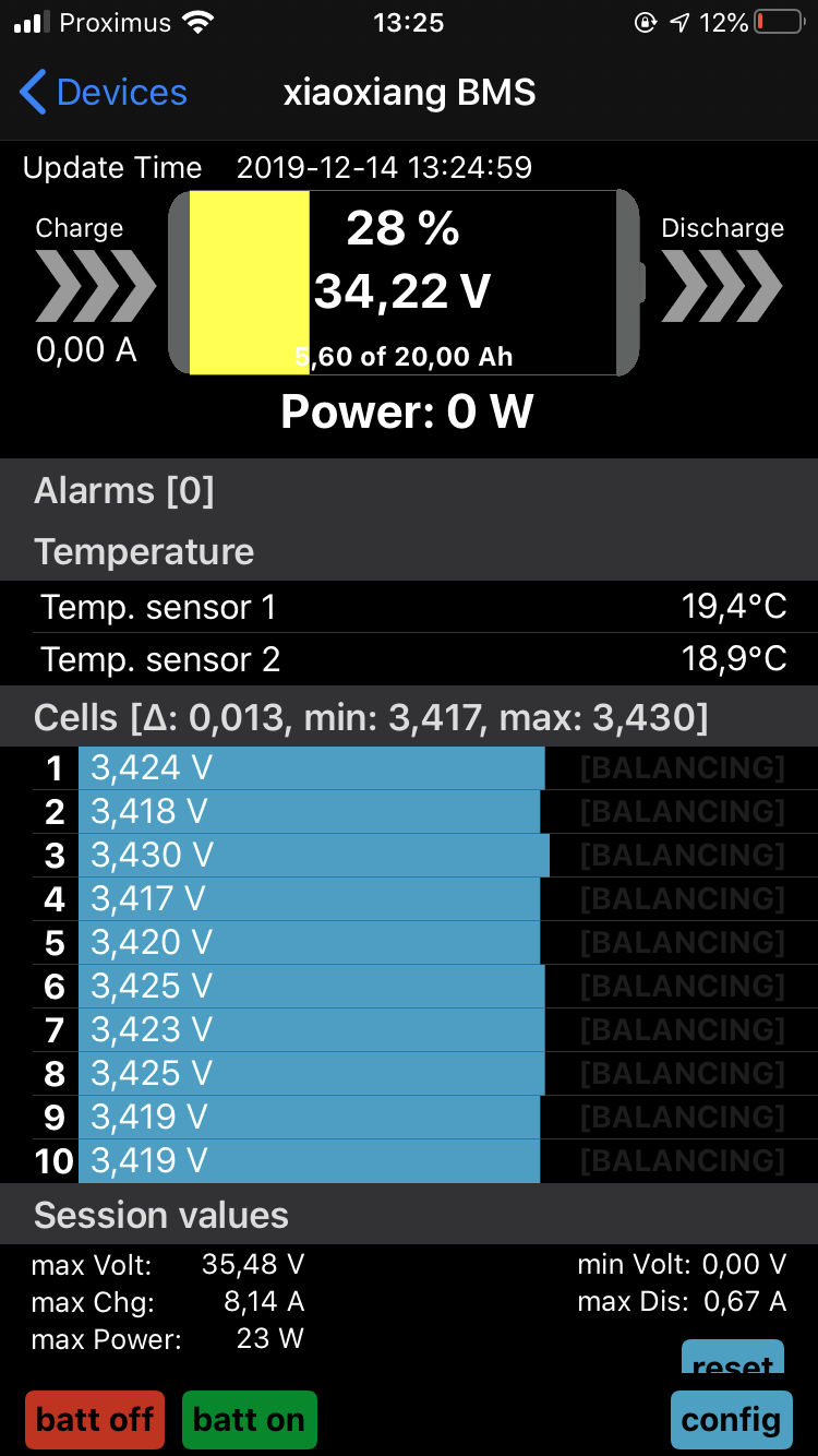

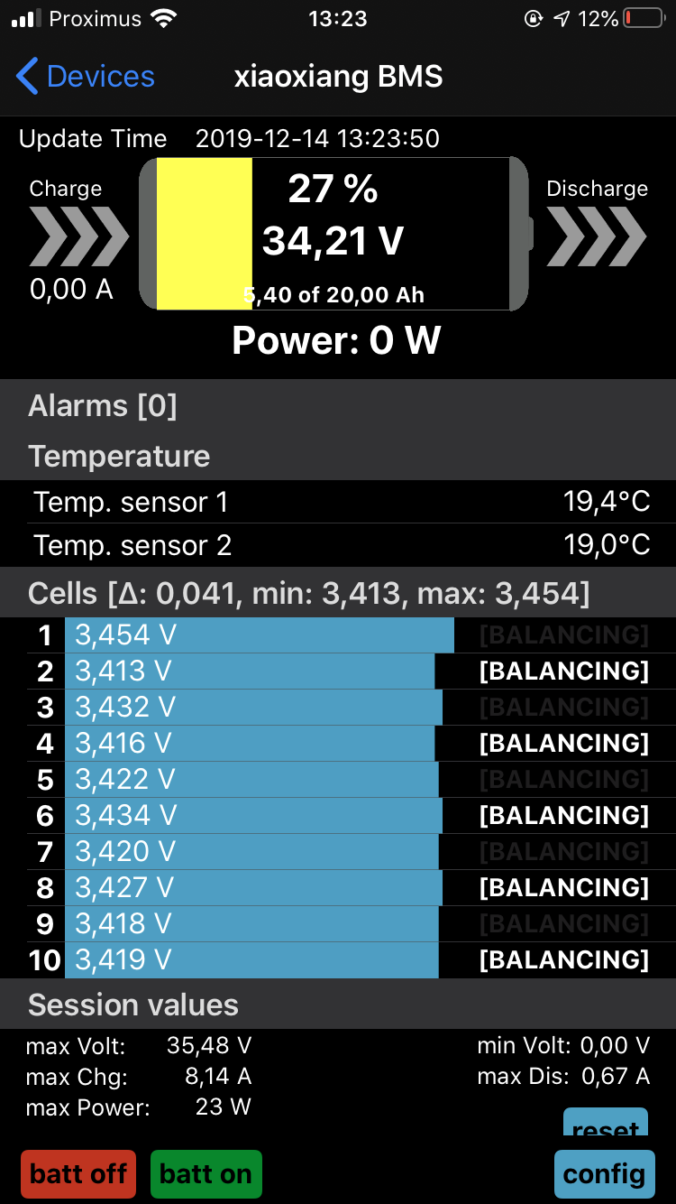

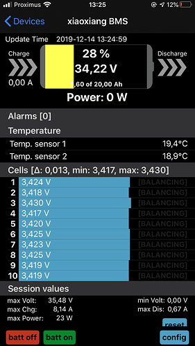

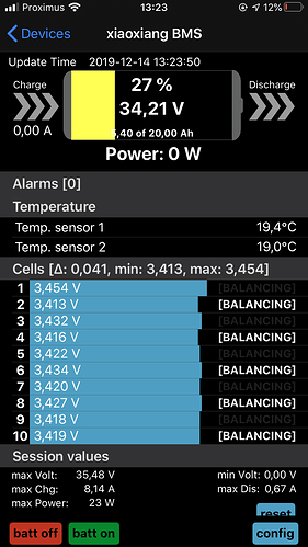

Last thing: there are some faulty ones from a batch going on. When you order 10s and you have a the small balancing plug (not +15s plug). Check it balancing works fine. It is possible when balancing kicks in the bms voltage on group 1 or 2 start doing strange things. I have contact llt but never had any response.
Example off this:
Balancing on:
Balancing off:
Ahh i see them now!
Right there for those of you playing at home.
Thanks Pjotr and @M.Hboards :call_me_hand:
Not entirely sure if I will use it now, but good to know that it is there.
Ah, nice! I never noticed those. Good to know and sorry for the wrong info.
