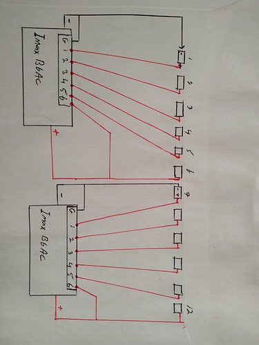

This would be the correct way to hook up 2 ImaxB6s to charge a 12s pack right?

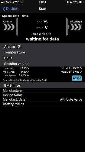

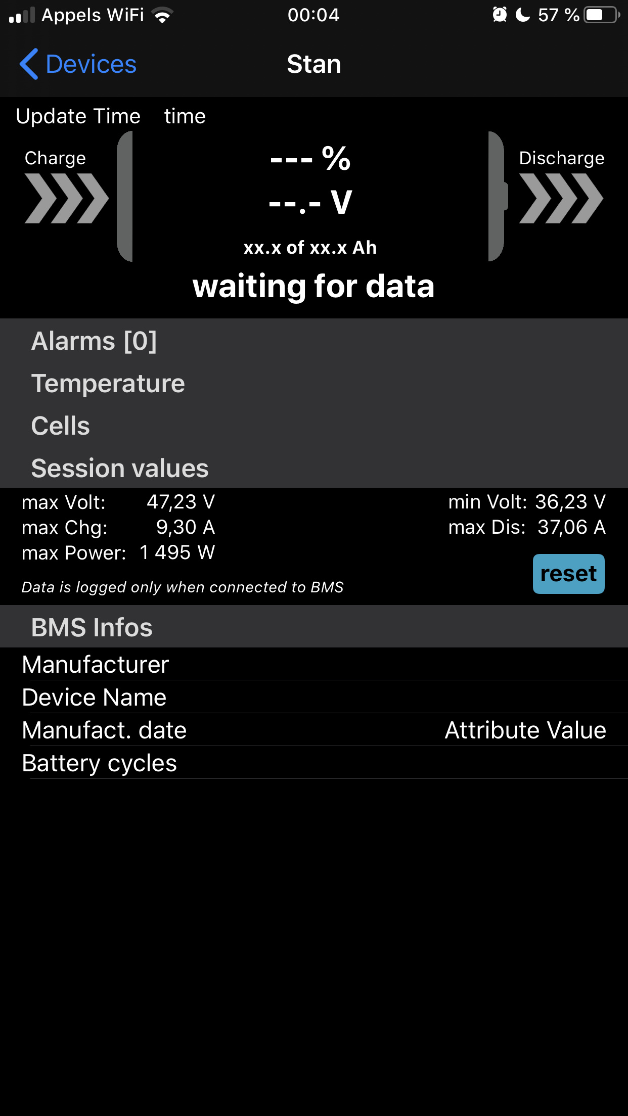

I have an issue with my bms, it got stuck at this page when I try to open it.
It does recognize the Bluetooth module, and the charger seems to be able to charge it. (Battery)
But it won’t load bms data.
I was using the bms normally, checking my battery% until suddenly it stopped working.
And from then, connection attempts had been made in vain :/.
I’ve tried to disconnect the Bluetooth module, reconnecting it, nothing seems wrong on it. I’ve also went to disconnect the BMS from the battery but nothing got fixed, still stuck at the same page while trying to load the bms app.
Anyone could help?
Could be a bad RX or TX wire or some damage on the BT module.
Can you somehow verify that the UART on the BMS is still working? Could be done with an Arduino and a few lines of code.
Oops, I think I just shorted that with my flipsky receiver ._. …
It touched the bluetooth receiver’s antenna and a spark came out of it.
This has happened once before on my power button a really long time ago, but it kept working well, just a part of the antenna got ripped off.
Now it isn’t being detectable with my phone, so… rip?
FU** I think I shored my remote’s receiver too… the wheels aren’t responding to it’s input now…

With two balance chargers you will either want to break the series on the battery pack or use independent power sources for the chargers. Otherwise you may very well short out the battery over the common ground.
