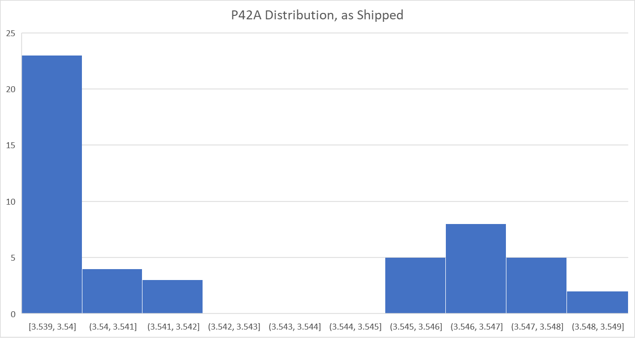

Just bought 50, and measured initial voltage. Below is distribution, not what I expected.
Interesting! Thanks for posting that.
That’s a great (and tiny) distribution IMHO.
About half of the cells are are in the lowest voltage set with none below that. This means all of the cells were self-discharging at the same rate as the main group or less…a good thing. This makes it easy to create packs with known self-discharge rates and that allows easier design of a BMS tailored to compensate for those known self-discharge rate differences.
(Edit) I agree with @Skyart too…that voltage spread is nothing.
So 10mv is the largest difference? This is like nothing to worry about, less then nothing. In the thousands of cells ive gone through the largest difference to date is 11mv for me ever.
