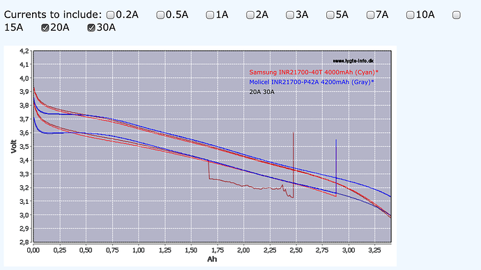

At lower current draw the T40 have more capacity making them better in larger packs
Arenā€™t they both ~4100mAh in ideal conditions?
At different currents batteryā€™s have different capacity
T30 punch hard to begin with then p42A very quickly keeps a higher voltage
T40 good at low currents
P42A come out as a better all rounder by quite a big margin
Yes, iā€™m talking discharge at something like 100mA
P42A sag a lot at the start giving the T40 the edge on capacity but thereā€™s very little in it after that.
Personally Iā€™d go with P42A more consistent acros there range the capacity bonus is so minisqal itā€™s not worth it
