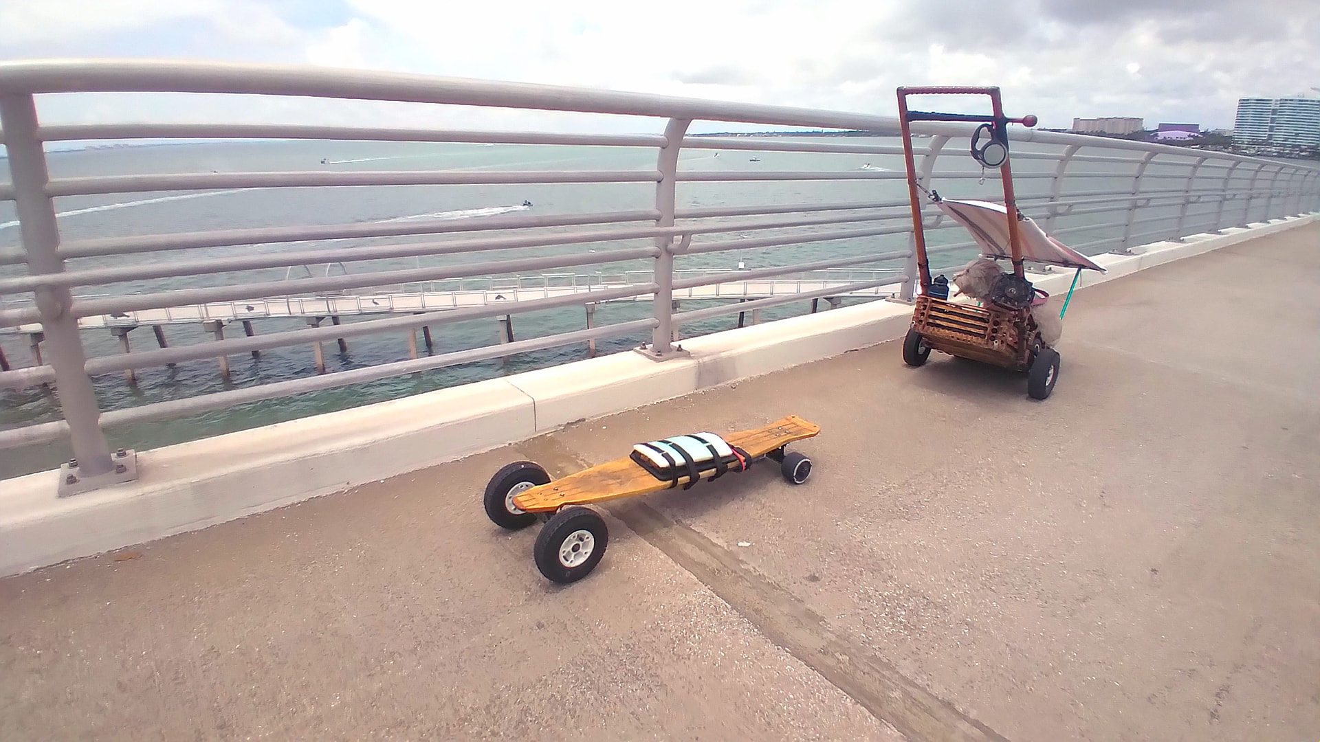

This bridge is the highest elevation, a whole 26 meters, the Esk8 has taken us.
Hub motors were maintaining 11mph up the grade, and did not feel too hot at the apex, but stator heat had not had time to work its way to where I can feel it.

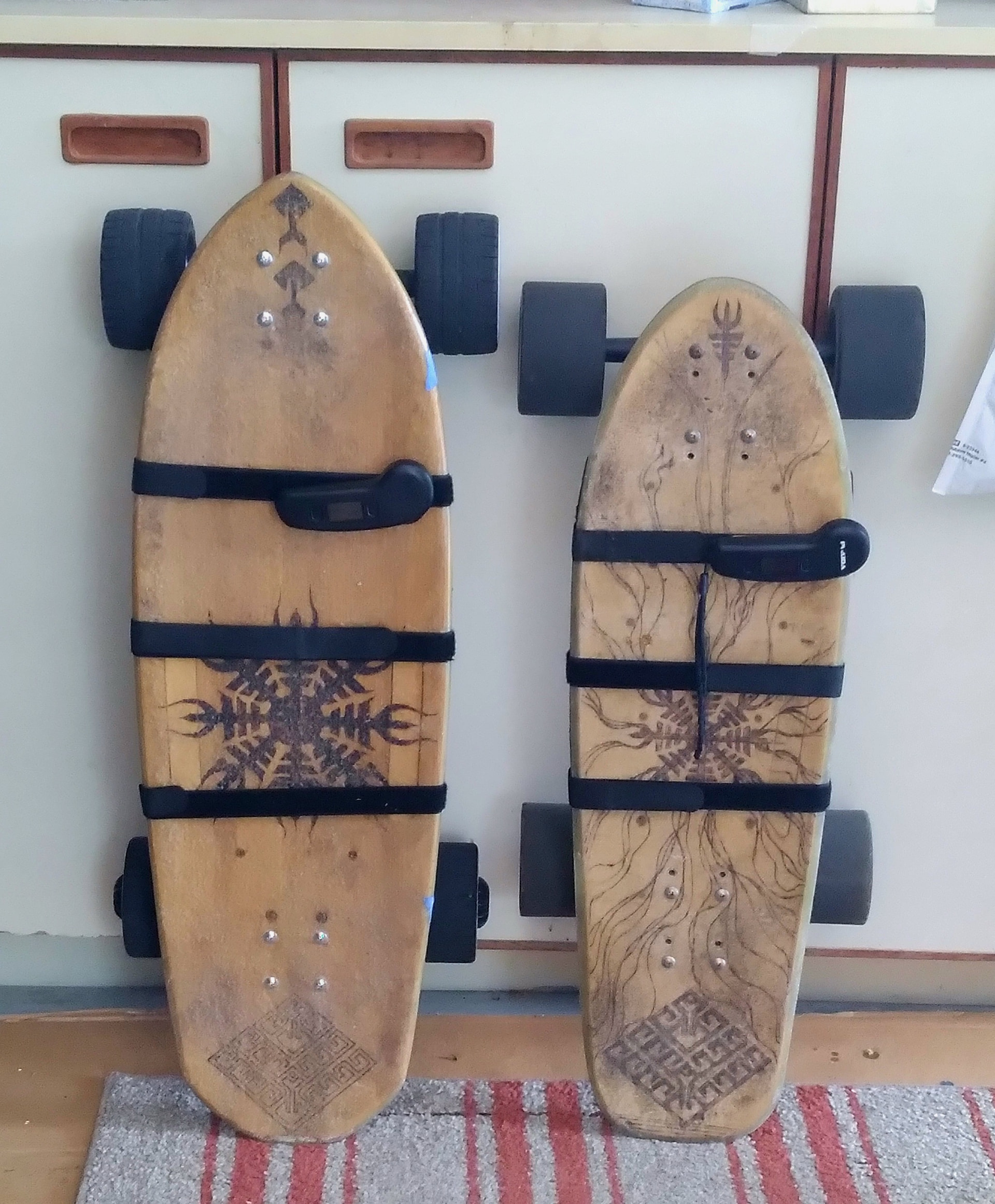

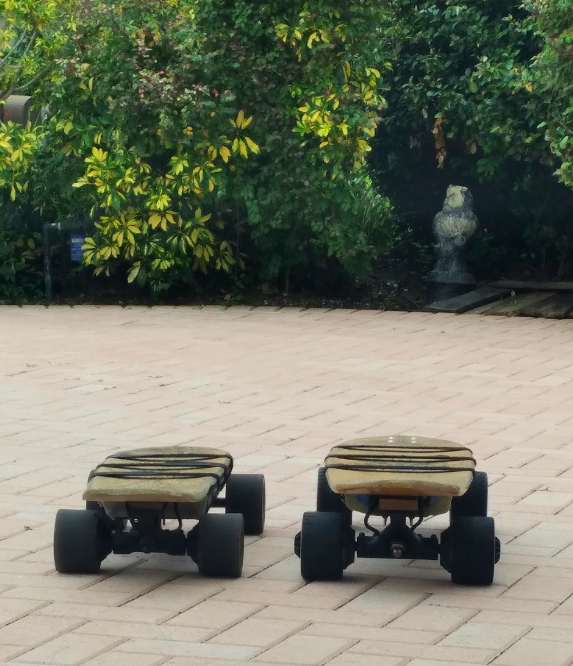

The Mini is still working perfectly, but I have not been rolling very much, and its been 2+ weeks since I went to the park, instead of the 10+ miles and 2-3 parks a day when Fiona was still alive.

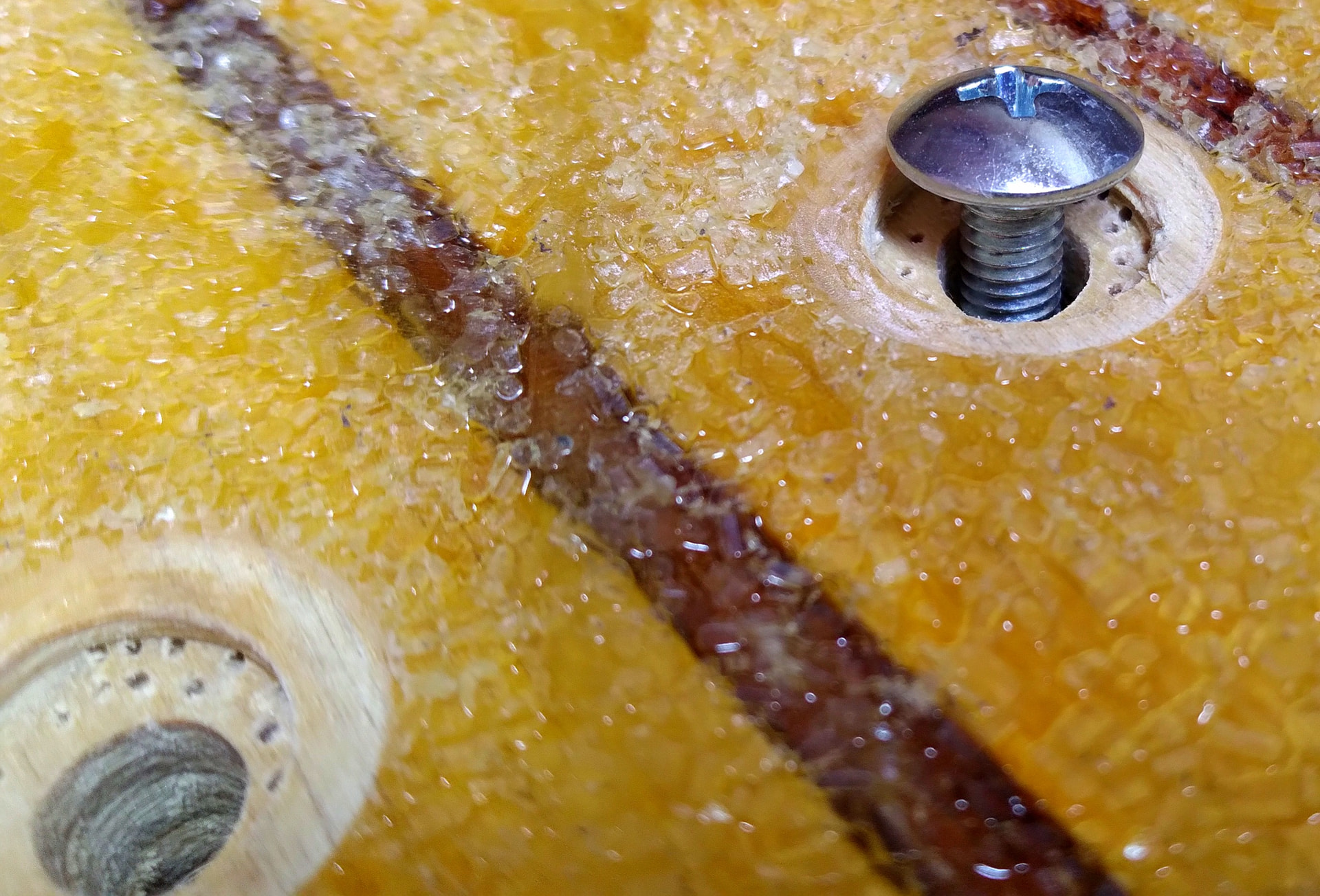

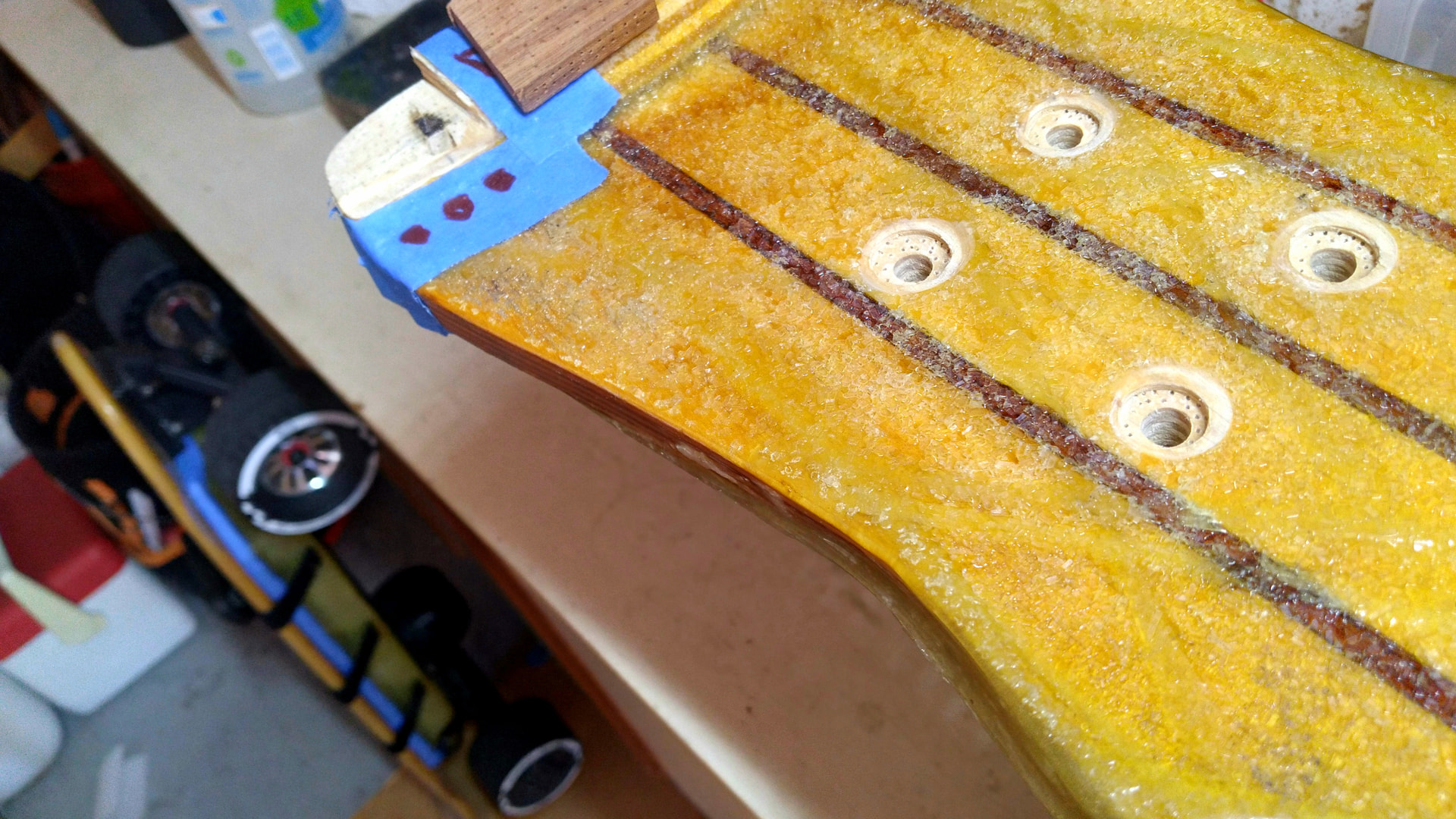

When I last added epoxy to the Guppy, I had drilled the baseplate holes a little bit bigger than the 10-32 hardware, and filled the holes with epoxy saturated with milled glass fibers, and after it cured I hand drilled new holes just big enough for the 10-32 hardware, but I did not get it perfectly centered.
I put a straight edge across the baseplates and don’t cinch the hardware until they are perfectly inline with each other, and this is imperfect from a hardware stress stand point since the holes are not perfect.
With the wedge risers the hardware takes on a bend and the threads on the shaft were also butted up against the thin walled epoxy column and digging in.
Anyway the deck got wet on its last ride, and when I removed the hardware I saw signs the epoxy column was compromised and the Baltic Birch plywood might have absorbed some water which got past the pan heads, or it was just dirty grey. it got scrubbed with soap and water anyway and blown dry.
Anyway this time I widened the holes a bit more and they are more hourglass shaped.
Birch is much softer than maple or bamboo, so even with wide pan head bolts they would want to sink, and on the back truck I said F it, and used washers, and no more issues in 2500 miles.
The New bolt in the picture below is a Truss head 10-32.
The epoxy columns do help against the sinking Pan heads, but this time I decided to take it a step further. There will be an integrated epoxy ‘washer’ atop the hourglass column spreading the load on the birch under the truss head hardware. The tiny drilled holes should allow the thin laminating epoxy to wick deeper into the nearby birch fibers. Getting all the little bubbles out will require some extra work with a needle, or a dental sized bottle brush, and perhaps a heat gun.
My ‘kicktail’ foot stop is just another piece of Baltic birch plywood that was epoxied and screwed at a hard angle, and the rear corner started flaking off, So I cut the screw and tried to get it flat so it can accept some Sapele that I had left over from Fiona’s kayak perch. Gonna look weird, but nothing about this board is not weird.

I put the enclosure back on the midsize Kicktail, but with 107mm wheels, wheelbite is an issue and I have not gotten around to adding more risers. The mini is right there and ready to go.
If riding the Midsize regularly, I’d want to do what I did on the Mini with wedging front truck and dewedging rear and enough clearance so wheelbite could only happen at walking speed or less.
But the Mini is pretty well dialed, and lighter, and easier to carry, and a fun little carve machine that I rarely feel the need to use on level 4 power. Level 3 is currently set at 80% current and acceleration and 75% of top speed, and I might turn it down a bit more.
I didn’t really enjoy the Midsize kicktail the last time I rode it. I can have a slightly wider stance with lesser risk of unintended torque wheelie, but the super short turning radius of the Mini is addictive.

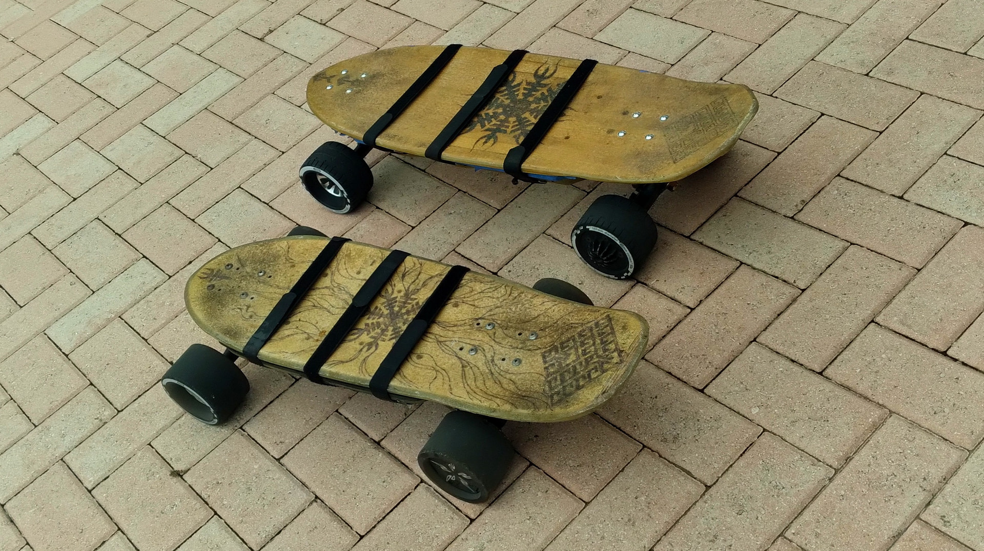

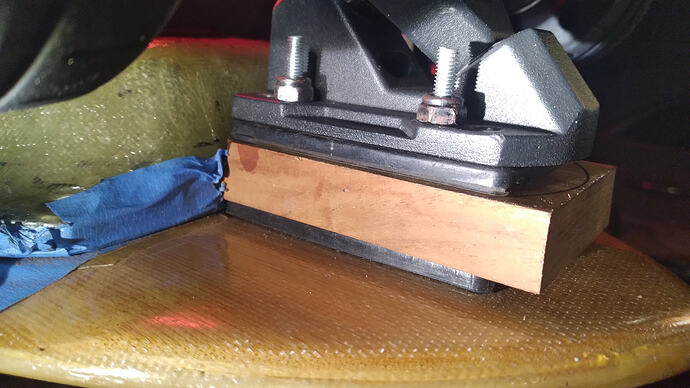

Quick and dirty Teak riser shockpad sandwich.
Thems 2.5” 10-32 bolts

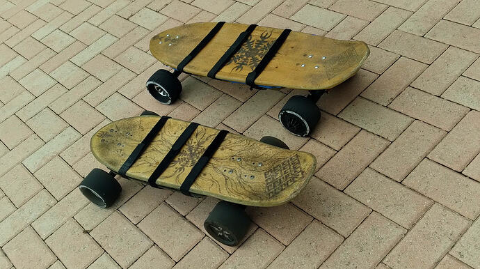

Never rode the Midsize with wheels bigger than 90mm before.
The 107mm airless rubber wheels can still bite the front of the enclosure lip at full lean, but slow enough to not be danger bite.
Need to dial it in with different duro bushings, but it rides pretty good as is, even with misaligned baseplates.
Might add some wedge to the teak, more up front, dewedge the rear, but the midsize is only in play when the Guppy is in drydock, but moving the hanger and enclosure over takes about a minute. The front baseplate might need to move forward a bolt hole for enclosure clearance, and then I can start lowering the ride height.
I like the 107 airless rubber wheels on the Midsize, far more than I did on the Mini.

Both Midsize baseplates got new M10 grade 10.9 Kingpins
3 quarts of ResinResearch laminating epoxy to arrive tomorrow.
Got to get back in the Composites groove.
Take off the roadside bushing, leave the boardside bushing. Wrap the wheel with griptape. Lean the truck all the way over. Use the wheel to sand away anything that’s in the way.
Then if it gets deep enough to need it, do enclosure repairs. Then sand with wheel again.
Then fill up the enclosure. It will work beautifully.
I have found that removing the roadside bushing and leaning the truck over does not have the wheel in the same exact spot, as it would be if the Bushings were still there and fully compressed centering the hanger in relation to the kingpin.
It is very close however.
I had in the past taken to using No bushings, and holding the hanger where the Bushings would have it centered if they were still there, then marking, and trial and erroring, or just removing more material than strictly needed, or just taking some and adjusting according to witness marks.
But right now the masking tape just gets schmemmied where the wheel touches the enclosure lip.
I am thinking of moving the front truck baseplate forward by one hole, and also adding some wedge to the Teak for some split angle action which will change where the wheels bite the enclosure.
This front truck on this board right now is the one which actually came with this prebuilt Deck and the hanger needed some carbide burr dremelling before it would not bind on the kingpin. which quickly became a wobbly kingpin with Beer can shims. I have some other trucks I can try as well, so at this point am not committing to modifying the enclosure to eliminate wheelbite.
Right now I have stopped the wheelbite by cupped roadside washers and bolt tightness, sacrificing some low speed turn radius.
There is a LOT of Dialing I would be committing to, if This deck was a daily driver, but it is only really reassembled as the Guppy is in drydock.
I am enjoying the extra leverage by not having my toes and heel hang well over the edge like they do on the mini. The longer wheelbase and airless rubber wheels and motor sleeves are better for rolling further away from home base, faster more comfortably, but this drivetrain / enclosure and motorized hanger installed on the Guppy is far more comfortable, fun, capable, and safe and within a KG weight wise
My new Surfboard Laminating Epoxy has arrived.
A 3 quart kit for 121$US taxed and shipped arriving 8 days after ordering.
Resin Research 2000 Bio Resin and 2100 slow hardener.
Both are perfectly clear and the slow hardener is almost water like in viscosity, and both the resin and hardener are thinner than the Apex Epoxy resin I had grown used to over a decade or so.
RR epoxy should wet out cloth/roving faster and easier. It should penetrate wood deeper as well. I got the slow hardener as It is summer in Florida, and My garage workshop is rarely less than 90F/32.2C.
Gel time is 40 minutes at 77F/25C, which is slower than the Apex Quikset clear I was used to. “Set” time is 5 hours at 77F. I will see. ‘ slight Thickening’ vs ‘Gel’ is subjective.
They sell FAST and KwiKick hardeners which would be more acceptable in cooler climates and / or when production speed is a concern. Not sure of their viscosity, but I very much like the thin viscosity of hardeners, as it reduces the time until it is thoroughly mixed.
I like to wear a headlamp and my reading glasses and consider ‘fully mixed’ to be when I can see no more swirlies. Scraping the corners and sides often show the swirlies return to the otherwise homogenous mixture, so a mixing stick which can scraps both the sides and bottom of the cup at same time also reduces mixing time which then increases the working time.
The box of RR epoxy was well packed, with some extra air squeezed out of the bottles and then Electrical tape applied to tighten the caps and prevent them from backing off. No leaks. HAZmat Ground shipping only, but this package crossed the Rockies, and their minimum 5k foot pass elevations.
The lesser air pressure at altitude often causes leaks in poorly prepared bottles as the air inside expands and when the bottles are not shipped upright.
This Epoxy is a 2:1 ratio by volume, and 100:44 ratio by weight.
I refuse to mix by volume anymore, even with calibrated pumps, or using quality mixing cups with good graduations. I find I can achieve absolute perfect ratios to the 0.01 of a gram on my 300 gram scale, and to 0.1 grams on my 3000 gram scale, and the confidence in perfect ratios cannot be underestimated.
The pumps I have used would basically require a sacrificial wasteful pump as the pump would depress a certain amount before resin or hardener started dispensing, thus throwing off the ratio.
Perhaps newer pumps are much better in this regard, but I often go months between mixings and gravity can be a bitch.
I have had some Apex epoxy batches that during their cure, fell below the minimum cure temperature of 60F, and then raised back above it the next day. Even if the next day was a hot one, the batch still sanded weird and several more days were required before it seemed to sand normally, but then I could often still see when I sanded through that batch into the one under it.
I found it super important that Apex epoxy, got a full 8 hours above 60F,
I don’t see falling below the minimum working temperature to be an issue in SW florida, but humidity is a factor.
While a lot of epoxies claim to be blush free, given enough humidity, Amine Blush is still guaranteed, the variable being the amount and how hard it is to remove.
Weighing Epoxy resin and hardener, I like being able to mix up tiny batches without wasting epoxy or having to have another project ready and waiting to use the excess. Also, nearly any cup can be used as a mixing cup, as long as its sides and bottom can be scraped clean.
With the ‘good’ medicine mixing cups the smallest batch I could achieve was 7.5ML and often they did not cure as well as hoped no matter how careful I was in pouring the ratios. Is the meniscus in the middle of the line, or just above or just below? Is the cup perfectly level?
The Wax mixing cups had the bottom variable in height in relation to the graduations. I wasted so much epoxy and sandpaper and time with those damn cups.
When I first got the 300 gram digital scale and did my best to pour by volume and recorded the weight at 7.5 and 15ml , I was off by a non insignificant amount, and 30ML batches I had to be super careful to not allow any resin to dribble out the side of the cup when mixing slowly..
I know a lot of people are vociferous about mixing epoxy by volume only, but I feel it is too error prone. if an epoxy does not list a ratio by weight, I dismiss it.
I weigh my blobs of JB Weld original. It is a 1:1 ratio by both volume and weight, and if one believes they are a magician at dispensing equal size blobs of parts A and B, then a digital scale will reveal one’s delusions.
Just because imperfect ratios still harden does not mean it has achieved its maximum adhesion or tensile and flexural strengths.
The same is true for laminating epoxies.
I will report back my impressions after working with this epoxy.
Yeah i always prefer mixing by weight as well, feels way more precise
Yes, it’s not exact. But it is close enough to be very helpful. If you want it exact, leave the bushings on and use a rope or clamp to hold the bushing lean, but that’s far more difficult for a very similar result.
I’ve only mixed one batch of the Resin Research laminating Bio resin with slow hardener, and wanted to give my initial impressions.
This stuff is THIN. Especially in a Hot Florida garage in summer The hardener is so thin it just wants to stick to the still full bottle lip and run down the sides and fill the edges of the digital scale weight plate, and cause me to curse up a storm.
There is almost no smell whatsoever. The least stink of Any epoxy I have ever worked with, and the slight smell there is, is not unpleasant.
I am used to seeing swirlies in the mixing cup when the mixing stick starts scraping sides and bottom of cup, and these disappear way faster than any other epoxy I have used.
I still mixed for longer as both the resin and hardener are so clear and similar viscosity and I don’t want to take risks with either improper ratio or unthorough mixing. It really seemed like this resin and hardener mixed together much faster with far less effort.
The Pot life with the slow hardener, even in a 90F garage is at least 35 minutes.
I was filling screw holes in my baltic birch deck, so there is some thermal mass exothermic heating expected, and I came back about 40 minutes later and this stuff had barely thickened, at 50 minutes I sprinkled some refined sugar on top of the holes to give it a grip tape texture, but the sugar seemed to be saturated and dissolved in the epoxy. it turned mostly clear. usually i use coarse brown sugar, and when water dissolves it leaves a coarse surface.
The much more fine white sugar did leave a 120 grit finish after being rinsed, whereas the raw brown “turbinado’ sugar is more like 36 to 50 grit.
The resin is so thin that the Birch really drank deep, and by the time I finished topping up hole 8, hole 1, which was heaping over, had drained to 2/3 full. This is with Milled glass fibers mixed in which does not really thicken the epoxy, but does make it greenish with whiter clumps.
Topping up the holes again and they largely stayed at that height.
I also spread the Epoxy on my Bubinga wedge risers bottom side, and filled their 16 overdrilled hardware holes.
Bubinga is a very dense hardwood, and I was again surprised at how much resin the wood sucked up.
The wedge riser hardware holes needed a second fill as the mound I left was about 2mm below flush by the time I finished filling the 16th hole and I had to mix up another batch of resin to finish and overtop the holes. The Bubinga had some micro cracks and The underside of the application, I can see where i the resin wicked deep and through the thin edges of the wedge and propagated along a crack on the thicker side. One crack was visible pre epoxy but a few smaller ones revealed themselves.
I had used System3 Clear coat resin for laminating in the past, and this stuff is also thin and considered a ‘penetrating’ epoxy, and I have to say this RR epoxy seemed to pull itself deeply into any voids and cracks in both the Birch and the Bubinga, far more than its thin viscosity would have me expect.
System3 clear coat is also quite stinky, Like a penetrating oil like kroil or Pbblaster. The CC epoxy is thinner than RR, but not by much.
ASYS3 CC epoxy has a really sweet smell that is pungent and eye watering in an enclosed space with poor ventilation.
The RR epoxy I was not even able to smell it when working with it in my garage. I had to stick my nose upto the epoxy.
It cures super glossy as most epoxies do, and far far harder than the Apex epoxy I had grown so used to. No obvious Blush despite humidity in teh 70% range and actually some rain about 90 minutes after application.
The overfilled holes on wedge risers needed to be sanded and scraped flat and it resisted this process to a much higher degree than Apex epoxy, and perhaps each and every other epoxy I have ever used.
I am not sure whether I would want to ‘fill the weave’ with this epoxy and have to sand it on a large area like a surfboard hull. I definitely would want the fast or Quikkick hardeners for that task as the slow nature of the slow hardener and low viscosity would have the self levelling allow too much to drip off the perimeter off the tape onto the floor but for actual laminating there is plenty of time to saturate and work the laps.
Resin research’s Additive F is supposed to make sanding easier( and prevent fisheyes). I wish I added it to my order. I have no experience using it. Some surfboard builders swear by it, others say it is completely unnecessary.
I did not spread the epoxy on a surface where fisheyes would be even close to a concern, yet, but I did not see any areas on the wedge riser that indicated it wanted to separate. So far so Good on Fisheye resistance, but I cannot say for sure at this point.
I also have two 0.5mm G10 sheets for my portacharger’s lid, that I wanted to epoxy together, and keep flat. I just spread the epoxy on one side of the G10 sheet with gloved finger and laid the second piece of G10 on top. These two sheets were sandwiched in between two pieces of Waxed glass. I used some sort of Meguires car wax as the ‘mold release agent’. I forget the exact label.
I have a lot of experience using epoxy on waxed glass, and was always surprised at how well the Apex epoxy still wanted to adhere. it would resist lifting with a Razor blade and then pop off without too much effort. The Apex epoxy was ALWAYS more difficult than other epoxies in this regard. By no means impossible to remove, it just took more force to get the razor blade under so it would pop off.
I was judging the adhesion of Apex epoxy as very strong, mostly by its ability to try and stick to waxed glass. it Did seem to have excellent adhesion to properly prepared steel too, but I’ve not compared other epoxies on Steel.
Now this RR epoxy coming off the waxed glass so easily could be because I am using a different wax.
Or, it could be that the Apex epoxy was somehow degrading the wax to reach the glass below and try and bond with it. It could be that the RR epoxy dries significantly harder and less flexible that the razor gets under it easier and it just pops off with far less effort.
It was easy to clean off the waxed glass of the cured RR epoxy, and I could tell when rewaxing the glass for the next batch, that the wax was still there where the epoxy had cured. Where Apex epoxy had cured the waxed application sponge would find more resistance and with the right side lighting i could see exactly where it cured on the glass, and needed to go over those areas more to get them to disappear and have the same friction.
So Again his Might be because of the specific Meguires wax I used is simply better as a release agent, or this RR resin does not degrade the wax layer to get at the mold/glass below, or it simply does not have the same Adhesion strength as Apex epoxy.
I will be wetting out roving and some cloth later today, and all my fiberglass has been sucking up humidity in a hot Florida garage for a long time now, and this usually prevents the fiberglass from turning as clear as it would if properly stored/treated. I do expect the RR resin to wet out any composites far faster, and its long pot life will give it even more time to saturate and penetrate resistive fibers, and Should cure more clear.
I will be adding RR saturated roving atop Apex saturated roving on the perimeter of the Guppy and I expect it to be obvious where the two layers meet. The Apex resin had a blue tint to make white surfboard blanks and graphics ’pop’, but the RR epoxy I got is devoid of these ‘optical brighteners’ although they do sell blue versions with them. The Blue resin on the yellowish wood gives it a greenish cast, not so desirable.
So at this point I’d say, for the same Money taxed and delivered, I am very happy with the RR epoxy over the Apex brand. It is super low viscosity and virtually odor free. Its long pot life in a hot garage( with slow hardener) are all big positives in my opinion and expected usage.
I am happy with my purchase.

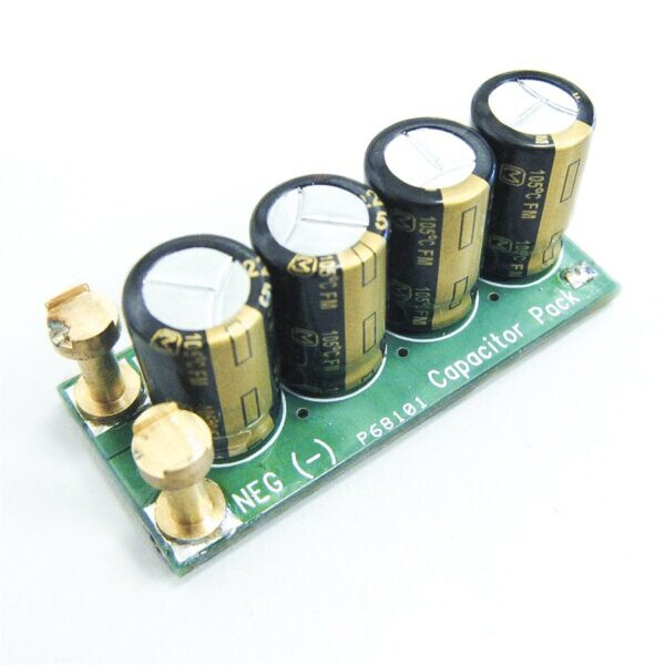

I did a bunch of reading up on Inductance and voltage spikes from long battery wires destroying ESC’s. I am just Using Puaida/ Lingyi’s and with my low power levels have not smoked any ESC’s.
But I would definitely have built my Batteries differently, and My loopkey harness differently too, had I been aware of what I know now. My main positive comes off the battery ~140Mm away from the negative there is significant ‘loop area’ which contributes to inductance as the + and - are not able to run right next to each other, and are also different lengths.
It seems the only downsides to more capacitance is the space required, and tapping the + and - as close as possible to the PCB risk.
I have had range brain for a while, despite never really going for long rides, but the longer the ride, the more inconvenient would be an ESC failure, and with a second battery on the deck in parallel, the more Inductance is possible increasing the likelihood of ESC failure.
So I am intending on building something like this:
My ESC’s have two 63v rated 470UF capacitors at the input. I intend to increase this capacitance significantly with a ESC “wart’.
This could be completely unnecessary. My ESC has 2500 problem free miles/4000KM on it, but I have perhaps only 120 miles with a second parallel battery attached which will more than Double the expected potential inductance.
While I am not going to be roadtripping up the US east coast, I would like to start exploring wider and further and worry les about cumulative inductance or voltage ripple leaving me stranded.
I have found the first post in this thread to be a great read on this topic:
https://www.rcgroups.com/forums/showthread.php?952523-too-long-battery-wires-will-kill-ESC-over-time-precautions-solutions-workarounds
This too:
Perhaps a lot of remote signal issues or VESC quackery can also be remedied by minimizing Inductance of the battery to ESC wires, and ESC’s that are run closer to their voltage limits could benefit greatly with more capacitance added at their input.
I got 18 of these ordered and hope to fit 6 on each ESC input wart:
https://www.mouser.com/en/ProductDetail/Panasonic-Industry/EEU-FR1J101L?qs=55qYoNY87qisN5eDXoM3ZQ%3D%3D&countryCode=US&currencyCode=USD
I have also ordered some Switchcraft 760 and 762 barrel connectors. These are built much burlier than the ones I employ and use at upto 10 amps without issue. These are not rated for 10 amps either but they are far more robust. I also really like my inline wattmeter with the 2.1mm Pin on the input, which does not contact my 2.5 barrel plug. I intend to start feeding it with a SC762 and also have a Pigtail adapter So I can still use my existing 5.5x2.5s and Sc760’s as well.
https://www.mouser.com/en/ProductDetail/Switchcraft/760?qs=yPI4UV3pIw3RhLPOoItSzw%3D%3D&countryCode=US&currencyCode=USD
The Switchcraft 5.5x2.5mm receptacles might be in my future too. They have ones with threaded locking collars, and one does not need to feed them through the enclosure and thread their Nut over the XT30. Most are rated at 5 amps, but there are a few at 7.5. The ones I use now claim 10 amps and seem to have no issues at 10 amps continuous, but I rarely charge at 10 amps, and wire them with heatsinking 16 or 14awg, cause I am sick like that. The Switchcraft plugs and receptacles seem to be the best quality available in this format, So I expect these to greatly outperform the lesser stuff I am employing that has been more than adequate, just unideal.
https://www.switchcraft.com/assets/1/27/switchcraft_npb_637_high_temp_jacks_plugs.pdf?7011
