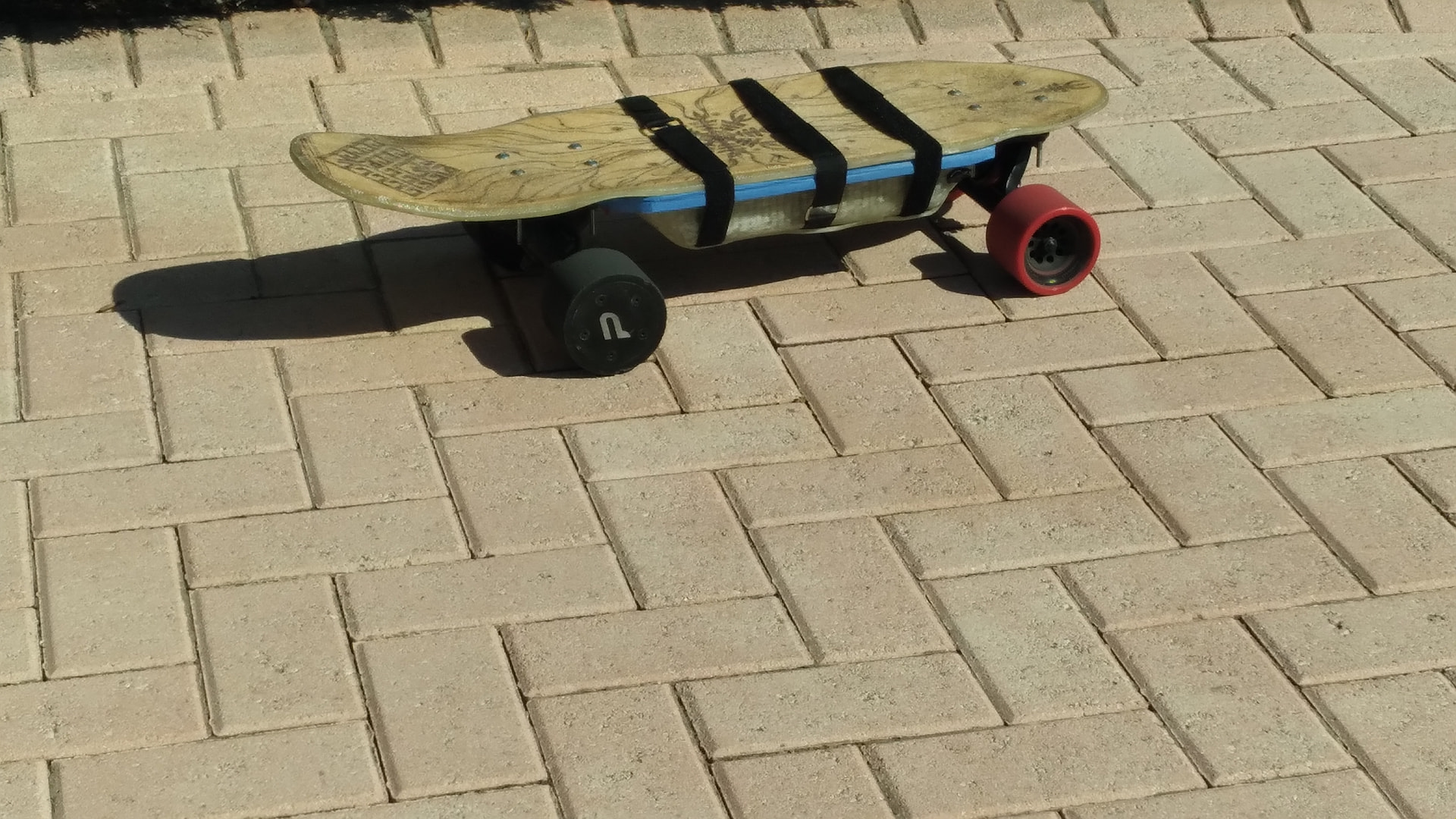

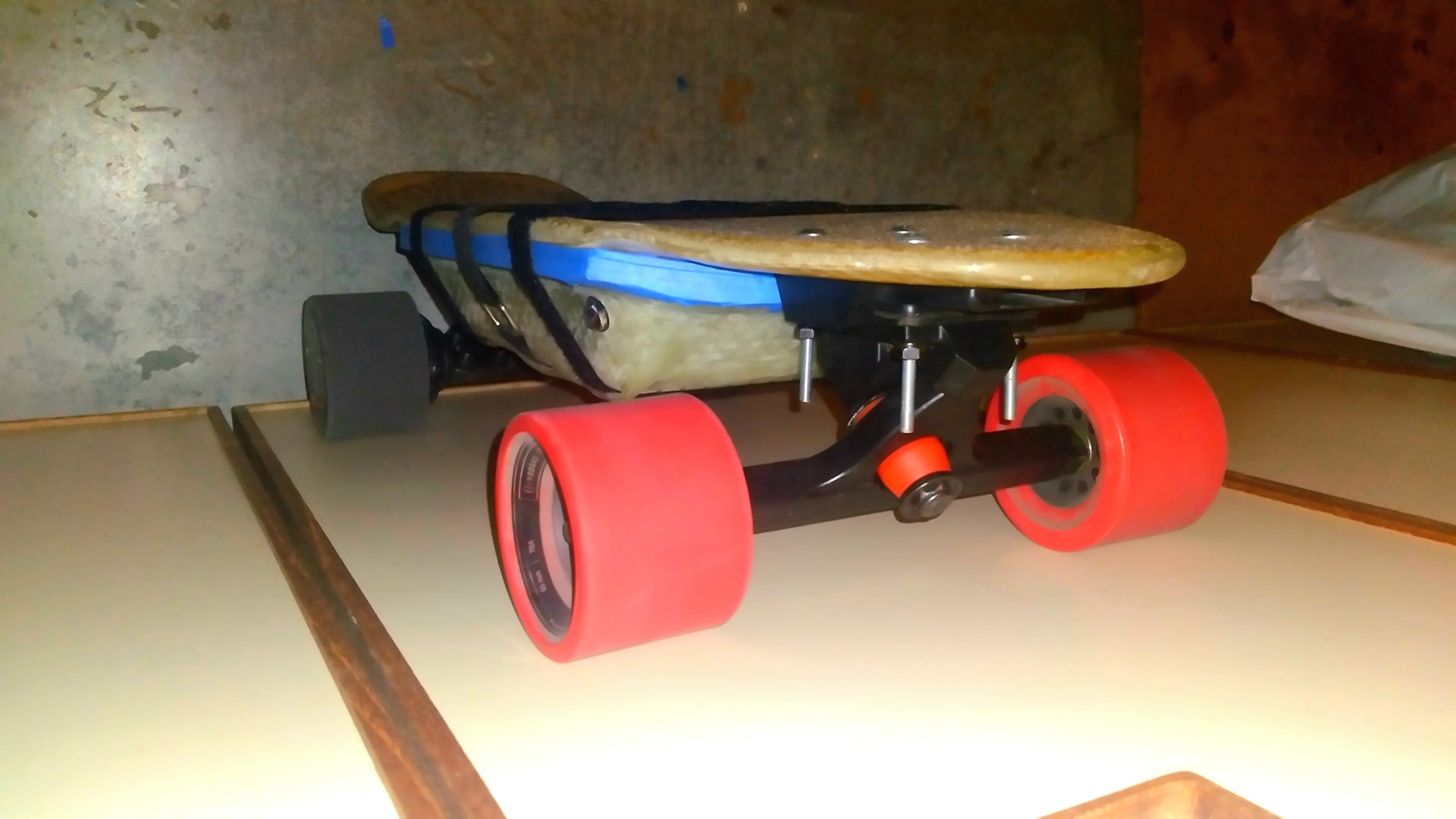

Modifying prebuilt junk, in stages, to be less junk like.
This thing is so fun to carve smooth asphalt on, but I still need to dial in the bushings, and the long wheelbase guppy is the much preferred option for running to the parks with Fiona.
I was trying to get used to my foot being farther back on the kicktail instead of at its very base, just behind the hardware, but it is too easy to wheelie unintentionally even on torque level 2. I’d prefer a bit of a wider stance, but I certainly do not need the length of this kicktail and my front foot is already as far forward as it can go. The kickjtail is largely ornamental and not very good at that. I mostly use it to kick it into my hand or to spin it around by foot when standing next to it.
I certainly will not be doing kickflips, and to pivot turn, which is super rare, I have no issues with my foot at the very base of the flip. With the battery in the back and ESC up front it feels unexpectedly light when pivot turning.

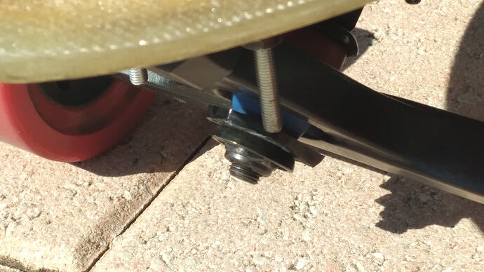

The Guppy with its TKP mountainboard truck, the only way I could get the full lean range and acceptable slower speed turn radius from it was by adding a 1/8”/ 3.3mm thick bushing under the upside down roadside cone cup washer atop the cone bushing, and that truck has a tall red cone that came on Caliber trucks.
Below, I tried the same concept on top of the short Blue Shorty’s doh doh’s cone bushing today, and this feels the best yet, but I find I can still want more lean, especially on toe side turns.
I can just barely spin the cup washer in my fingers. Any looser, and the washer rattles and I cannot stand rattles.
I can get the 80mm front wheel to bite on enclosure when stopped and pressing with a lot of force, but riding, hard frontside/ toeside turns my heels are leaving the deck, and I just want a bit more lean and more turn. I guess I have to try a softer boardside bushing up front next, but might be into stacking to reach the proper height.
The extra long hardware will be cut down to an acceptable length after I at least try dialing it in with the 105mm wheels and sleeves. I am starting to think as long as the guppy is functional that the Mini will keep the smaller urethane, and if I have the guppy in drydock then the mini will get the 105s for the comfort factor when heading to the parks, and where 80mm wheels will stop short in some wider deeper bridge expansion joints and sidewalk cracks annoy the shit out of me.

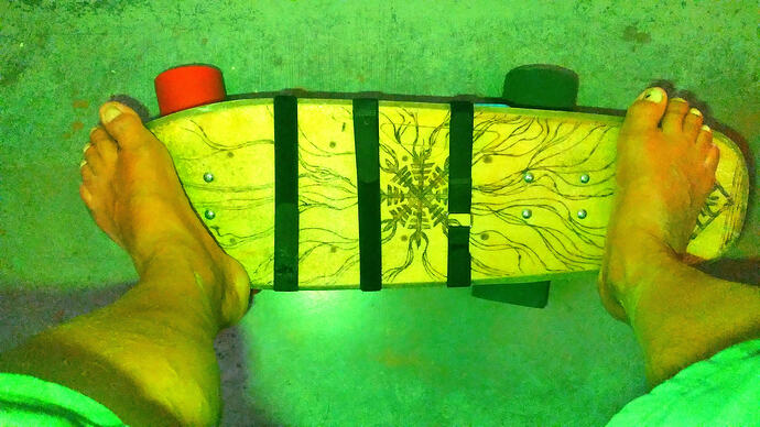

I ride with my foot on the very back edge. Just lean forward, you will become used to it really quickly, unless your remote/ESC has lag.
I recommend using the whole deck, all the way to the back of the tail.
Whether long or short, surfboard or skateboard, since the early 1980’s, I have always changed my foot position, often and frequently, without thinking about it. Both feet.
The mini is forcing a certain stance, and only allowing me to move my back foot, and only a small amount, and only forwards or backwards.
It is going to take me a while for me to get used to this.kkMy icktail muscle memory that first started fading in 1988, was gone by ‘94. I did not put my back foot on a rolling shortboard’s kicktail again until late 2023, and it still feels awkward.
I moved the trucks, shifted the bolt pattern back to where kicktail turns still feel good but there is less leverage when my rear foot on the tail. Makes holding a manual a little easier but I can’t really hold a manual well anyway and could be off base. Still goes off curbs nicely.
Mobydeck and moved it about an inch iirc. The kick is super tame but i like it with a little less leverage
I had considered moving rear truck backwards back when this deck was dual diagonal drive on narrow TKP and 70mm urethane, but decided against for some reason i cant remember at the moment.
I think it had to do with the fitting of it within the kayak hatch without any hanger removal, more than the fear of weakening the thin deck with more holes.
The front hanger removal might be a requirement now, with these wider RKP trucks. I need to check.
This tiny deck was likely not a great choice to invest so much time and effort upon.
I like riding it far more than my midsize kicktail though, which i spent even more time on.
Ive seen (caliber 3?) narrowed by quite a bit successful. Careful cut of the aluminum then snap and finished flat with a tool of some kind on a drill. It’s something im interested in trying as I’ve got all the dyes to cut the axle thread to where it needs to be but i need to find the tool to cut the hanger flat without damaging the axle. Still have a set of neo hubs i want to adapt to the bustin sportster eventually when i give that build a real makeover
When the Mini, was the 7S Diagonal Mini, with narrow 145mm ish TKP’s and 70 mm urethane, it would easily fit tail first, wheels up, into the kayak hatch.
The back wheels would hit the interior footwell, and the nose would then just barely clear the front edge of the kayak hatch. No disassembly required.
So if I were to move the rear truck backwards on the deck, the nose could not clear the hatch, and I would have to remove the front hanger and insert it nose first. Not a huge deal but it was nice to just stuff it in there and then break down the kayak cart and fit that along the sides, saved a minute or two.
The Midsize Kicktail required I remove the front hanger, insert it wheels up, nose first, and then hand lean the rear truck over to get the sleeves to fit past the hatch edges. Very tight fit After I added a roving Halo. Removal of the board caused many a curse fest when the kayak hatch seemed to be a bit smaller from being colder.
I just went to stuff the Mini in its current form into the kayak and the rear wheels would not clear the hatch inserted tail first.
Once I loosened the hanger bolt all the way I could just barely get the tail in, but when the 90mm wheels butted up against the interior obstruction of the footwells, The nose would not clear the hatch opening anyway.
I Would need to shave at least 7mm from the nose for it to clear and then the front wheels might require some heavy leaning and curses to clear the hatch opening, after loosening the rear hanger so loose the bolt would unthread by hand and likely disappear.
So basically tail first with these trucks and wheels is not happening. It could only work with the narrow TKP trucks and 70mm wheels.
I removed the front hanger and inserted it nose first and easy Peasy install and removal. This is actually better as i can then slide the board farther back. the kayak is very nose heavy with Fiona up front and the ESk8, so the mini being lighter and sliding it further back is a good thing from a weight distribution factor. It is hard to steer when it is so nose heavy. I often block off the rear well with wine corks and fill it with water to even it out.
So it seems likely I will be drilling new baseplate holes farther back on the mini, widening the wheelbase, and removing some unneeded kicktail leverage. The longer wheelbase will change the turning radius and feel a bit, but I will adapt.
At Max lean now the front wheels actually bite the enclosure before the deck, So I can slide the enclosure back to split the difference and likely gain a bit more hanger articulation, Which I do not really need.
So maybe I can remove a riser pad and have the whole board sit a bit lower.

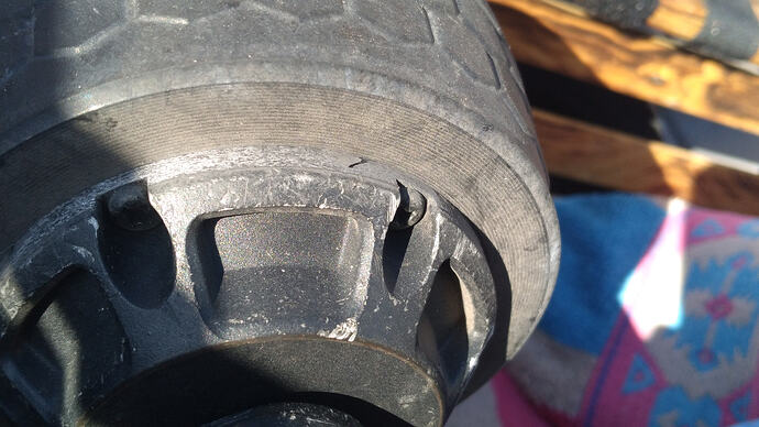

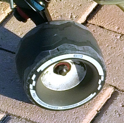

I got around to installing the new Puaida 105mm sleeves yesterday.
I did expect the Nashua Flexfix tape that I installed on motors under Meepo sleeves to be a nightmare mess of gooey adhesive and shredded tape, but it looked fine once cleaned of the black grime.
The Puaida sleeves would not fit with the tape installed for the meepo sleeves, So I peeled it off, and it came off cleanly.
I didn’t try and peel the 12mm wide strip of Nashua flexfix tape off the inner side, as the sleeve sat to full depth on the first try cleanly to my surprise.
The interior piece of flexfix tape looked to be pretty mangled though.
Puaida 105mm donut sleeve does not sit as deeply onto the Motor as do the Meepo 105mm sleeves. The sleeves are the same width but the Puaida sit about 6mm wider on each motor.

Happy to report the new sleeve behavior through this section was much improved in both comfort and control, and so much quieter. Some sidewalk cracks passed without notice even when trying to notice them. I was thinking I need to order another pair of these sleeves then and there.
I hammered the throttle down to 30.3 volts and a beeping ESC, benched the board and busted out the IR gun.
Typically riding this aggressively I would read 159 to 167F max on the inner bearing caps of the hub motors and 121f on the hanger, 118 to 119f on the heatsink. The outer edge of the motor was silver with Meepo sleeves and difficult to get a reading on with IR temp gun so I would finger test the heat.
Today the readings were 141 and 143 on the inner bearing caps, 121F on the hanger 121 on heatsink, and the outer bearing cap which now has a black aluminum cover was coming back at 145 and 151F and the finger test was inconclusive.
I forgot to test the urethane sleeve itself, but since these are aluminum, and fit tighter to the motor exterior, they have to be helping dissipate motor heat to a higher degree than the Meepo sleeves. perhaps this is a contributing factor as to why that one section of sidewalk, some of the cracks seemed to have disappeared since my last roll over them, as the urethane was warmer and softer.
I really hope these new Sleeves do not chunk and fall apart quickly, and I might really order another pair just to have as backups and fear of future unobtanium status, and since they arrived at 30% less $ than Meepo sleeves, and tarriff free too.

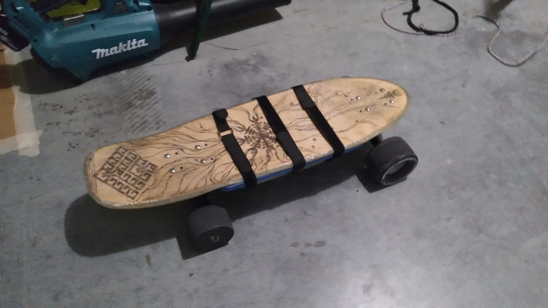

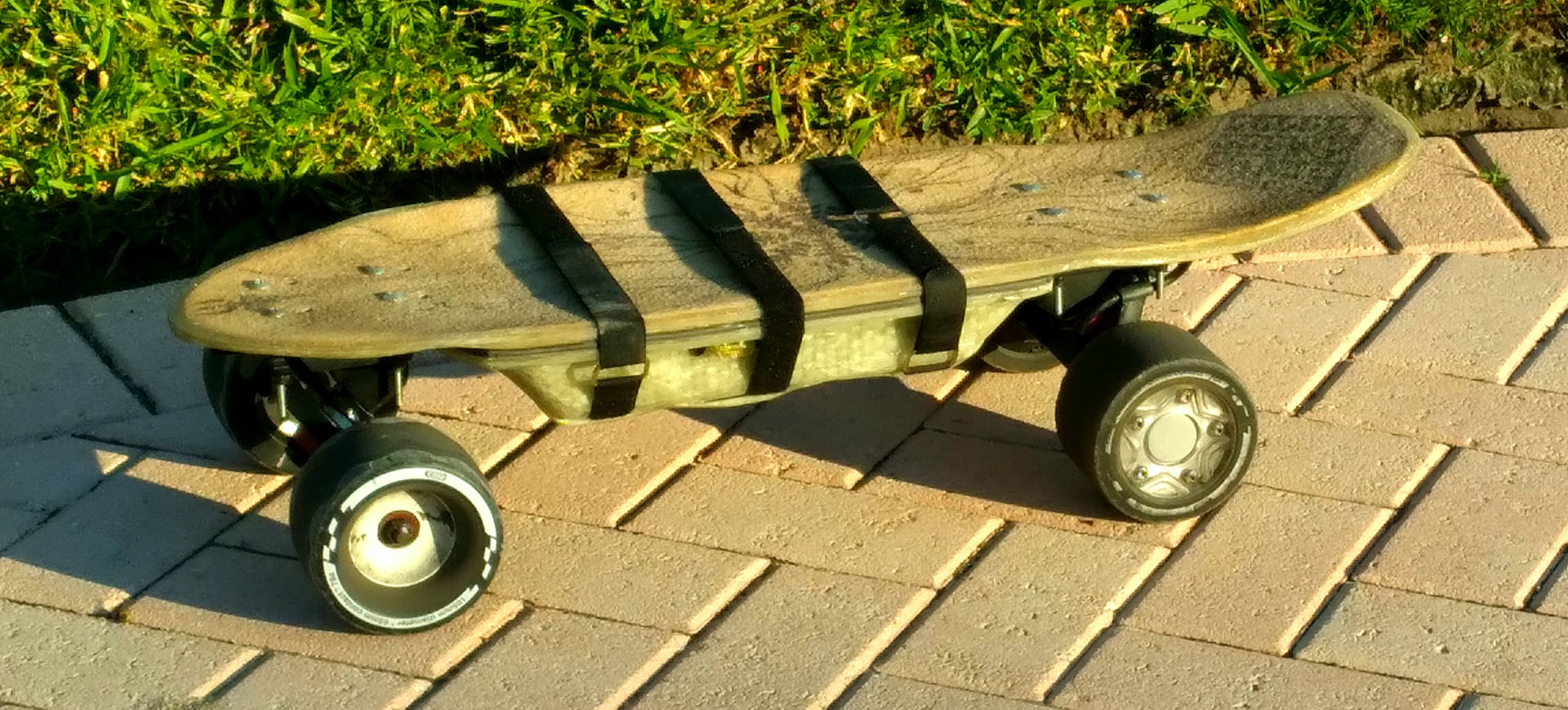

I did move the rear truck baseplate of the Mini backwards by about 20mm, with the expected results.
I am considering moving the front truck forward by perhaps 15mm as my front foot is all the way forward and I have nose dove it a few times stepping onto it when the wheels were inside a paver gap.
My MR60’s have arrived and the Mini will be getting the New smoother ESC with far battery brakes.
I also want to play with the 103mm Meepo sleeves and 105mm wheels on it, see how it feels compared to worn 87mm sleeves on hub motors and 80MM urethane up front.
The Mini with a fully charged Eve 10s1P 40PL and speed level 4 will out accelerate The guppy, and likely could go faster too. The tendency to unintentionally wheelie with rear baseplate 20mm farther back is very much reduced, but It still feels sketch at 20mph.
I am considering dewedging the rear truck a smidge. Doing that to guppy did not have the degree detriment to the turning radius effect, that I expected.
On the Mini, I moved front baseplate forward by a about an equal amount as I moved the rear baseplate backwards.
To position it< i installed the 105’s on the hanger, removed roadside bushing and leaned the truck over all the way, and tried to get the wheels to sit Mid wheel recess, Used a straight edge between the two baseplates, clamped it in place firmly and drilled trying to hold drill at 90 degrees.
To my surprise I could not get wheel bite or enclosure bite with the 105’s, At max lean the turning radius is so tight, that I cannot really notice that it can’t be AS tight as with a narrower wheelbase. It didn’t really feel like I needed to go back to the Inboard 80mm wheels up front when doing high amplitude carves. I was not pushing it quite as hard as the wheels need to be broken in and are not as soft as the 80mm urethane, but I felt no squirrlishness, and smoothness on the driveway pavers was noticeably better.
The Unintended wheelie factor is reduced even further with the front truck further forward and with heavier larger wheels up there.

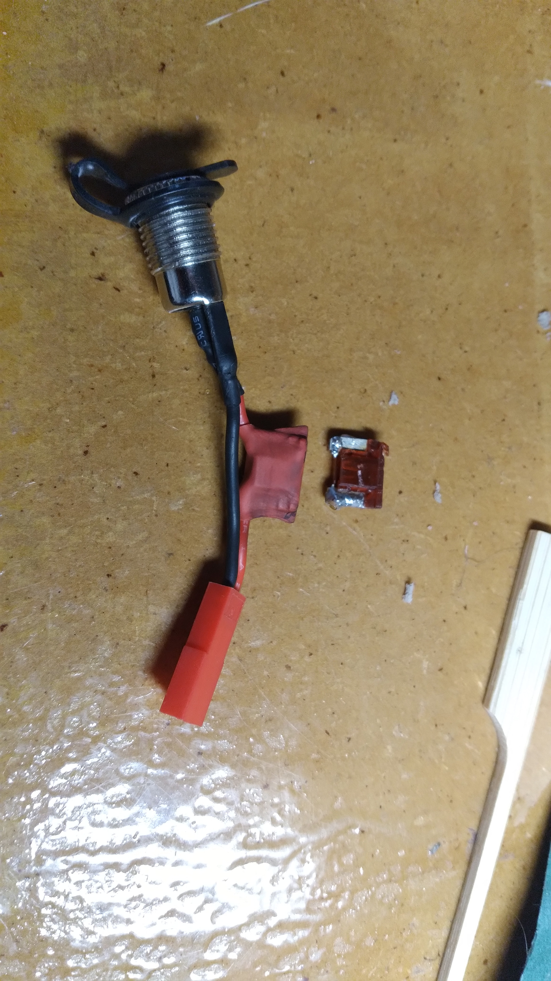

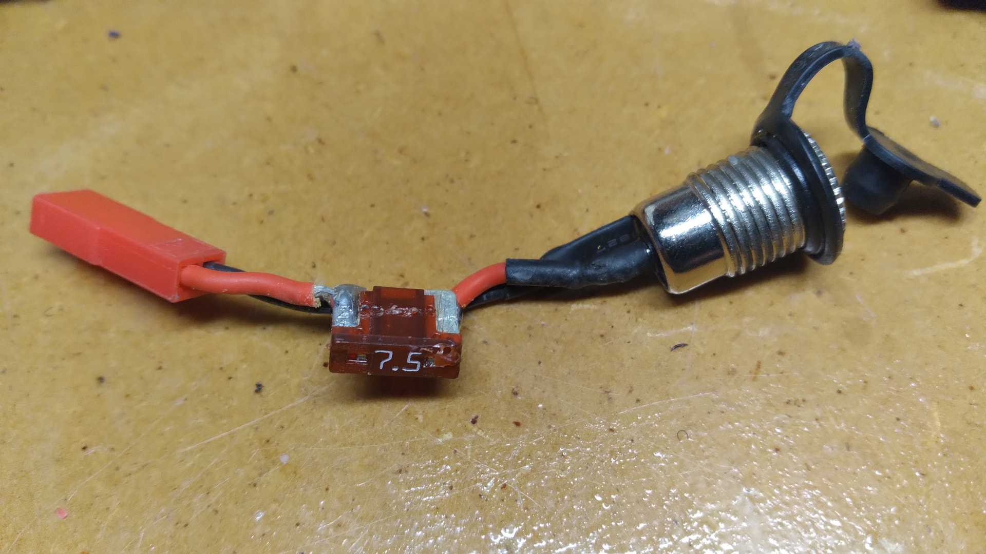

When we walked the full length of the park, and I went to disconnect charger, I saw No current flowing and BAK battery was 37.4ish volts iirc. We rolled about 4.5 extra miles in our neighborhood, until the ESC was beeping at me.
On the bench the battery was 30.7v actual, hub motors were less than 155f, the ESC heatsink was 121f, the hanger was 112f.
The enclosure away from battery was 85.5f, the enclosure right atop the battery was 94.5f, and when I loosened a velcro cinch strap to read the enclosure under it, , which was somewhat protected from direct airflow, it was 96.5f, So the fiberglass enclosure is definitely sinking some heat from the battery which is resting on foam.
I pulled out the 7s2p portable charger and disconnected the 7s1P from its charge port, and the 1P read 25.3v, Hmmm, should be lower, WTF?
The 7s2p’s BMS will not allow voltage to be read on charge port, so I lowered my Vbooster to 25.2v, and plugged it in to charge, and dialed up voltage until current started to flow.
Current never started to flow.
I must have blown the soldered inline 5 amp charge port fuse, so at some point, the 7s1p had to be feeding the 7s2p, and the Booster together well over 5 amps for some period of time.
Or the BMS has failed. Will investigate another time.

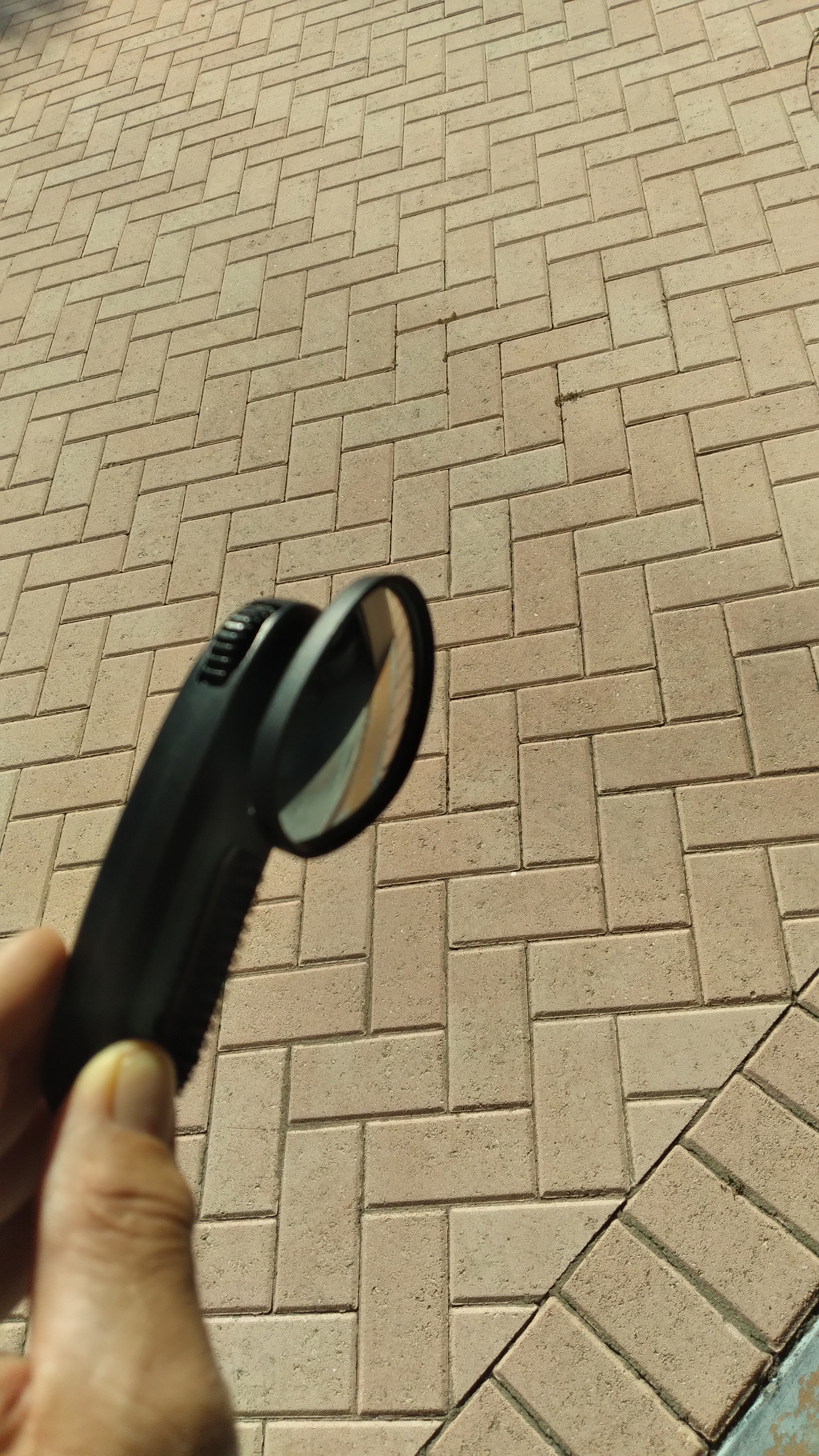

I ordered some Bike handlebar rear view mirrors, to try on my remote, and so far my impression is positive. Looking into the mirror at arms length over left shoulder, I can see pretty well behind me. Looking over right shoulder is less intuitive, so far.
My 7s2p portable charger Did blow its charge port fuse with the 7s1P plugged into it. I am not sure of the voltage Delta at the time, but they had been in parallel, unloaded, booster off, for a several miles when I took it back out, pressed the button to power the booster, and plugged it into my depleted BAK45D 10s2P charge port 285 watts were flowing when I started walking.
I thought it was a 5 amp fuse, but it was a 7.5 amp. 58vDC rated.
I still have difficulty believing that 5 amps were flowing, much less 7.5 amps.
At 285 watts output from booster, the 2 batteries in parallel are having to provide 11.4 amps out of the booster, and at 90% efficiency this should be 12.5 amps into the booster.
The 7s1P is now 25.30v t, the 7s2p is now 23.36v, and I do not know how long the 7s2P had to carry the booster load solo after the fuse blew.
I wonder if my soldering the 7.5 amp fuse weakened it and reduced its rating, or somehow there was actually 7.5+ amps flowing from 7s1P into charge port of 7s2P.
I have 10 more 10 amp 58v rated LP mini Bussman/Eaton fuses ordered, as I seem to be really good at blowing charge port fuses.
I think I am going to return another 7.5 amp fuse into this and just turn booster down to ~250 watts output, or just not plug in the 7s1p to charge port.

I didn’t have the new fuse soldered into the 7s2p portable charger’s charge port, and wanted to roll, with a backup charging source.

Just soldered the new charge port LP mini fuse, and even remembered to slide the heatshrink over it beforehand. It’s now charging it at 51.7 watts.

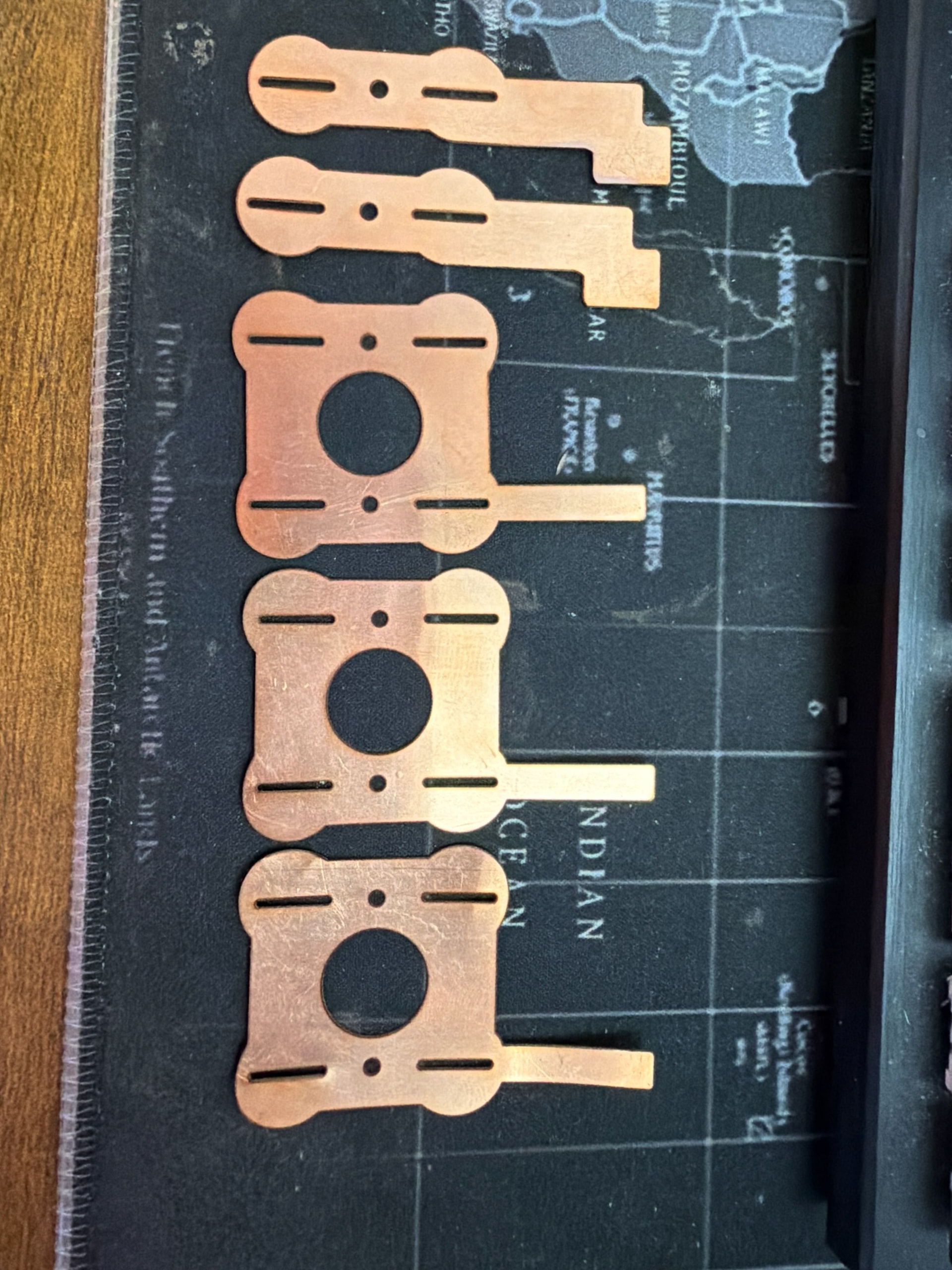

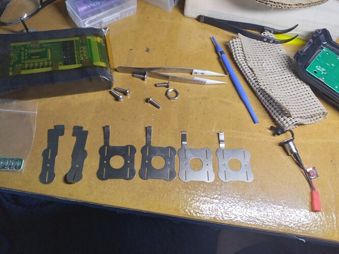

The 0.2mm Nickel steel busbars below, came with my 10 cell 21700 Makita 5s2p kit.
I scanned them and emailed them to Nelvick @DIY500AMP.COM and he did some magic and had his laser cut them out in 0.2 and 0.3mm copper
I am going to use 10 BAK45D to build a 9.0AH Makita 18v nominal battery for my leaf blower. I only have 4, 4.0Ah stock Makita batteries, and they get super hot and do not last nearly long enough in the blower, so this should be a HUGE improvement.
Nelvick is going to be carrying the Makita kits in his store, so this will likely be the first of several Makita battery builds, as my stock Makita batteries degrade further.
I have not yet welded a single layer of 0.3mm copper, only dual 0.15mm stacked, or 0.2+0.1mm, to accrue that thickness. I expect a single layer of 0.3mm to require more power, but time will tell.

The prebuilt 7s2p looks like it was built with 0.1mm nickel plated steel and some of the sharp edges of those strips was smushed up against the tangled balance leads near the BMS. I tried to get some fishpaper separation in there, but Should likely not have trusted this battery this far.
I will cut the heatshrink and inspect, when the Eve 35v 7s2p is ready to be built.

I reinstalled my 2022 Lingyi/Puaida with the weaker than desired brakes, and the Mini is now fully functional again.
The loss of torque going from worn 90mm to worn 105mm motor sleeves is not really a factor.
On speed level 4 it feels faster than it really needs to be, at least solo, and the brakes are OK too, solo, but towing Fiona adds close to 90 Lbs of extra mass to move.
The Meepo 105mm front wheels still have some noisy ‘tread’ which needs to wear flatter, before I really push it hard when high amplitude carving.
I am not sure this board really needs 105mm wheels for what I am going to use it for, but going back to 80mm up front and worn 90mm motor sleeves, is a pretty quick process. I do have new 90mm sleeves too.
I do like the stance with the wider wheelbase and the 105’s.
I should drill the holes for inserts and paint the enclosure, If I really cared about anything other than function.
The loopkey is certainly tucked high and tight.
Can barely see it here.
What is the total length of that deck, and what is the distance from the rear axle to the tip of the tail?
Good thing you had a fuse there. Imagine if it was just overcurrent without one, what kind of far worse things could happen.
It is 28 3/8 inches / 72 centimeters tip to tail on the deck.
The tip of the tail is now 7 9/16 inches / 19.21 CM from axle center.
With 105mm wheels and sleeves, it now weighs 18lbs 13 oz / 8.53321 KG.

I want to try dewedging rear truck and maybe adding wedge to the front.
I am currently stacking rubber and plastic risers and want to make new Bubinga risers no taller than they have to be.
The rear truck definitely feels more turny than the front and gets super twitchy at speed even tightened way more than I like.
Once I dial in the wedge/ dewedge I will drill and add the inserts to get rid of the velcro cinch straps.

The 105mm wheels seem bite the centered enclosure, and deck at same time, at such a hard lean angle, that it is going so slow as to not be dangerous.

If you stand on the nose and the tip of the tail and lightly bounce on it, does the back axle have like a suspension effect where the deck is flexing under you?
Yes, It is a pretty thin deck, and does soak up some road irregularities with back foot all the way back on kicktail. I added a lot of fiberglass. It is encased within fiberglass. and the perimeter has at least 9mm of roving and the roadside has 1 layer of 24oz/ 800 GSM woven roving, and 2 layers of 7.5oz cloth.
It’s just my back foot prefers to be at the base of the kicktail, and unconsciously finds itself there.
Hitting road warbles at higher speeds with my foot farther back, just has the ass end super twitchy and somewhat alarming so.
The torque wheelie tendency is much reduced with the back baseplate moved backwards(and front forwards), and the turn radius at slow speeds is still excellent.
I do want to try dewedging rear baseplate. An ~ 10 degree dewedge did not seem to negatively affect the Guppy’s turning radius as much as expected and I have grown to love how the guppy handles both slow and fast, and they have the same rear truck, and both have JBweld boardside bushing hanger cradles mimicking a cup washer, Which really helped bumpsteer.
