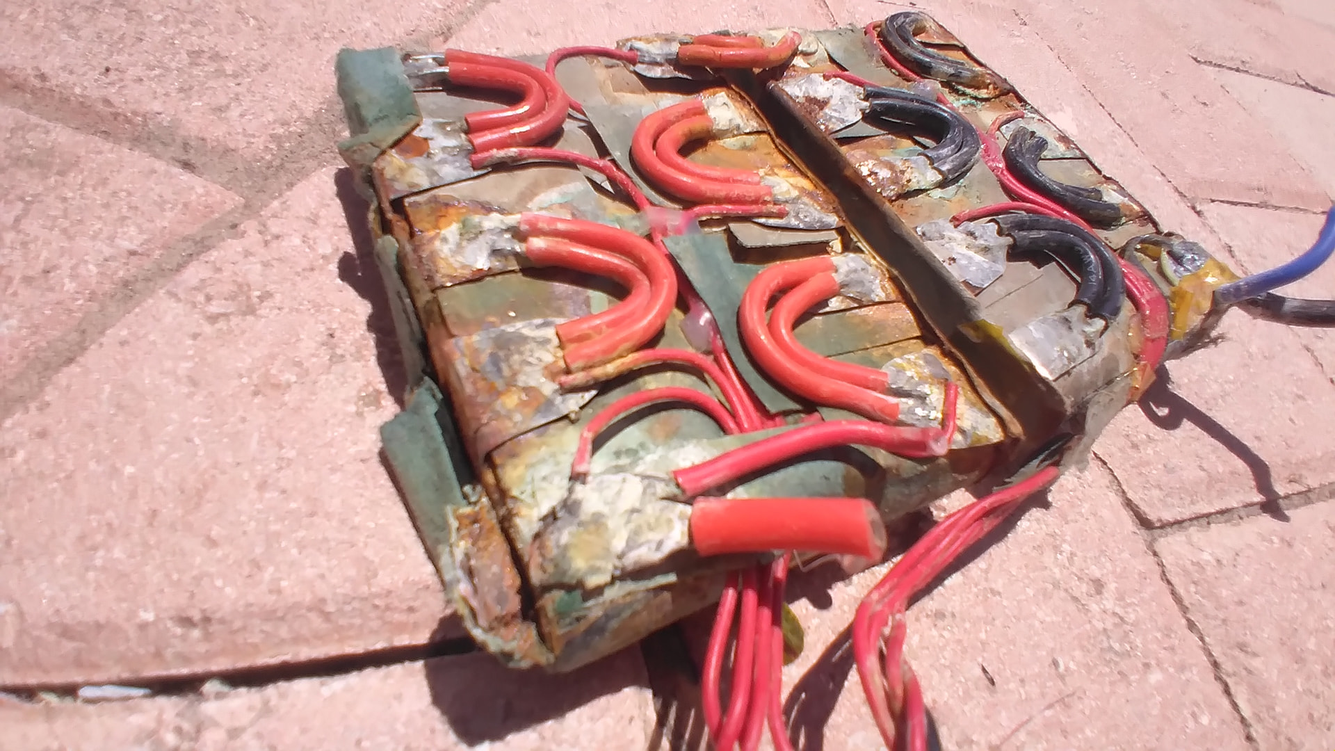

it was about a year ago I finished my second Esk8 battery, a 10s1P P42A, with 0.1mm copper under 0.1mm Nickel plated steel, dual 14awg series, and was kind of blown away at how much more torque there was compared to the relatively high mileage 10S2P of DMEGC-26E.
Unfortunately, that battery lost its life being unintentionally submerged in the bay
I was able to get upto to 5.5 miles of range with that battery if rolling conservatively, and it was getting close to 60C if riding more aggressively for 4.2 to 4.5 miles.

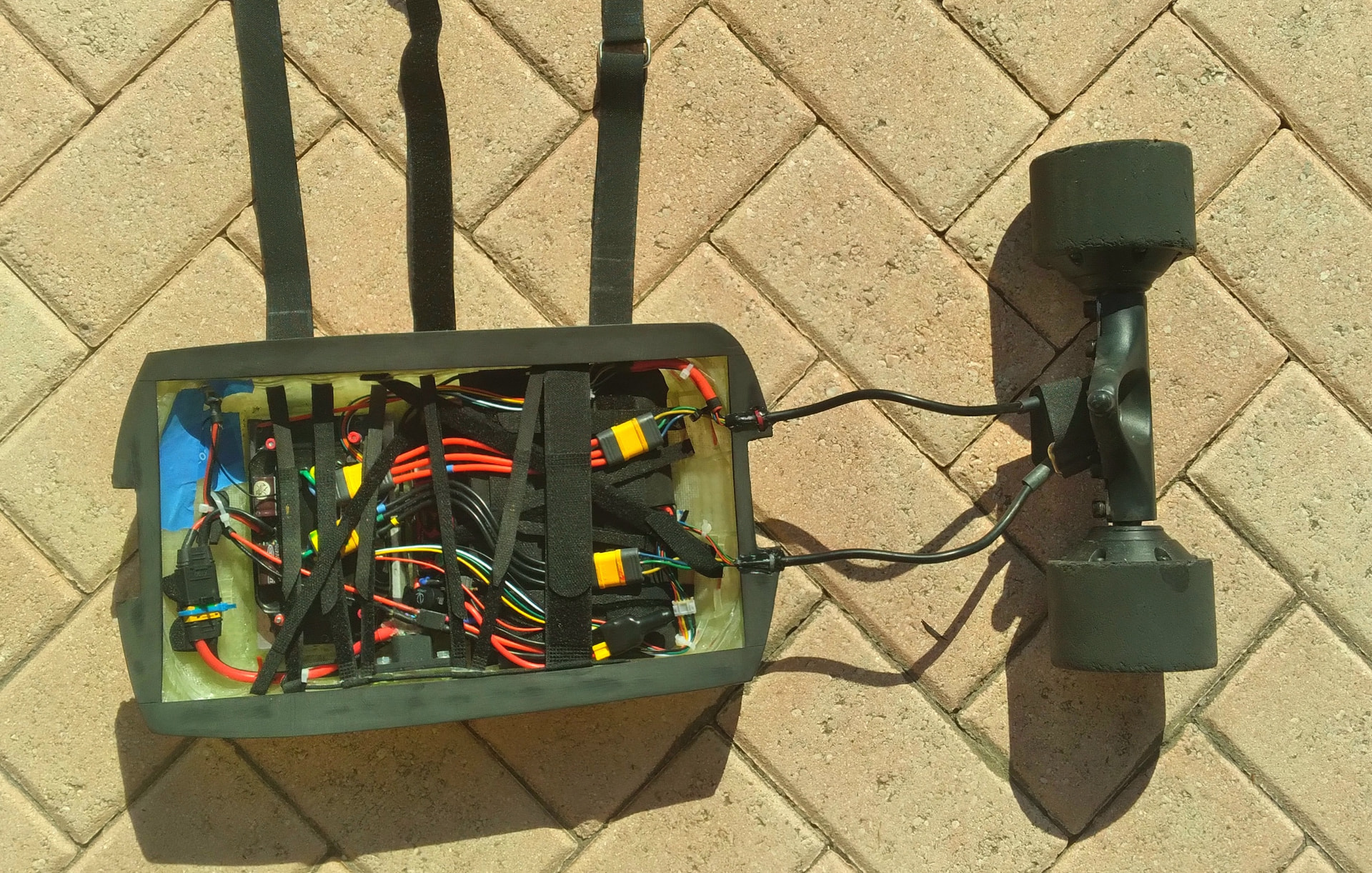

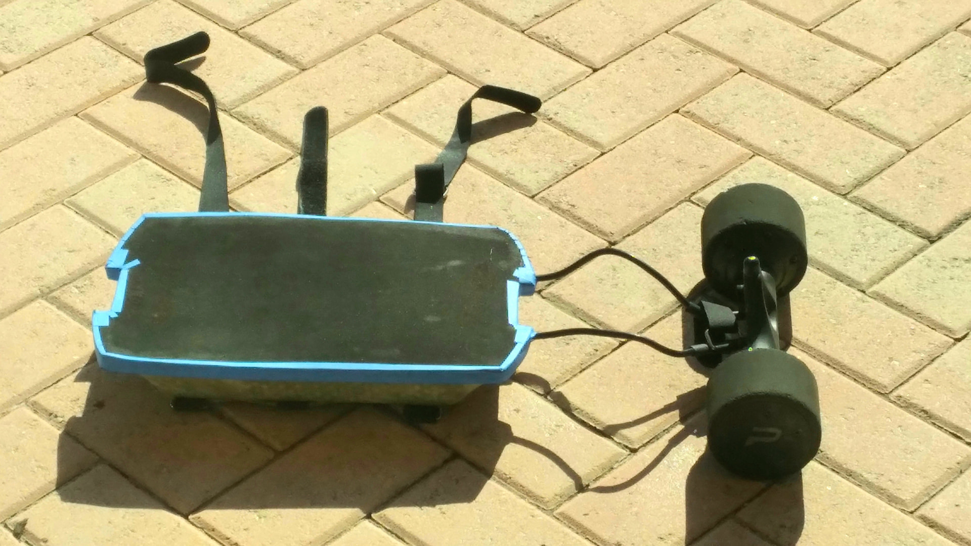

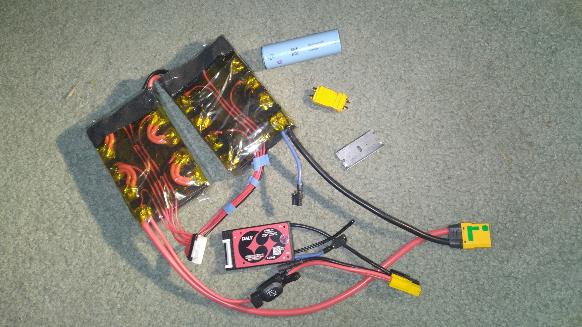

This is the 7s2P enclosure which came with my sub 300$ Junkking kicktail in October 2023.
Its 7S2P double stack battery is made with 2000 mAh cells of an unknown brand and CDR. No doubt junk.
It claims 103.7 watt hours.
The 7S ESC which came in this enclosure had dangerously horrible brakes that threw me a few times, when I was running it on the Diagonal Mini with its 70mm hub motors.

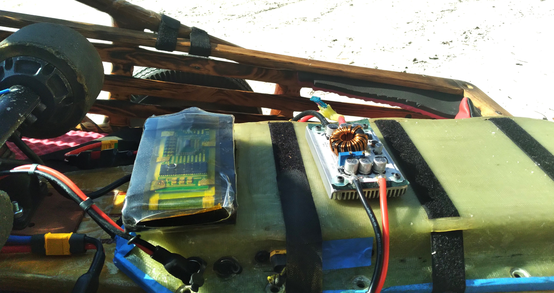

I removed the stock thin aluminum plate ESC heatsink it came with, and installed a larger much thicker one, and then attached the deep finned heatsink to that.
Onto this heatsink I installed a voltage booster rated at 10 amps input current, but that has a 15 amp fuse. I have pushed it as high as 350 watts output, charging my 10S esk8 battery from 7S, but 250 watts is more realistic without a fan blowing over the finned heatsink.

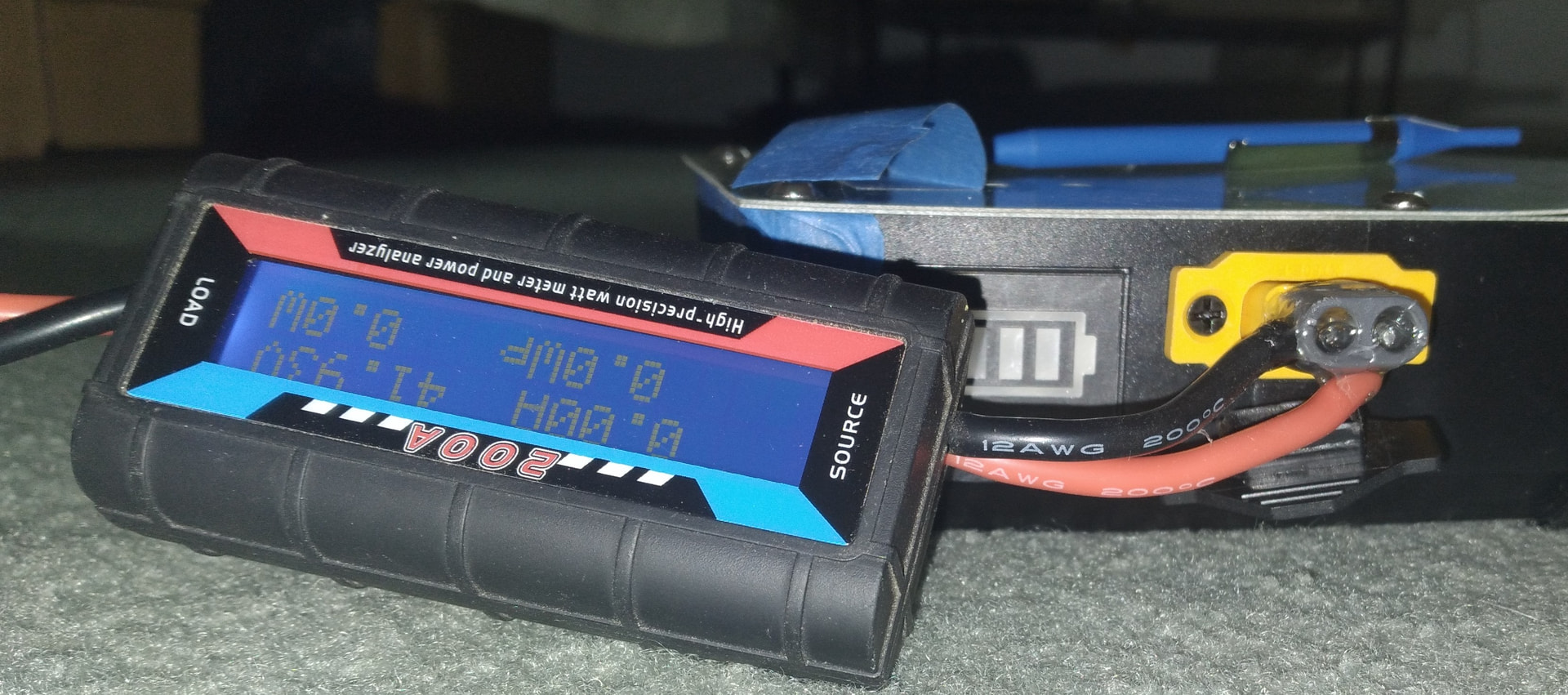

I am going to dedicate an inline wattmeter with an XT60 direct to the Charger’s output and a 5.5x2.5 to the Charge port on Esk8 over 12 and 16awg. This wattmeter above is one of my two best, but the far Anderson powerpole is attached to a 5.5x2.1 barrel connector which still fits a 2.5mm pin, but which came with thin 20 awg, maybee even 22 awg from a 7S 40 watt charger.
This wire was getting hot and slowing down the charging potential.

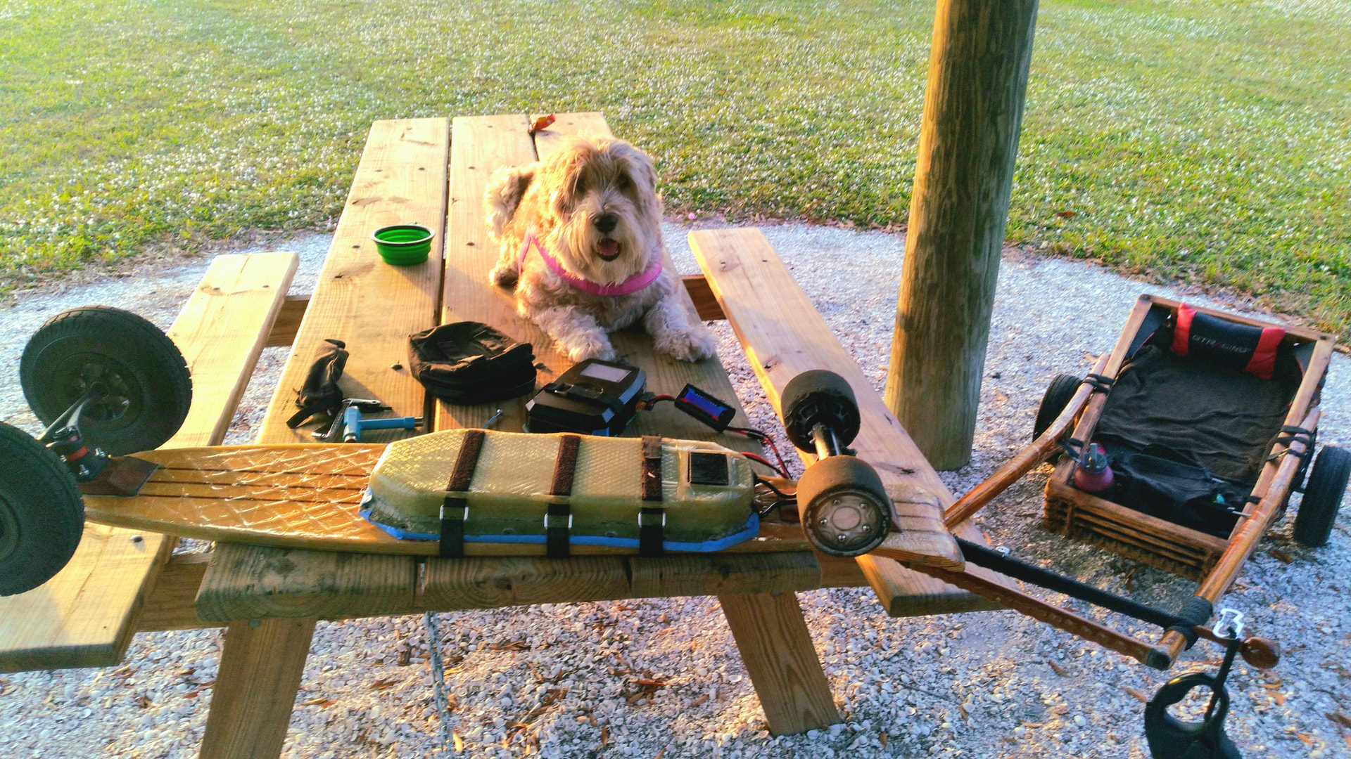

We rolled to a new to us spot, and had this little beach between Million dollar mansions with their own private beaches, all to ourselves.
The road to this spot has a sidewalk but I was getting on the smoother 40 MPH road after a line of cars passed and full throttling upto ~25mph for as long as I could until more traffic approached behind me and I braked and returned to sidewalk and let them pass. Was feeling a bit sketched out going 25mph on an unfamiliar road surface.
Fiona absolutely loves to play ball on the beach, even more so, to swim after it.
She was not acting like a 12 year old, her goofy inner puppy re surfaced and she was all reinvigorated barking at pelicans and prancing around like she did at half her current age.
Great to see!
After she eventually got tired, We walked and rolled to explore a few more miles but did not find another spot to chill out that was nearly as pleasing.
So we rolled back to the same park where we had charged at 170ish initial watts. The speed limit on the narrow road is 40mph and the sidewalk is kind of rough with deep soft sandy sections in the shade so hard to see. There was a lot of traffic, and I was a bit annoyed at how many decided to match my sidewalk speed and start taking video of Fiona in her chariot, while cars behind them got impatient, all too ready to cross the double yellow to pass.
When we got to the park, this time, the Esk8 battery was low enough that it accepted the full 250 watts from the portable charger, until the 7s2P LVD kicked in. It got the 10S Esk8 battery back upto 39.4 volts while we just chilled out and barked at pelicans.
Its only about 2.5 miles home from here, but It was nice to have a lot of battery left, so we took the extra long route, with a lot of full throttling top speed runs, to hit the 4th park of the day, and nearly double that distance.
Not sure of the total mileage on this outing, as the trip odometer resets when the ESC shuts itself off, and I did not keep track, but it is likely our longest journey yet at 13-14 miles, and we returned to 35.9 volts on the remote but which measured 36.26v on the bench via the wattmeter.
We are definitely going to roll to the little beach far more often from here on out, especially on the low wind days with an incoming clean green tide. I could likely make it here and back without the portable charger, But it is nice to have that extra throttle and torque and potential range.

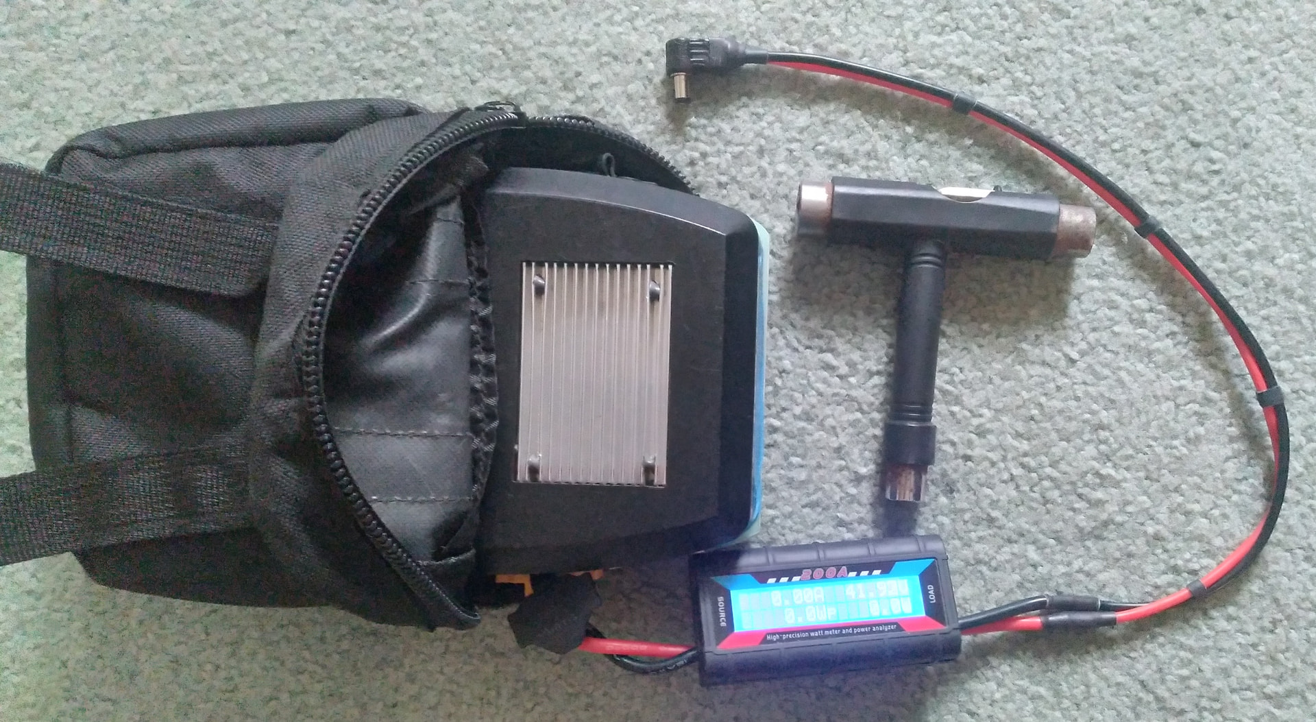

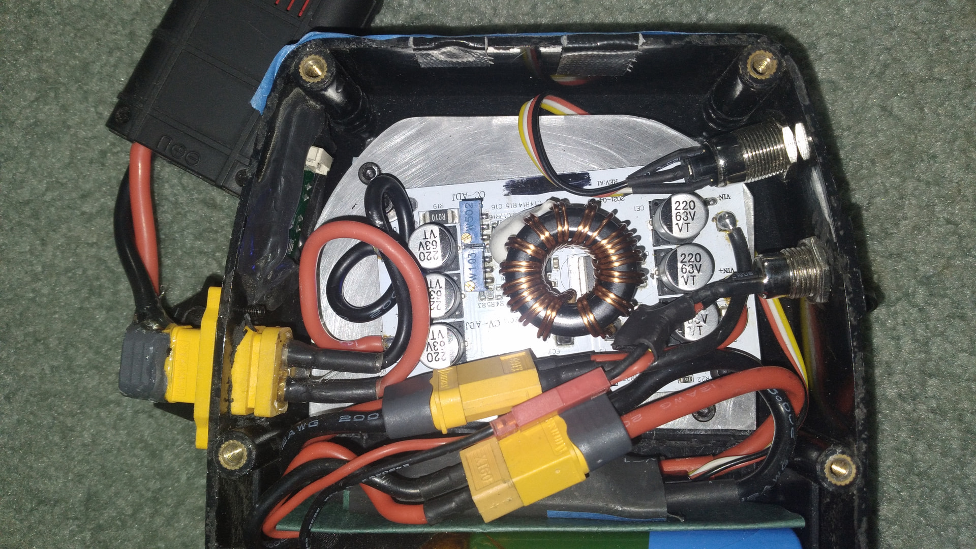

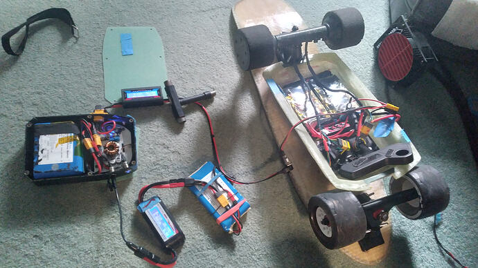

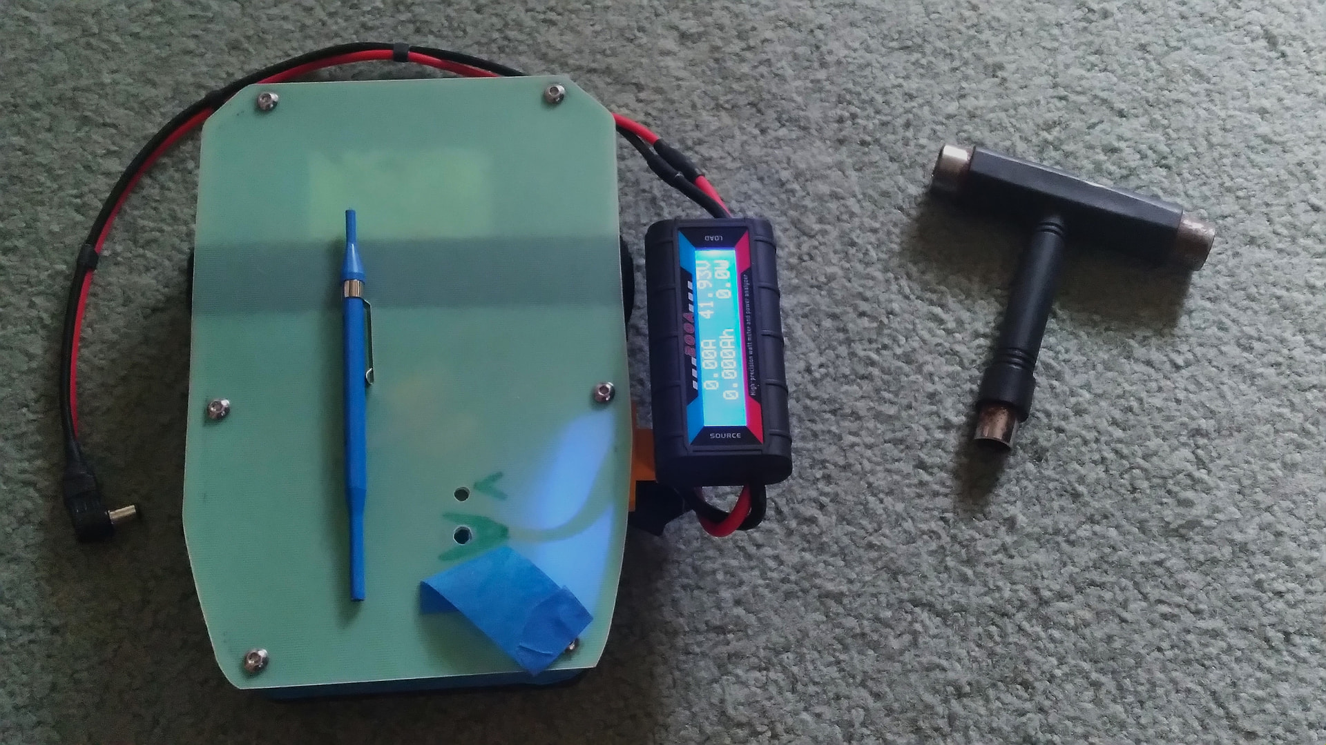

This is my portable charger, Not quite finished, but fully functional.

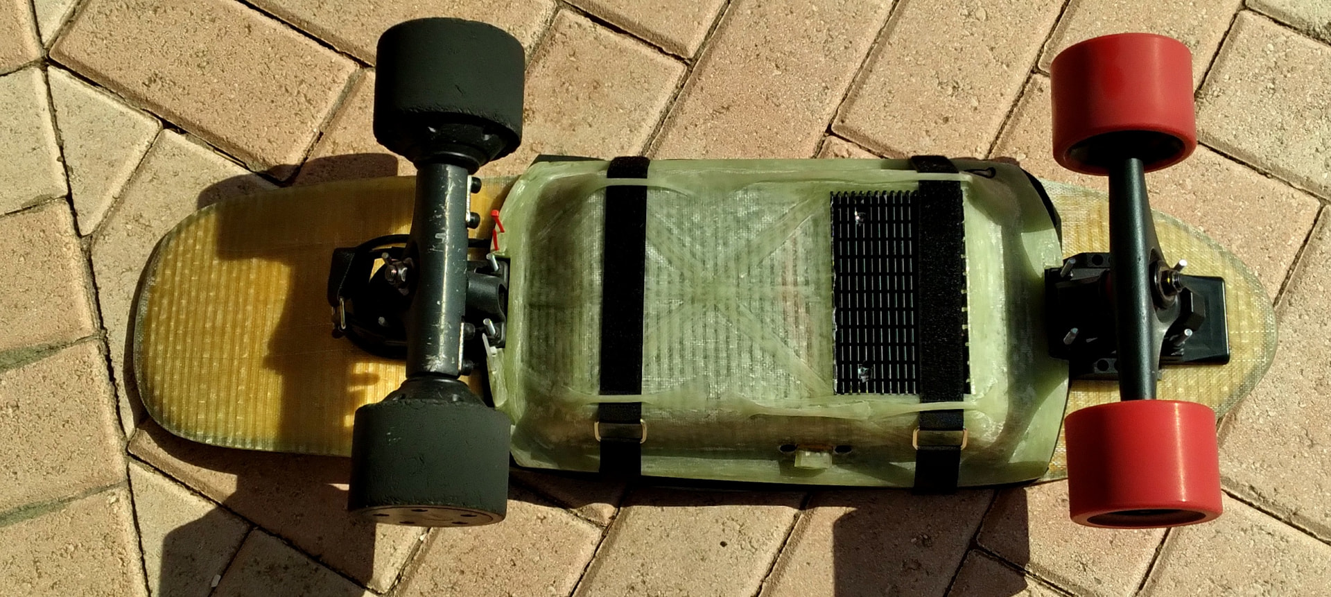

The old 7s2P enclosure which came with my Junkking sub 300$ prebuilt kicktail in October ‘23.

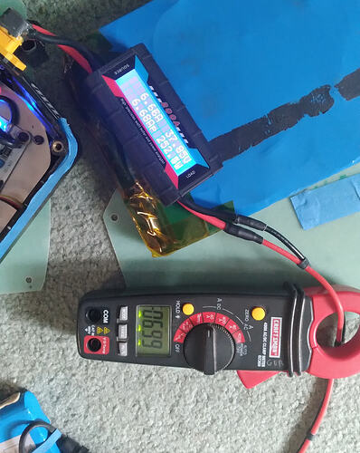

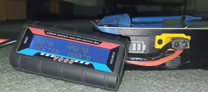

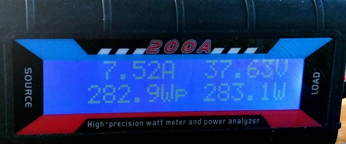

This specific wattmeter unfortunately reads about 0.2 volts high, and about 0.2 amps low, through out the full voltage range and upto 250 watts. I tried to get the wires to exit the XT60 panel mount as closer to 90 degree exit. I crimped 14awg to the 12 AWG and shoehorned that 14 AWG into the 90 degree 5.5x2.5 barrel connector.

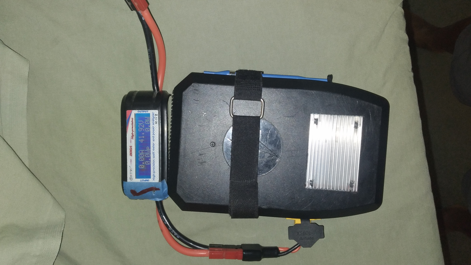

This visible finned heatsink is screwed and JB welded to a much thicker plate of aluminum than the one that the enclosure came with.
I trust this clamp on meter as it has closely aligned with many other shunted ammeters in the past.
There is a ‘600 watt’ voltage booster mounted to this aluminum with thermal grease. 600 watts in quotes as it is basically rated for 10 amps input, and has a 15 amp fuse. I have pushed not this specific booster but another of the same model to the point where I blew the fuse, somewhere north of 20 amps input, boosting from 12v nominal. It much prefers to be boosting from 25.2v nominal.
With a big heatsink and some airflow, I will allow upto 15 amps input continuous, but it gets pretty hot. I have had it feed my Esk8 battery 350 watts before but dialed it down to 250 as the heatsink gets really hot, and the 7s2p just sags so hard that the LVD kicks in having delivered far less Wh than it could at 250 watts.
The supposed 103.7wH 7s2p 4.0ah battery this enclosure came with is made from claimed 2000 mah unknown cells. pretty sure it uses 0.1 Nickel plated steel too. It still seems to have a decent amount of the capacity left. It will accept 3.68AH charging from 23.32 volts/ 3.33 volts per cell. I intend to wear it out much more before making a new 176wH 7s2p with EVE 35V, and copper, and a higher quality 7S BMS.

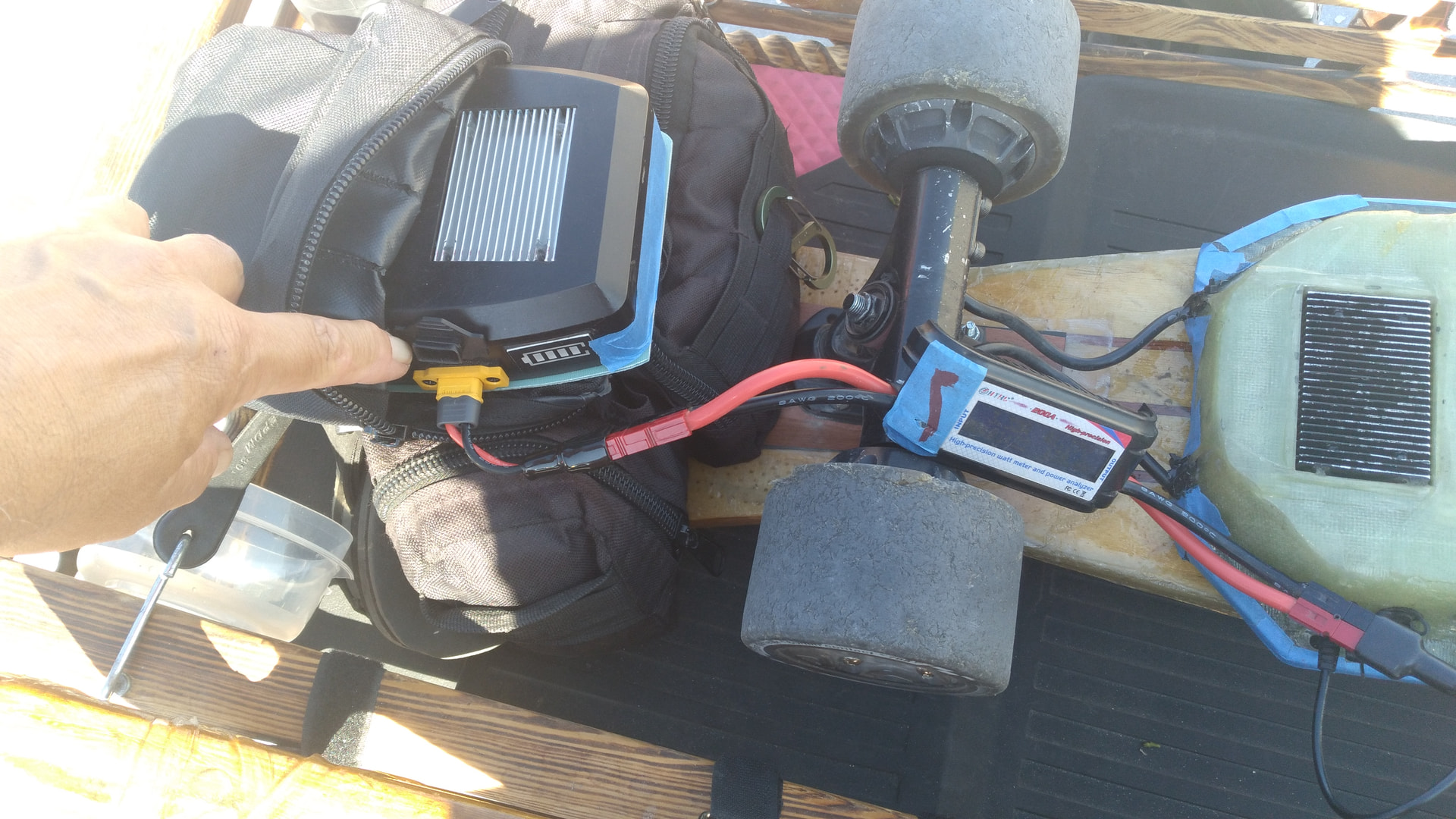

Below I am charging the Mini’s10s1p Eve 40PL with the portable unit.
I also have a 7s1p plugged into the fused charge port of the 7s2p, via a 5.5 x 2.1 plug which came on a 7s 40 watt charger and is only 22 awg . It is currently a significant choke point as the 7s1P delivering less than a third of the total wattage going into the Eve 10s1p. I intend to purge the 22 gauge for at least 18 gauge, so It can better keep up and share more of the load. but that is no priority right now.
I bought a 3 pack of these Bourns potentiometer screwdrivers. The regular jeweler’s screwdriver loves to slide out of the groove, so this is much easier and safer. I will find the appropriate size plugs rather than use blue masking tape.

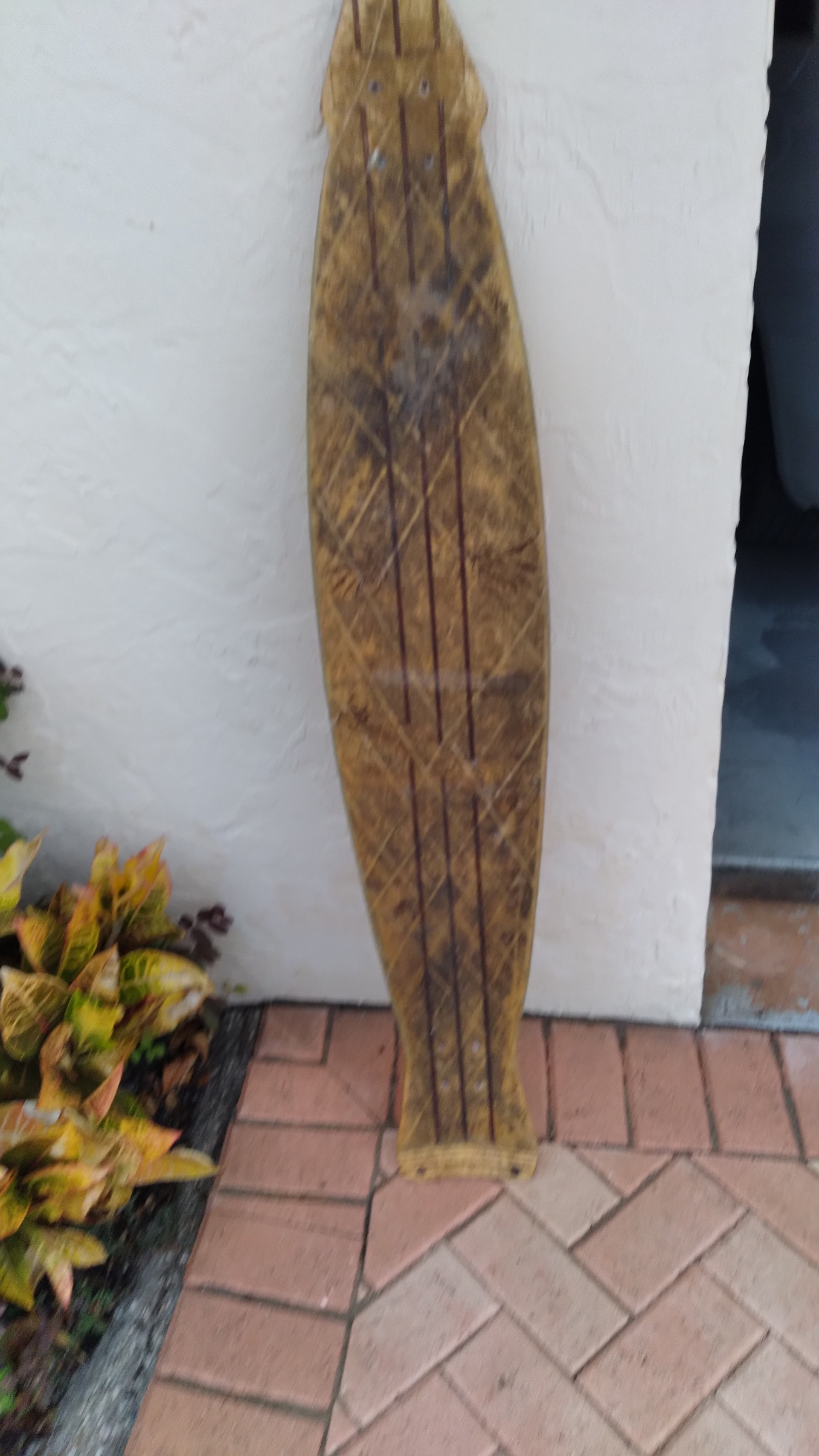

With the deck all damp, and Dirty AF with what must be well over 500 miles of road grime and Sun baked foot cheese, I removed the baseplates and hosed off the brown sugar textured epoxy grip.
It cleans up nicely with just water, but a scrub brush and some dishsoap gets it a little bit better.

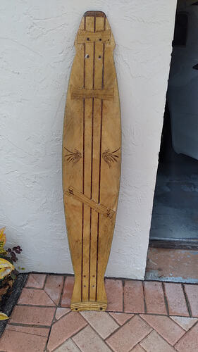

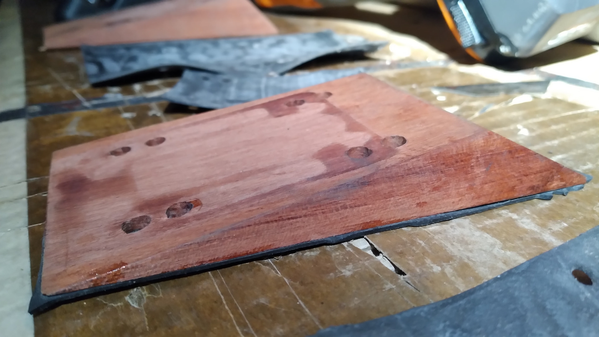

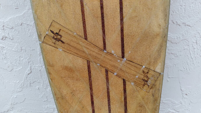

Sometime around 2014 I added the White Oak butterflies to this deck. They are about 5/16 inches thick.
When I first made this deck in July 2003 with Finnish made Baltic Birch plywood, I used a Biscuits and some wood glue to attach the 3 Mahogany Stringers. Some of these Joints opened up nearly immediately, and I wound up making a new deck, without stringers, and rode that for a decade before breaking that. When I busted this deck out of storage, a new sheet of 5x5’ Finnish birch plywood was near unobtanium and unaffordable.
I hand razored the outline and chiselled to depth and epoxied in the White oak butterflies across the areas where the mahogany had separated from Baltic birch plywood. This board was always super flexy an got a bit more so, but the butterflies were keeping it together. It got more and more flexy as the analog miles accrued, and I added some Roving for under back foot, and then just a few months ago added a lot more roving/ Fiberglass tow/ Finrope, unidirectional fiberglass to the perimeter and to the deck and hull.
This significantly stiffened up the board but without adding very much weight, and I felt a lot better going faster and hitting bumps.
I noticed the Roving, where it crossed the rearmost butterfly on the deck, had turned white where baltic birch met Oak when under compression.
This does not seem to have effected the strength since the top of the deck is under compression and the underside fiberglass shows no Stress in the same area. I will keep a close Eye on it and add more fiberglass to perimeter and underside if I do notice the flex increase or any other signs of danger.

My 103.7wh 7s2P portable charger setup was down at storage voltage, but my 6S1P Samsung 50E was closer to 90% charged, and we were ready to go.
So I took it, and my white ‘600 watt’ voltage booster, to charge my 10s2P BAK45D esk8 battery at 175 watts at our destination.
Neither the Samsung battery, or CCCV booster got too hot at this charge rate. The 6s1p Samsung battery is only rated at 9.8 amps and when I last pushed it that hard, it hit 60C way earlier than expected, so this time I dialed in about 7.5 amps on the input and I don’t think it got more than 45C by the time I disconnected it.
The input wattmeter claimed to have delivered 92.3wh (of 108) and 4.382Ah (of 5.0ah) to the booster, by the time I disconnected it, when esk8 battery was accepting 0.14 amps at 42.08v
Samsung Battery had rebounded to 3.11 volts per cell, 18.66 volts, by the time we returned home.
We left here fully charged, at 42.05 volts, with a lot of full throttling on the way home, appreciative of the torque and 25mph top speed.

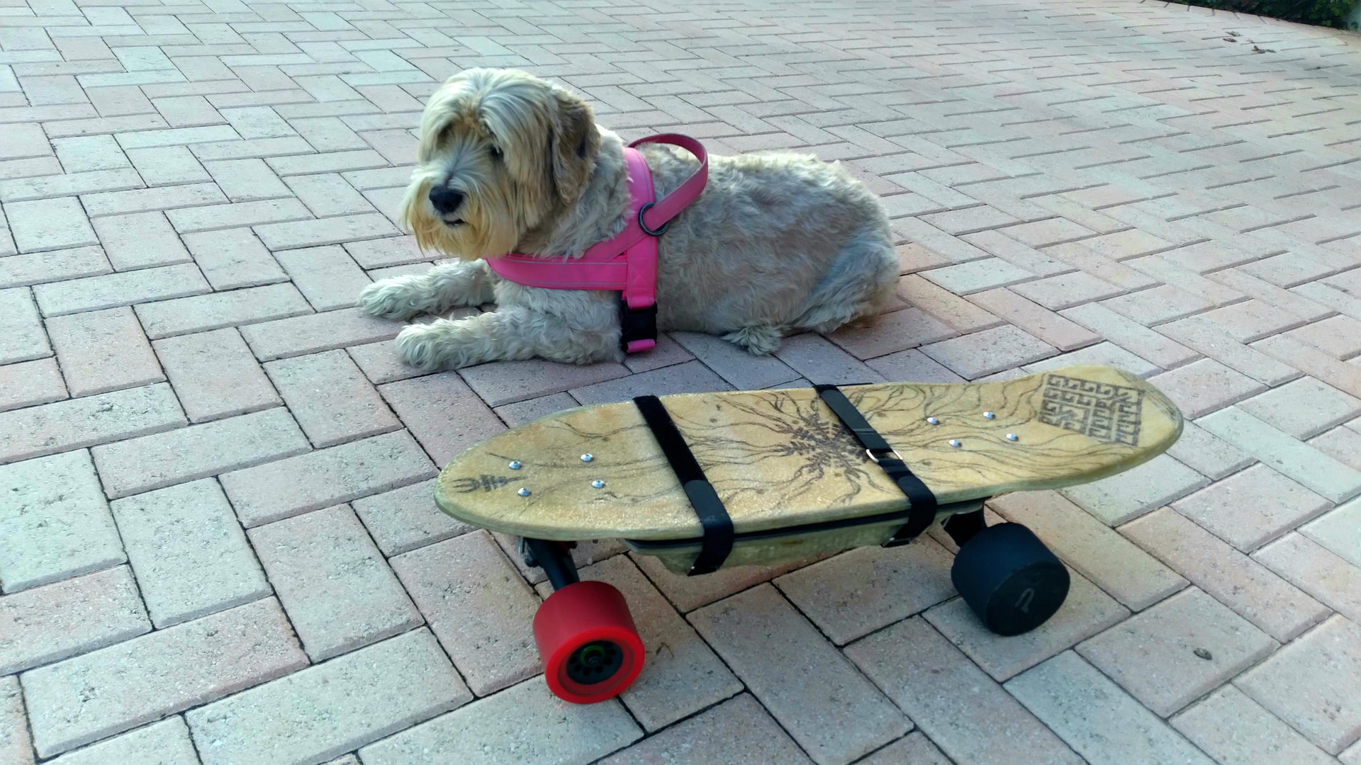

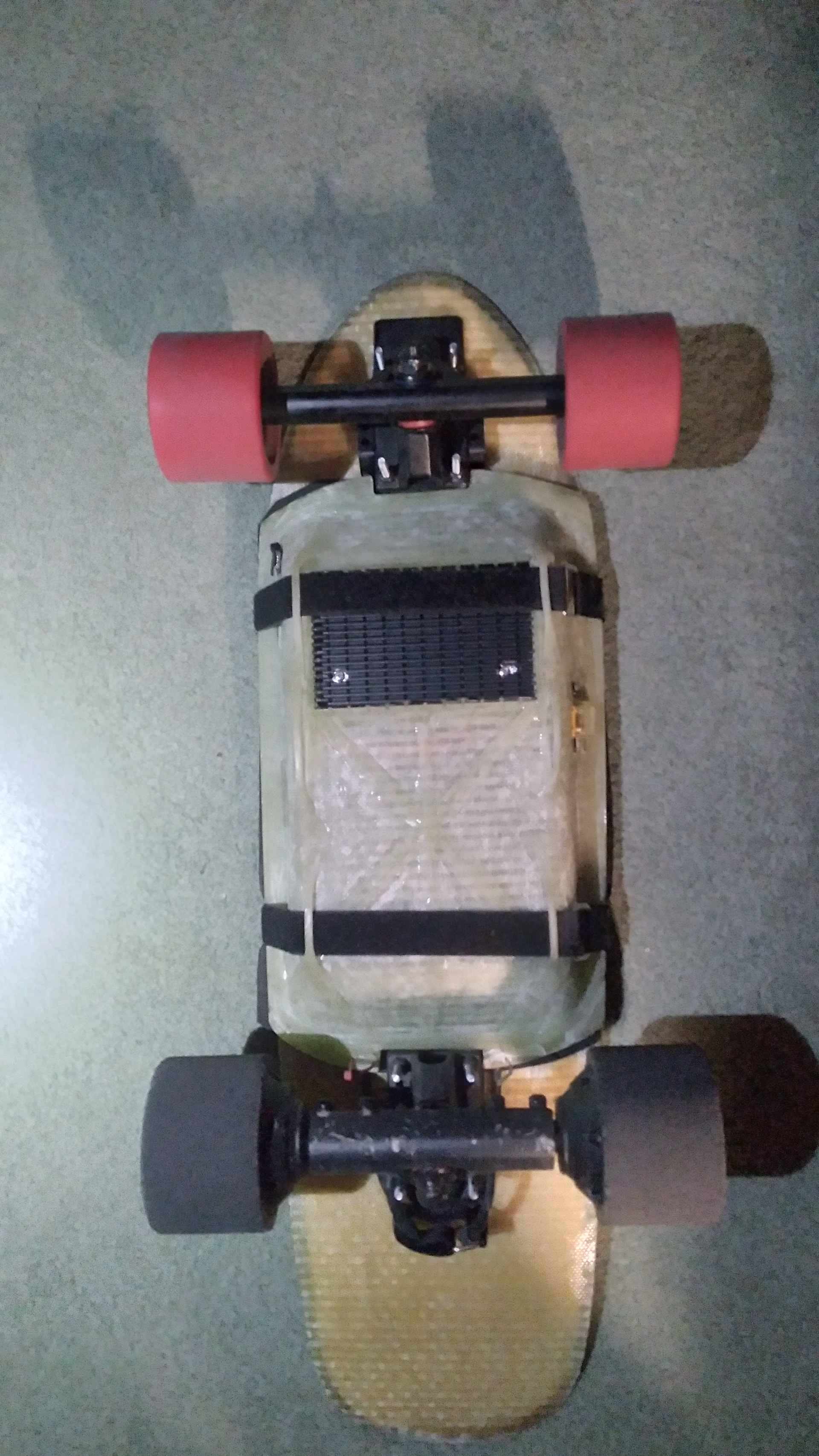

Got the mini functional, but it is far from finished.
I started the test roll with the EVE 40PL 10s1p under 39.5v, and got somewhere between 5.51 and 6.49 miles of range out of it mostly doing tight turns and figure 8’s close to homebase, draining it to the hard cutoff at 32v.
The second half of that roll was towing Fiona, as she was not content to just watch.
I don’t think I went above 16mph and averaged far below that.
I am not used to such a short wheelbase, or a kicktail.
It took a long while before I developed any confidence on it.

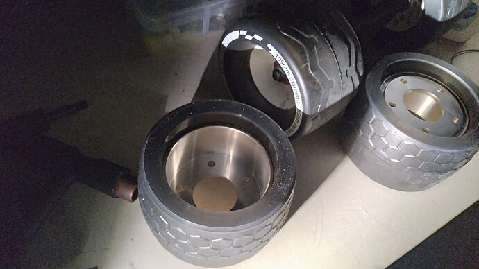

The last time this board was powered, it had dual diagonal 70mm hub motors and urethane, 7s2p, narrow TKP trucks. Light, Super nimble, but 12mph max.
I doubt I will ever attempt to approach the~28mph top speed of these hub motors on this ESC, and I had a few wheelie scares with the available torque, and such a forced narrow stance, even on speed level 3 of 4, and the brakes with these motors on this ESC, are weak.

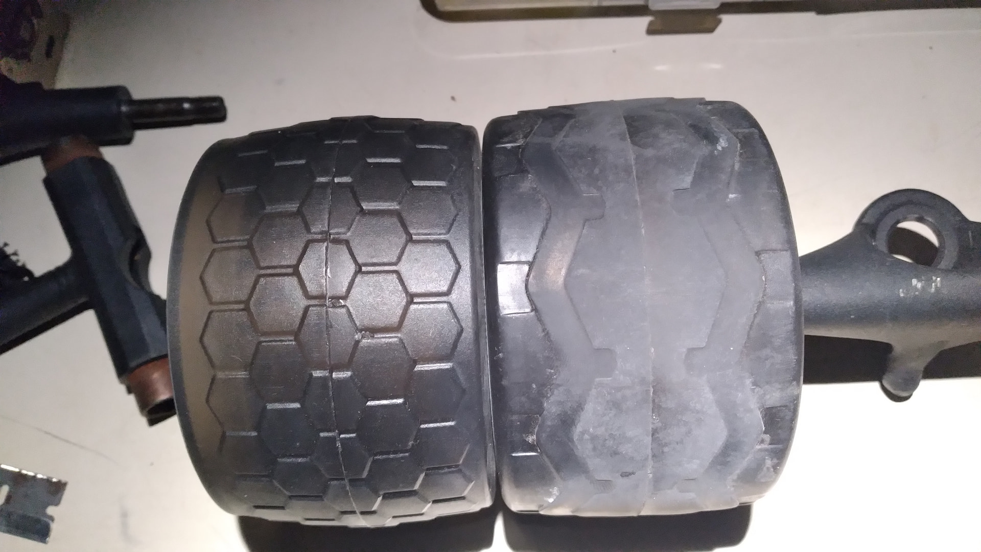

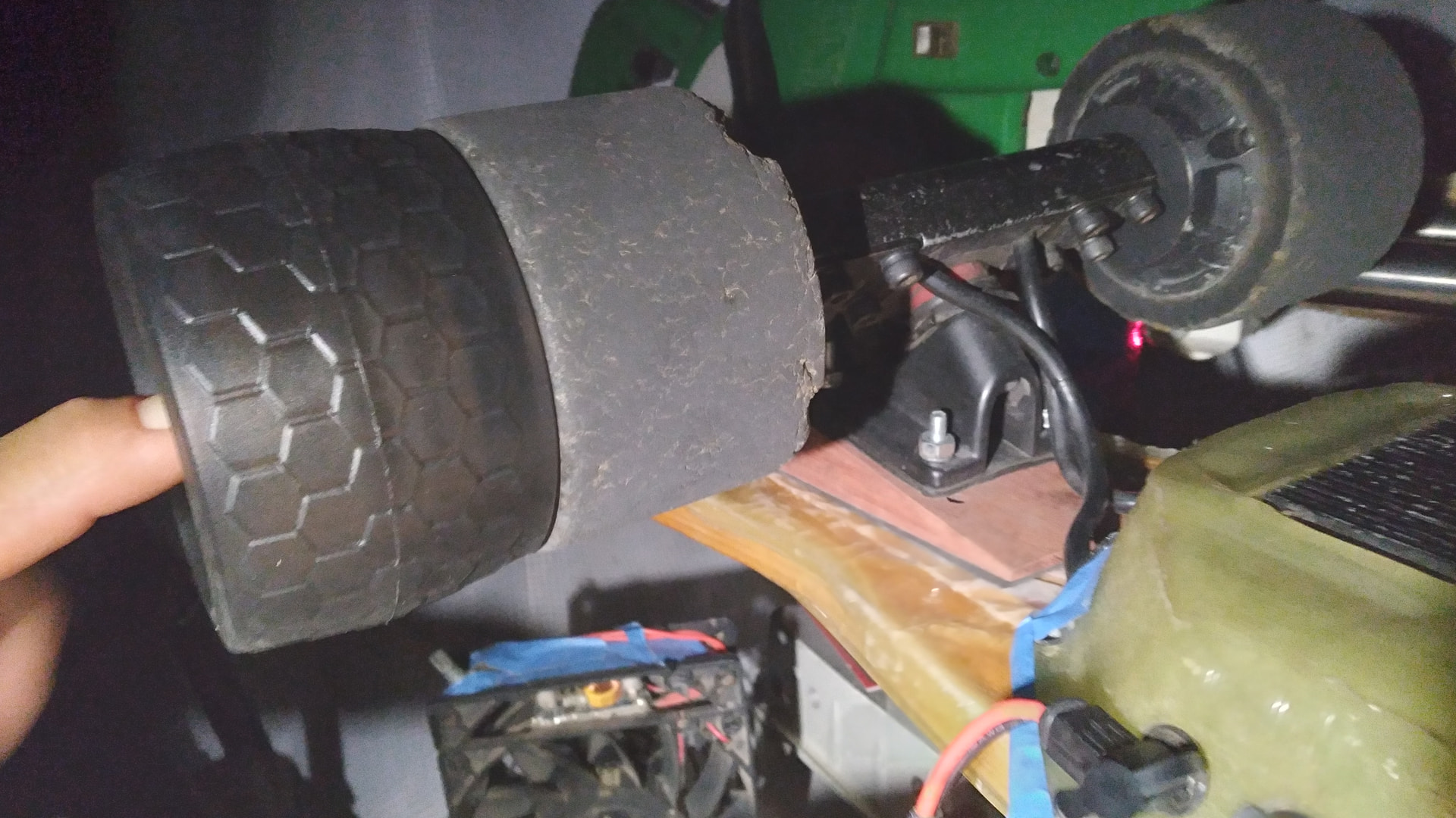

I first tried the 105mm meepo donut wheels on the front truck and their new tread was noisy, and I had the trucks pretty tight to prevent wheelbite, and quickly decided to swap to the 80mm urethane instead to relearn the dormant muscle memory.
I need to weigh it.
I dialed it to charge at 1amp, and then took out the Guppy for our late afternoon roll with a much better appreciation of its comfort and stability.
Well, the Mini is not so light at 17 Lbs/ 7.73 kg.
I did not build it thinking about minimizing weight, but even if I did, I don’t think it could be much lighter.
The Fiberglass enclosure is pretty burly, bigger than it needs to be, and its heatsink is laughably huge. I used 10AWG off the battery, and my Phase wire extension adapters are 14awg.
The Junkking 80mm( now 74mm) hub motors are significantly lighter, and I might actually return them, to use their sleeves up completely, not for their lighter weight. I do not really need the extra power of the Puaida 90mm motors, but they are quieter and ride smoother, and I have backup sleeves and more are still available.

I can swap the mini’s drivetrain to the Guppy in under a minute as they use the same rear baseplate, so its just unstrap velcro and remove hanger and swap.

Beach run on the Guppy today, with the sweet goofball, and Portable Charger in her Chariot.
PC started out at 317 watts today, and when we went to leave, it was already at 41.94v accepting just 0.14 amps.
The roll home was far quicker, having become more familiar with road and sidewalks in this area.

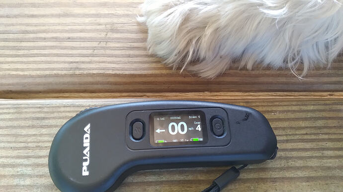

The 99$ Puaida/Lingyi 2024+ ESC allows for customization of torque and top speed on the 4 different speed settings, and has a much smoother roll into the throttle after freerolling, and way better brakes, and telemetry. I’ve got 370 miles on the first one so far. No cutouts, No issues.

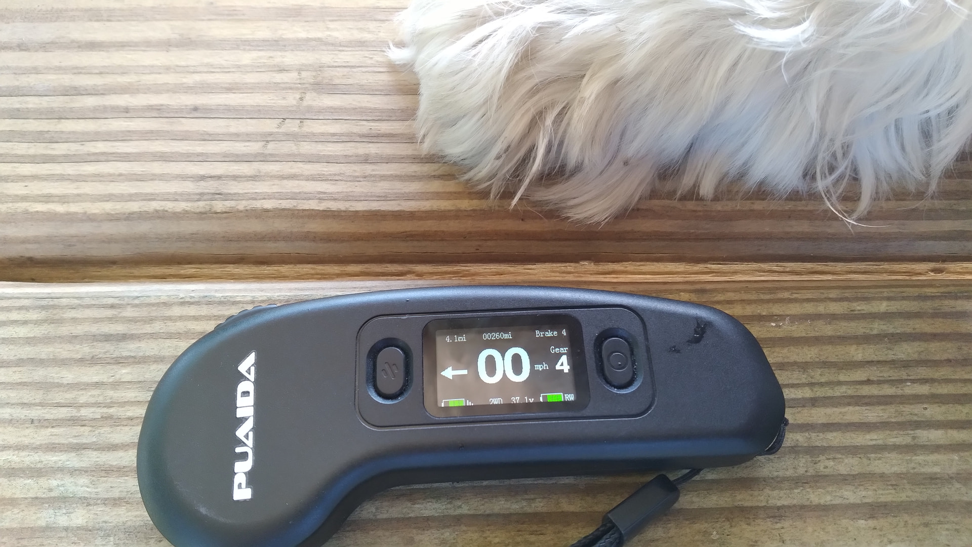

I have been really digging the trip odometer and voltmeter on the guppy, and so My ignorance of just how much better VESC current control is, is something I will remain ignorant of for some time to come.
When Fiona and I returned from our first more distant roll on the 10S Mini, there, on my front door was a package from China. New 105mm hub sleeves cast onto aluminum, instead of the plastic onto which the Meepo 105mm sleeves are.
These have a different profile too, both tread design, and a more donutlike contact patch..
The worn sleeves above, looked just like the wheel on the right below, when they were new, ~450 miles ago.
I was really expecting an Email from USPS or some other package carrier saying I needed to pay an extra fee, before they delivered it.
The Meepo 105mm sleeves use an M5 Panhead screw, but the Puaida sleeves, either 90mm or 105, require an aluminum faceplate and M5 Flat Head Socket Cap Screws.
I have 9, kind of salt stained, but need 10 to use these new sleeves.

I was thinking of taking the Kayak out, but decided the enclosure needed a little bit more buttoning up, Since I had largely left most wiring loose to test ride it and kind of spaced out on finishing it better.
The 144wh Eve 10s1P 40PL has some dense 3M adhesive foam adhered to its bottom, which is in contact with the bottom of enclosure.
I did not remove the adhesive backing for the top side of the battery with the dual 14awg series connections so it is free to slide over the heatshrink.
The battery and BMS is held to enclosure with 6 Velcro cinch straps. 2 full width straps side to side and 4 half width straps front to back, the center two in an X. The battery is held firmly but can still flex with minimal restriction.
Many more 1/2 and 1/3 width velcro cinch straps basically hold everything else in place though there are a few small Zip ties here and there too.
While I have inserts and the hardware for a more permanent attachment, The 3 velcro cinch straps to hold it to the deck are unobtrusive, on the mini, and I like the idea of not adding inserts.
I could add some roving bridges to the perimeter fiberglass and not have the cinch straps visible on the top of the board, and then removing this powertrain and strapping it to another deck becomes super quick and simple.
I ran outta wide tip black sharpie to turn blue masking tape black, but I dont really care how it looks, and I the new 2024 model ESC is supposed to be here in a few days.
The tape is ‘temporary’ and obviously not completely waterproof, but it took a while pressing down on the full size neoprene gasket to squeeze out the extra air.
I am thinking that this enclosure and powered hanger, would fit nicely in my backpack, or the chariot, and allow me to wander 50% farther from home base, not including the potential of my many portable charging solutions.
