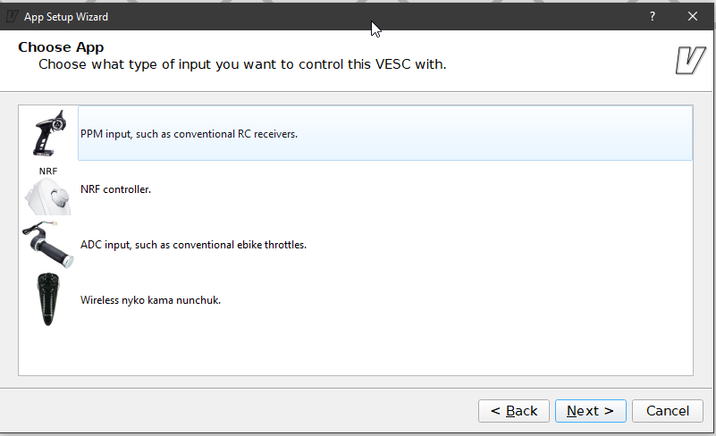

sure, i can remove can link. since the remote is connected to the new vesc ill run setup on the MK3 as a single then?
Yup, then you do the other one and tell it to be slave.
@Trampa when clicking on the Setup for the second vesc i dont get an option to set it up as a slave.
PM me. Otherwise we clog up this thread.
That i think the same issue i have for months where the tool won’t set both up to run via can.
In the Ackmaniac tool you can choose between a single or dual setup.
You set each VESC up on its own (without can)
Turn it off, connect can, turn it on and connect the usb to the vesc you want as slave and do the Input Wizard.
Thats where you can choose who has the Input connected and you can set VESC Id’s to make sure it know which one is the Master.
The stock VESC tool says my firmware is old till this date.
EDIT :
Actually that is the old Wizard from VESC-Tool. The new VESC-Tool figures it out by itself. It scans the CAN BUS, allocates VESC IDs and you don’t have to care.
Correct, the old one is still in the ACK tool. But thats the only one that works for me. As soon as a have can connected on the stock tool it says my FIrmware is old and i have to update it.
That might be hardware related. You can still do it the same way you used to do it in the old tool.
But the wizard that asks if you’re setting up a slave and a master VESC seemed to work better than the VESC tool doing it behind the scenes, as I know for myself it gets the VESC ID’s wrong and I2C over CAN requires me setup the forwarding manually. I feel like it was a step backward for the VESC tool.
I never get wrong VESC IDs. For me it always works. We set up quite a few boards!
You can still use the manual way to detect the motor and calibrate the remote. With VESC-Tool 2.0 your settings will never be lost, so it is a one time experience. Updating FW will be mega easy.
