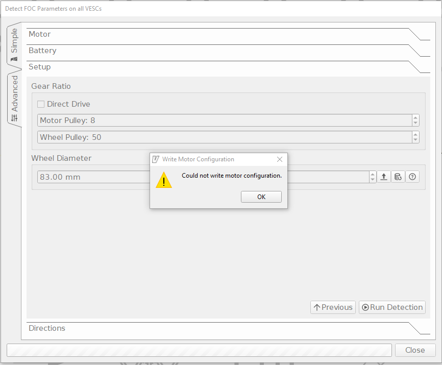

Seams like the first 30 Units got the wrong FW loaded, which is not tragic, but does not allow the switch function to work. This is the correct FW. It can be uploaded via the Custom FW tab.
updating the FW on it now will re run motor detectio nand let you know if i still get same error
Perfect.
thanks i was able to run the detection i uploaded the FW you supplied. though i do have another issue though since updating the vesc’s i can no longer get data through the METR module and app which is annoying since i dont have a battery monitor as i use my phone to monitor my battery. this was working perfectly fine till i updated the vesc tool today and the vesc FW earlier.

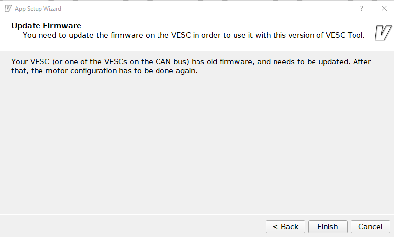

i just went to do the input setup but was greeted with this window here after updating the new vesc. since i have 1 of the older models conencted as well do i need to upload the same FW file or will it damage it?

Run the VESC 6+ from the 60 FW please.
is there a way to get my board up and running in the meantime. i finally replaced the motor and the vesc and installed my battery and had it on charge for the past hour but i cant seem to get through the vesc tool setup without issues. was hoping to get some riding in for the weekend but if their are still software issues which could damage components or injur the rider i might hold off till this is fixed…
sorry im not sure what that is. do you want me to uploaded the same firmware version through the old vesc that i downloaded from your link?
Update both VESCs and try again. Worst case is that you need to run the wizard for each unit and do a manual configuration.
The VESC 60 will need the HW 60 FW, the VESC 6+ the 60MK3 FW.
alrighty just uploaded the 60 and 60MK3 again ill re run motor detection and see if it will let me get through input wizard
@Trampa without the wheels spinning i get this. also i noticed in the background the wheel diameter changed from 200mm to 83mm
