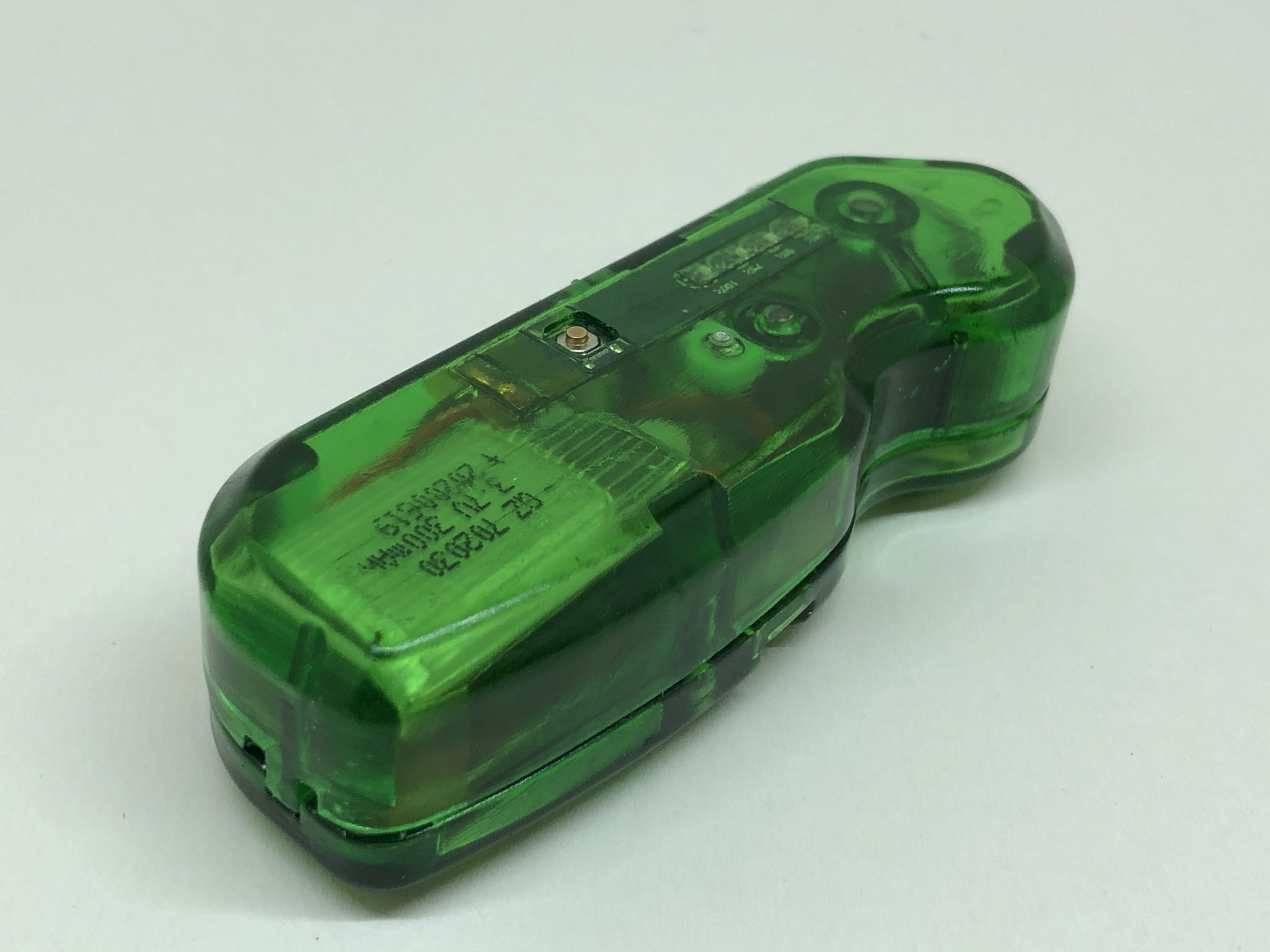

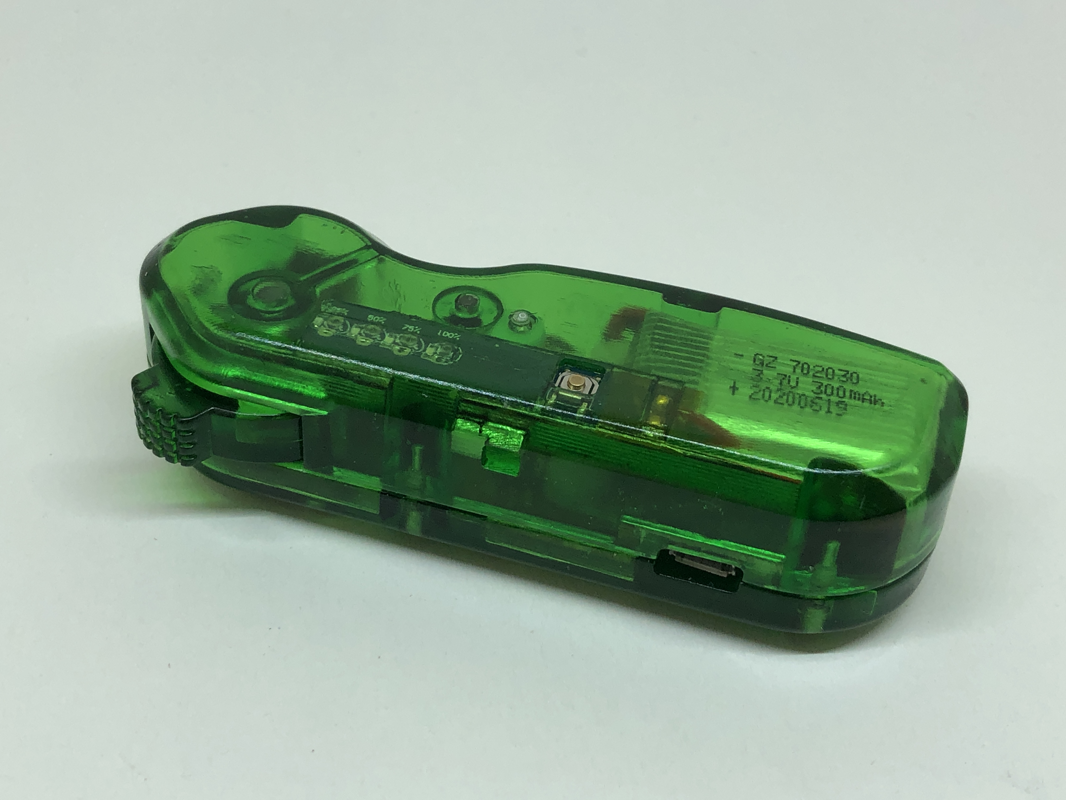

Does it really work just with the 1S lipo? No regulator/diode?
I know anecdotal evidence does not prove anything, but I have been using a Mini Remote on straight 1S lithium-ion (4.2V max) for years now with no issues. The 18500 cell lasts so ridiculously long though, that even with daily use over 2.5 years I think I’ve only charged it maybe 3 or 4 times? So most of the time it is not running at the full 4.2V
This is with no regulator or diode.
I used a vape lipo for this and it’s A-Ok.
@Battery_Mooch although it’s a lipo and not a cyclical cell, you might be amused to see direct harvest of vape guts into Esk8 gear.
Disposable vape lipo -> remote battery.
That’s a neat size, how many mah is that lipo?
They are 350mah.

I have a MicroUSB charge port and a charge indicator but not the exact same charge indicator
It’s more of a square than long and skinny

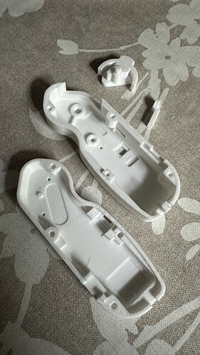

Made another one :slight_smile:
Man, resin printers are so cool
Clearly
Would anyone be interested in buying resin printed remote shells from me? I can completely finish the shell ready for you to install the parts into it.
I am from Belgium so if there is some request from the usa maybe a group buy can be done to save shipping.
Let me know :ok_hand:t2:

How likely would it be for you to print the puck puck Bruce mod and at what cost?
Hey @jaatis, I love the mod and just printed myself one. Would you mind sharing the design files for the shells as well? At the moment there’s a step file for the thumb wheel but not the rest of it, I wanted to make some small mods and am no good at modifying stls
