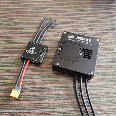

Mini FOC based on VESC6
With a full aluminum case and screw holes, these can easily be bolted to the bottom of the enclosure with a hole exposing the underside, just needs a 2mm gasket to keep water out
Make round holes in the enclosure and lathe a circular groove on the case, then you can use standard large diameter o-rings

Man, you can hardly see that little thing
Itā€™s really impressive how small that thing is.
You could probably mount them sandwich style and together they would be just a bit taller than a single focbox :joy:

Very impressive performance out of such a small form factor.
I applaud the PCB design.
(But it could be even better with MOSFETs that are not from international rectifier ;), I can give some suggestions for alternatives :slight_smile: ).
can you elaborate what is your issue with them?
We should have a thread specifically for International Rectifier devices
Ridiculous gate (miller) charge and as such horrible FOM, terrible rdson variation with temperature, cost, no small package sizes, lots of fakes and clones out there.
This list is not exhuastive.
The only thing they have going for them is avalanche ruggedness, which is why the vesc gets away without using any form of transient suppresion.
