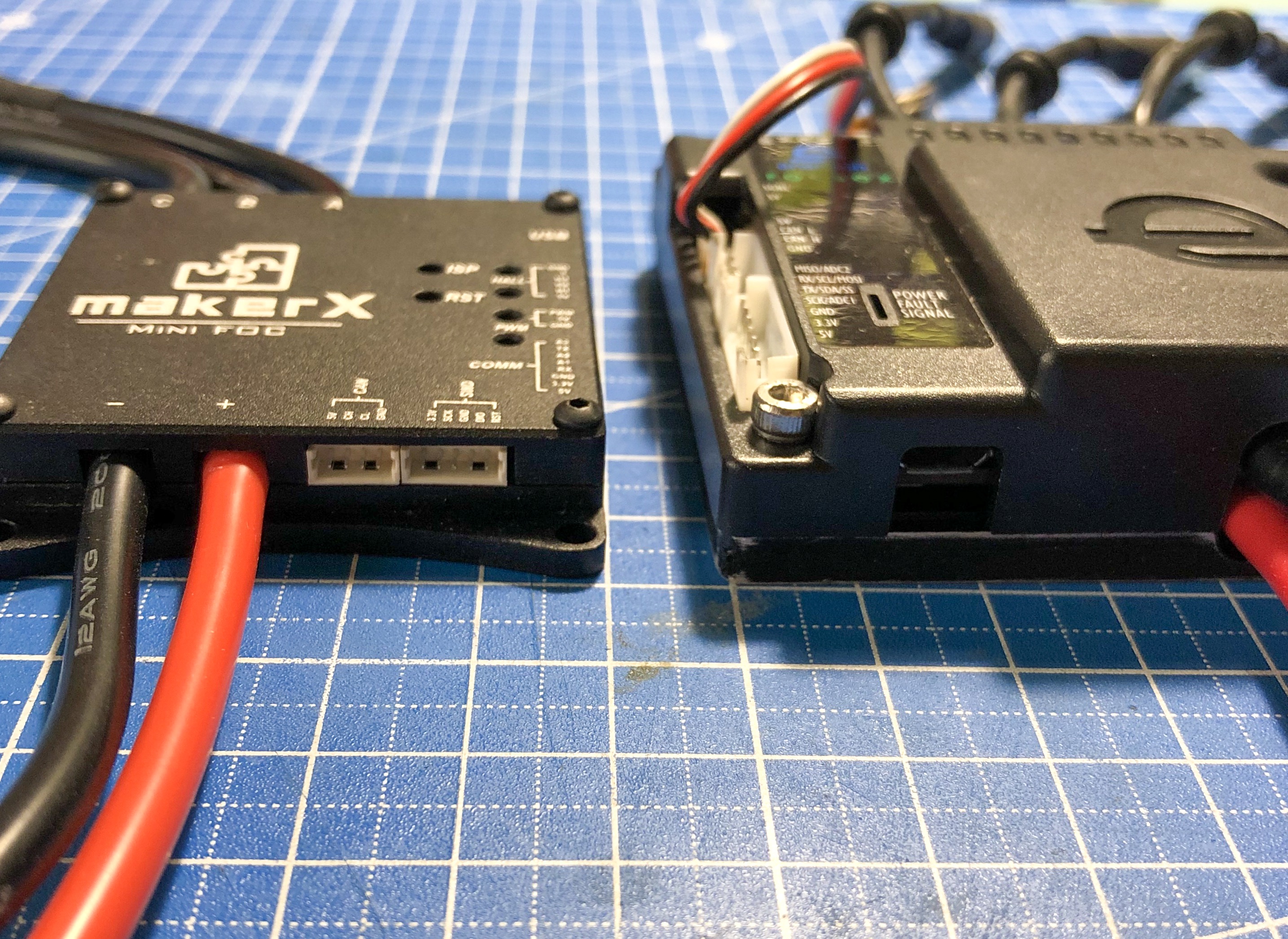

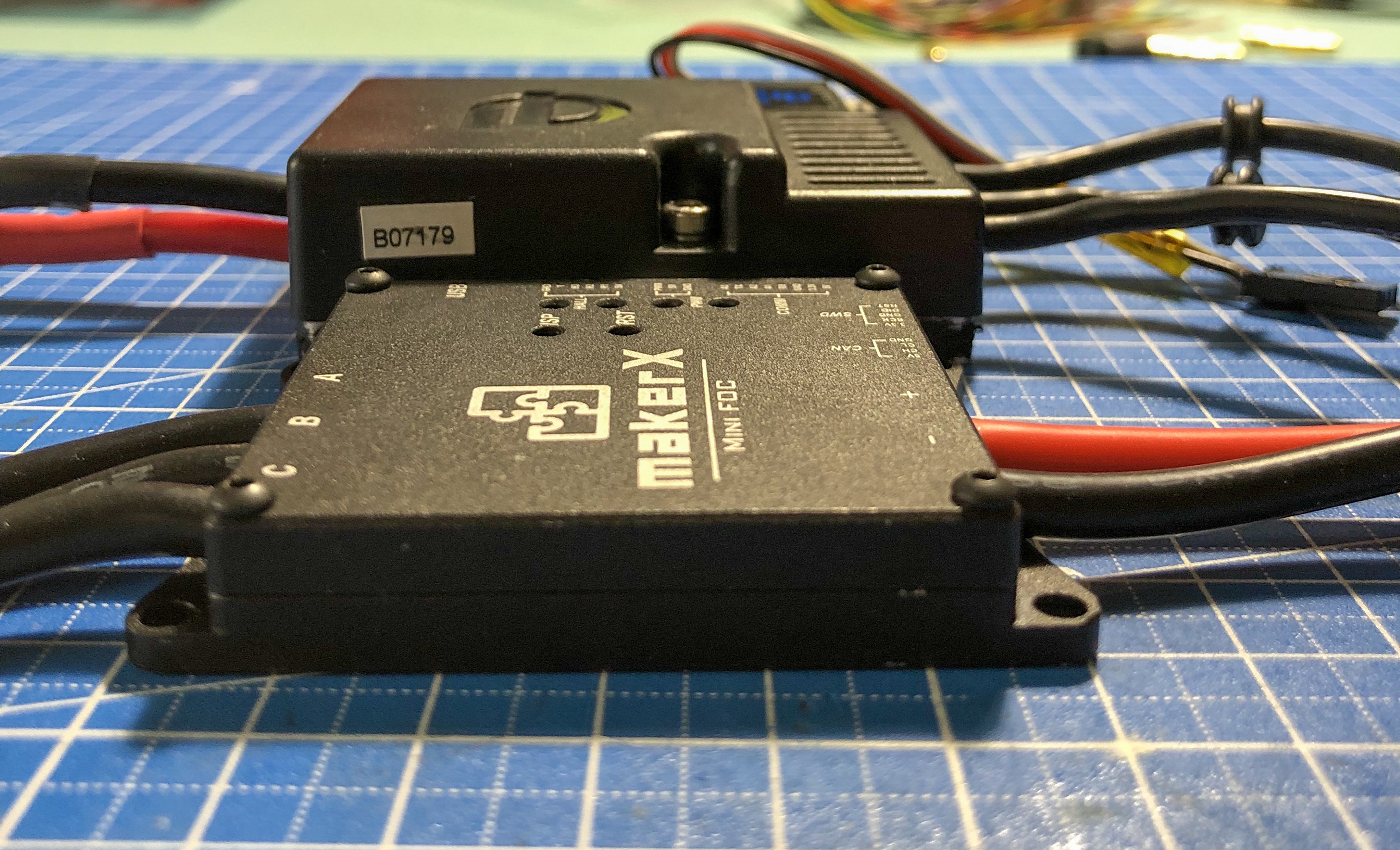

To get a bit an understanding how small they are here a comparison:
MakerX->focbox->fsvesc6.6->esk8.de vesc
To get an understanding how slim they are, here a comparison to the focbox

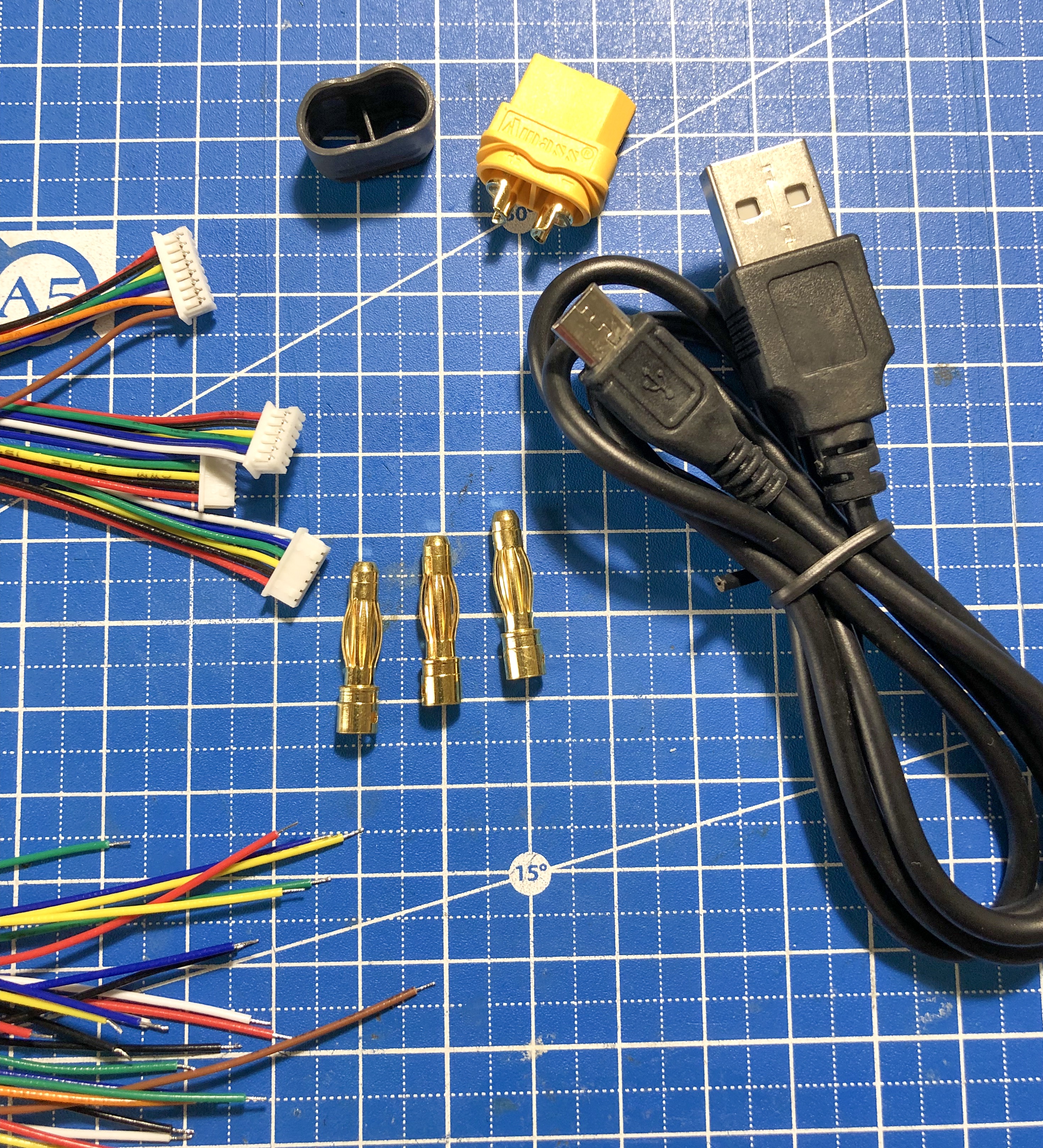

They come with quality 12AWG for phase and main power leads. As well as 4mm bullet connectors and xt60.
I specially asked for some adapter wires for there jst-plugs, so that’s what I got with the escs:
I don’t think it’s really necessary to always send a micro usb cable, but some pre crimped jst plugs for all ports is definitely a nice to have as it’s not the 2mm ph jst plugs we usually use.

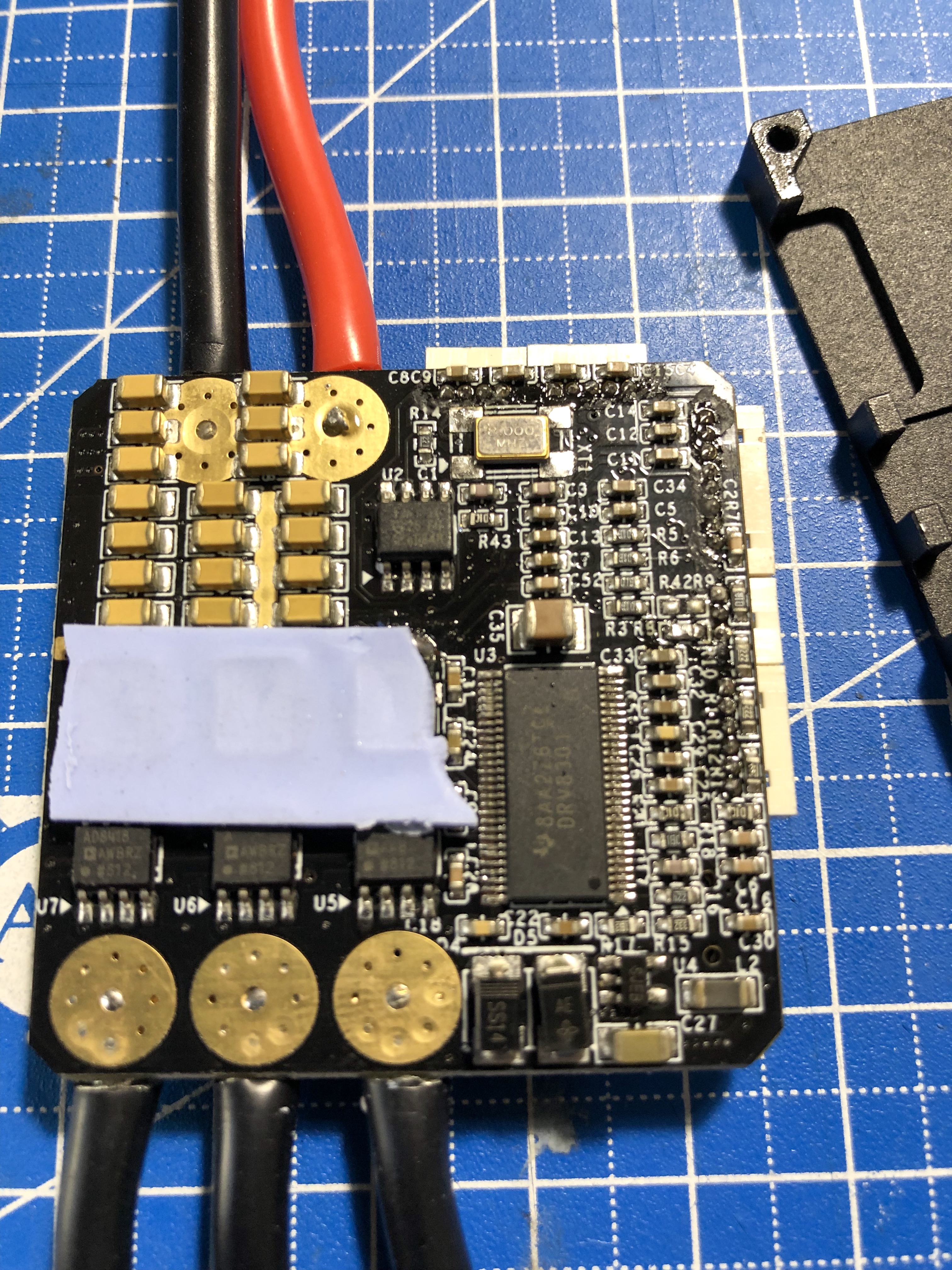

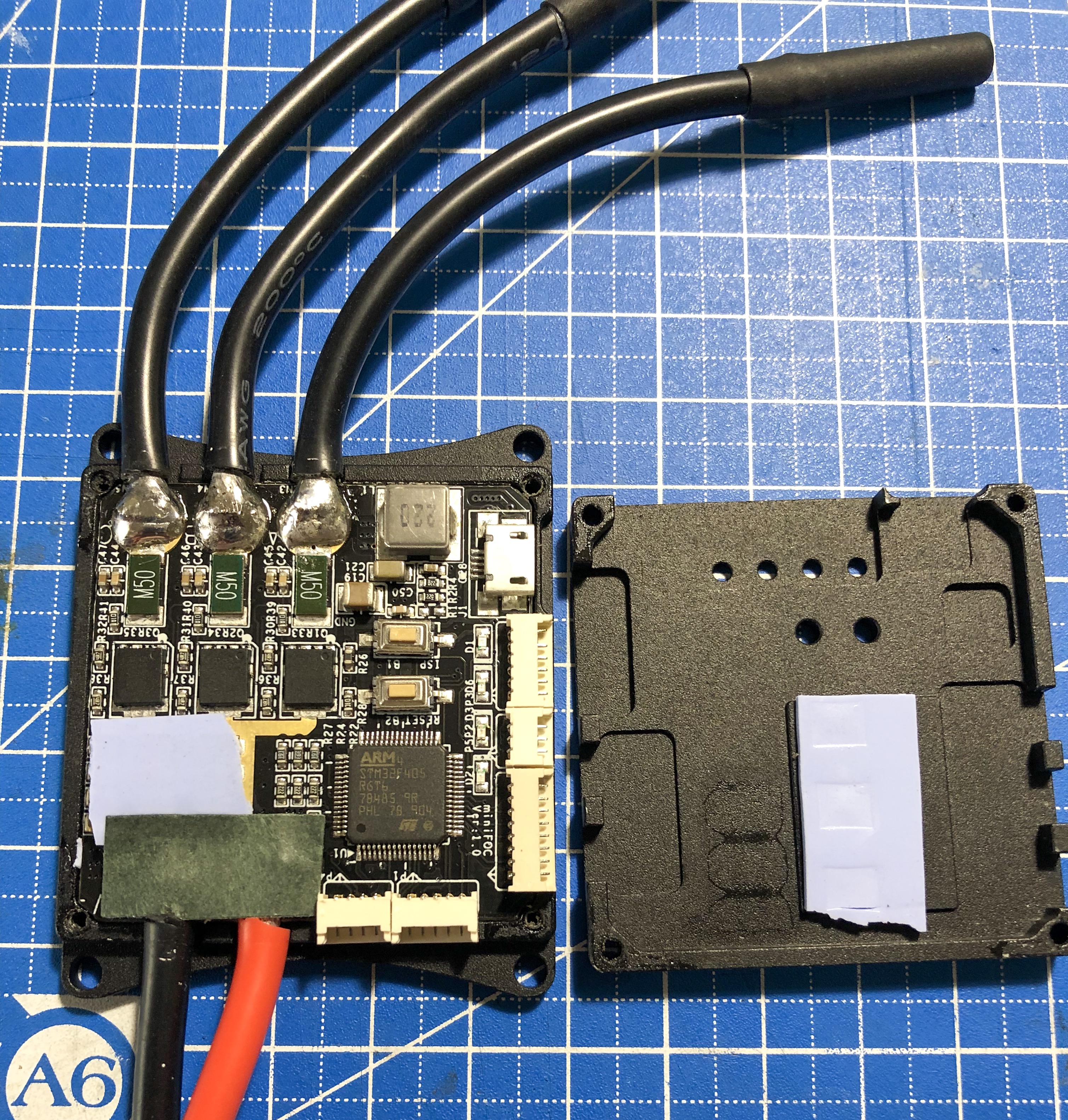

As somebody before mentioned, the thermal pads look pretty fat, probably 1.5mm. Thinner would be better, but might have effects on the tight fit in the case.

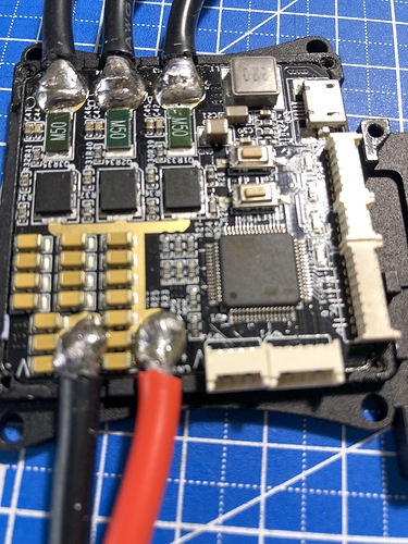

A closer look on both sides of the pcb

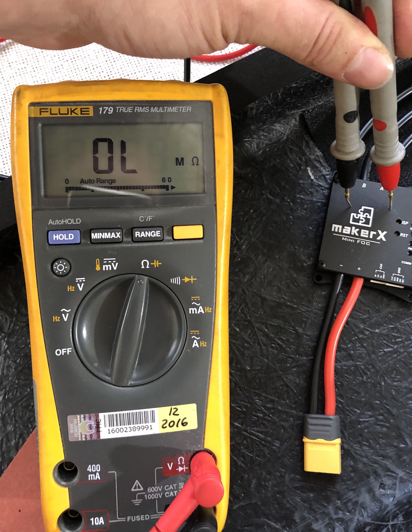

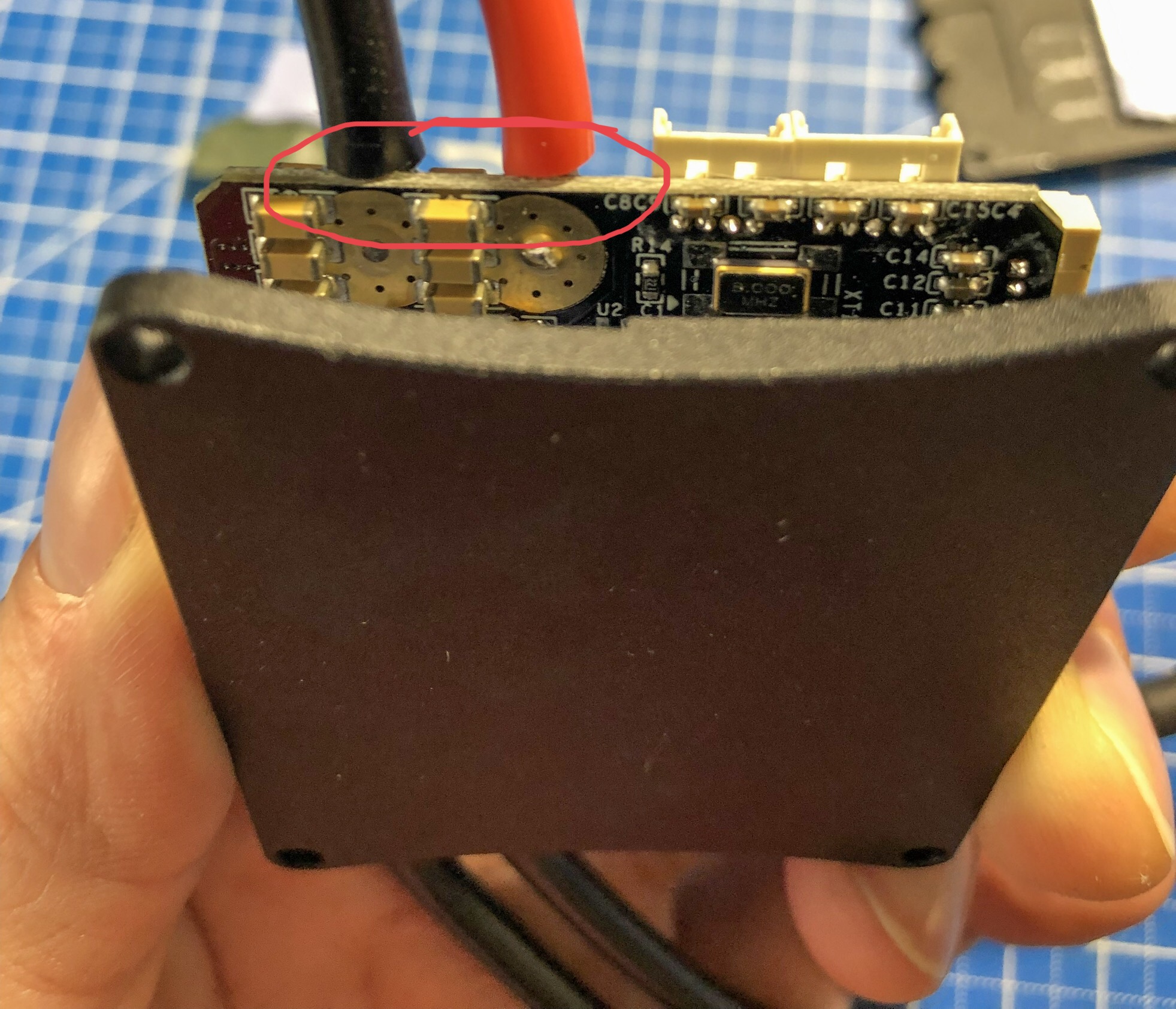

As you can see the main leads are covered with fishpaper to not short out with the case. I just wonder why not doing the same for the phase wires? They can as well short out there. I didn’t want to risk that and add some fishpaper on top of the phase wires as well.
Due to the all aluminum case I see as well a small danger that the main leads can short out if the isolation of the wires is a bit too much cut off.
It’s not the best angle but o marked the place I mean in the picture. The wires are going on this place through the case, so as soon as the wire is a bit off it could short out.
I used some liquid tape in addition to just get a bit of extra protection there as well.

Good heapdsup about dem power leads. Looks bit scetchy indeed.
It’s not a big thing and an easy fix/improvement for the producer just to add some rubber protection or something similar on the case where the leads come out. The wires not pressed through the two parts of the cover, so it might be possible to do that.
The case is as well protected due to the color, so in fact nothing should happen even if the wire has contact.
But we ride a lot and vibrations manage to damage everything over time, so better save than sorry.

If you got yours, have a look on the back side of the pcb if the one trace is strengthen with copper as it’s described in a post above. Mine have been like that already.
