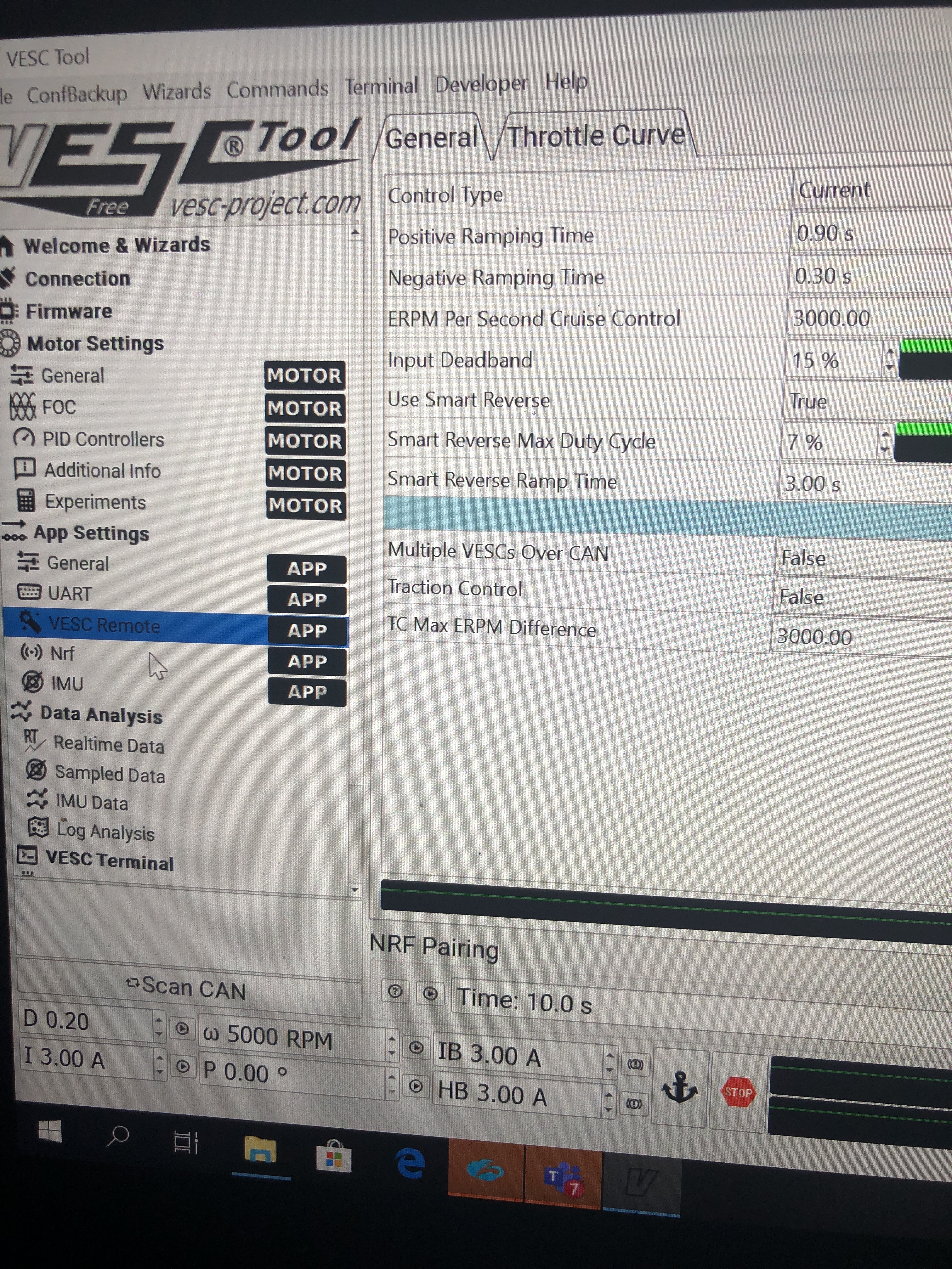

FW 5.1 Hw410*
also how do i disable smart revierse as i dont see it anymore and also how do i up the min voltage so both wheels spin when I lightyl touch throttle as only 1 spins

How is your remote setup again? which remote ? is it PPM or UART?
If it’s PPM then “App settings” → “ppm” → “general tab” → “control type”. set it to “current no reverse”
if it’s UART then “App settings” → “VESC remote” - > “use smart reverse” set it to false.
it auto wont lt me apply it quicky switches back to off
under app setting i dont see any vesc remote option
Doesn’t look like this? Don’t use these settings it’s just default.
