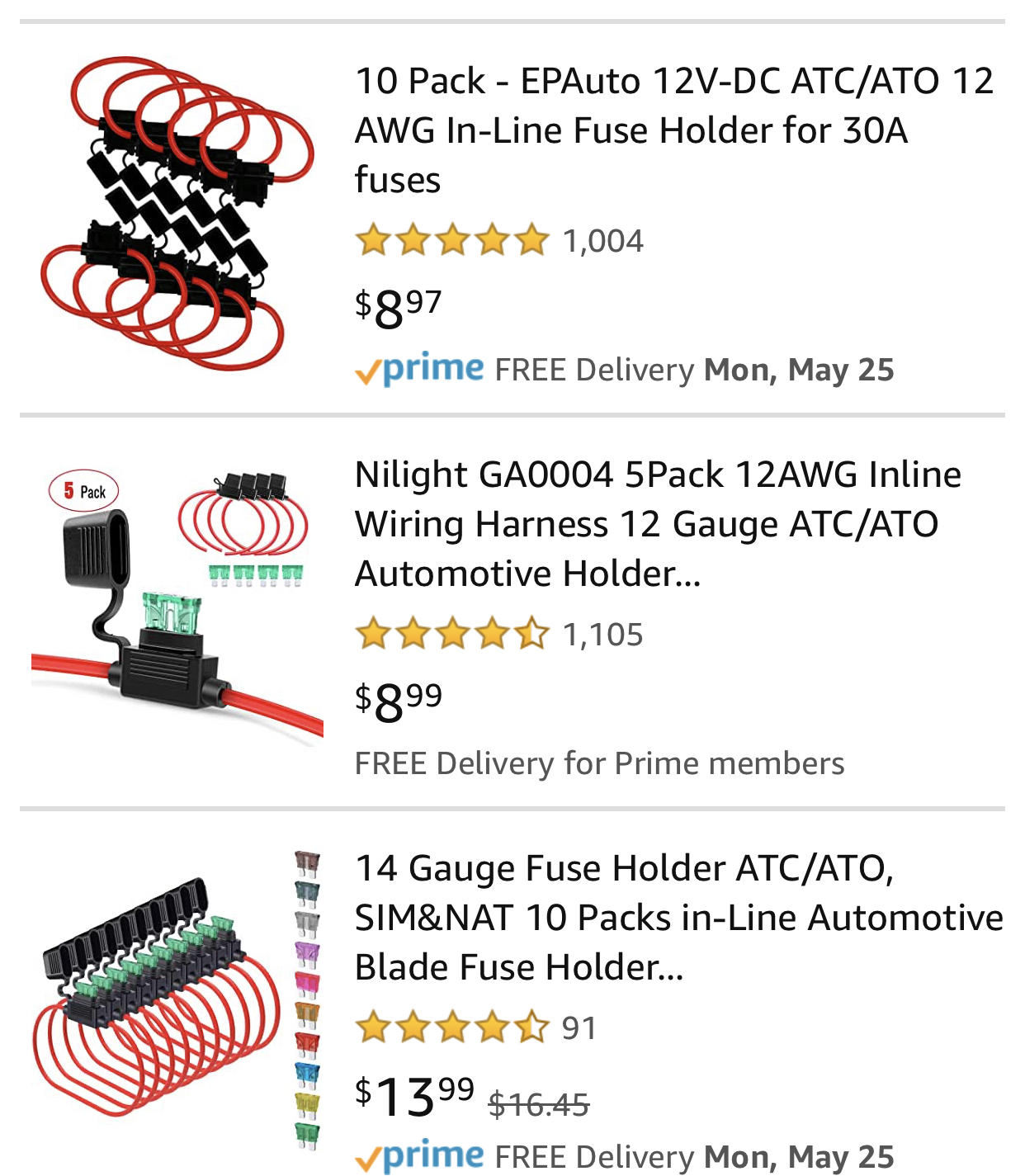

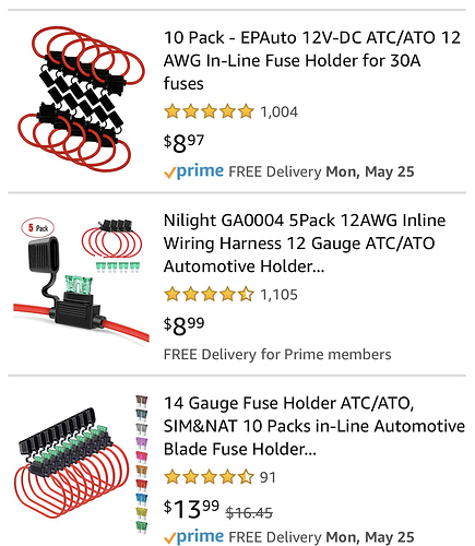

Which one of these fuse holder things should I get?
fuse holder?
I JB Weld or silicone the fuse to the inside of the enclosure or on top of the internal loopkey jack, or somewhere and just solder to it
d00d seriously… I like playin’ with science… just do science smart…
