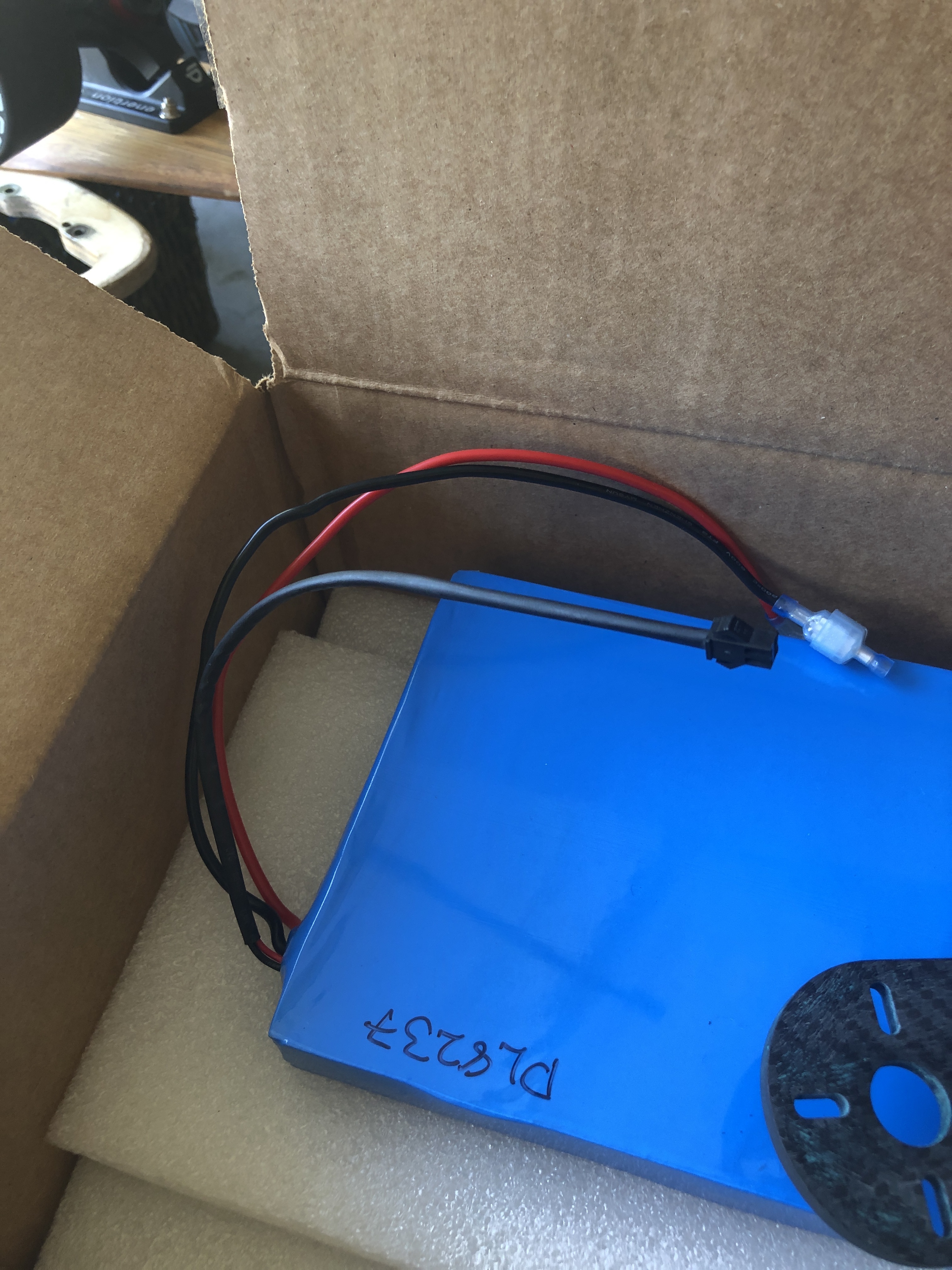

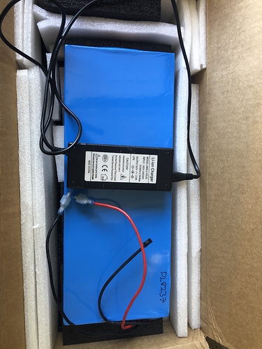

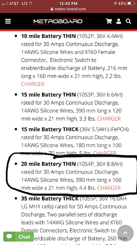

Ok I need some help I know I need an XT 60
But I want to charge it with my charger and maybe add a battery percentage indicator is this possible?
And do you recommend a website to purchase the stuff thanks you’re the best🤙

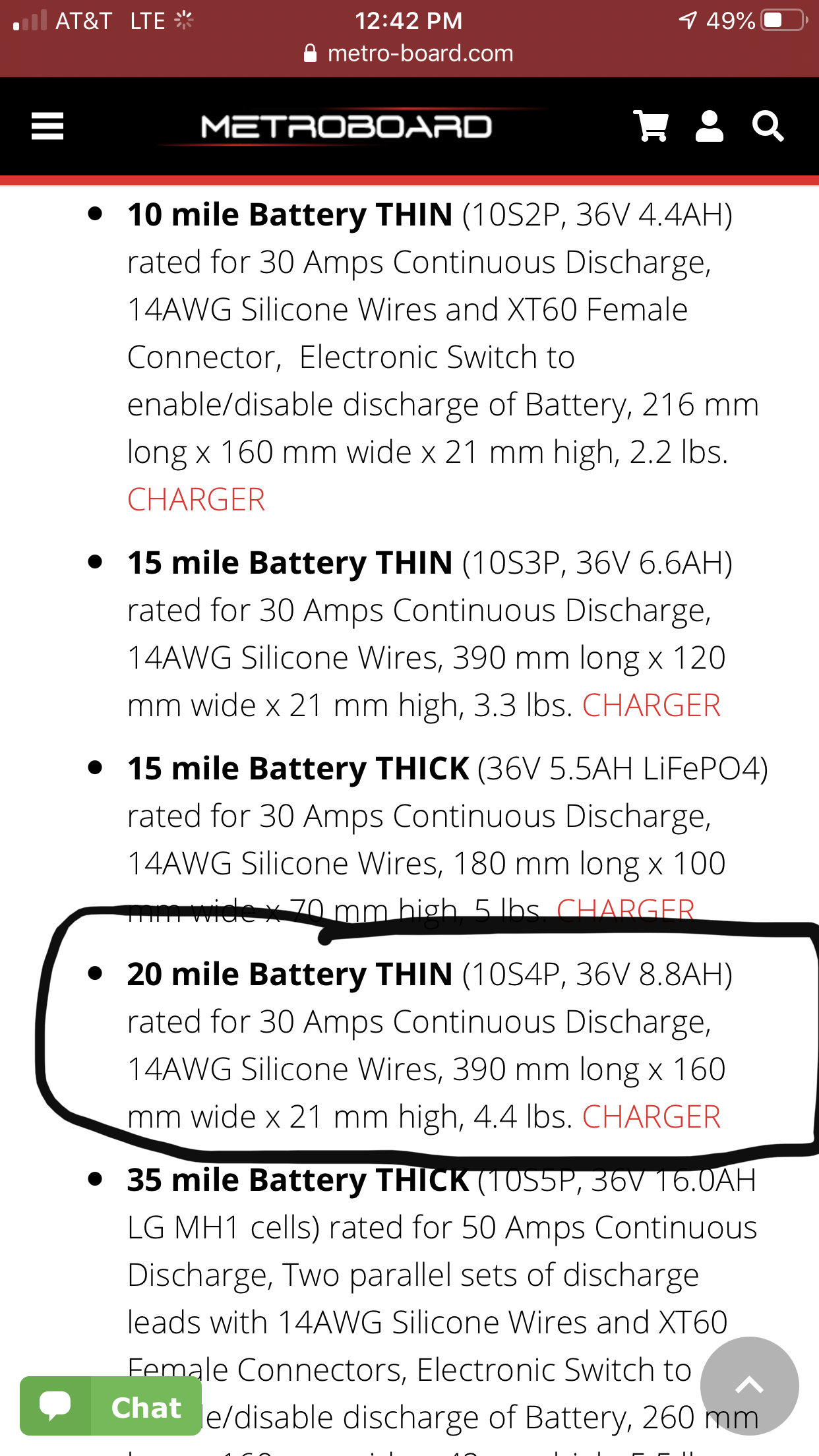

Are those the only 3 wires coming out of the battery? I thought Metroboard batteries had 6 wires; I only see 3 there.

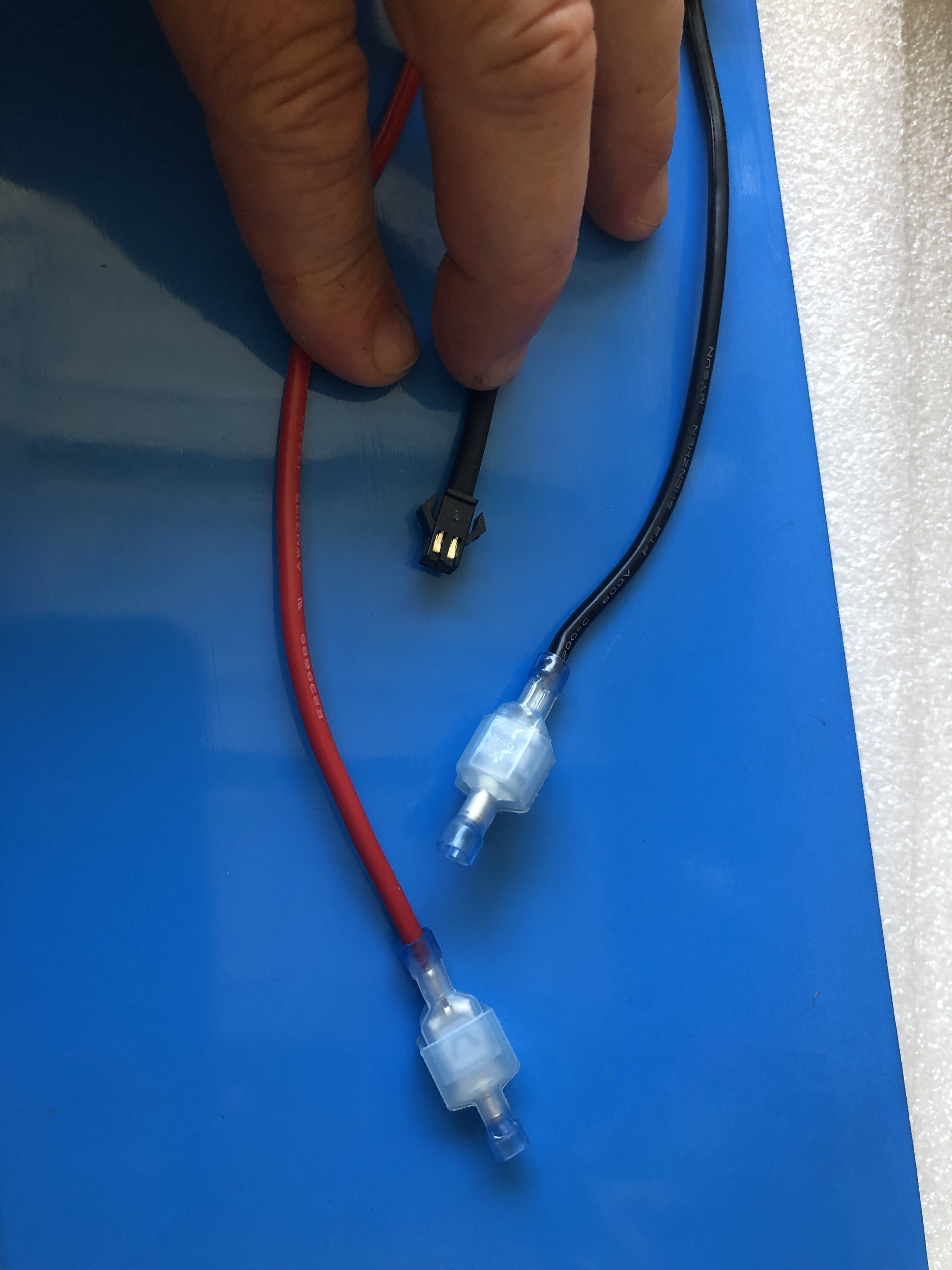

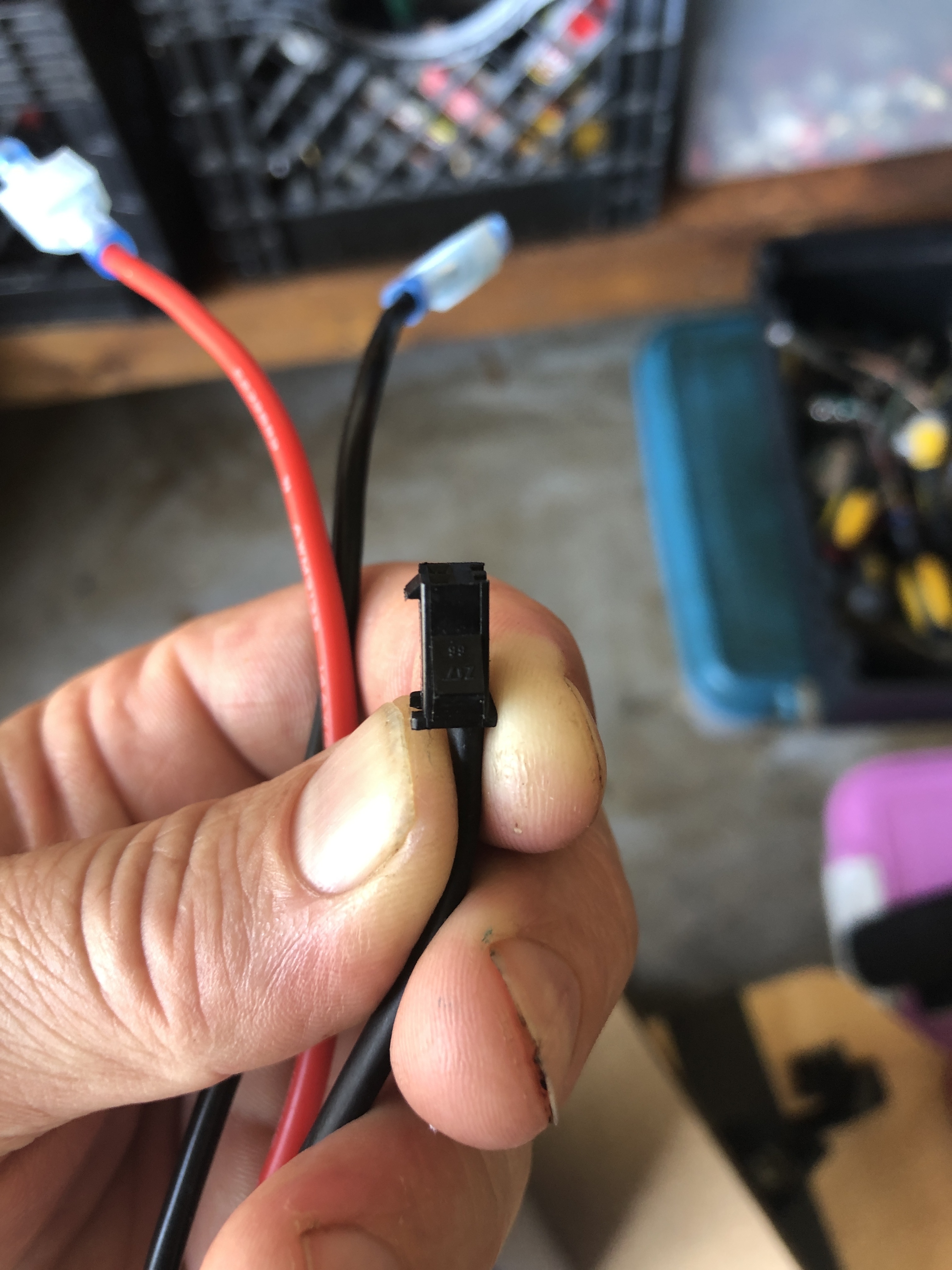

Can you get a closer photo of that wire that doesn’t look like the other two? Is it a single wire, or a cable with two wires inside?
I can take more if you need me to
looks the same as mine. The black cable is the charge port and the others seem like power. I don’t think that one has the built in switch
weird power cables though
That’s normal, the black one that’s different is for the included charge port and the other two are power cable that I just cut off and soldered and xt90 on.
Yeah I agree with @Bordboy

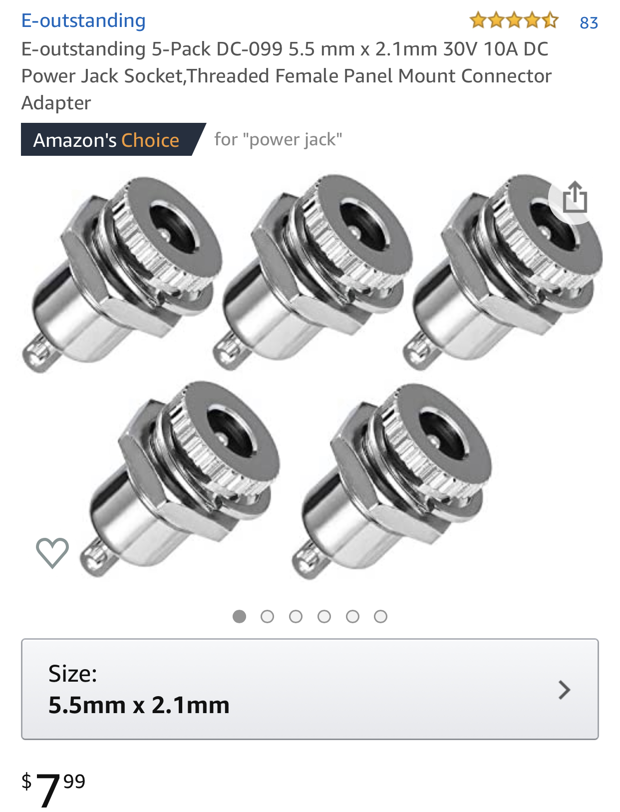

So get a 5.5 x 2.1mm charge port and a plug if your charger doesn’t have one and don’t forget a fuse on one side of the board-mounted jack.
For a charge indicator, I prefer leaving them off the board and using one of these things or your phone.
Be ultra careful if you do this. Work on only one wire at a time, and completely tape the other one with a not-electrical-tape so there aren’t any accidents. Completely finish red before you start on black et cetera
Only solder on XT90 and XT60 while male and female are plugged together, so have a few more than you need to use.

That chrge ports you linked are rated 30v 5a, are they suitable for charging a 12s 50,4 battery?
Im strugeling here with my charger and charge ports. I ordered a charger with an xlr port and is to wide for the thicknes of my enclosure, so i have to return it…
Thank you
This is the charge port I swapped in. Rated for 10A
https://www.amazon.com/dp/B07C46XMPT/ref=cm_sw_r_cp_api_i_PGvYEbJ78AJ21
But still 30v
Yes those are all fine. The current rating is far more important than the voltage rating in this use case.
Get the ones @Mikenopolis showed
Put a 7.5A fuse on it
Thank you!
Where do you put the fuse? The change cable? Positive or negative?
On either the positive or negative side of the charge port, inside the skate
