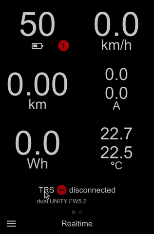

I also noticed this, have seen it happening only with VESC 5.x firmware, which one do you have?
Also 5.x, 5.1 i think?
I’ve noticed this as well, but haven’t noticed anything break because of it. 5.2
Mine and my friend’s metr connections have been really spotty lately, probably after the latest app update.
Most of the time when I start the app, it shuts off half of the ESC and refuses to connect. This is fairly repeatable and makes zero sense to me. If I do not start the metr app at all, I do not have any issues.

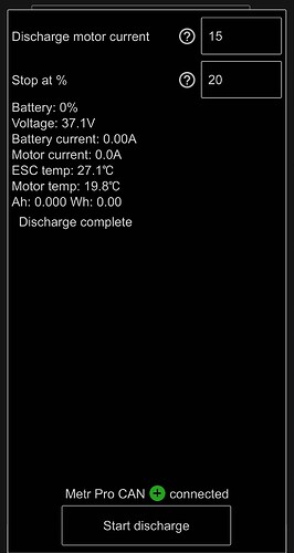

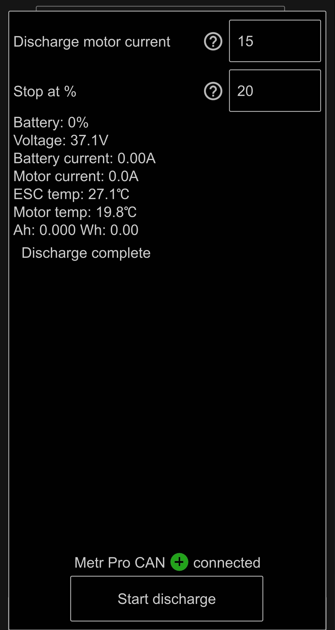

Discharge battery only clicks once upon starting, then metr says ā€œdischarge completeā€
hw 6
fw 5.1
latest metr pro can FW module and app
Update: only happens with metr pro CAN.
metr pro works
Fixed, had the battery set to 12s on a 10s battery.
10S battery with 12S settings? Looks like your metr thinks your battery is at 0% based on voltage
Well guess i found my problem. lol
Now it works :man_facepalming:t2:

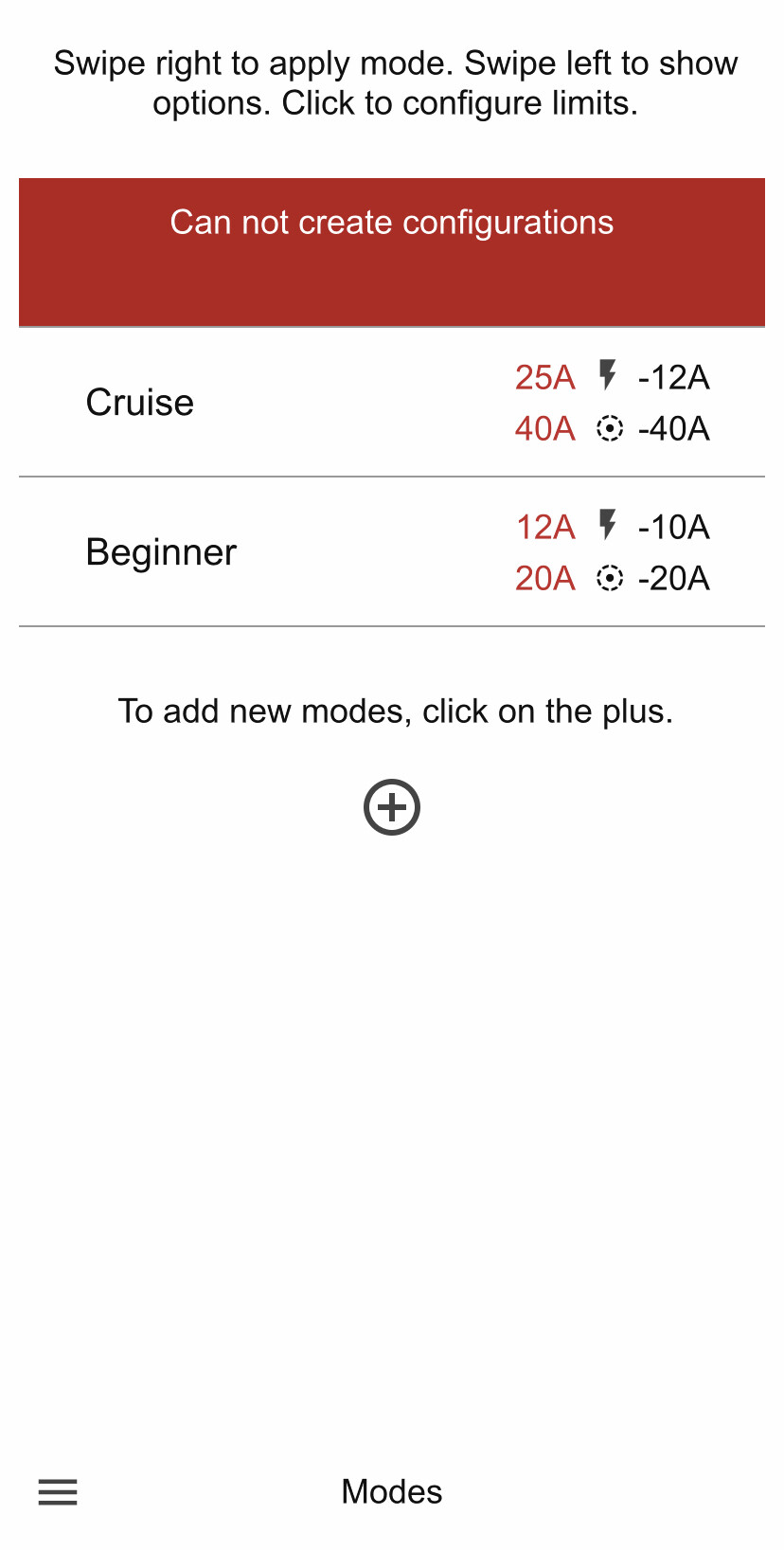

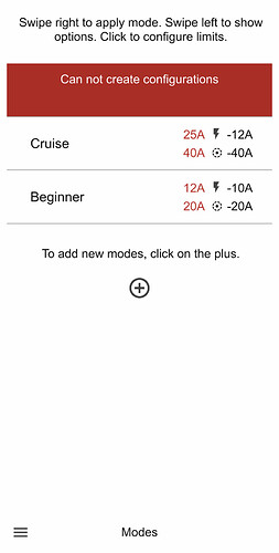

With the new update I have many issues.

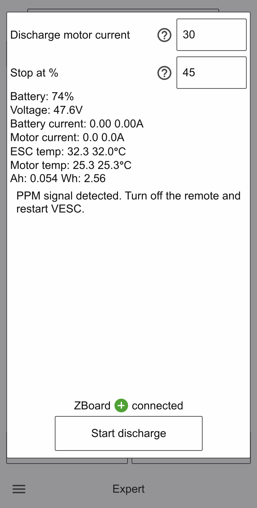

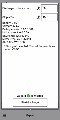

The discharge feature doesn’t work for me unless I disable PWM in the app settings. Remote is off.

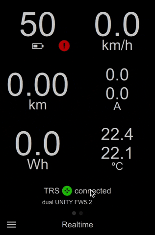

Also I am not able to change modes. This is what is says when I swipe

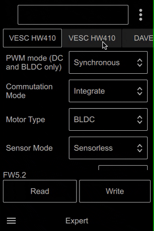

Lastly when I change settings in the expert and hit write, it says something like ā€œno changes madeā€ every time.
