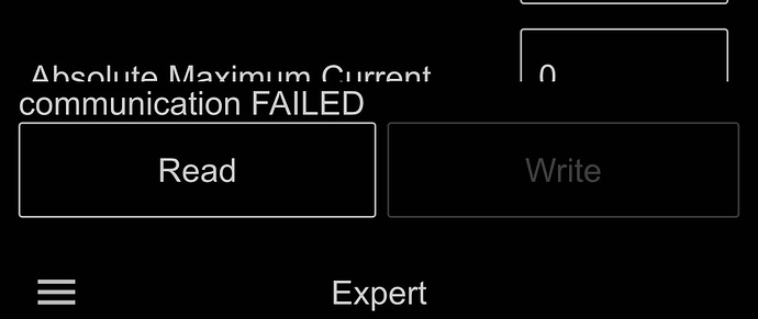

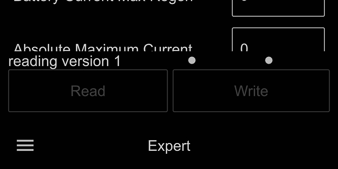

metr pro stuck ar “reading version 1” in the expert tab.
After a while “communication FAILED”
Live data works like it should.

Did you try it with good internet connection? Can you zip your 0/Android/data/at.metr.app and send to me?
Tried it with wifi and mobile data. Wifi 50cm away from the router.
Sure can do, give me a minute.
