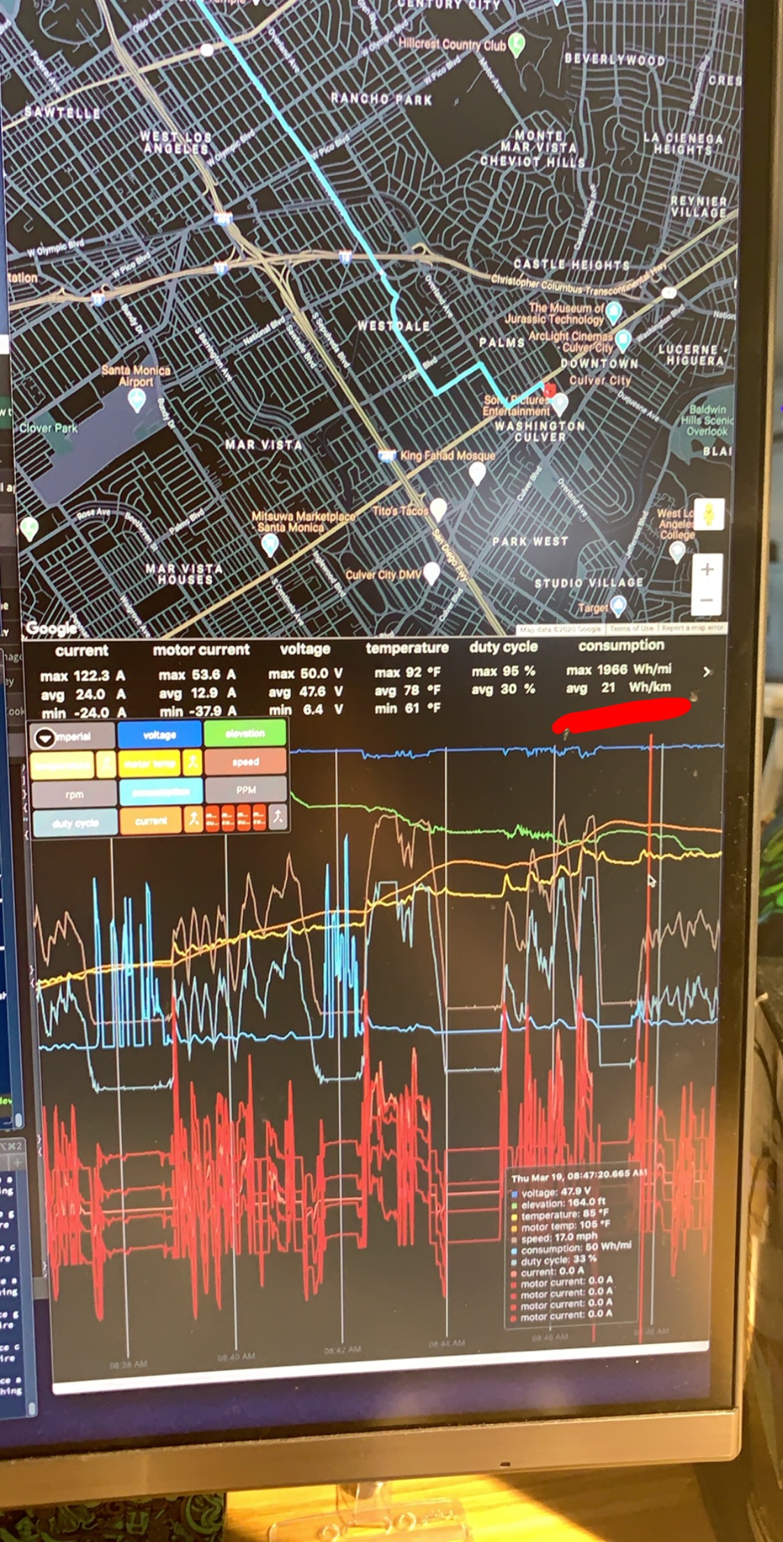

@rpasichnyk after uploading one of the logs I noticed that’s the avg consumption value when toggled between metric/ imperial fails to change. It looks like that element isn’t getting updated during the state change between the two units. All the other elements seem to update just fine. Probably just needs a listener on that element?
Images below:
same. Refreshing the page switches it.
Ahhh nice to know thanks.
Funny I had a similar issue when I was debugging an Angular app just yesterday lol.
Thank you, this is now fixed!
