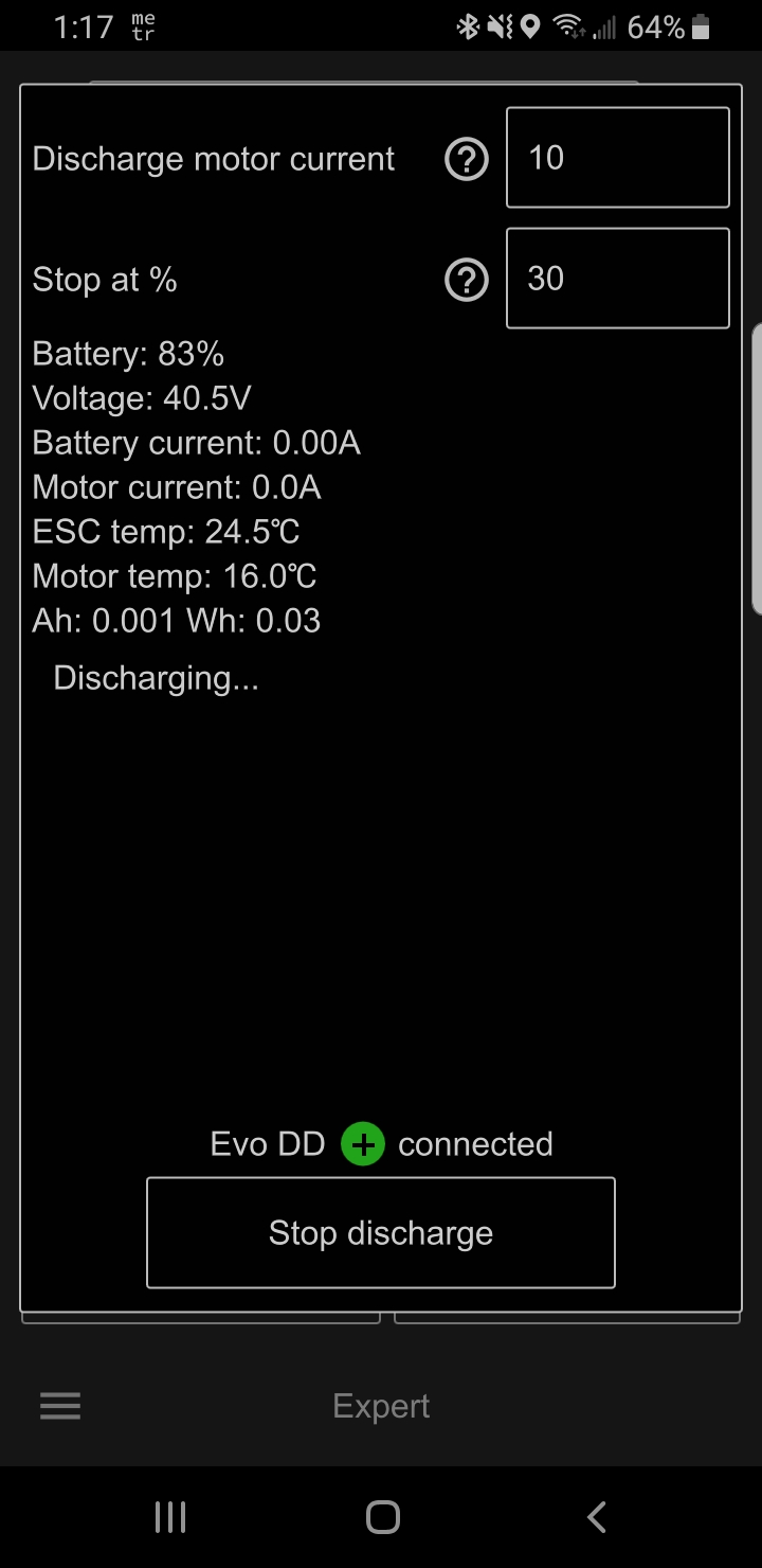

I also tried the discharge, do I need to change the FOC openloop and FOC hysteresis values from 0.1 or something else? motor and battery current stay 0. This is what I see when I activate discharge:
Great, you found a bug! And I just fixed it, new update is coming out soon :slight_smile:
For discharge you have to switch to FOC, yes. Do you have working FOC setup?
Sweet thanks!
yep, I have both FOC and BLDC setup. Trying to run discharge when FOC is applied. I reran FOC motor and FOC sensor detection, applied, tried again and still no discharge activity. Tried changing FOC sensor modes (hybrid, sensored, sensorless) and no difference. I tried changing openloop ERPM (100, 400, 800, no difference) and FOC openloop time (0, 0.1, 1, 10, no difference). It does seem to make a really soft clunk/click sound sometimes right when I hit start discharge. I think once I saw the very beginning of that animation, like one little spark on the discharge screen that immediately disappeared. I wonder if the openloop command is different on Ackmaniac…

Yes I just installed Ackmaniacs 3.103 on my board and did FOC setup, and discharger not working. Timeout hits too soon (and that’s why that click sound). Investigating…
So it’s a bit weird with Ackmaniacs 3.103 and foc_openloop command. I think because of the changes in timeout.c (firmware code) In official firmware there is no logic analysing RPM, in Ackmaniacs timeout hits when RPM is low.
At the same time it kinda works for me, but only 10 seconds or so. Then (scary part) motor spins fast for about couple of seconds and UART dies. After I restart VESC, it’s all good again. But probably discharger functionality should be turned off for 3.100+ :see_no_evil:

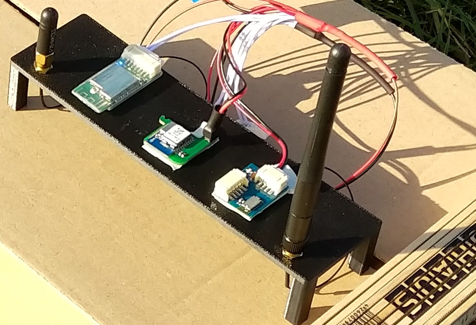

what does the small external antenna look like?
small external antenna on the left, large on the right

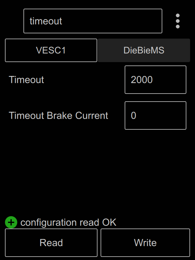

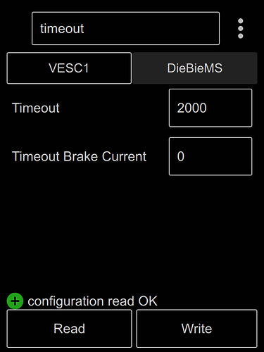

Try to increase timeout value from 1000 to 2000
If it doesn’t help, please send logs (Settings -> Show Logs) to support@metr.at

So I took iPhone 7 with iOS 13.2.3 and noticed a bit weird behaviour. Sometimes it would freeze app for 4 seconds when screen locked / background. Can you try increase timeout to 5000 from 2000 (both VESCs) and try again?
Tried it and the result was better. I have sent you a new log file.
