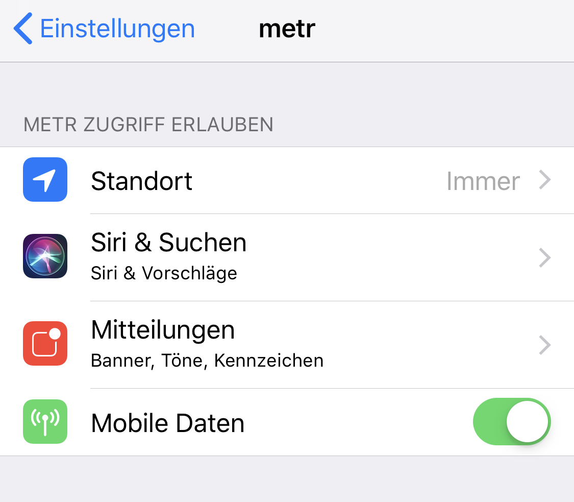

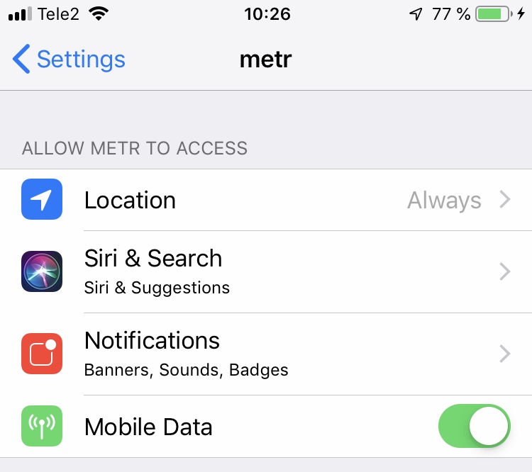

@Andy87 can you check location permissions for metr app in iOS on your phone? Should be set to always
Just checked
It is set to always
It worked for me with the same settings that you have :thinking:

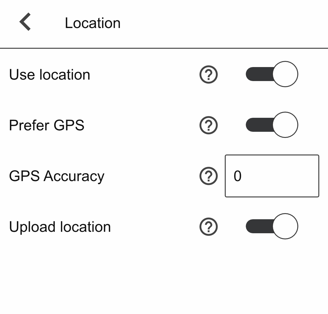

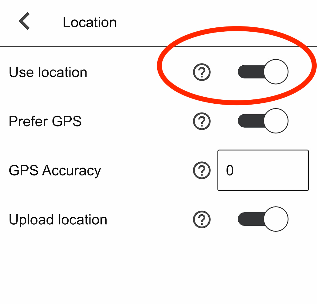

Just an idea, turn this switch off and on again, maybe something is wrong with iOS permissions and this will trigger location request.
Do you have a small location arrow in iOS status bar when you are using Metr app?

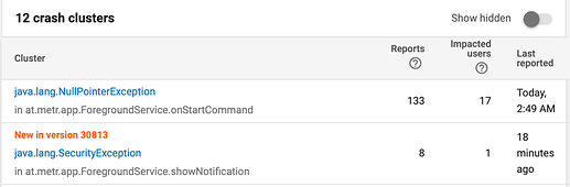

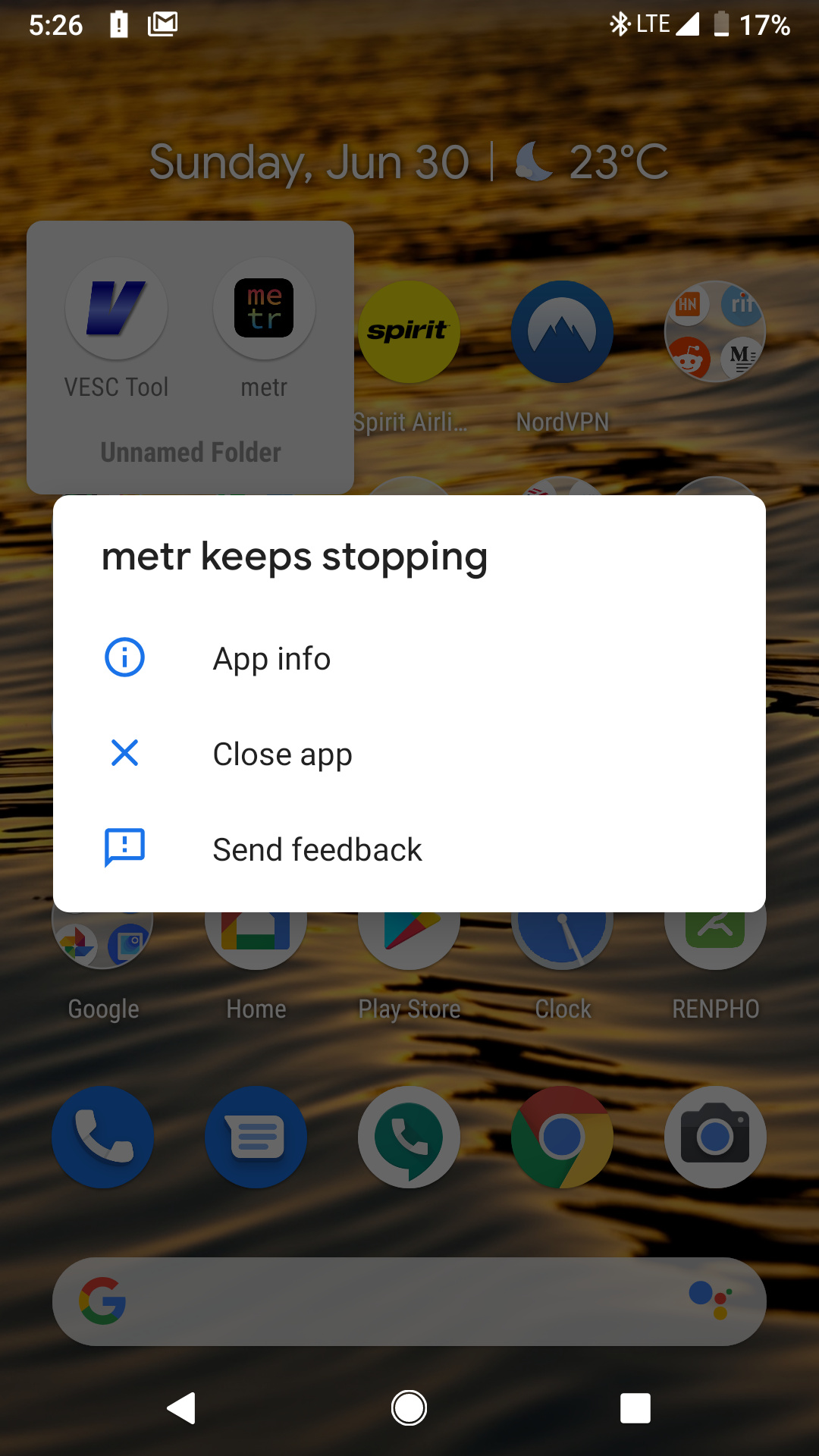

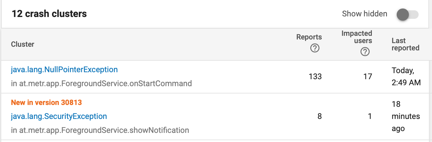

I have the latest firmware and app on Android and it keeps crashing. I have the lastest firmware on vescs too. Pixel 2
Does the app even start? Logs?
It doesn’t start. I have even restarted my phone. I have sent feedback with system log.

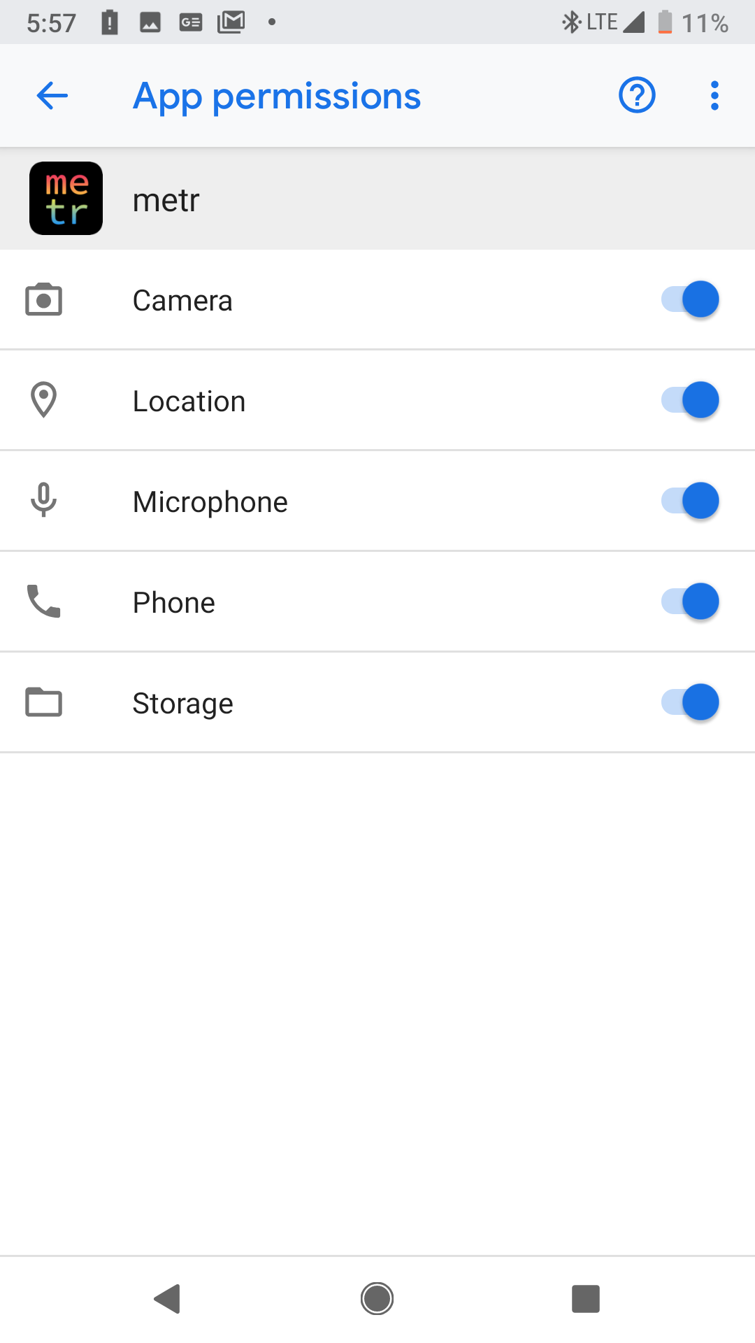

I will have a look tomorrow on Pixel 3. In the meantime, give the app more permissions, maybe it will help
Gave it full permission, still nothing. Should I clear cache and data?
No, we figured out the crash was happening only on selected devices (that’s why not spotted). Thanks for letting us know! It should be fixed now, please update :slight_smile:
