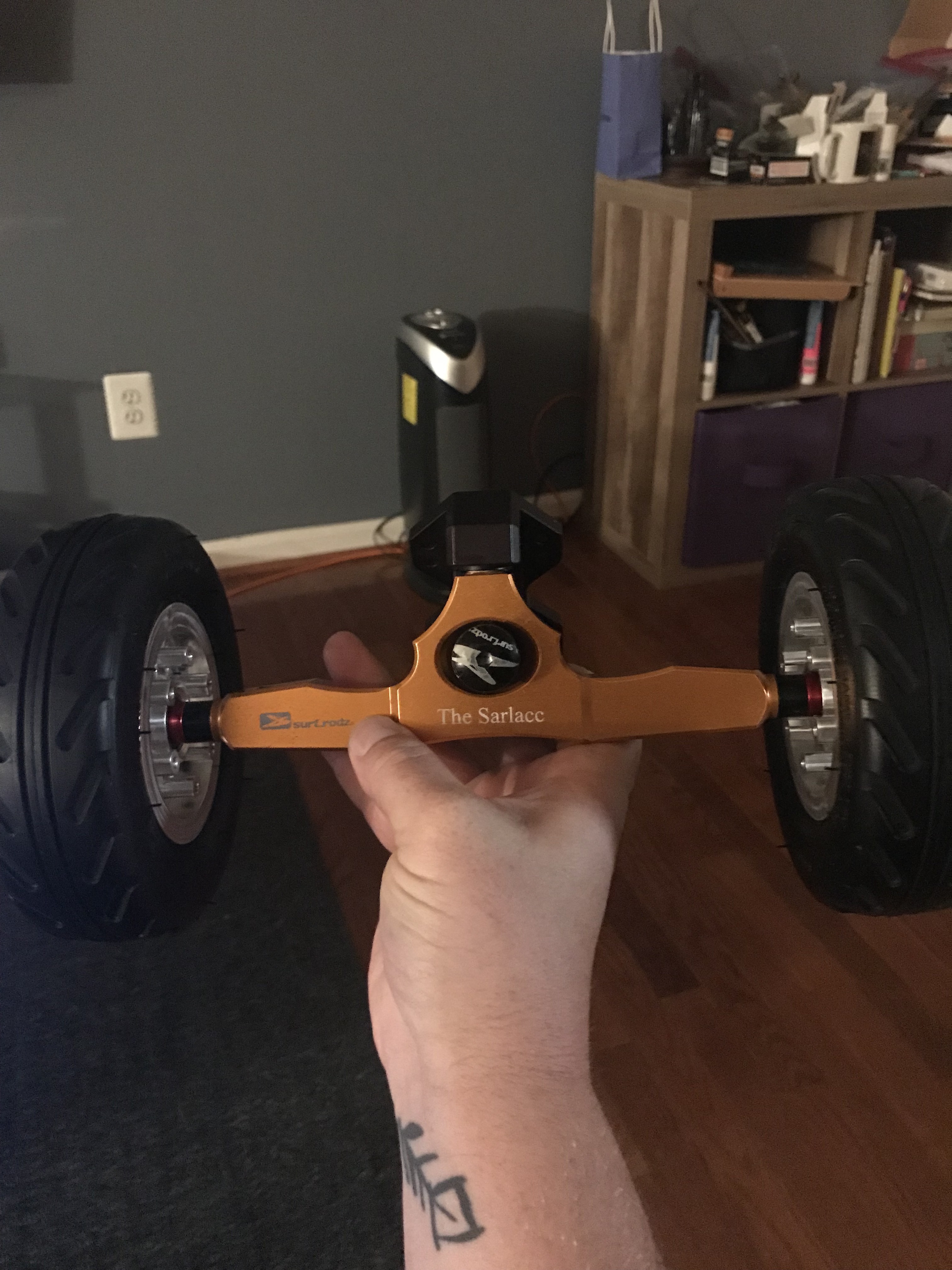

Yay!! More money to spend on my board! That’s why it’s named ā€œThe Sarlaccā€
Just like the pit boba fett fell in to ā€œdieā€, this board is the pit my money falls in to die as well!
Not die more like equivalent exchange for pleasure.
