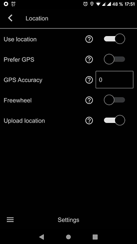

After finally upgrading my phone I went to Android 9. Module was found, all good, stuff works. Except for location. For the life of me I cannot make it work in records. App has permissions, location is set to high accuracy. None zip nada. No location data, only one point on the map and that’s it.
@rpasichnyk any ideas? I could send a long, but I read it and it didn’t seem to have anything. So maybe it’s just a phone configuration thing…

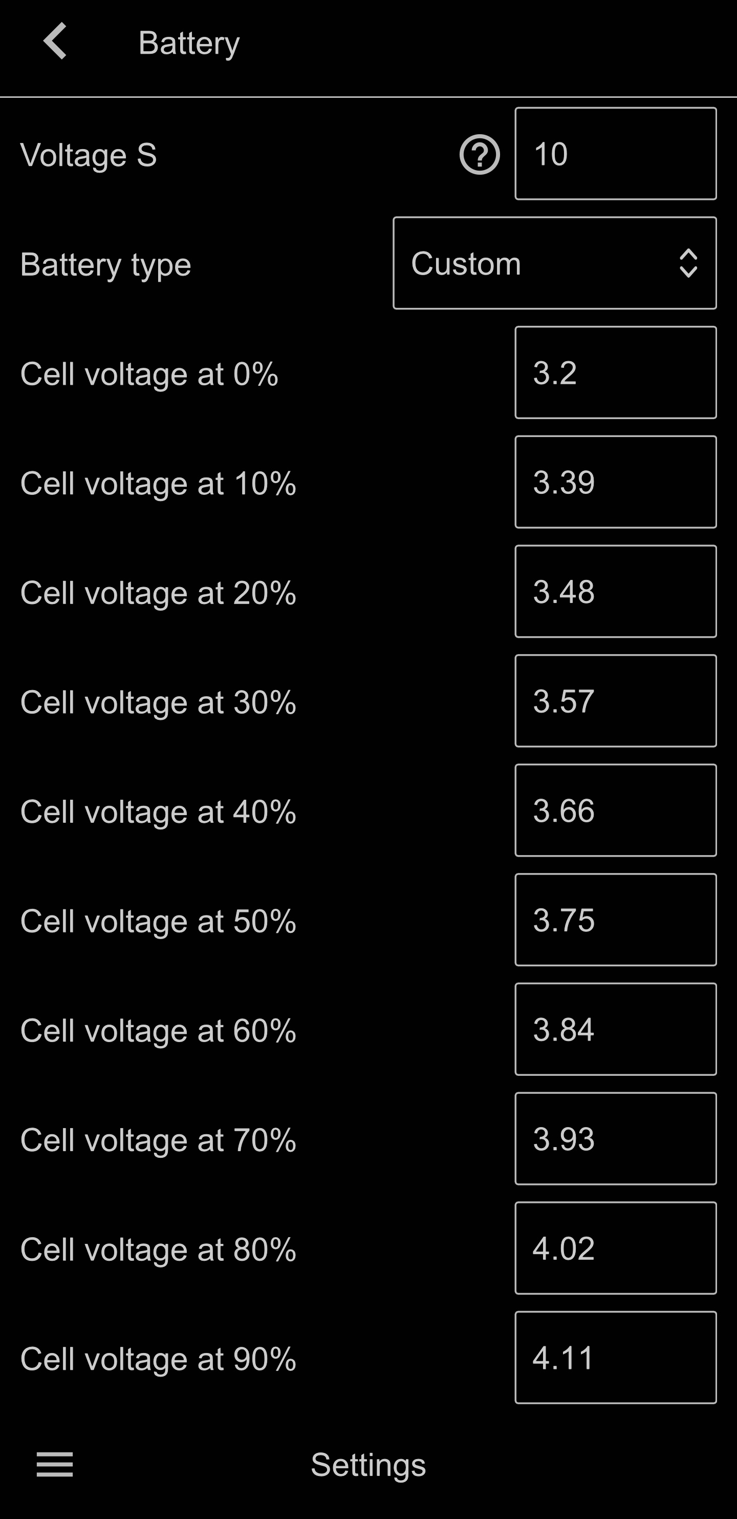

Any idea why the metr pro says my battery is at 88%~ at 40.8v (10s battery)?
Battery settings are set to 10s and 12 the size (12Ah)
It also states 33%~ at 36v
Because that are the percentages matching the voltages for the battery type you choose. You can also select ā€œCustomā€ and change it to your own values.
Edit.: Have a look at @rod’s screenshot, where you can see how to set the right cell voltage to battery percentage when you want custom settings.
This is why:
The Li-Ion option has a similar table.
You can play around with these values if you don’t like them but I find it to be much more precise than most battery meters.
The only way to precisely measure battery percentage is by implementing a coulomb counter. Battery discharge does not drop voltage linearly.
Yeah i found it. Settings were set to Li-Ion ( I use 30q cells.)
