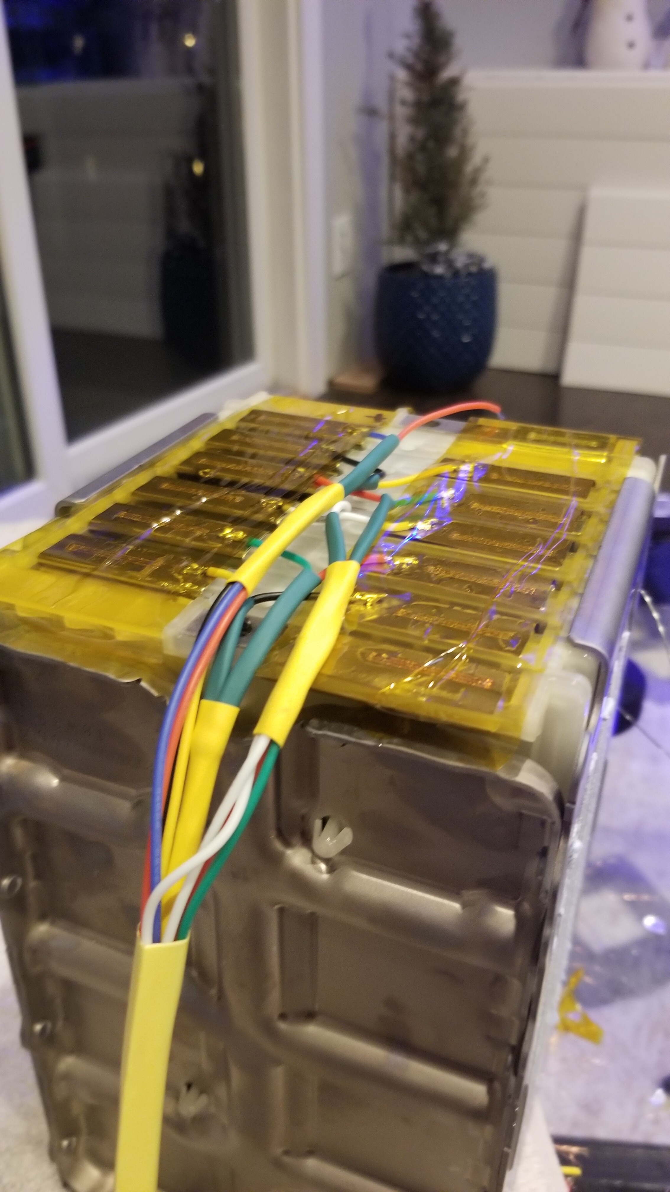

Mercedes OEM L09-1 EV Battery is pretty cool.

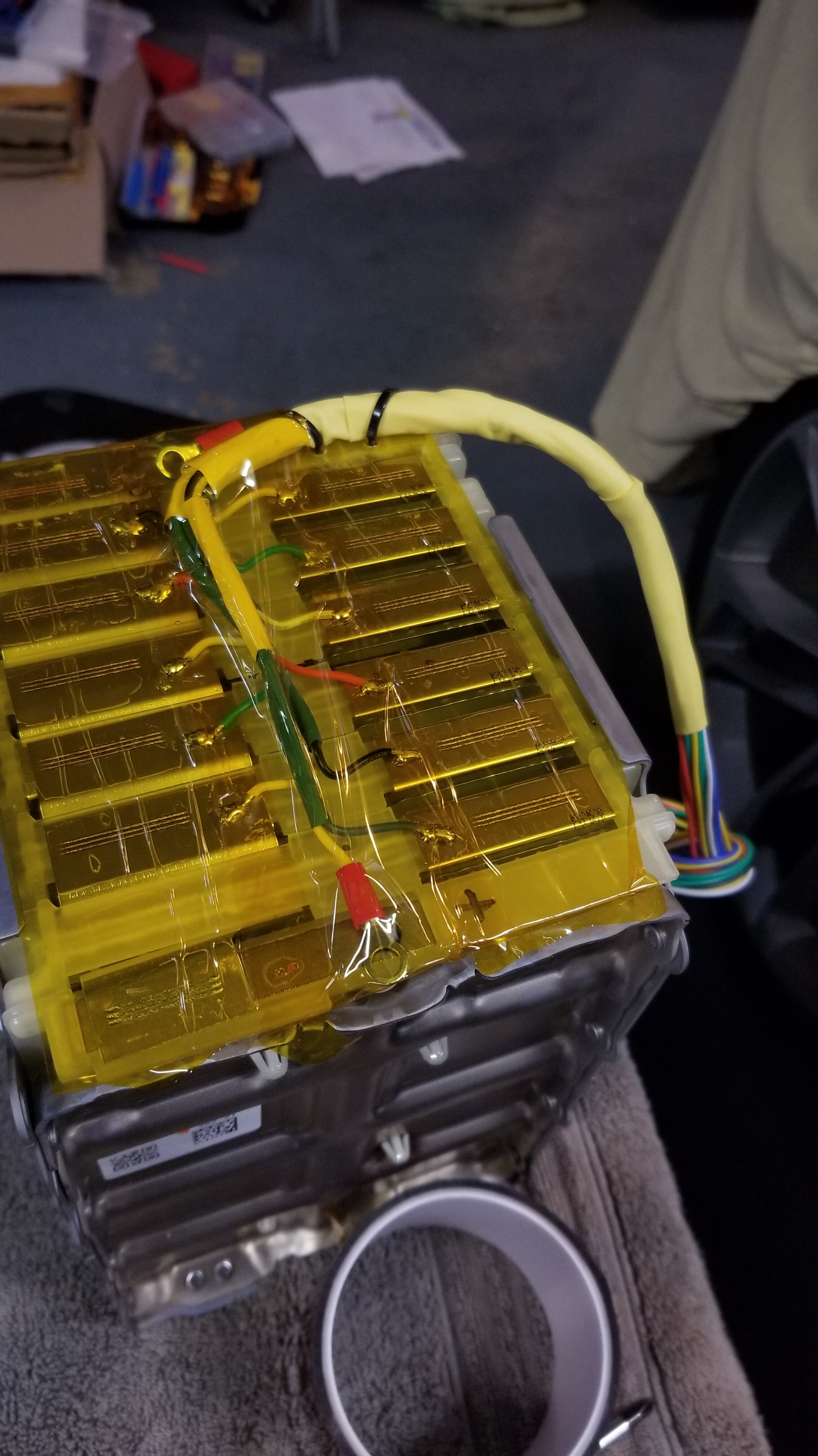

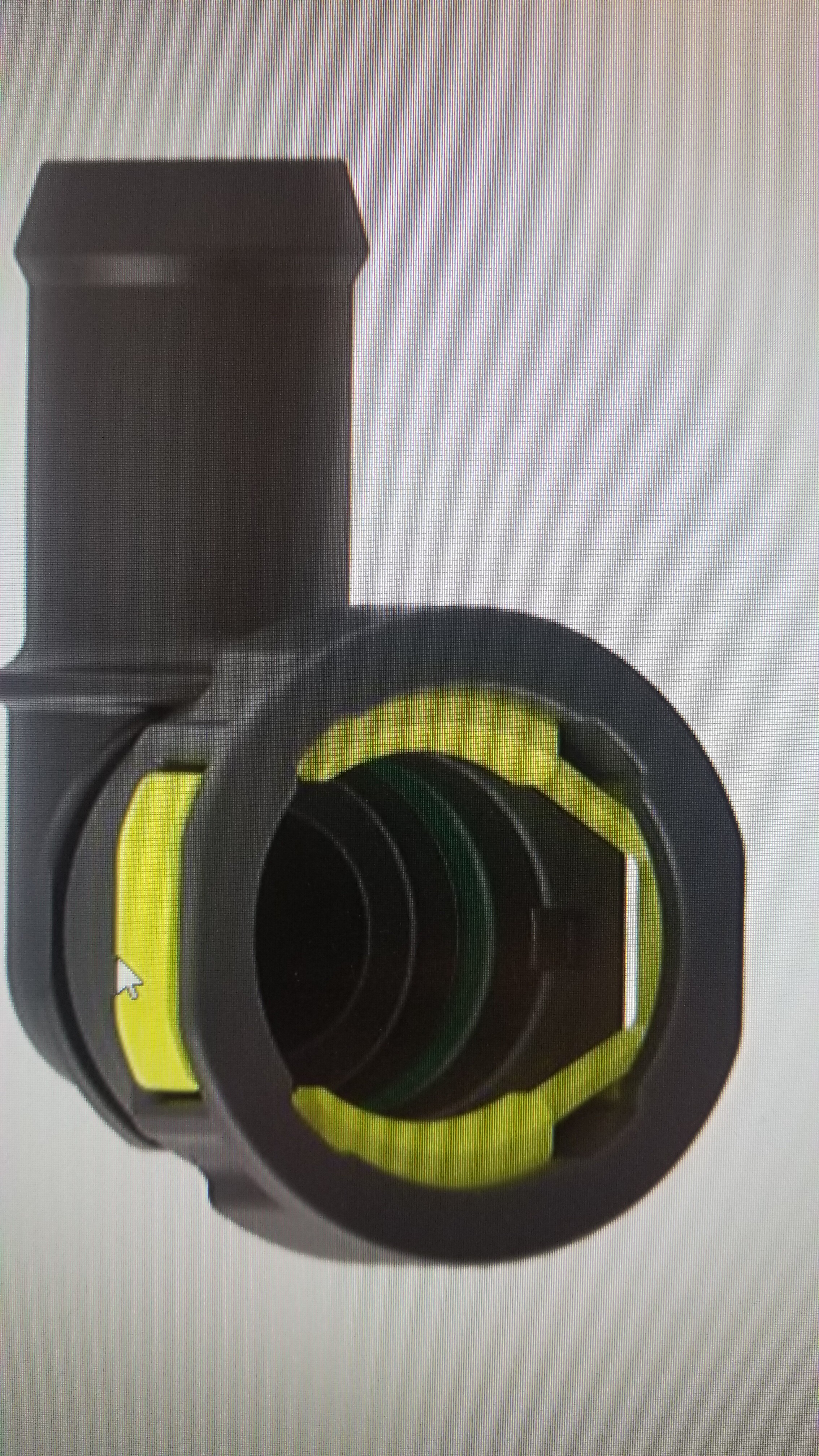

yeah some quality rubber tubing would be good you would need something flexible.
Whatever liquid you use would need to not grow anything in it I’m not sure what I would use…
Agreed. I want to use pex (rigid and wont puncture or kink) and I can figure that part out. Just struggling to make a reliable connection with any material to the battery
I’m going to use automotive coolant, just like what used to be in there!
I like the rigid idea but that seems more prone to vibration making noise or snapping on a crash causing a spill. Flexible all around for me I think, maybe straight runs would be solid but very well attached.

Nood point on the cracking aspect!!!
I think I found the connectors!!! Took a TON of calling around to get this far, now it’s just a matter of sorting through the options. I think it’s one of the 17.5mm or 18mm ones? The link is the page we need to scour, the image is just an example of one that’s close.

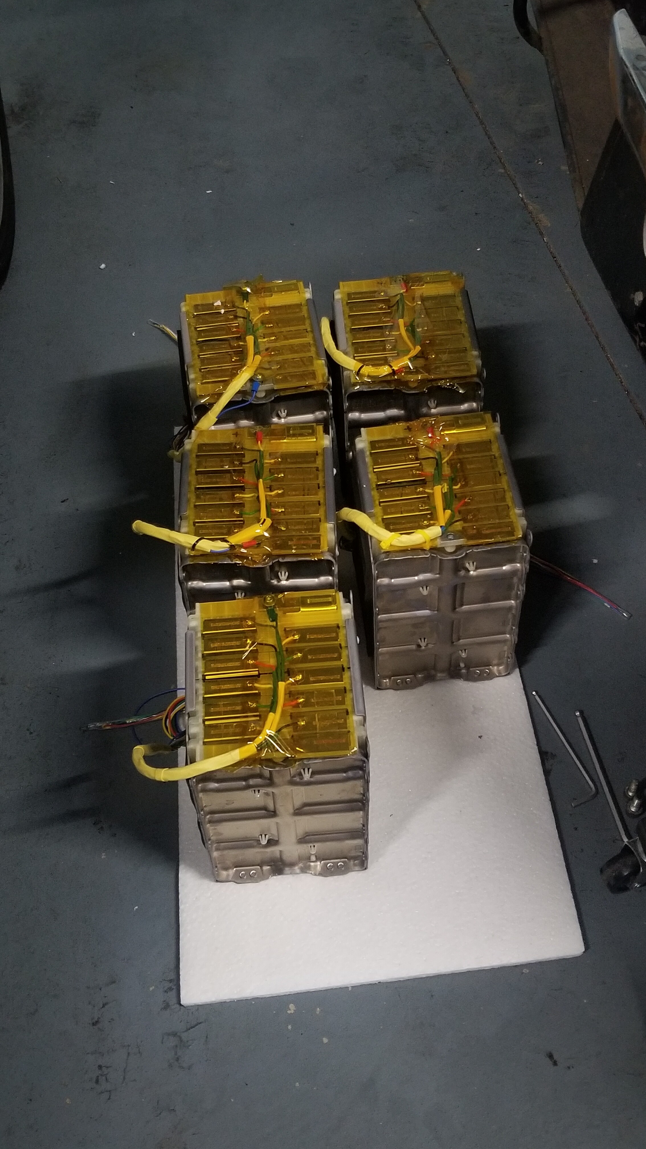

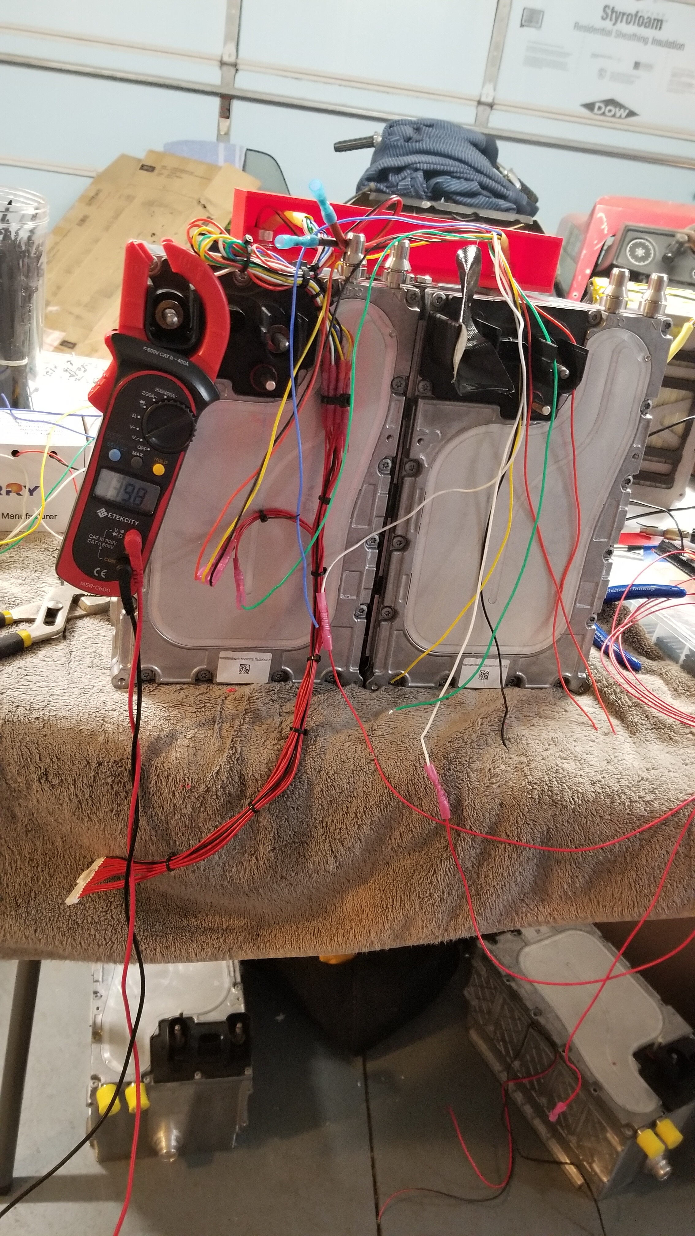

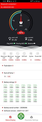

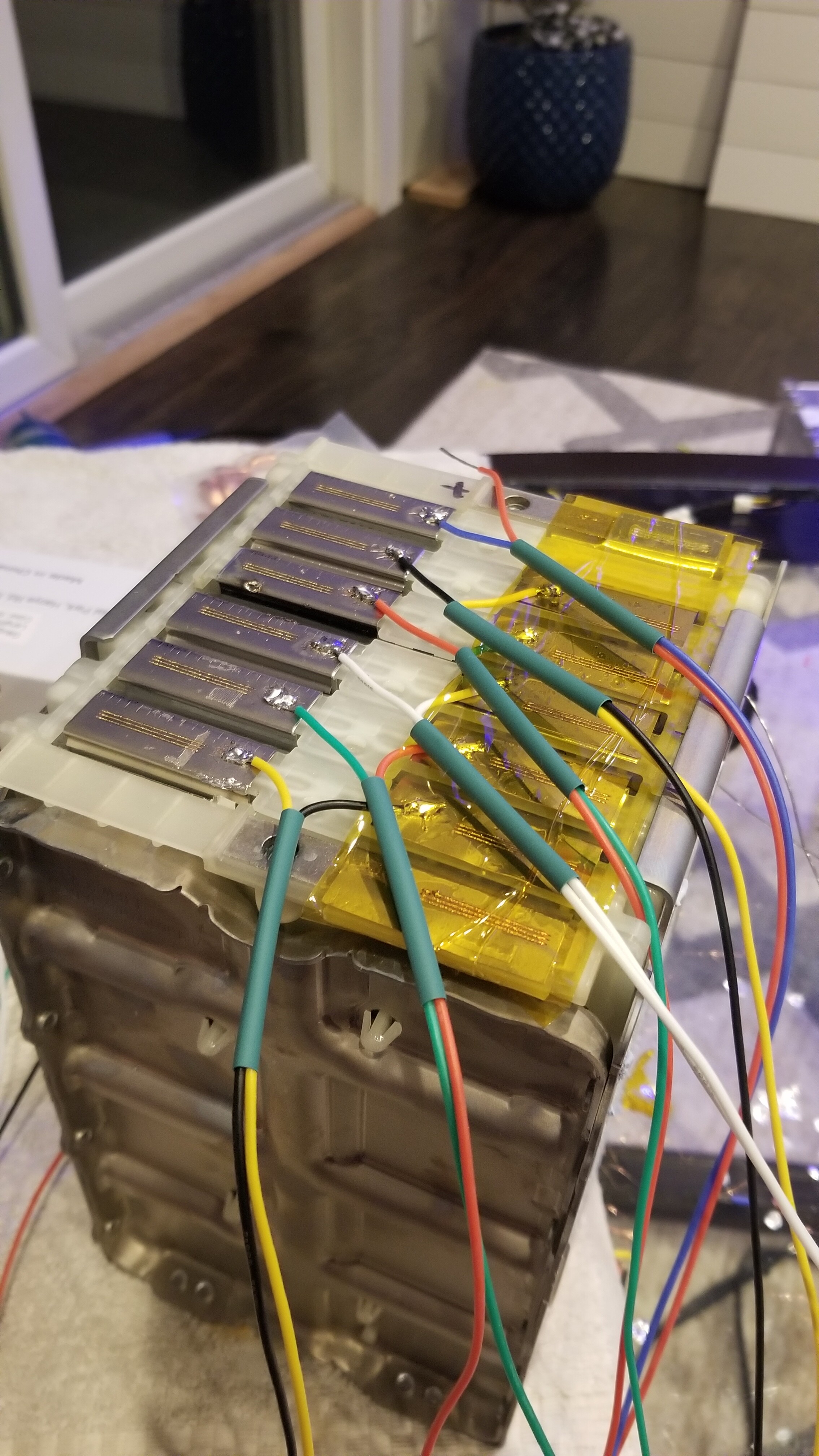

I’m pretty impressed with these packs. Have 2 in series to make a 24s pack at around 96V or so. Hooked a Daly BMS to it and look how even the cells were! All within a .006v range of each other!

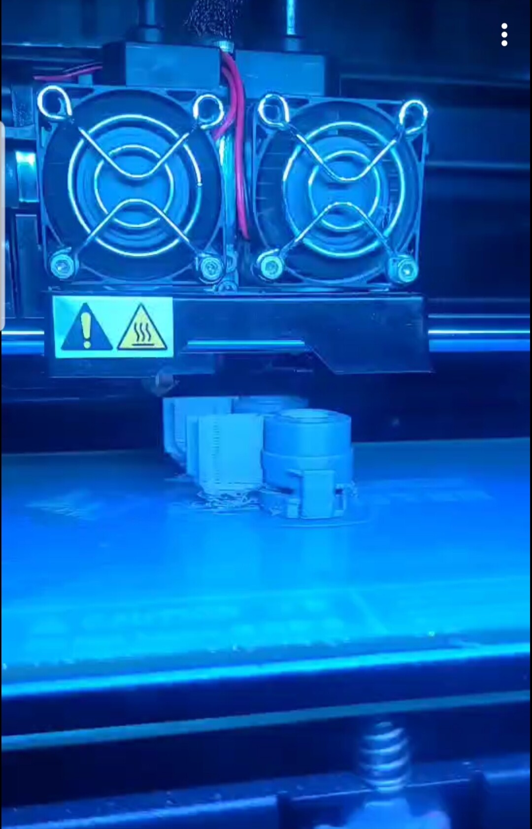

Working on 3d printing hose connectors. If it works I will let ya know
I man you could always have just hose clamped some tube on bit I’d like to see the design.
Yeah, these packs have a lot of power, I didnt want the line to break and short out the BMS or overheat the motor. Will send ya pics tomorrow.
