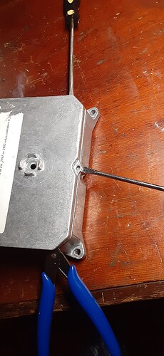

I have some ideas for the box they are in however, I just need to crack this one open successfully this time (other one I snapped the tabs under the bolts off trying to pry on them)
@Passedyouby did you manage to get the box on top open? I was thinking of trying to heat it up with a hair dryer before prying
The Dc/DC converter box? Naw, I noticed they aren’t torx bits, but instead some sort of odd bit. Figured there was plenty more to figure out stripping all 6 of these things for now and would get into that down the road! Haha

Which tabs dis you snap?

This is the only spot it was easy to pry under, also the weakest so idk why I tried. With the amount of glue it clearly could not work.
The person in the video linked in the first post was able to get it open but I think they were fairly destructive.

To open, leave it on your heater and forget about it. Then start on a corner with something small then move to two flatheads.
Keep prying
May need reheat if you don’t get most of the glue broken
Hardest book I ever opened in my life
