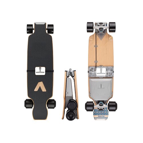

Sorry for your woes, but in the interest of kayak space limitations there are manufacturers who make folding boards, at least one of them sold the hinge separately
Edit: Old post from the unmentionable place
It was these guys, they don’t appear to sell the hinge separately any longer although their decks with the hinge are very reasonably priced & made with Canadian maple or so it says

I’d never thought about a folding deck build to slip into sit on top kayak hatch.
