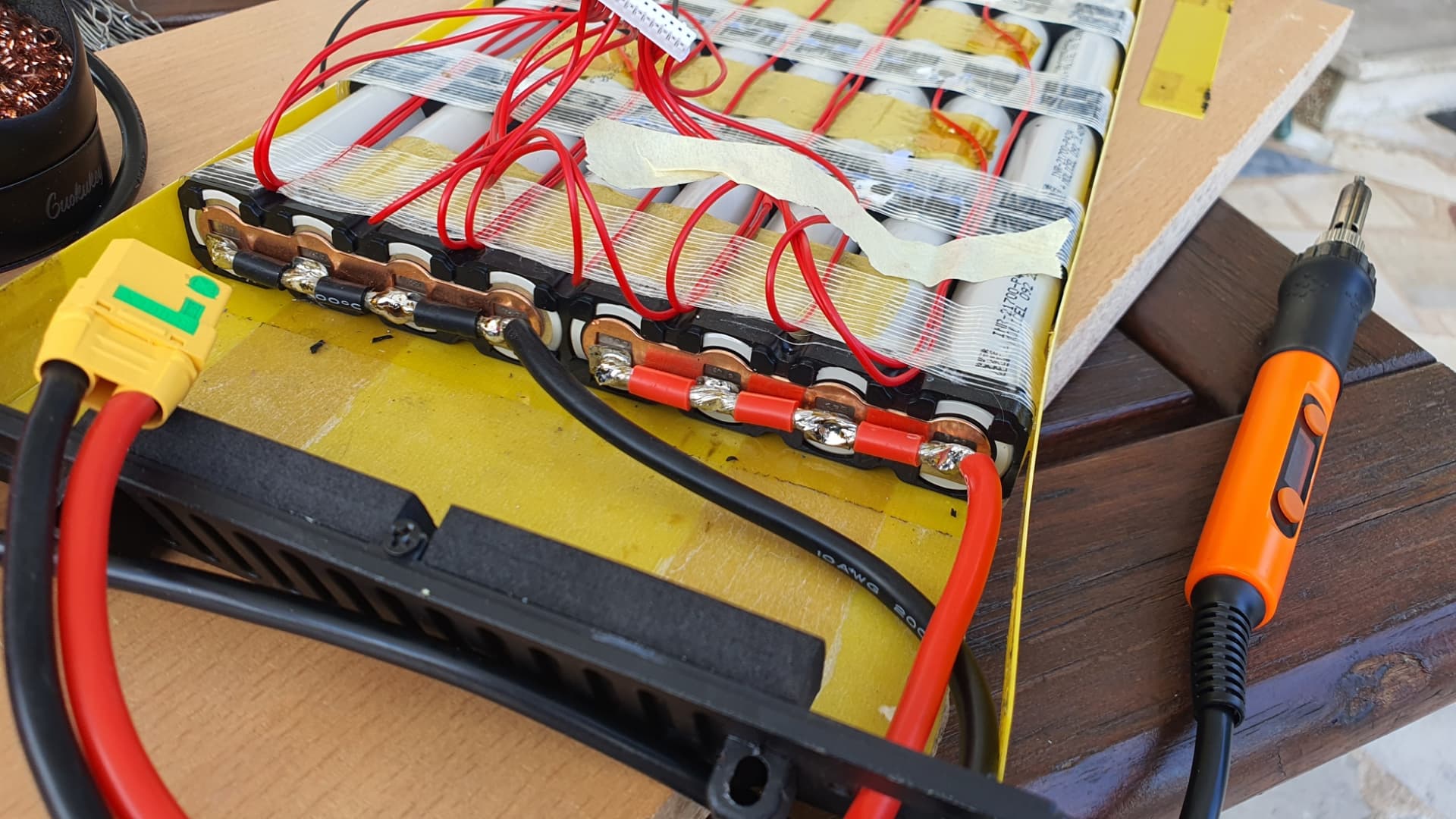

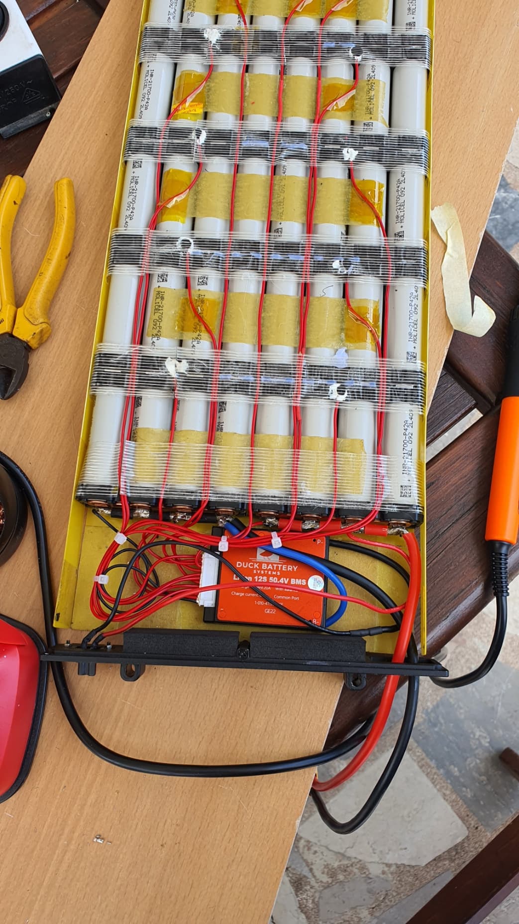

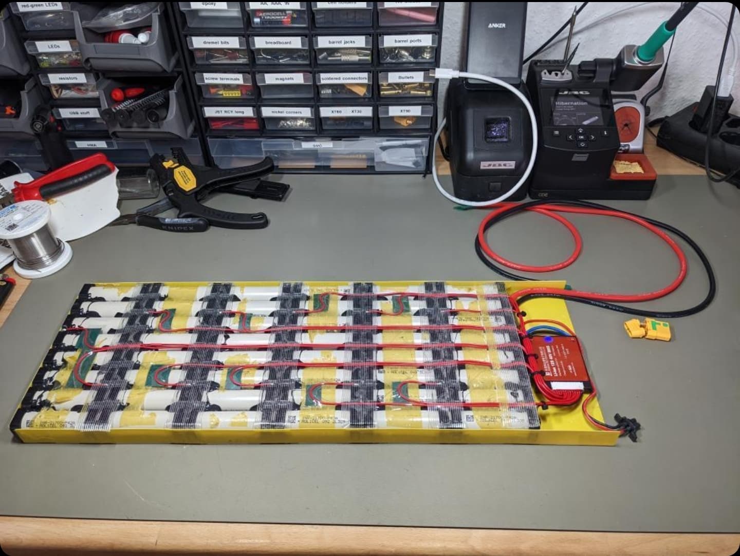

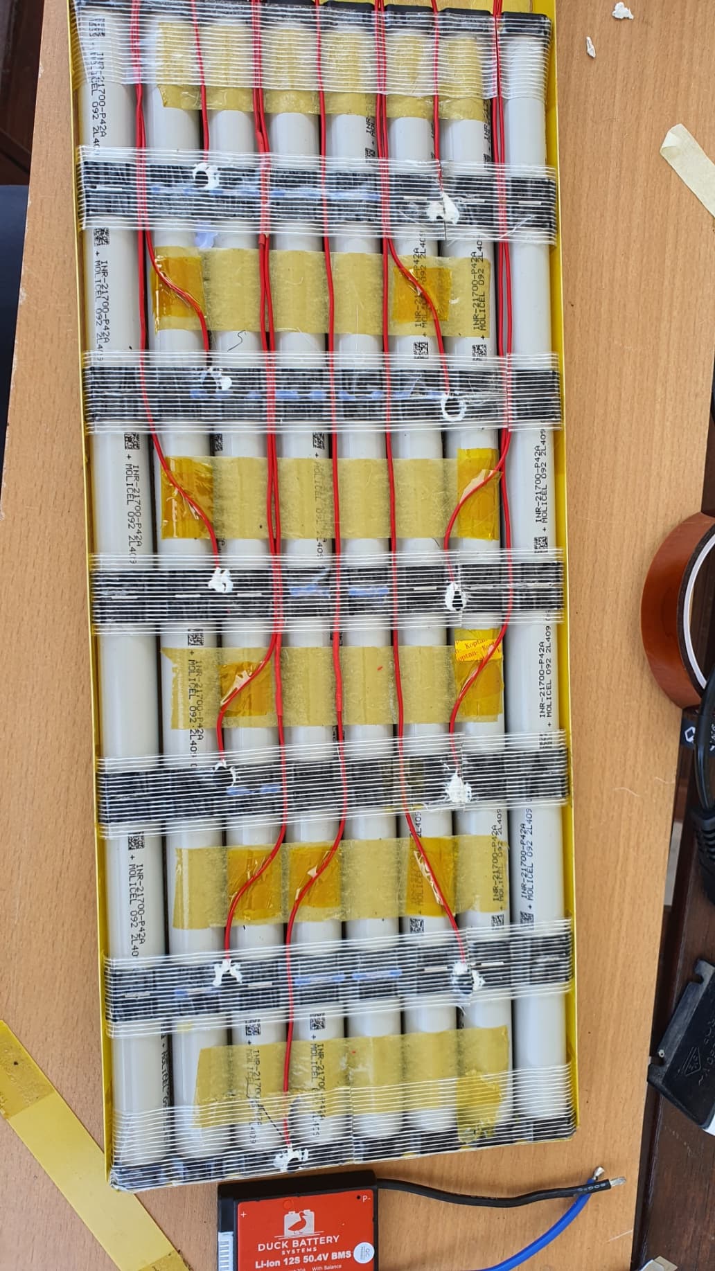

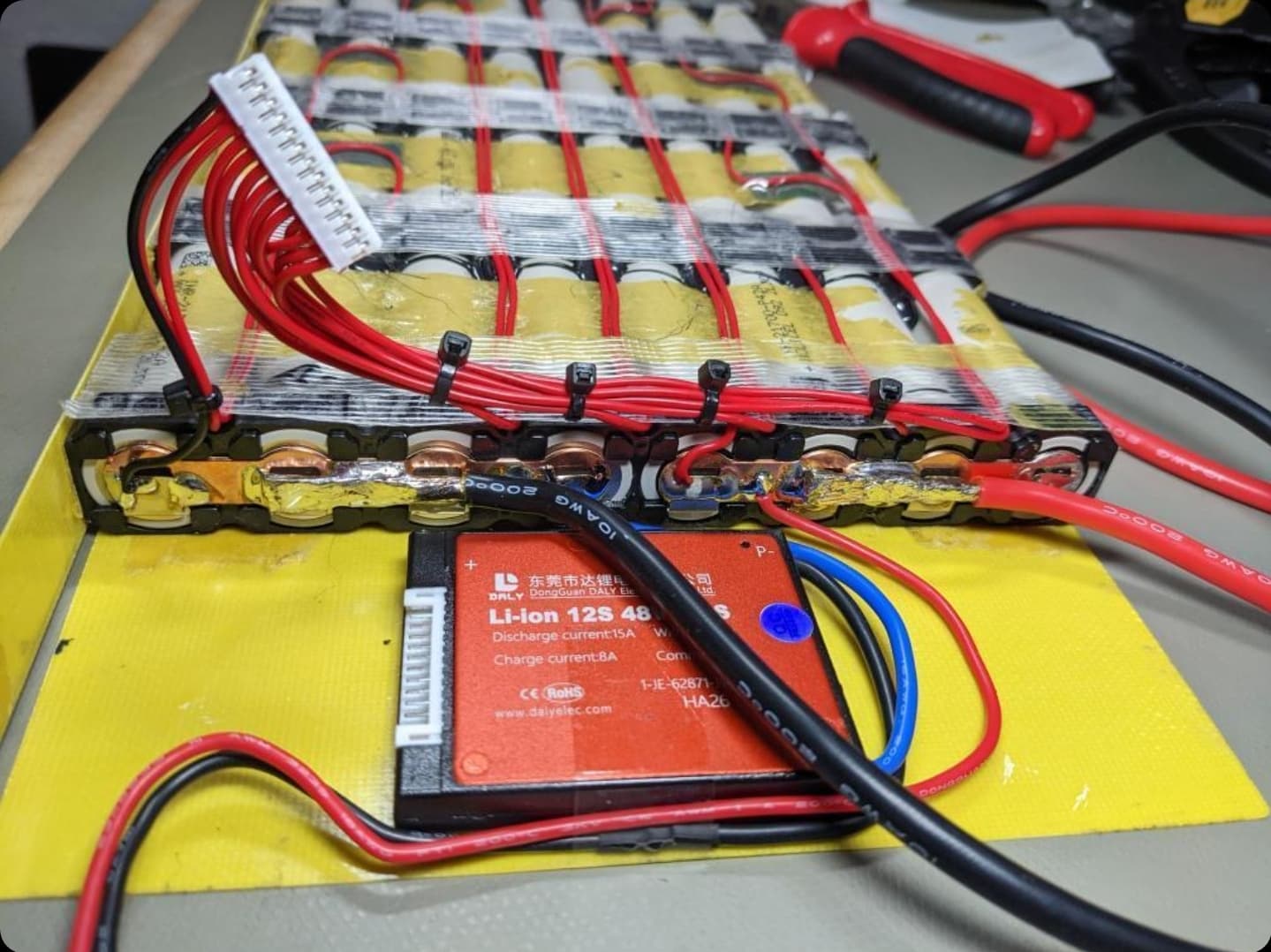

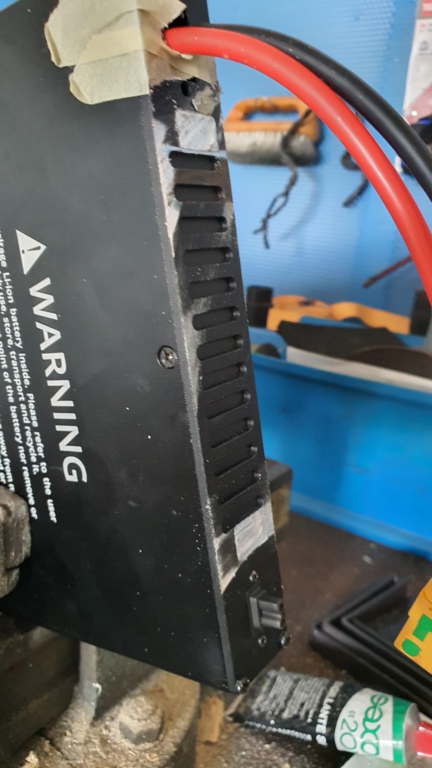

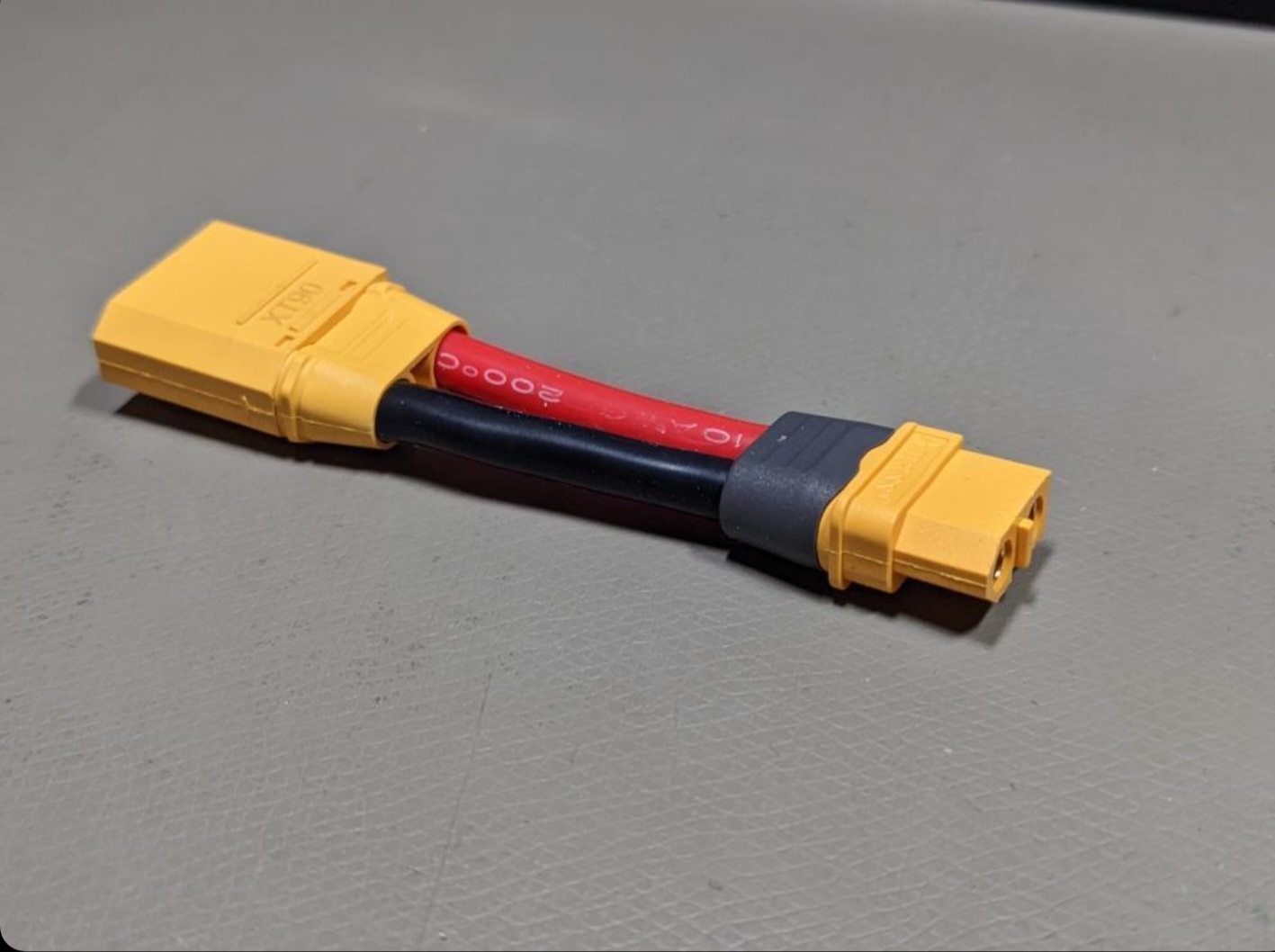

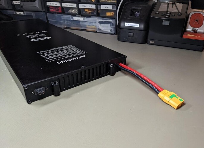

Bypassed battery by @Simeon
Daly is such a perfect size to replace the meepo bms
I learned this the almost-hard way. :grin:
Cells at 0 voltage that then get pushed into the upside down get pretty hot.

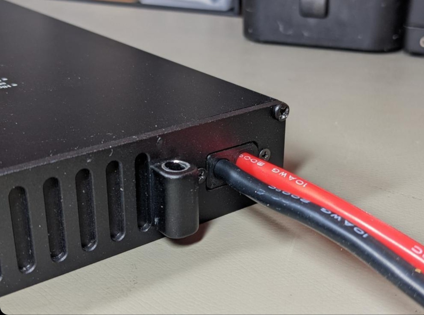

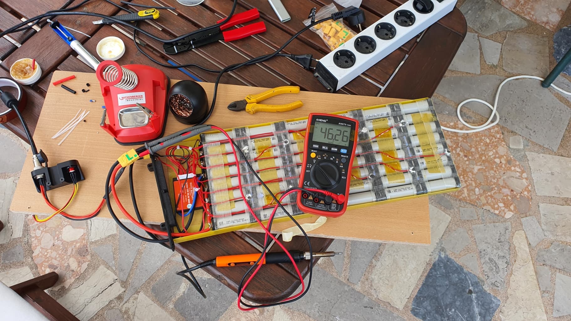

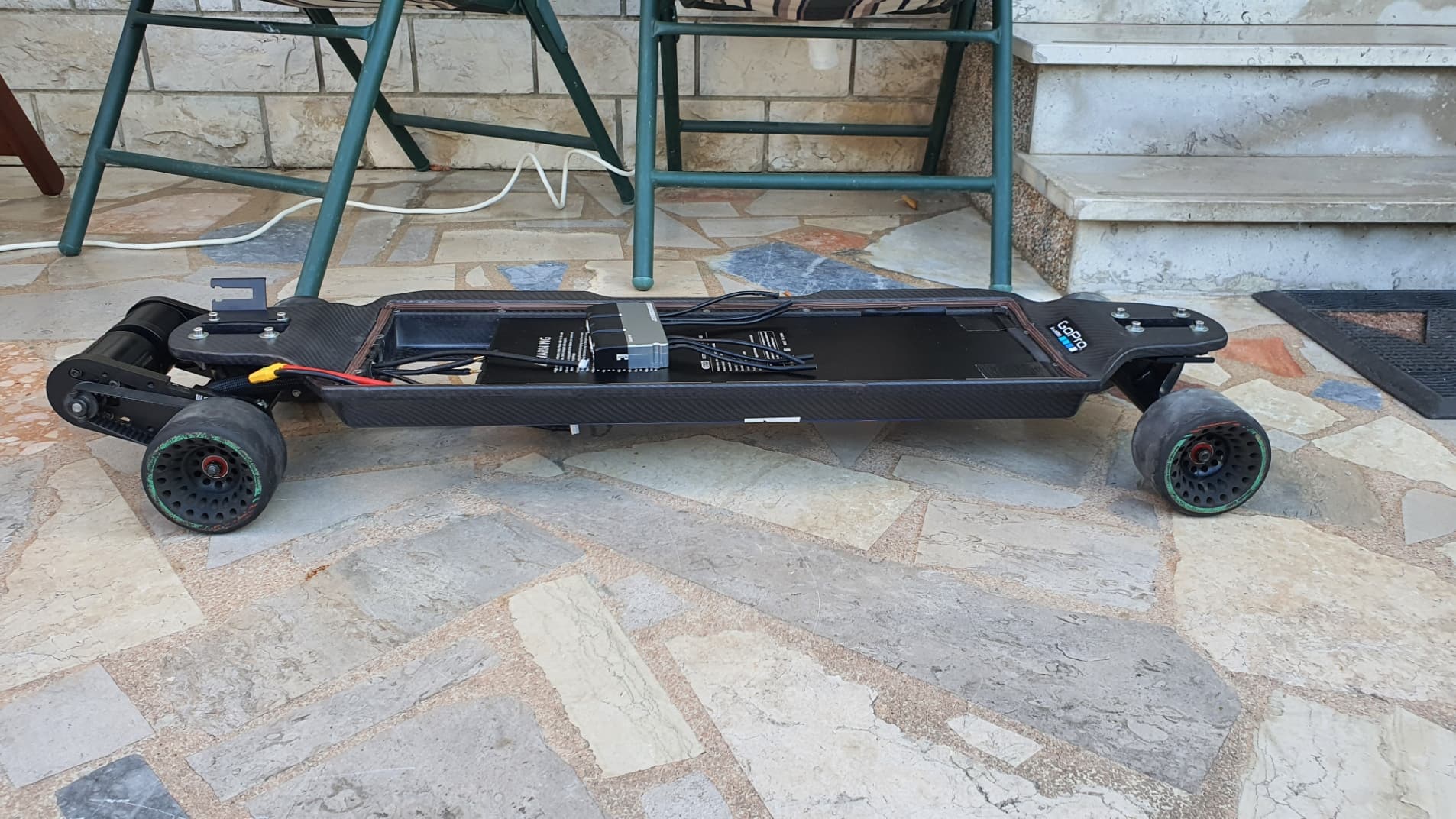

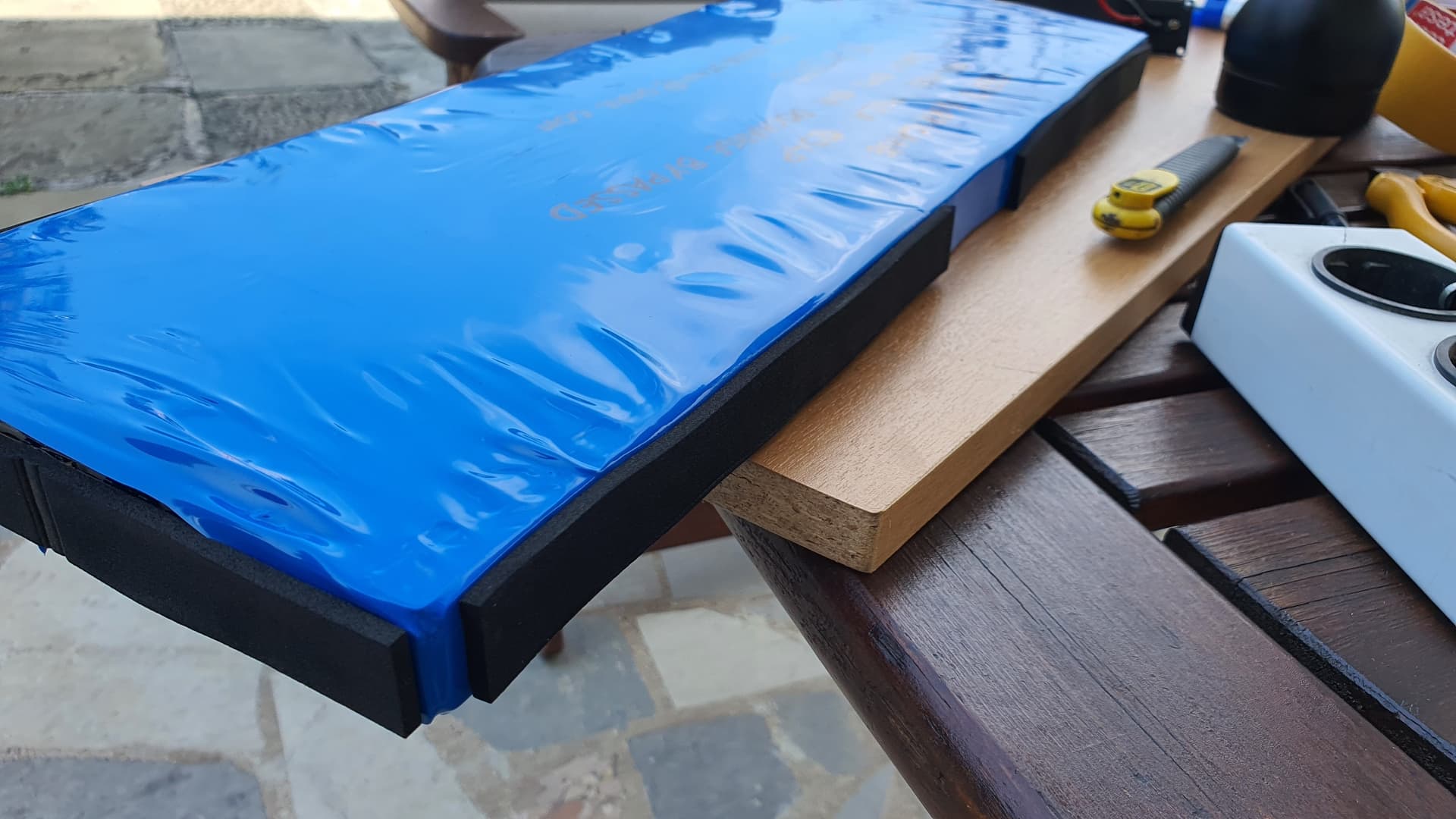

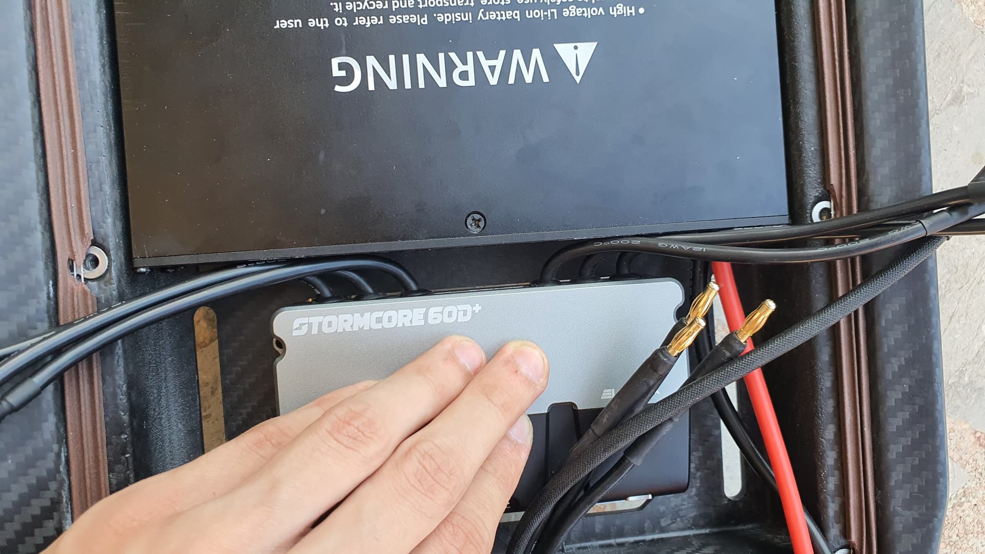

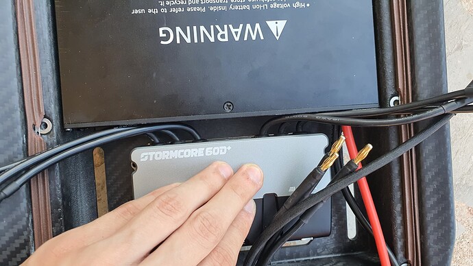

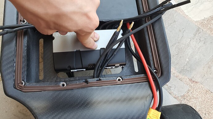

Here are some more pics of the Stormcore fit and my BMS swap.
Nice !!!
My battery🔋 is done aswell.
@Simeon did a great job even on the little details.
The esc is definitely a tight fit its gonna be intresting fitting a cool plate.
Curious how you gonna setup the esc ( how many amps you will be running per motor)

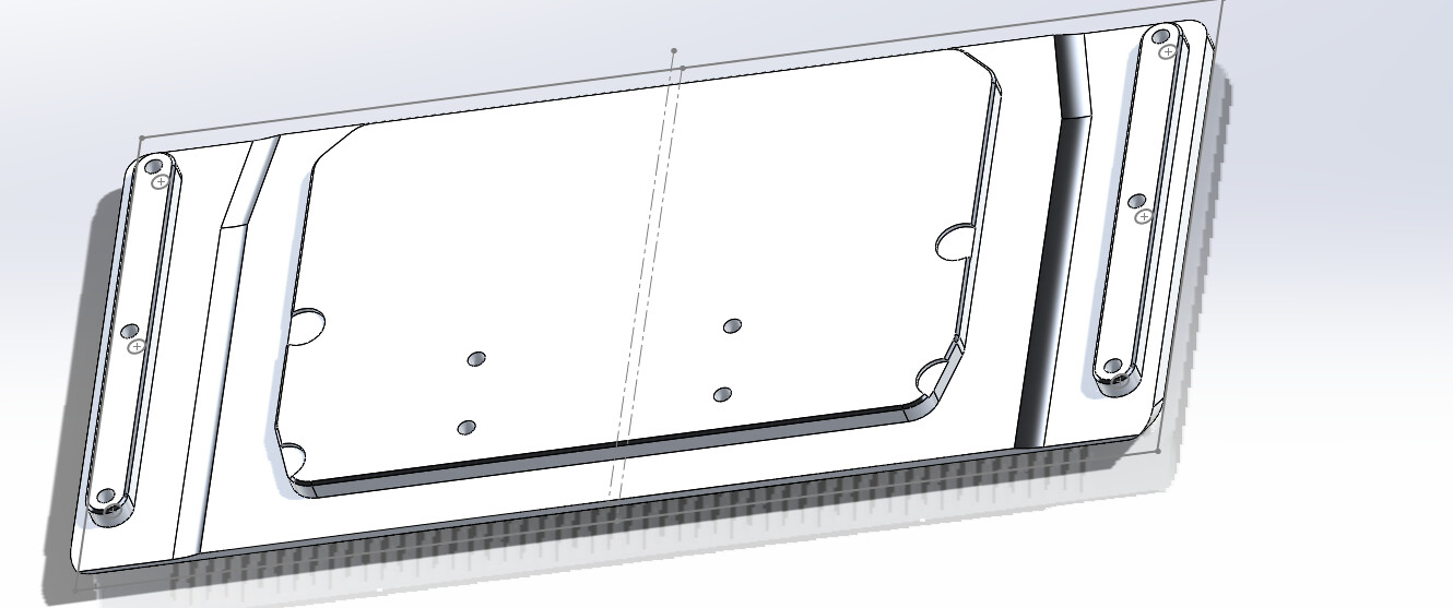

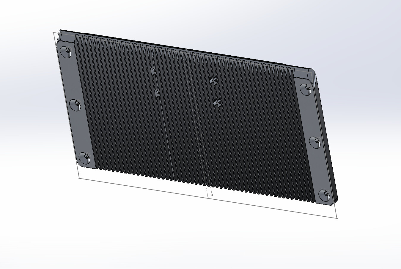

I took the design to my local machine shop to have it CNCd, excited to see how much I messed up :joy: Measure once cut thrice right?
if it works, i might want a piece
How much did you get quoted for that much milling?
I didn’t, I’ll find out when it’s done :joy:. Speaking of, since I know nothing about the process, which part of my design is most expensive/time consuming to make? The fins?
Probably the fins yep, they’d be annoying to cut. It’s either that or any tapping of holes, if that’s needed.
@SabreDynamics probably have a good idea of how difficult / easy something like this is, he makes custom cnc parts
Oh boy… be prepared to shell out a couple hundred dollars lol
Be better if you’d make the fins a bit thicker, looks like they are 1mm now and that would probably mean they would have to be milled quite slowly to not cause any chatter while cutting, but there might be chatter regardless which leaves a bad finish. Id make them a bit thicker to be sure. Other than that it looks pretty doable. Because it needs two sides to be milled a fixture is needed so thats a bit of added cost, and you have a slight chamfer/3d surface on one edge which needs some extra attention while programming id reckon. Overall id probably quote this at around € 150, but I always check the cad model before I do a final quote.
