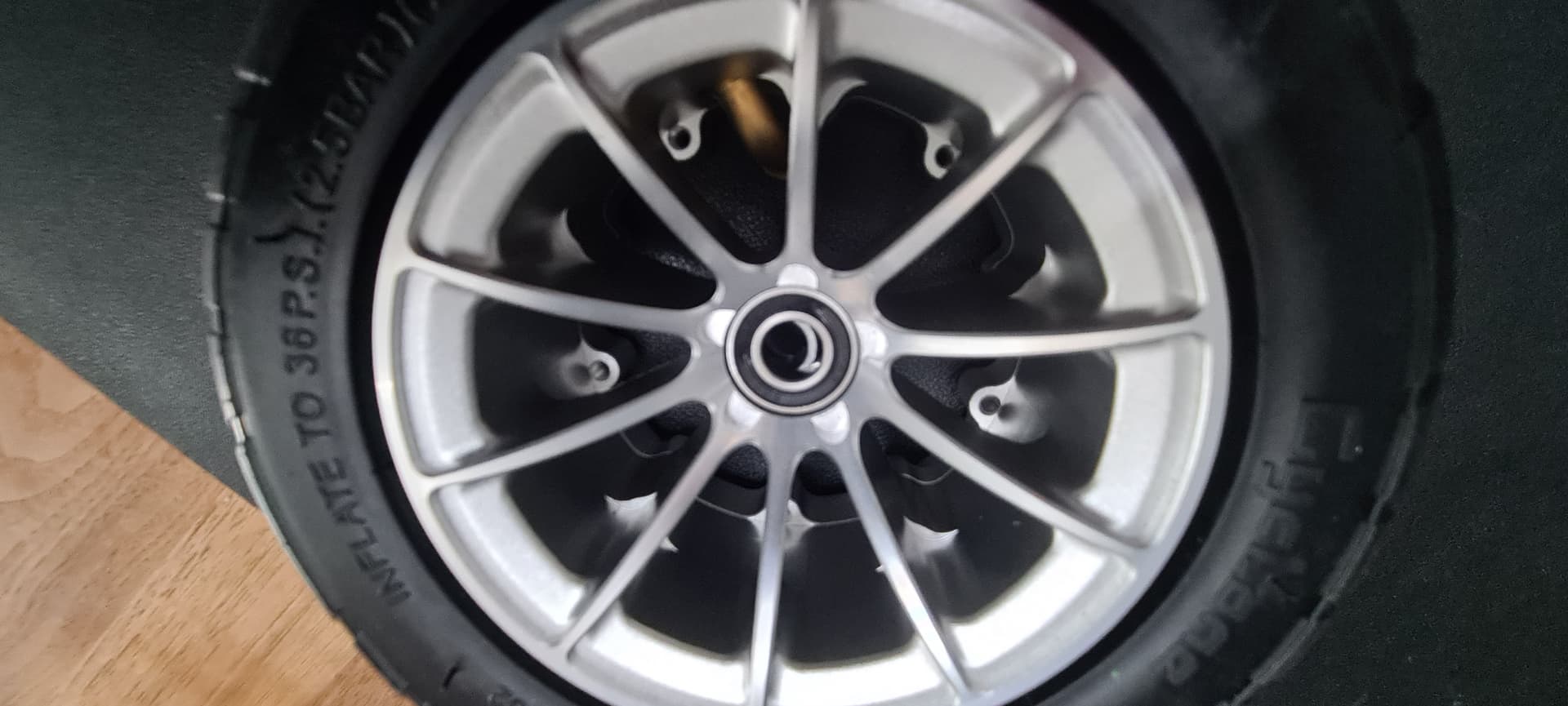

Does anyone know if their Cyclone wheels use an MBS pulley mounting pattern or at least something else non-proprietary?
they don’t, its their proprietary mounting pattern
I fitted them to my bn geardrive so yes the have a mbs bolt pattern but…
the screws go in from the back so you cant screw from the outside to the inside.
Ill post some pics later to demonstrate
@Boardnamics u said it wasn’t mbs?
Marked in blue is the mbs pattern but you can only acces it from that side as normally that were you would bolt your pulley on to.
I placed m4 bolts in there and shaved them to the right size to accommodate the bn drive.
The bolts cant be screwed all the way through due to the fact that the frame of the wheel( the other part) doesnt give it space.
So you will have to cut all the heads of your bolt of and shave it a few times untill it fits perfectly.
So officially its not MBS looking at the hole pattern of the hub itself.
my measurements tells me they are very close to mbs, but not exactly the same
Ill do all the bolts and then fit and measure them again and will get back to you .
Its seems like they fit but…i have not secured all the bolts yet. :dizzy_face: :ok_hand:
Cool
Really seems like a fit…
So it definitely fits.
I just used the pulley which bolts to the hubs.
Everything aligns.
You will need place a spacer 7 or 8 mm before you fit the wheel.

Very cool… Is this the wheel pulley that comes with the cyclones?
Yes , you can only use these pulley on the specific hub as it has cutout designed for it
