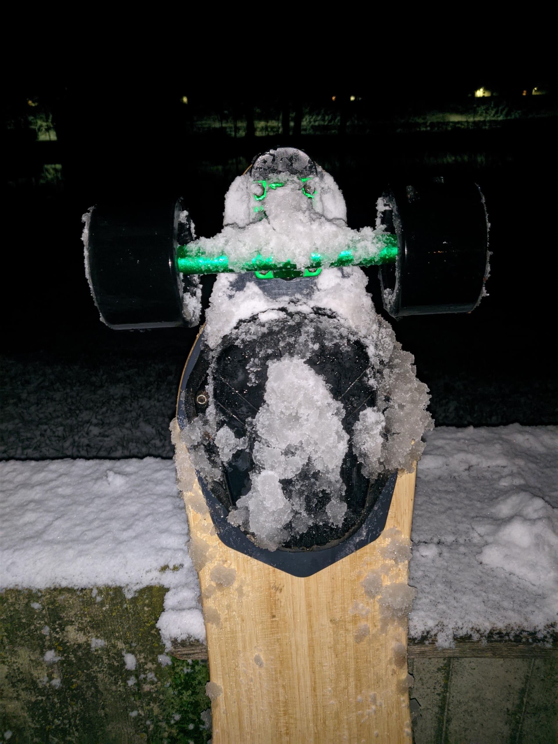

I have the never version of the v3 motors. Yours are v2? Or early v3? I love mine. So quiet and absolutely take a beating. I’m sometimes pushing up to 65A per motor when i feel funny. I’ve taken them through rain, snow, mud, gravel, everything and they just won’t die.
