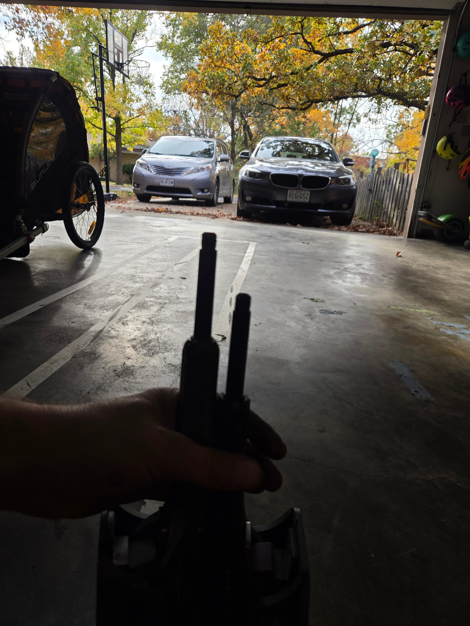

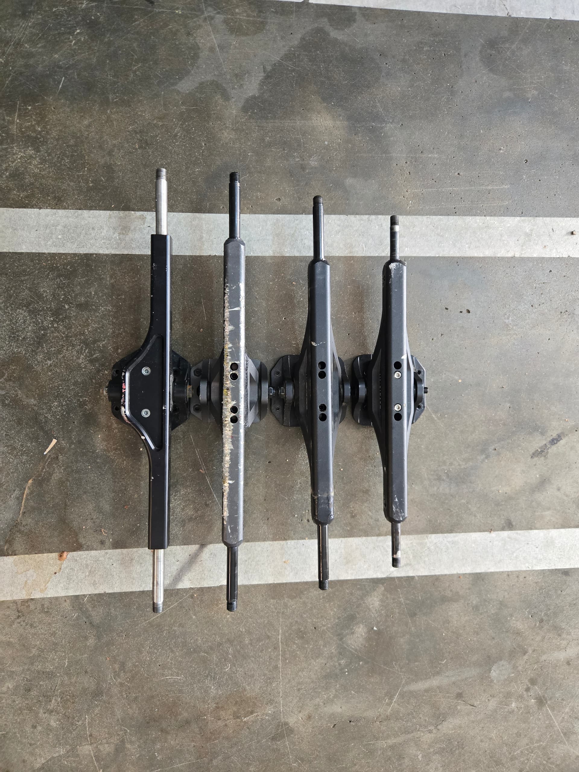

Good to find out that the CNC axles are different because I’ve considered the same ultrawide swap on my 320s if I can pick up another set of MIII sometime since I’d be almost halfway there buying 4 70mm axles. I was wondering why they only sell the stainless 70mm for spares and not the cromoly ones that come on the 280s.

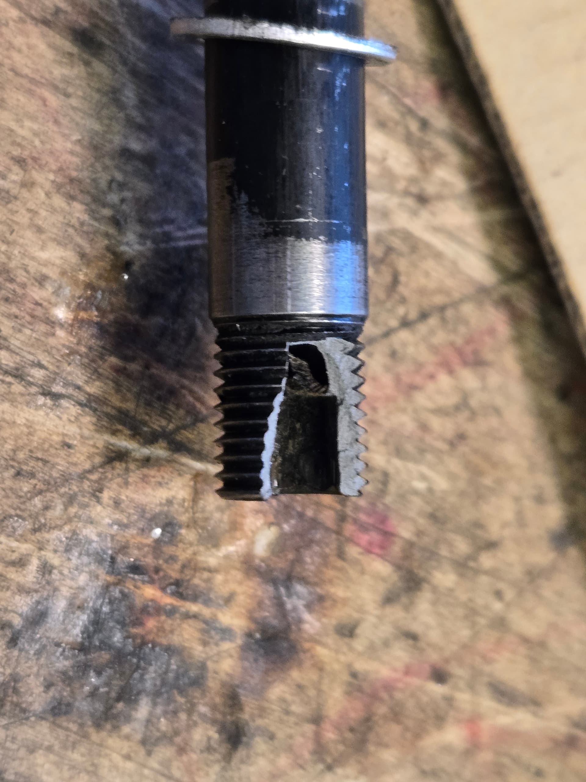

I’m just a savage breaking shit today…
This was putting the axle back on…

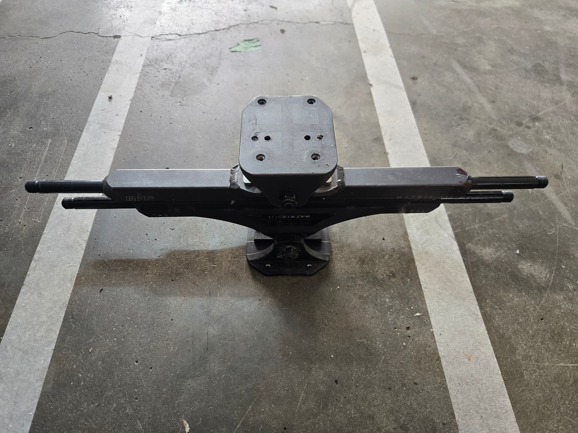

The 320 hanger with the 70mm axles is as wide as the 3DS Fat Boys I had on here.

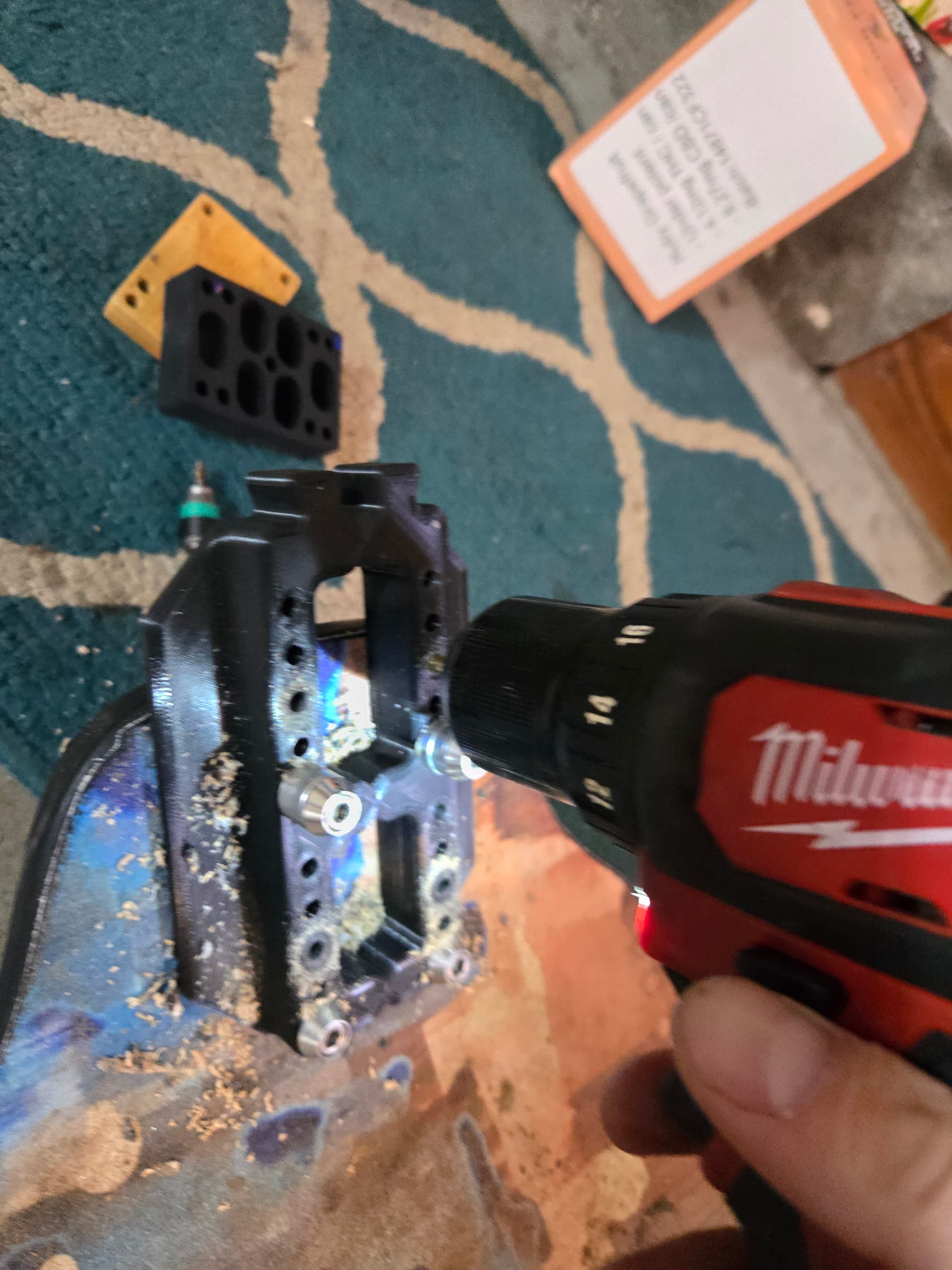

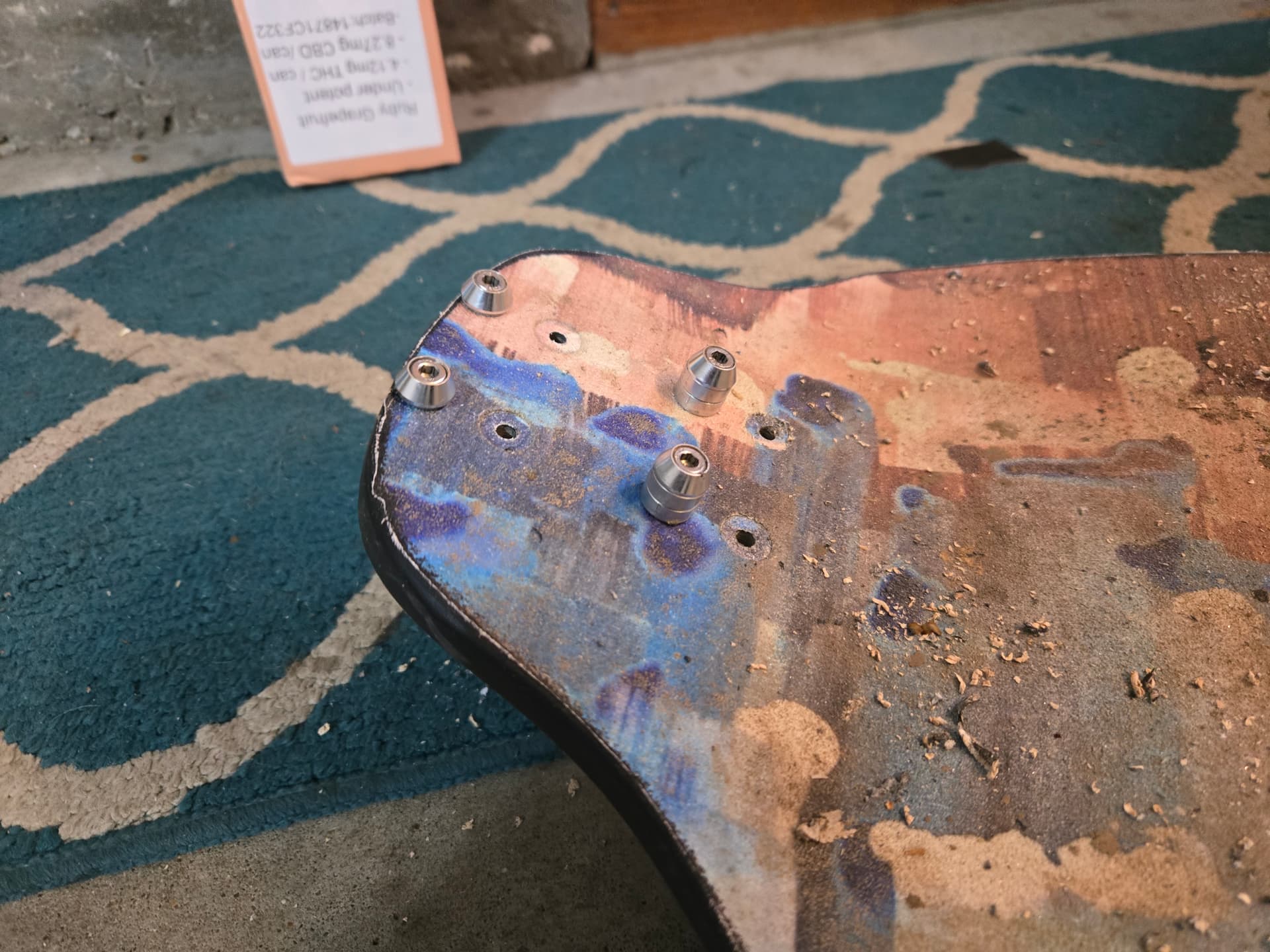

But I also decided to extend my wheel base by drilling out new holes.
So I’m going longer and wider hoping to get the right feeling…
Yesterday when I put the narrower trucks on it looked funny to me.
Felt tall…
I am taking a break from tinkering but I had just put the tires back on and the look is already better to me .

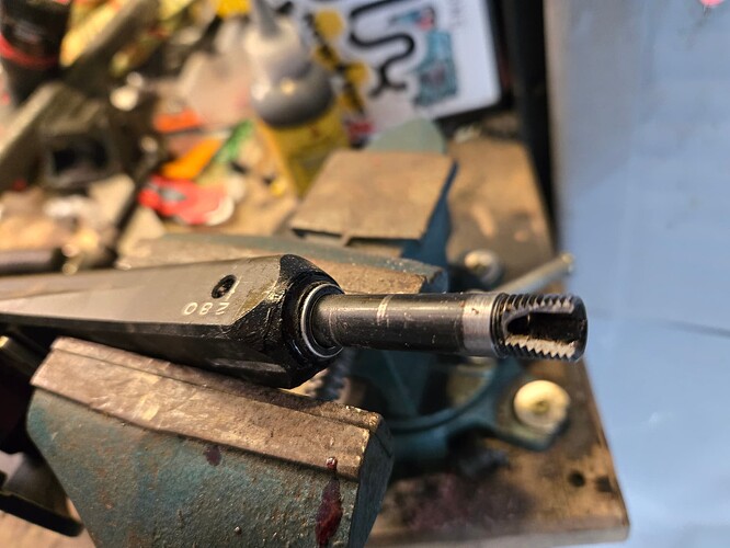

Worth noting that your vice jaws are conducting a lot of heat away from the hanger here. If you left the hanger sticking out so the part that you’re trying to heat is exposed, you would have a much easier time cooking the loctite properly.
This is a good observation and I did move the end up on the other ones.
It’s a pretty simple job once you cook the ends enough.

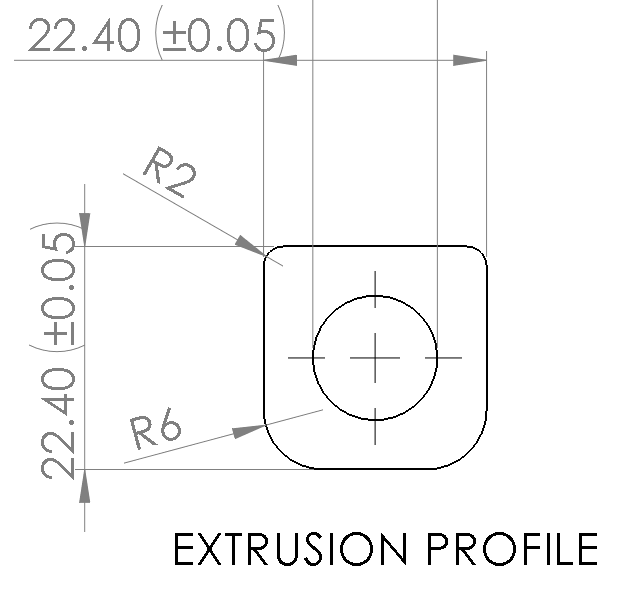

Hi guys,
Anyone got a STEP or STL of the Matrix III profile ?
Wanna build some parts for it.
Couldn’t find this anywhere :frowning:
Yeah, those ones you linked to are the short thread version.
