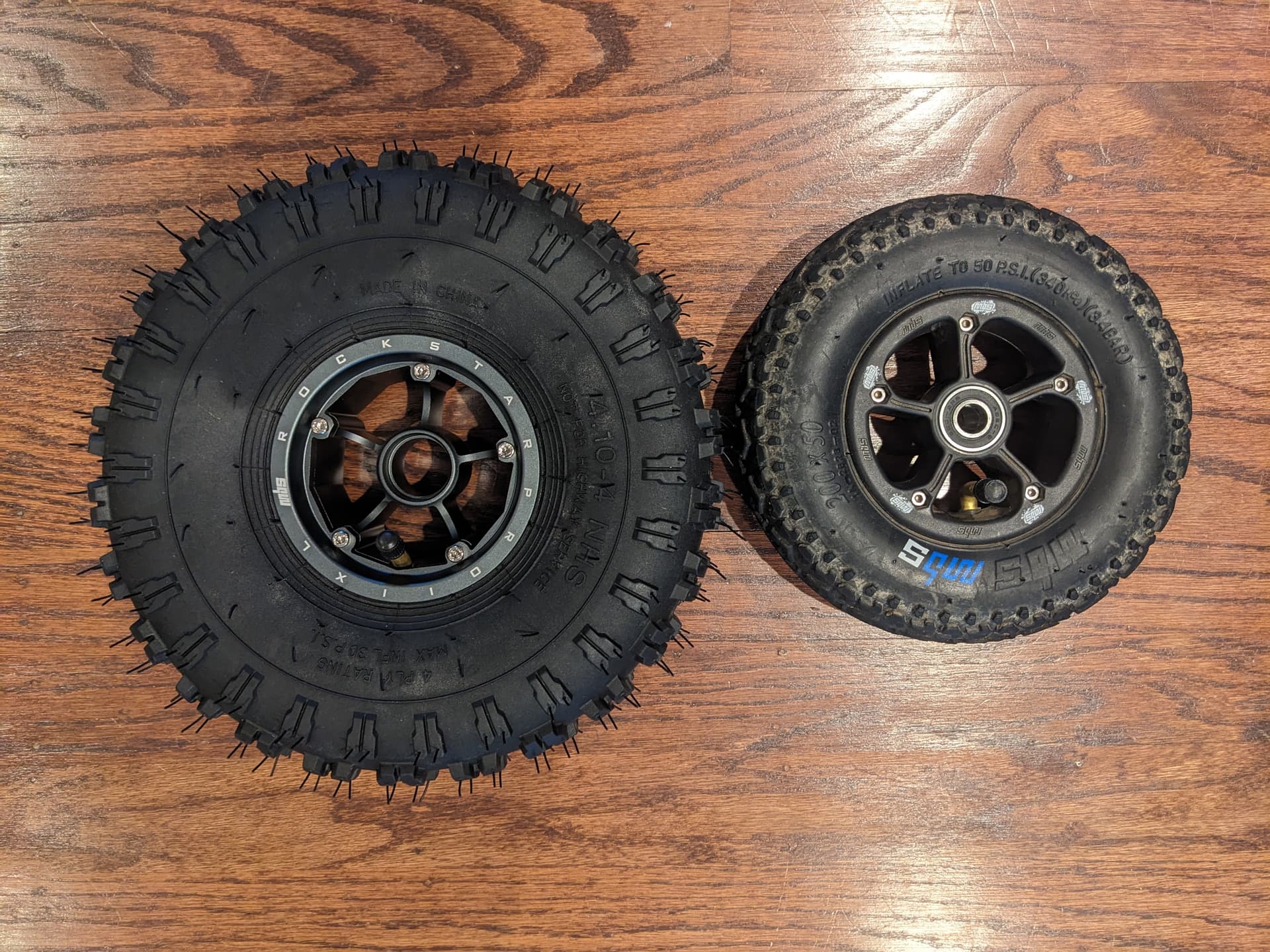

11”? 30 PSI? Cool to know the 3.50-4s I have will almost certainly fit :+1: And also that I made a mistake in not waiting for the new trucks with longer axles :laughing:

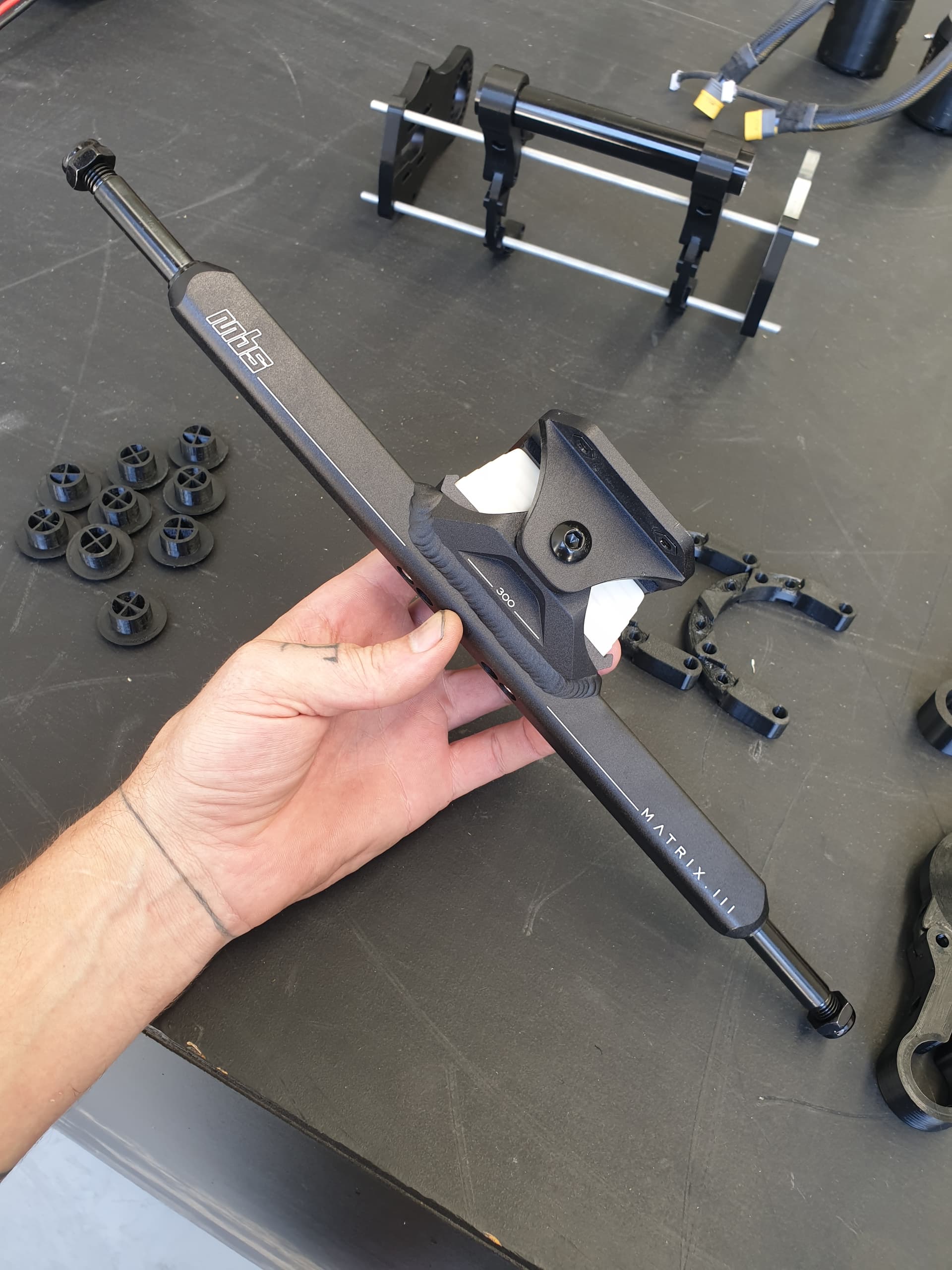

Have you considered the use of cartridge ball bearings in the kingpin interface as opposed to plastic bushings? My biggest complaint with the Matrix II’s was that I had stiction at the pivot on low tension shock blocks. Would love to see roller bearings or ball bearings on that interface if there’s enough meat to allow for a standard bearing size to fit.
I believe other trucks that have taken this approach have had issues with seized bearings, among other things.
Whatever the interface is here, it’s likely going to need to be a consumable item, at least when a nylon bush flogs out, it’ll still work with some slop… if a bearing seizes, you’re gonna have all sorts of worse issues

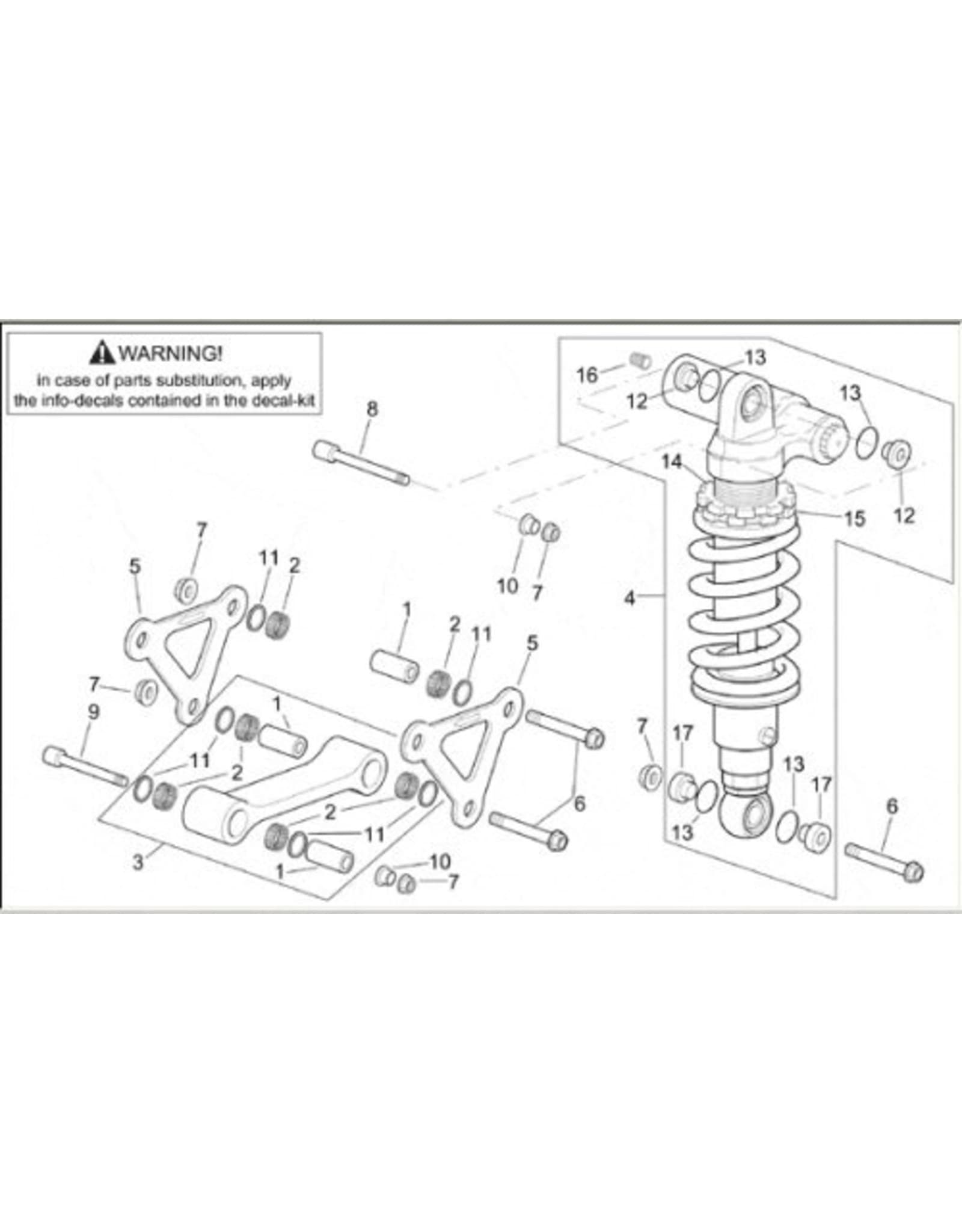

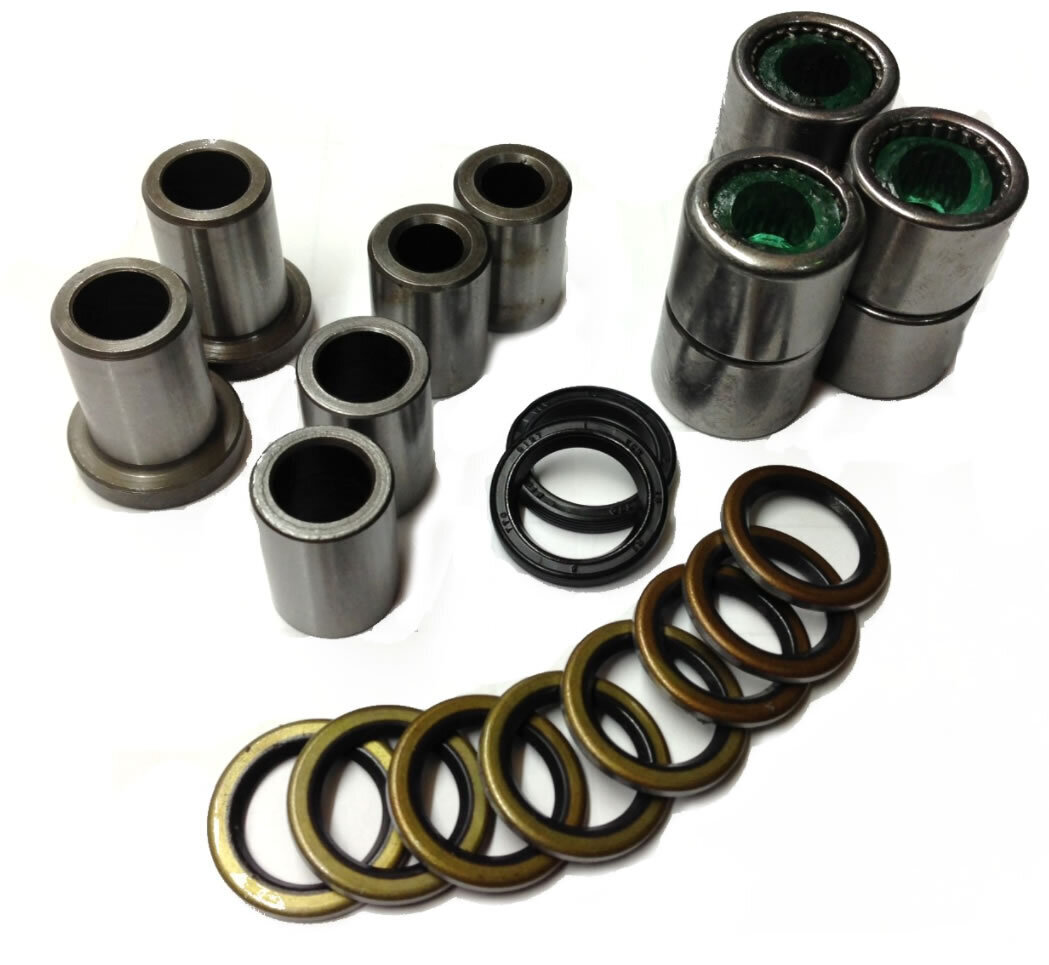

Needle bearings have served the MC world for a few decades in rear suspension linkages with 200kg + rider 150+mph in extreme conditions.
Where these sit tends to get all the road salt/water thrown at it over huge distances & if lucky annual regreasing. What would probably help is a seat for a rubber seal & a spacer to go between the bolt and the bearing although not sure if there is room for that in with current designs.
As used in many industrial applications and swing arm linkages.
Typical part diagram, marked #2.
IMO something like that would be fairly f’ing indestructible in an esk8
Needle bearings are used in suspension designs that built to absorb shock. I don’t think it’s safe to assume they’ll hold up to an esk8 system with no shock absorbtion.
The bearings are in the unsuspended parts of a linkage as well I.e. unsprung.
Yep, definitely, but even that unsprung linkage benefits from the shock absorbing system of 10" moto shock travel. We have nothing like that in esk8 other than our knees to absorb shocks in the system.
A kingpin gets absolutely punished in esk8, which is why we see welds snapping on trucks sometimes.
I’m pretty sure needle bearings have been tried on other vendor’s trucks and they fail, which is why most truck designs use bushings.
Maybe on propel boards or something they could work
No doubt about breaking trucks we’ve all seen the pictures, I’m not aware of the designs which tried to use them & suffered bearing failure.
Would have thought cost & complexity was a factor to a degree.
Only thing about a needle or roller bearing is that part don’t really roll…they go back and forth over a small degree.
I think a bronze bushing would work better, will take a beating and eliminate most slop.
A spherical bearing has probably already been used?
Delayed response regarding bearings for @Kodin and @magharees and others …

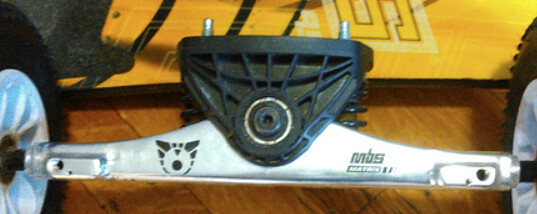

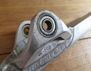

We actually have a lot of experience with using bearings for KP pivots. Our original Matrix trucks (circa 2003?) used a 60002RS (10x26mm) bearing. Worked great. Never had a failure. But that was with a nylon top truck which absorbed a fair bit of shock.
I tested skate bearings in the early stages of the Matrix III projects. I wanted to go that route for the precision which was awesome, but a few things pushed me away from them (at least for now). Assembly is more of a pain in the design I was using (small issue), and there were a few aesthetic things I didn’t like - it’s hard to completely eliminate “clicking” sounds when turning, and they feel a bit “harsh”, especially for urethane wheels (for better or worse, we want to explore that direction more…)
Needle bearings would be awesome for bearing loads (better than deep groove ball bearings like the 608), but not good for thrust which is needed as well, but you could separate those two demands (use a washer for thrust). Maybe a tapered roller as a compromise?
Bronze bushings as suggested by @m_oliver1 seem like a good option too, but no experience with them to comment on.
Spherical ball - not applicable for our trucks but thought could be cool for traditional skate. I remember seeing some designs like that a while back for the purpose of removing lateral slop from skate bushings (can’t remember brand off hand).
So many options! For now we’re just sticking with the same nylon bush as the M2. Our experience has been really good with them, and we made a few tweaks to make the better. I saw some people have had bad luck with other brands’ nylon bushings but as far as I know ours have been solid (probably just thicker?).
In summary… the R&D continues, but I don’t foresee a change to our production spec nylon bushing in the near future.
