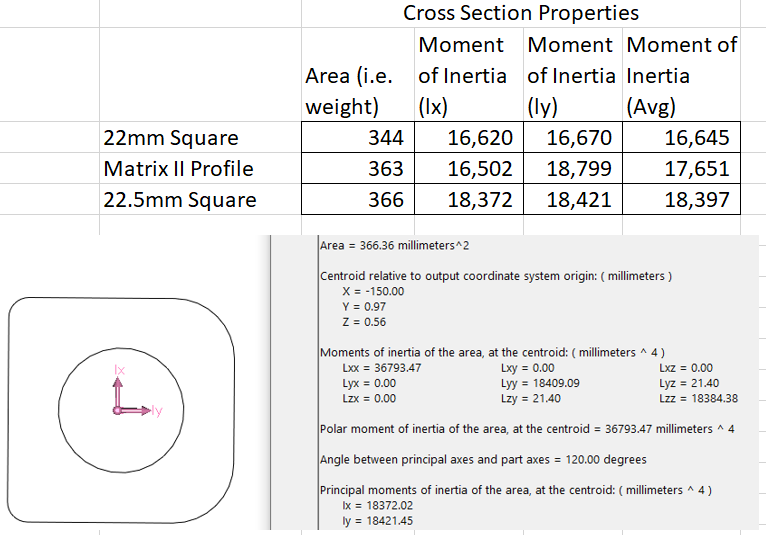

Some rough maths shows a 140kv 63100 motor can produce up to 10Nm torque. After 5:1 drive reduction that’s 50Nm
So on a 22mm profile, the force on that interface is 4.5kN, which is equivalent to 460 kg.
Don’t under estimate how much force this is, especially when our use case frequently involves quick changes between forward and reverse.
Sorry for the trouble. I got stuck in a numbers game. One of my constraints was that I needed the new profile to be stronger than the MII profile. I tried a 22mm square but it didn’t make the cut. It was lighter, but not as strong. The 22.5mm profile was the smallest I could go to meet my constraint. Same weight as MII, but stronger. I can’t find my original calcs right now, but here are some quick ones that are close (coordintate system not quite right, but gets the point across).

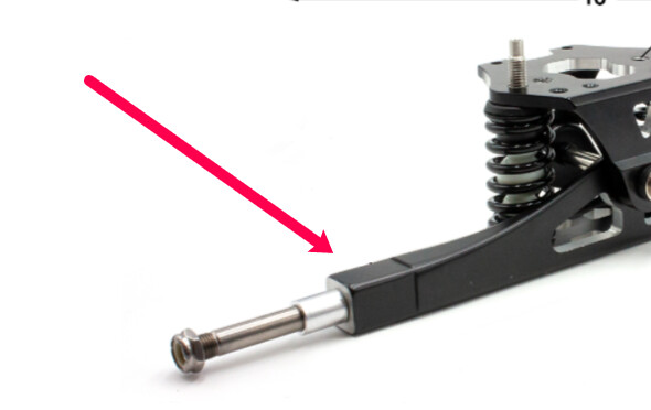

Out of curiosity, what is this community’s experience with slightly oversized motor mount holes?
If most mounts use 2 x set screws on adjacent sides of the square then doesn’t that push the hanger into the opposite corner of the square hole? If it’s anything other than a press fit there will be a little gap, right? If so, I’m wondering in practical terms how much it matters if the gap is .1mm or .5mm. The set screw is still taking some load right? Not preaching. Sincerely wondering. You guys have the experience. Do mounts have problems if the fit is anything other than a press fit? Or do the set screws take the load?
Empirically, I’ve had two motor mount hanger clamps that have been slightly looser than a press fit (didn’t require gentle tapping to fit).
On both of these clamps, the set screws were loctited and cranked down.
I have yet to retighten any hanger clamps that were press fit. I have had to reloctite and replace grubs on both the ones that have had gaps. They were both mountainboards as well.
I think the issue is tollerances. Say a given hanger is 22mm Square, that will usually be defined as 22 +/-0.2 and I’m sure you are working to similar tollerances so potentially the difference can be up to 0.9mm.

My motor mounts are designed to work with wide variations in tolerance. I allow 0.5mm oversize to account for varying hangar sizes. It doesn’t really matter if the gap is 0.1 or 0.5 unless the clamp comes loose in which case a smaller gap will stop the motor mount tilting as much…
Thanks for the real world feedback @Venom121212, @glyphiks, @Tony_Stark. All good food for thought.
@Lee , I do feel a bit shit with respect to lack of standardization. Despite what it might seem like (i.e Matrix II profile - haha), I do appreciate it and strive for it when I can. But strength was the trump card for this one. I’m anticipating these are going to need to be stronger in the future, not only for Mountainboarding, but for you nuts going big on electrics now (especially with the wider trucks you guys are craving).

I bet it would work, but it would really work best on deformation clamps rather than set screw ones
Lowkey I’ve developed a large dislike for any kind of setscrew clamp. They always loosen in my experience
Why not mill the ends to the standard? Leave the rest of the hangar the same? That’s what Trampa does.

We dont do this anymore. We use precision now. Any mount that relies on a big grub screw digging into the hangar is outdated and not worthy of these hangars or anything with more than 1kw of power.
Seriously, I am sure I can gently convince that 22mm clamp to slide on the 22.5mm profile :man_shrugging:
You would be surprised, 0.5mm is a lot in fitment world. Would need to get the file out
Yeah you think 0.5 isn’t that much and then when you look at it, you realize its metal and that you’re going to be sitting around filing for a while.
If the clamp is built strong enough you won’t be able to convince it lol
0.05 would be a different story

When @Boardnamics designs press fit mounts to use with his AT gear drives for these, they will slide right onto the hanger.
It is a valid question but all of the matrix II are welded so I feel like they have this process well developed by now
