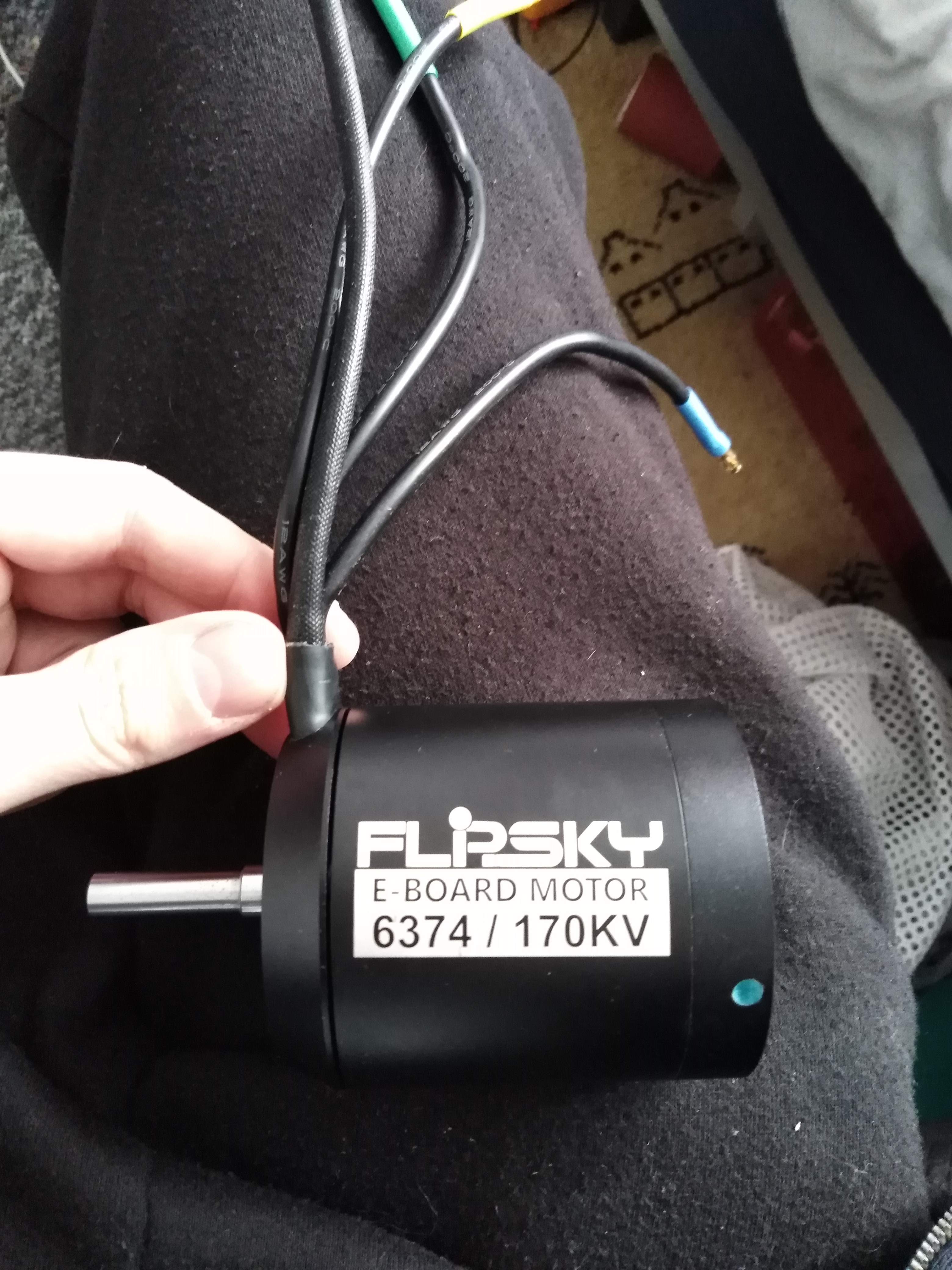

- Motors: Flipsky 6374 170kv Battle Hardened

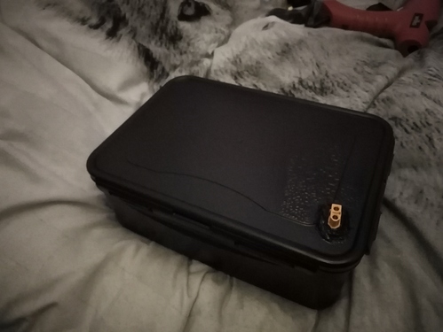

- Enclosures: Peli 1200 for battery / Peli 1040 for ESC

- Enclosures: Tuppaware top mounted battery box

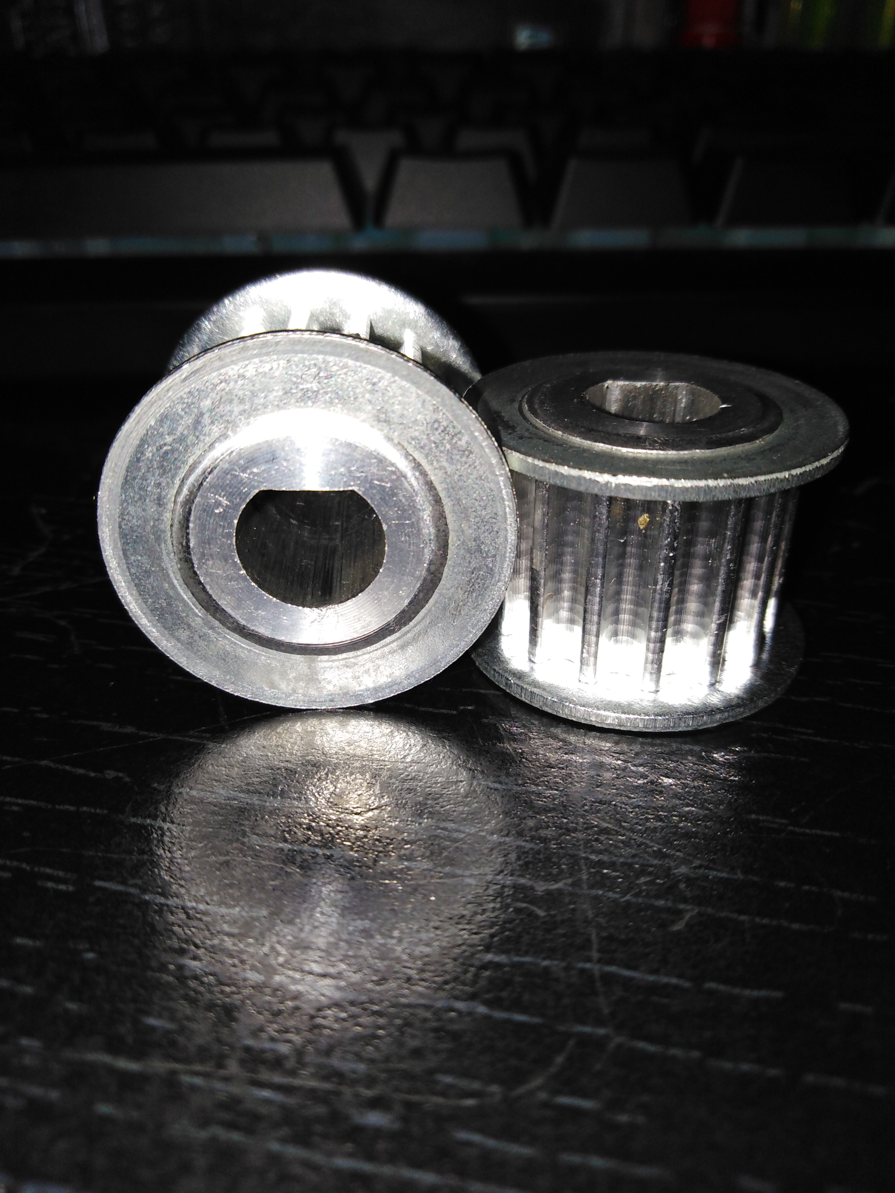

A perfect example of this would be the Fatjay motors. Tom (Ideatb) suggested them as a budget choice over the Racerstar ones I had been looking at. I was looking forward to playing around with different gearings by changing my motor pulley. But I didn’t realise these motors have a 10mm D-shaft and there ain’t a lot of motor pulleys around for that. So it’s basically 15T or nothing. I kinda wanted to start at 14T to find a nice balance between torque and top speed, especially as these are 190kv. A lesson learned and something I will remedy with my next motor choice, most likely Street Wing.
Another dumb choice was cheaping out and not getting Ideatb’s pulleys. I originally planned to have some 3D printed to but then I noticed Trampa’s are oddly not that expensive at £25. They suggest the 62T for Urban Treads, but I figure I’ll get the 66T as it will be fine and then I’ll have something good for some 8inch tires later on. Then I started to think about belt length. I used the calculator everyone suggests (Timing Belt Calculator - Belt Length Calculator | B&B Manufacturing) but there is no option for 66T pulleys. I can only select 64 or 68, so I have no idea if that is going to throw off the reading by a significant amount. Now I’ll likely have to waste money buying multiple belt sizes to find the right fit. If I had got Tom’s pulleys, he would have supplied appropriator belts and it would have been one less headache. Some things are worth cheaping out on, some are certainly not.
