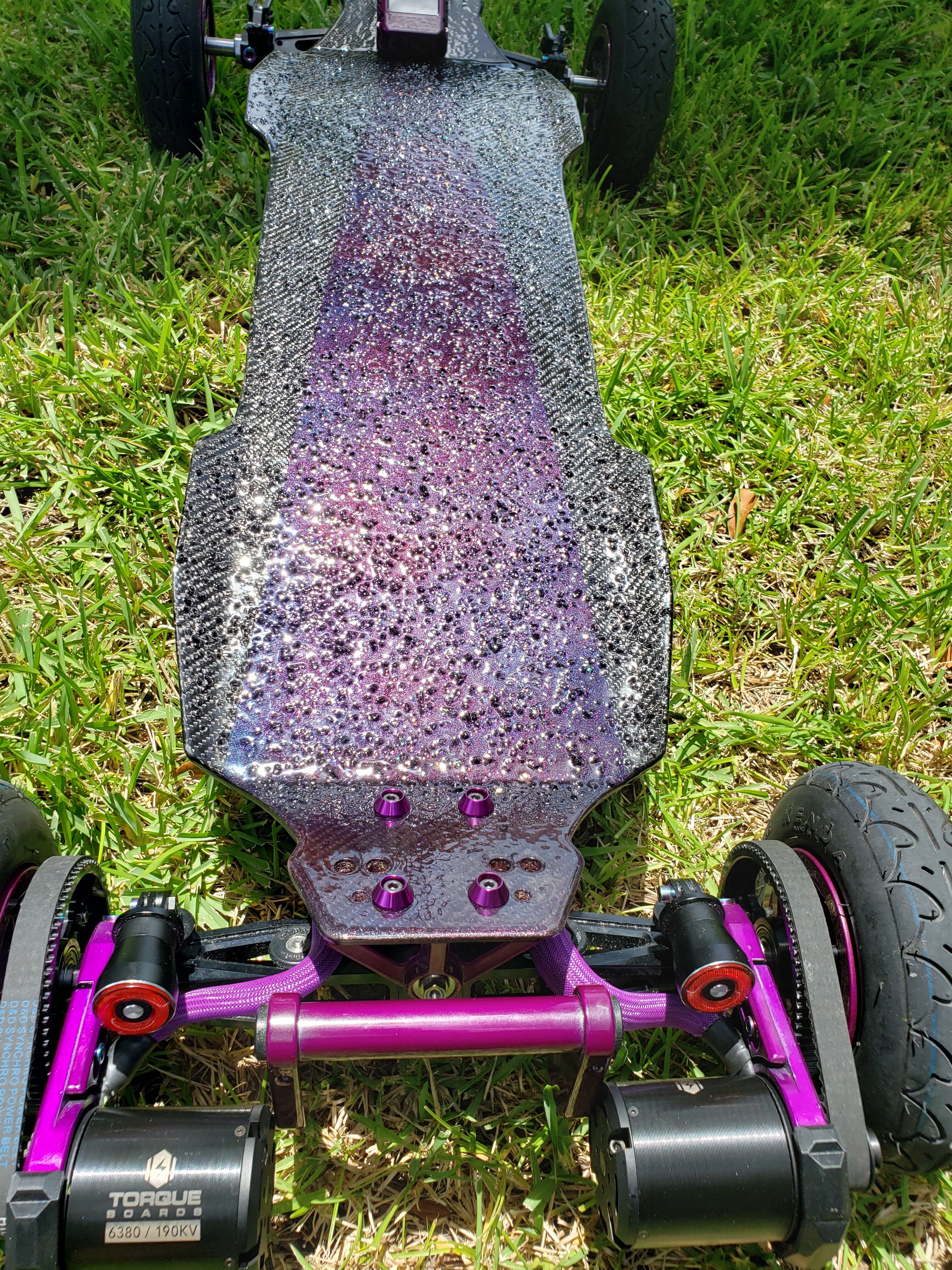

I’m planning a build mainly for streets using a kaly deck probably will focus on torque but I was wondering if my top end is going to be around 35 mph what would be the better setup. Which one turns better? I know channel trucks aren’t the best for racing but until I recover from this build I won’t really be able to create something with 3 links so which one would be better for racing on shorter tracks like stuff like intro to speed?
those trucks use a similar bushing set up, but since the MBS trucks have a shorter wheel base, my guess, with something like yellow or white bushings turning would be better with MBS
Ya that’s kinda what i was gathering but this build is basically gonna be a love child build and I see that so far all of them use hyper trucks and I was wondering for my purpose could I get away with making mine with matrix II’s
i think you definitely can
with Matrix II, does body weight determine which version to get? (i.e MBS metal vs MBS regular Matrix II’s - i understand the latter have plastic baseplates). Maybe if your light you can get away with the (cheaper) regular ones.
I am a very light rider but I think it’s less about the weight of the ride but more about the torque
i gather you mean that for a torqu-ey setup you need stability, which the all-metal ones are more suitable for?
Ya like the force that gets put on the rubber ones with motors snap because they are not made to have that kind of force from that angle put on them sorry if I’m confusing you more then helping…
No, the nylon ones are just cheaper, lighter, and objectively worse for our purposes. Weight reduction is good if you’re doing jumps and short tracks on a regular mountainboard, but you want durability for offroad trail riding and long distance cruising, which doesn’t happen often with analog boards due to the need for hills. It’s not really a matter of if they will crack, but when. Functionally there’s no difference between the plastic and metal ones.

I would try and ride both sets of trucks and make a decision on that.
I was in the same exact boat and was leaning towards the matrix2s, but after riding hypertrucks, I fell in love.

Currently you have lacroix falcon drives and 3dservisas finality drives.
Moon was designing a clamp hasn’t been produced for sell yet.

Fyi for the cost of the hyper trucks your getting everything but a motor and motor pulley.
In another thread there was talks that they weren’t going to dept the trucks yet but may package them with falcon drives as an option.
If your itching to ride start with the matrix2 then upgrade later
Get some @moon trucks they come with free assembled 4gears gear drive
I emailed lacroix to see if the price would go down if I didn’t need everything there but I doubt it. If I do go with the hyper trucks I’m gonna get the shorter front axels from land surf. I think I will probably not m2 for the start like you recommend unless anyone thinks I should def go hyper trucks.
