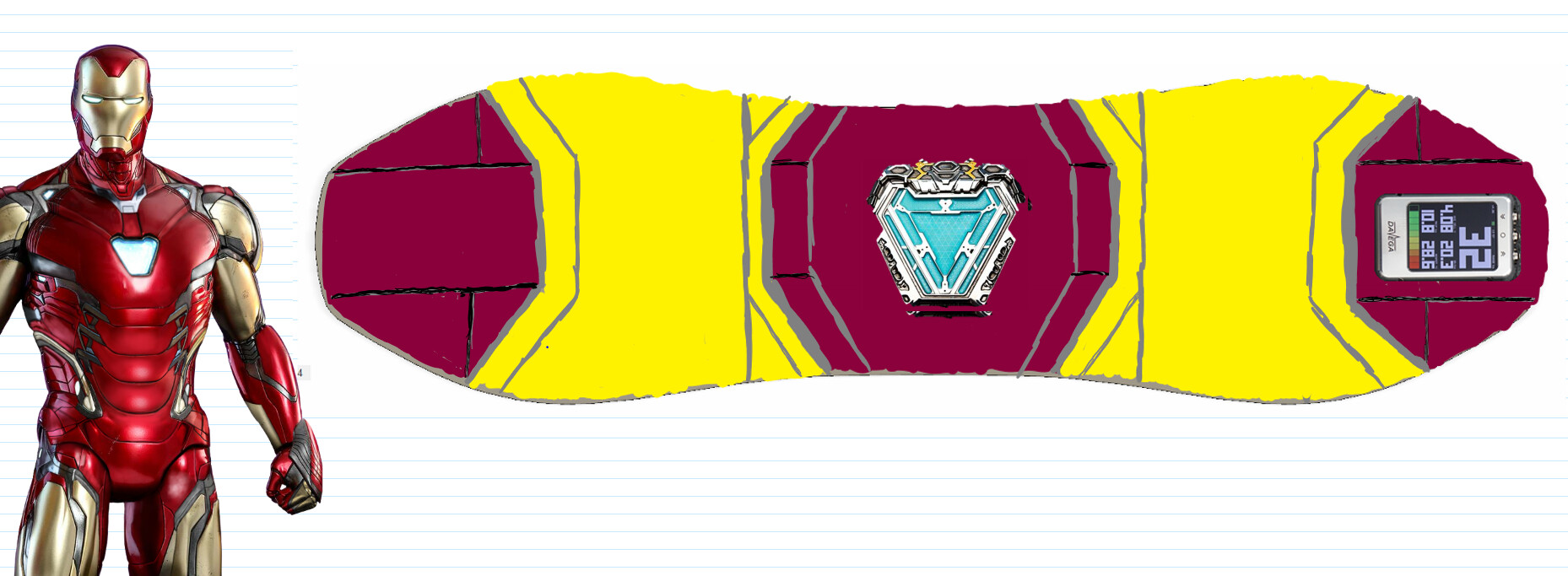

My plan modded is actually more along the lines of what I was thinking. Personally, I’d rather see something like that with slightly more small screws than a more risky design with less larger screws.
The less you have to take out of the deck in volume, the better.

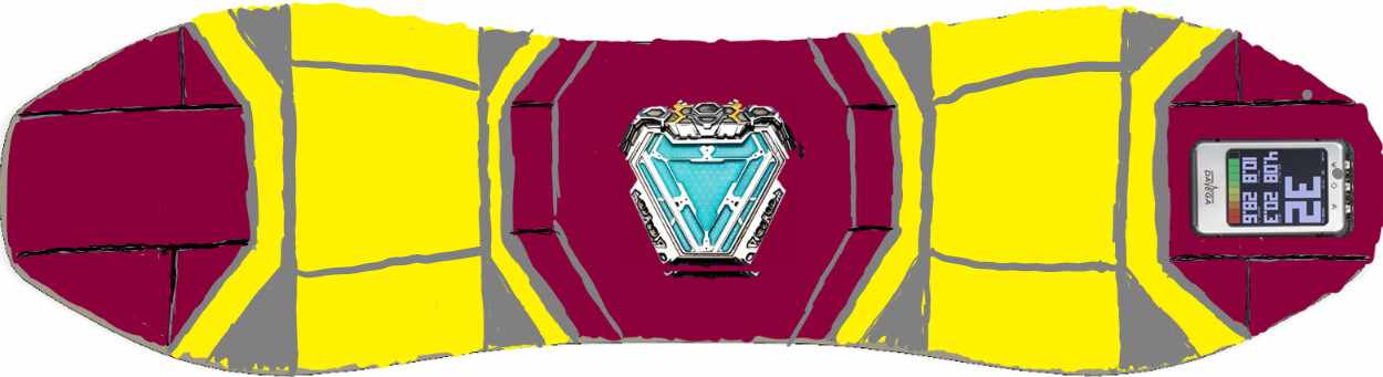

Thoughts? black lines vs grey lines? red? yellow sections? more sections? Im thinking a mix of straight lines that follow the deck holes and contours that follow deck curves. theres sections where the feet go and then at the ends where the board curves up and around the arc reactor. Ignore the poor drawing and colours that are inaccurate. I’m sure it will look better with gold and proper lines. Will remake in fusion if you like it
also im thinking the vinyl on the bottom will have the two blue photon beams under the feet! (that are at the palms in the suit that he uses to fly - because ill be flying with the board

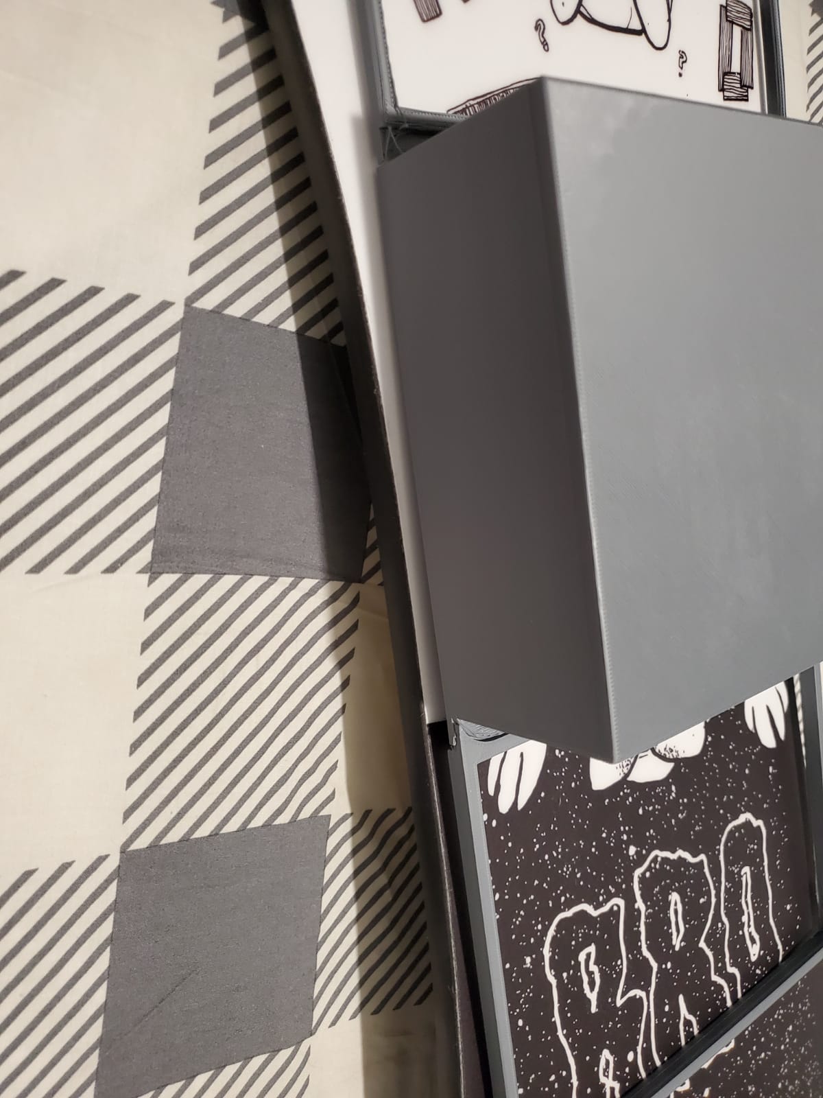

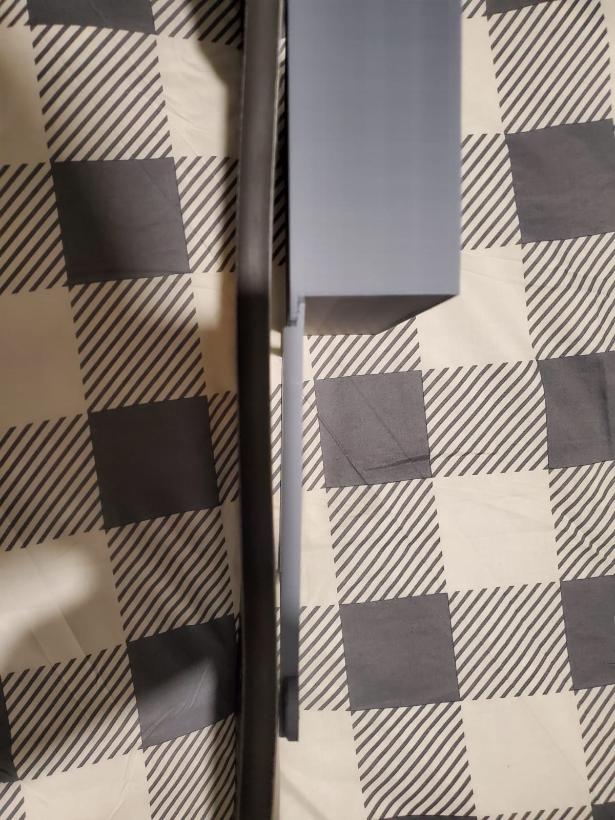

The enclosure dimensions will fit on the board, 12s16p here I come! I have a challenge: the curvature. I will be printing a gasket in tpu but I think this is too much curvature. I wish I had the model of the deck then I could easily cut my boxes so the bottoms conform to the deck
Take a photo of the deck from the top and from the side, make sure that the angle wihile taking a photo is as close to 90 degrees, measure length, width and thickness of the deck at the middle and I’ll make u a model in a second.
But PLEASE measure it in metric (cm,mm) because I have no idea what inches, feet, foot or 1/64 something mean.
Man you’ll have 3 sheets of printer paper clearance on that deck once you step on it.
Please reconsider both the idea of having 3dprinted plastic hold the biggest fire hazard in this hobby and how much battery you can actually fit under that deck
