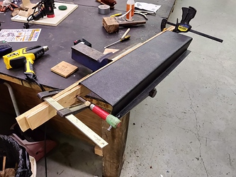

Made my own enclosure today!
I had a 22" x 12" sheet of 1/8" ABS plastic to start. And used a heat gun to warm it up enough to bend.
Put it in a makeshift jig with a vise and clamps:
I screwed up and the dimensions were off :’( This was because the bending radius was bigger than I expected. So I had to flatten it and try again:
It worked in the end! but looked abit wonky. You can see in this picture that the left side was redone and wonky, but the right side was fairly smooth since wasn’t flattened and re-bent yet:
Overall it turned out pretty good for a first try :slight_smile:
