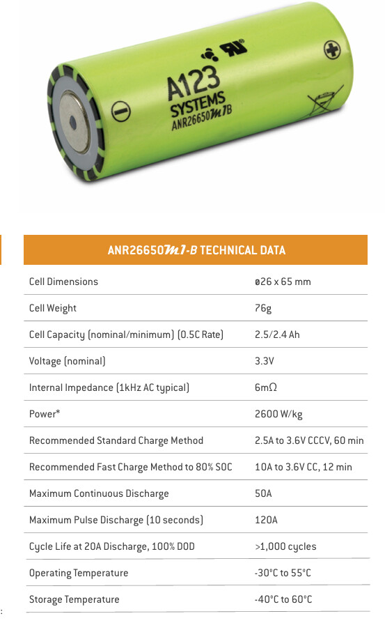

Not 100% sure this is the right place to ask but I’ll try. I’m running a DV6 with a 12S2P A123 pack (5Ah) and I’d like to tweak some settings.
I’d like to understand how the “motor current max brake” and “battery current max regen” settings work.
The max regen set to -15A, means it will actually push 15A back to the battery on hard braking? If yes, I should decrease this.
If on the other hand, I’d like it to brake harder, can I increase the max brake current? If yes, by how much? Will this stress the DV6 or the motors more?

At 50% of your boards top speed you’ll only need 50% of your boards battery voltage, meaning you can draw 10a at 50v from the battery and push 20a at 25v to your motors.
Max Regen at -15a will indeed put 15a to your battery, this number is also per motor, meaning with 2 motors you’ll put 30a into your battery.
This is not the same as charging at 30a though, this braking current is made up of spikes of current rather than a consistent 30a. I don’t have any info on pulsed charge limits on A123 cells though.
As long as your motors aren’t overheating you can increase “motor current max brake” If I recall correctly the DV6 can do about 80a/side
Putting more power through anything will indeed stress it more, your DV6 though is rated for quite a bit more than you’re using it for, I wouldn’t worry about raising them unless your motors start to overheat.
