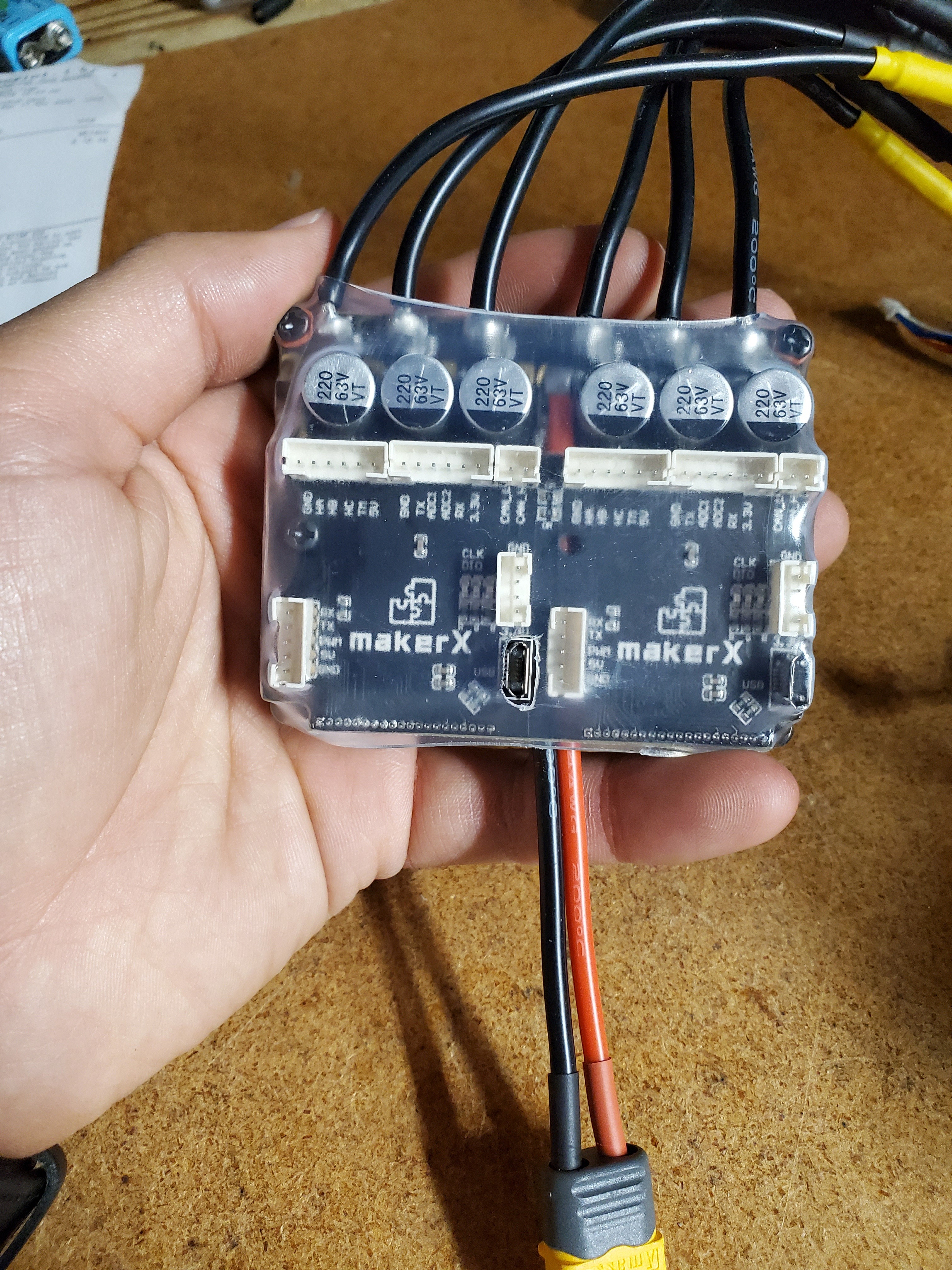

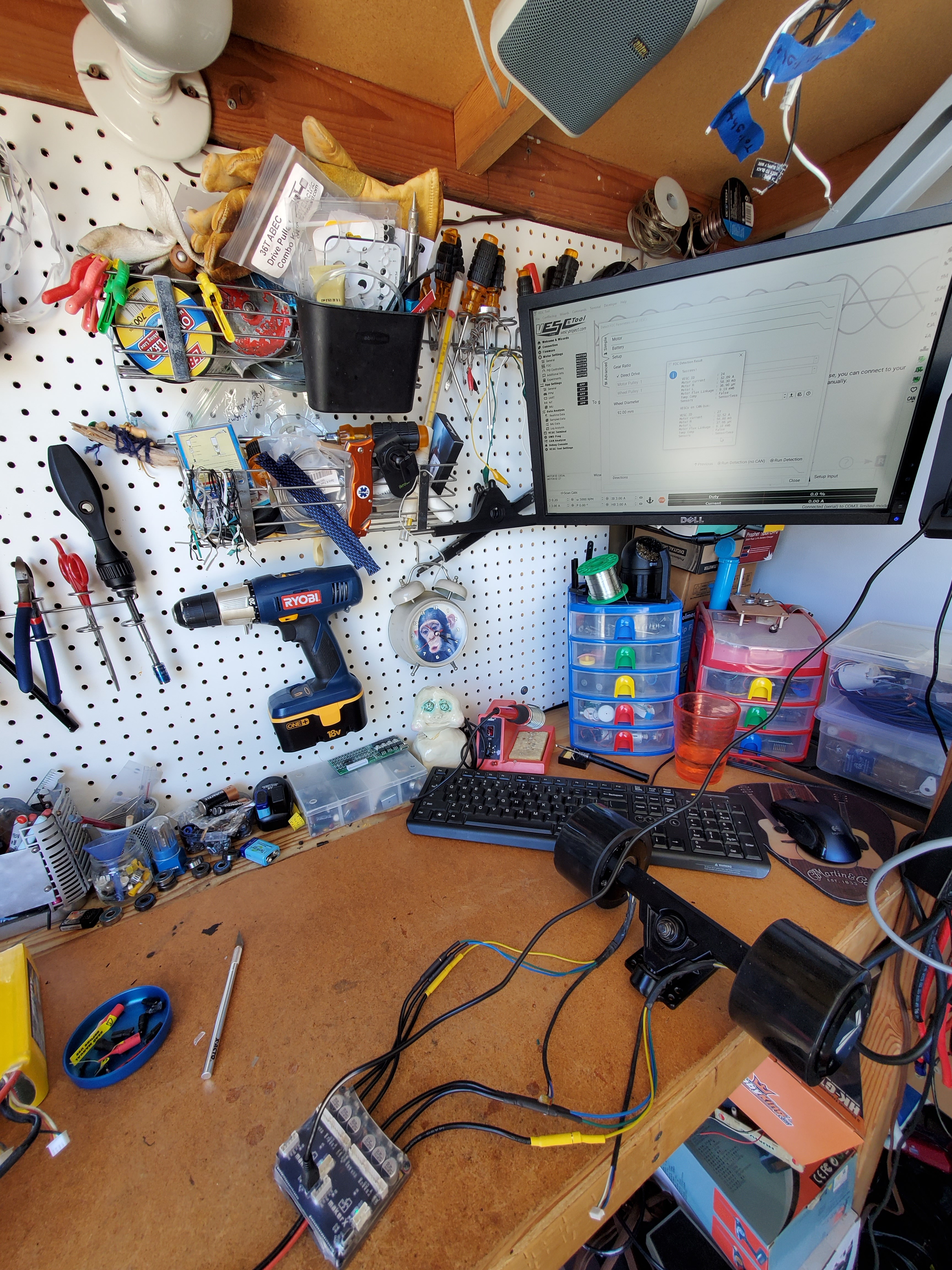

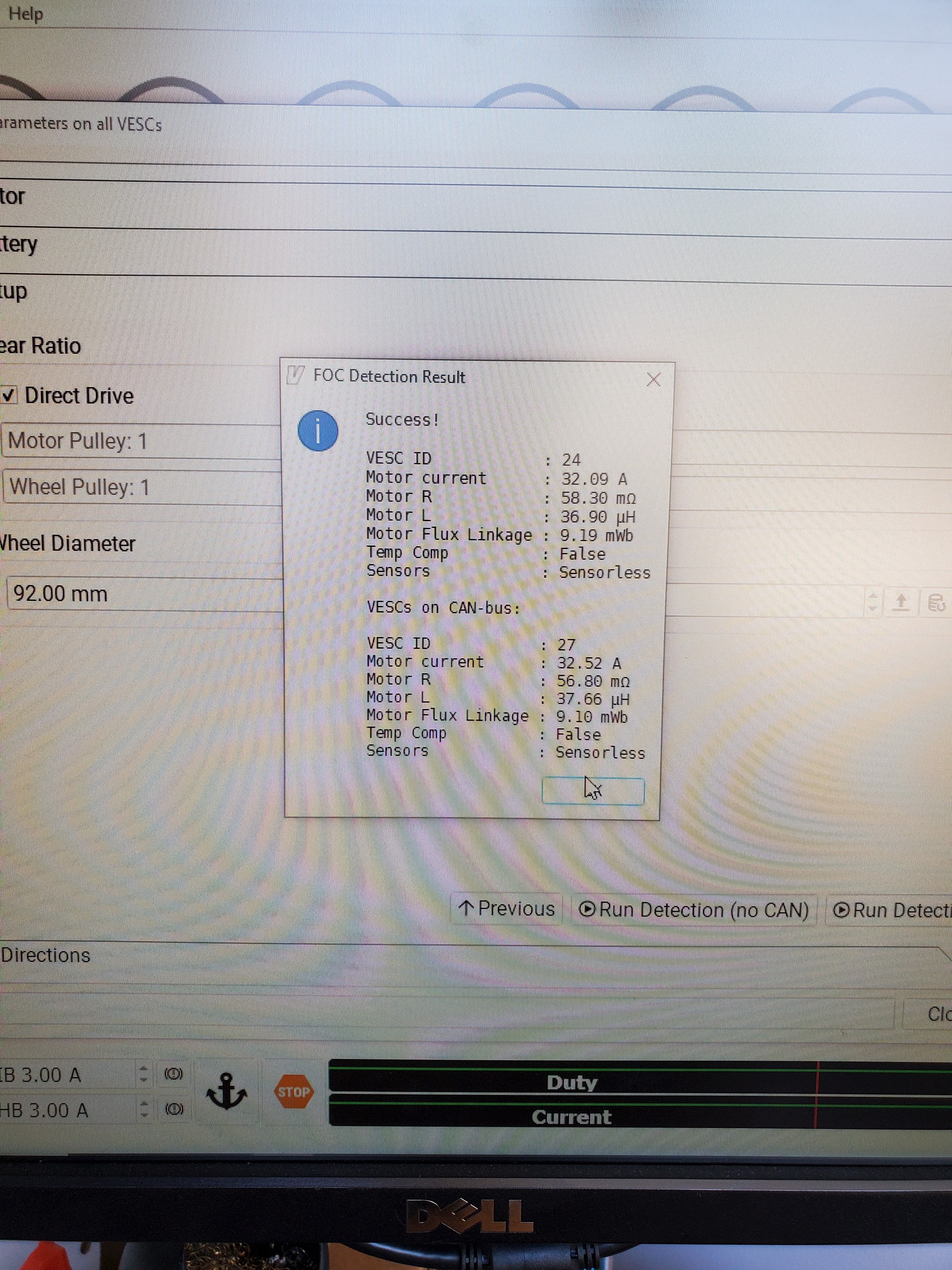

Alright so I got the motors spun up today after soldering on all the connectors. Latest version of VESC tool, 2.06. I didn’t update the firmware on them yet because I wanted to see that they worked fine with the firmware they shipped with. I could check again but I think I recall seeing that they shipped with 3.65 in VESC tool.
I had no issues running motor detection with medium outrunner settings and specifying them as direct drive, and was able to run detection just fine through CAN. After that, I configured them to use BLDC instead of FOC since my other two hubs are on BLDC on the TB vescs. Both motors can be operated with the keyboard controls although there are some weird skips on startup like normal with the keyboard control settings.
I will probably leave CAN turned on since this is supposed to be an improved design and it’s a dual vesc anyway. In addition, it makes the controller wiring easier. I am already running split ppm for the TB vescs, so I will probably just split another off and run the wire up to the front of the board. That brings me to my stopping point for the moment; it is not immediately obvious to me which port the PPM wires are supposed to go into. I see the UART ports but I’m not sure if I’m just expected to use three of the UART port pins for the ppm input or if it’s one of the other ports.

I’m not sure exactly what you mean, I ran the motor detection in FOC and it worked fine, spun with the keyboard okay as well.
I wanted to run the actual board on BLDC to make it louder and match the other two motors on the TB vescs. To be honest the only thing 4.12 I trust with FOC is the Focbox. Were you asking me to run the testing in FOC or run the board on foc?

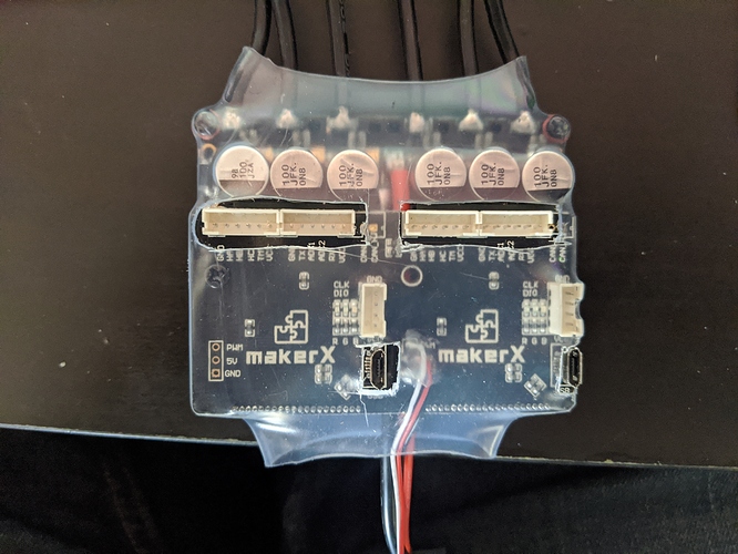

Does this help? You can see where the wires are coming off of for PPM.
Looks like you have a different revision of it. I have UART ports instead of your pwm spots and the caps are different parts.
I wonder if I should just try and see if it works just using 5v gnd and pwm on the UART port
Alright more news gents. I got PPM working just fine by using @YUTW123 provided UART cable and plugging into the side that I configured from, still in CAN. Looks like he made it so you can just use the PWM, 5V and GND wires from the UART port and it will work. I have a Vx1 that’s in the FrankenWheel build but I didn’t want to disassemble it to test this quite yet, so I will probably use UART mode on the Vx1 but I had this GT2b laying around (it had some weird intermittent problem that is apparently gone right now) so I just used that so I could test it.

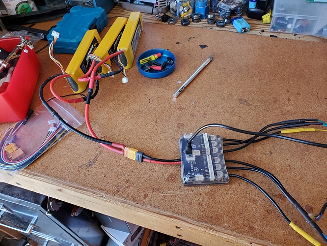

Here’s a video with the MakerX dual properly running Current no Reverse with Brake in BLDC mode on the Landwheel hub motors using 3 3s lipos I’d replaced from my main board.
As you can see, no issues here.
Unlike some people, I do actually like smart reverse, so I decided to try turning that on, and it seems to have some weird issues. The video below shows the board first running in smart reverse, and then after fiddling around and finally finding the switch, I changed it to current mode to show that normal reverse works fine. I would imagine that the smart reverse is only having issues because it’s on the bench with no load, but I don’t have much experience with it, so maybe someone could enlighten me.

I think smart reverse needs sensors if you’re running in non HFI mode
Ah. I was not aware of this. In that case I will probably just run no reverse. Either that or try and wire up the sensors, but in interest of consistency I would have to do the same on the TB vescs, which… Well I probably should just do it, but you know, sensor wires are annoying lol
HFI is still only in the beta firmware afaik and I don’t want this board to have any beta-ish issues.
